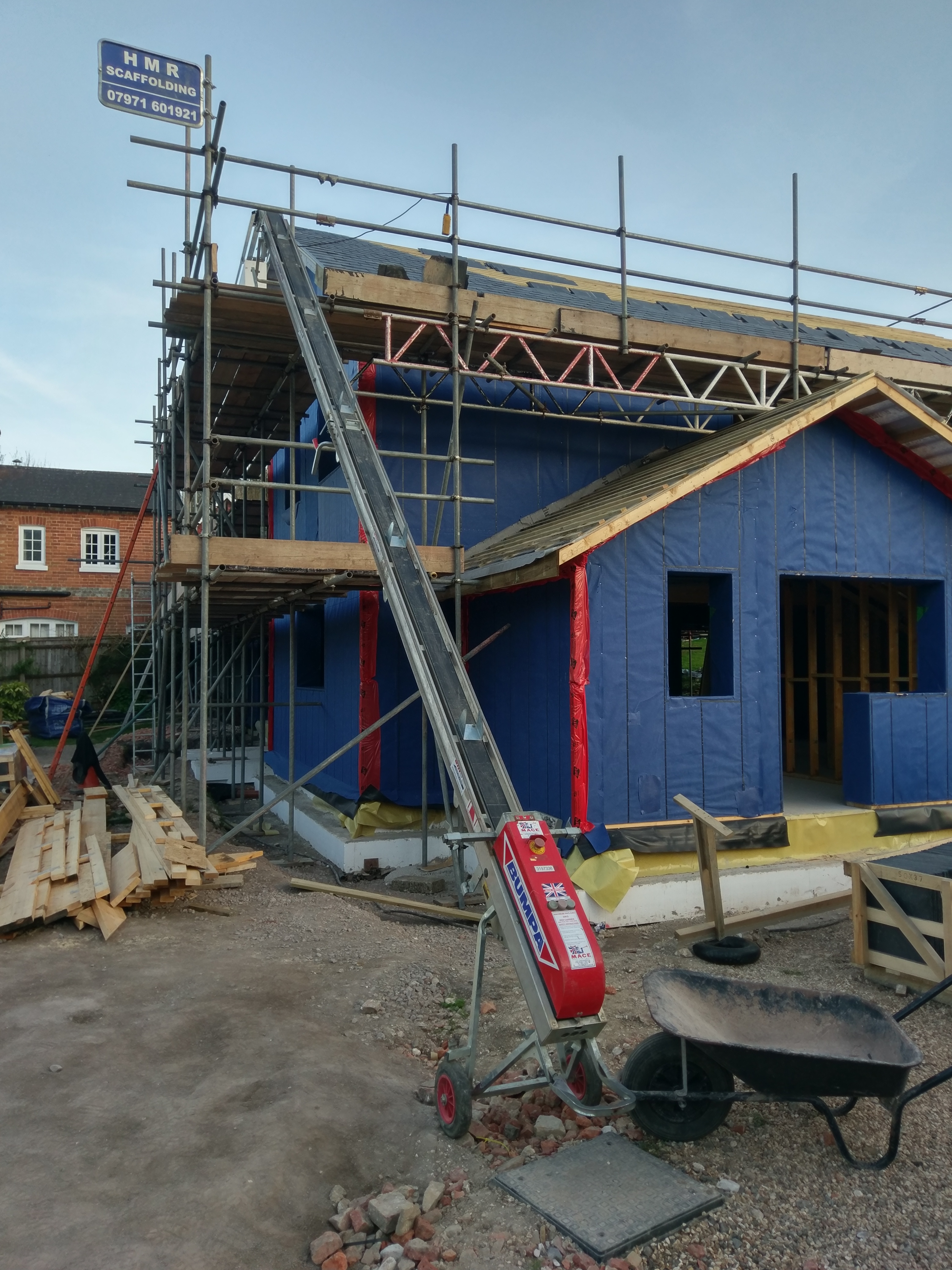

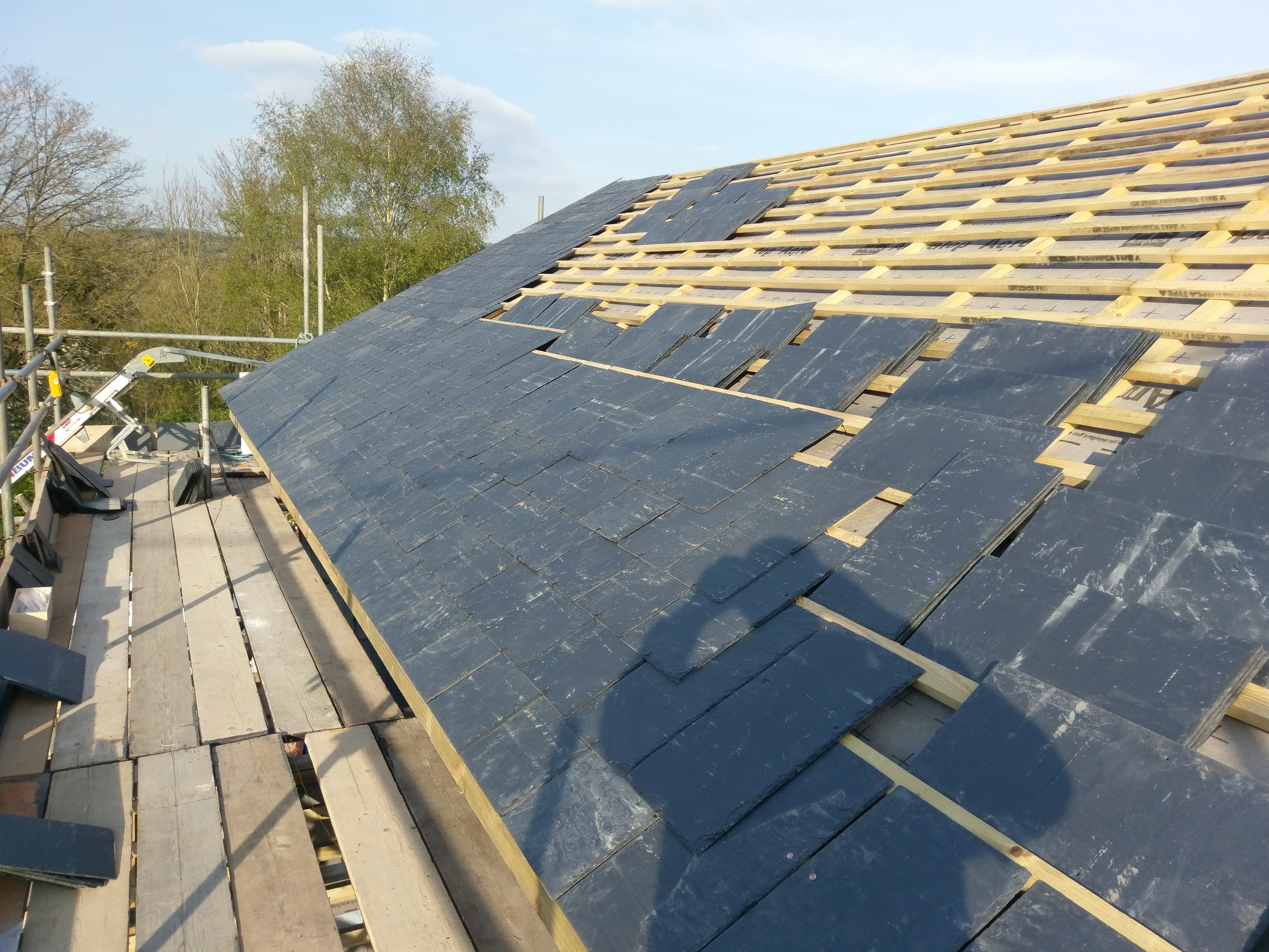

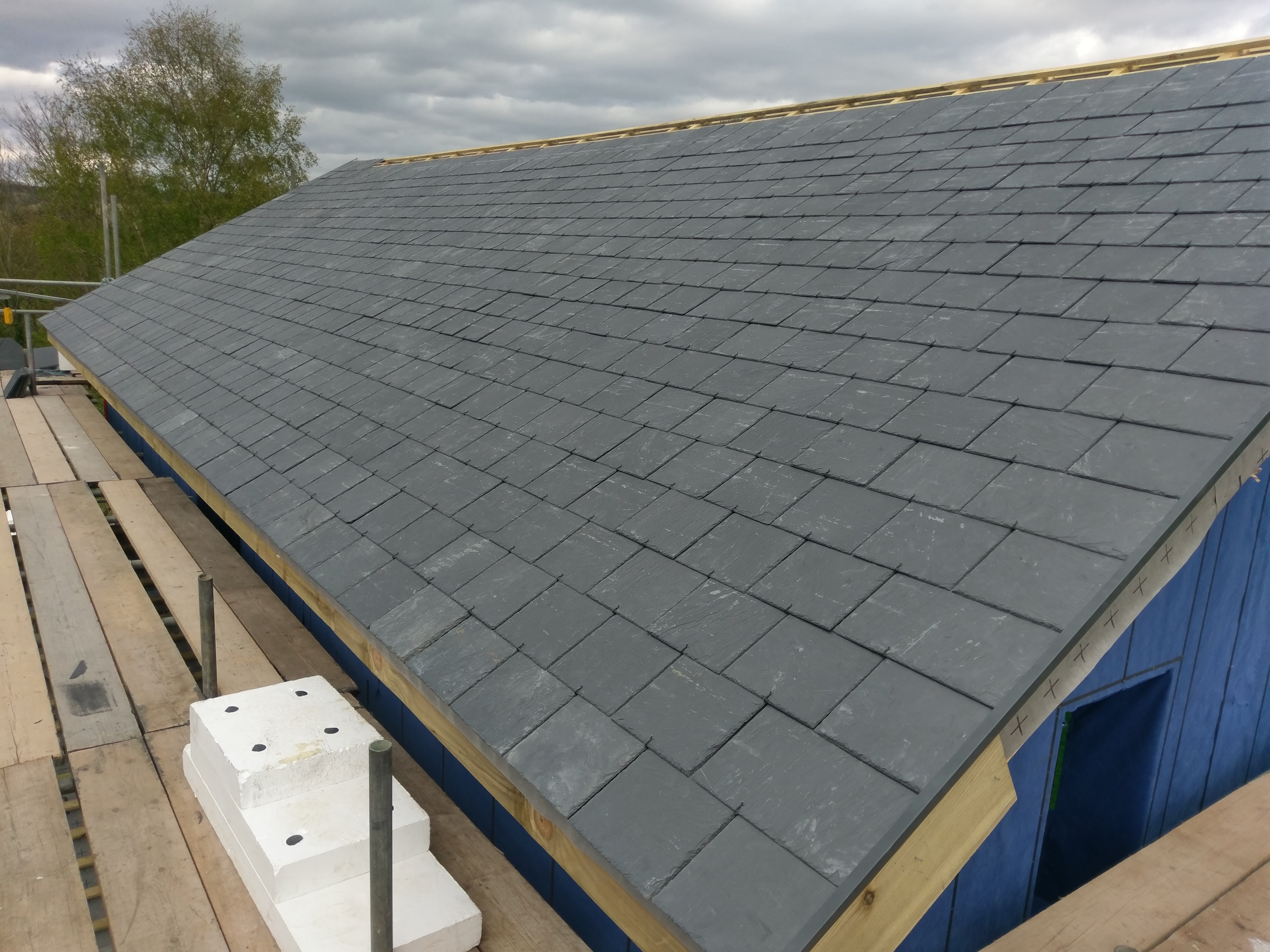

dogman Posted April 11, 2017 Author Share Posted April 11, 2017 Started roofing yesterday. We decided to hire a Bumper However we had a very frustrating day as it would only run for 2 minutes before it cut out. A quick trip to Selco and a larger transformer fixed the issue. Today was more productive About 600 slates loaded onto first roof and made good progress (for me) Link to comment Share on other sites More sharing options...
Triassic Posted April 11, 2017 Share Posted April 11, 2017 Nice slates, what are they? Link to comment Share on other sites More sharing options...
dogman Posted April 12, 2017 Author Share Posted April 12, 2017 http://internationalslate.co.uk/spanish-slate/casaio/ came in at just under 97p each and £2.16 for slate and a half so far they very consistent in thickness and totally flat. As normal there are shouldered slates in each pack but i use these for the cut courses Only 1 broken in first crate. They are a thin slate around 6mm Link to comment Share on other sites More sharing options...

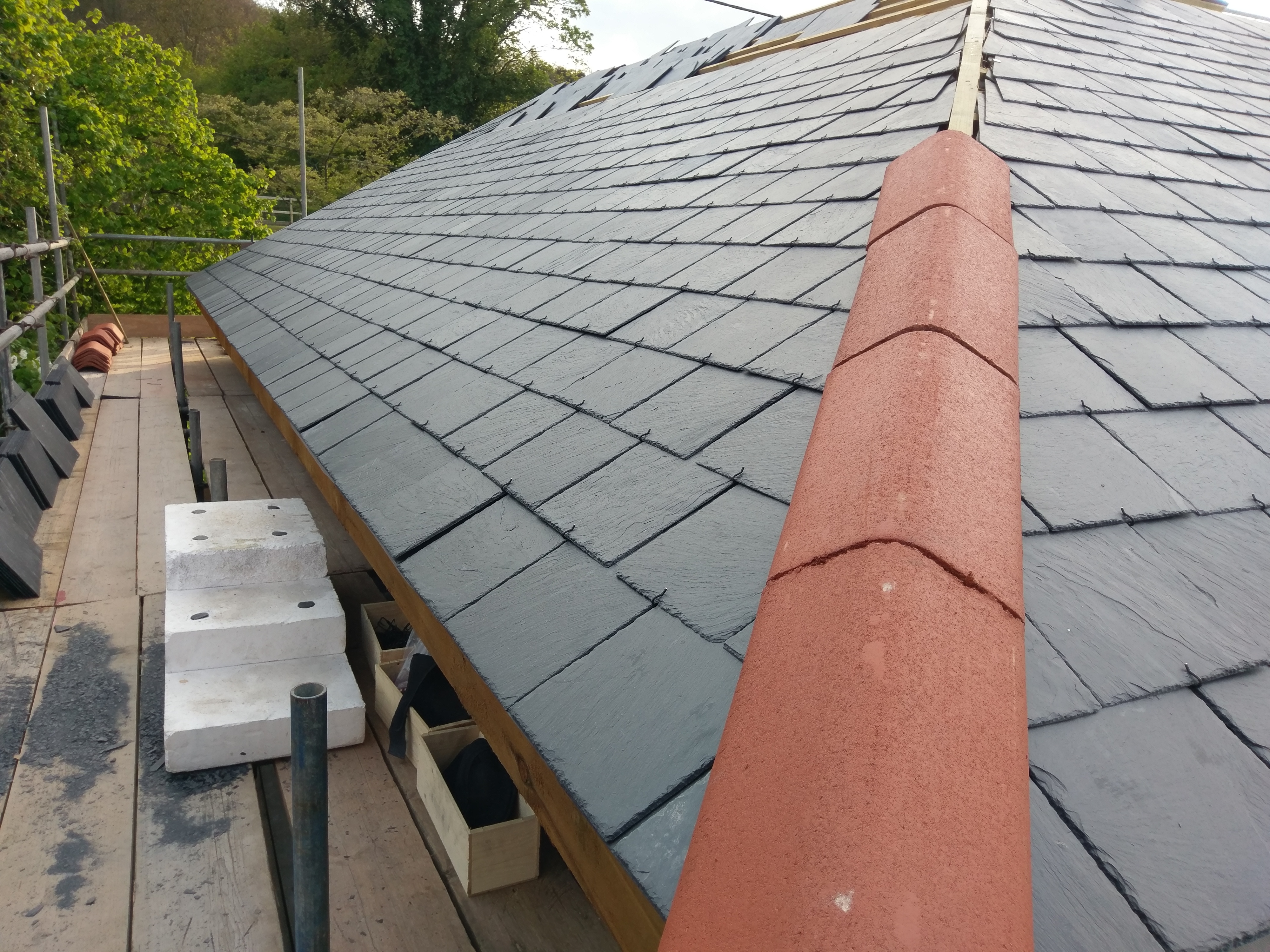

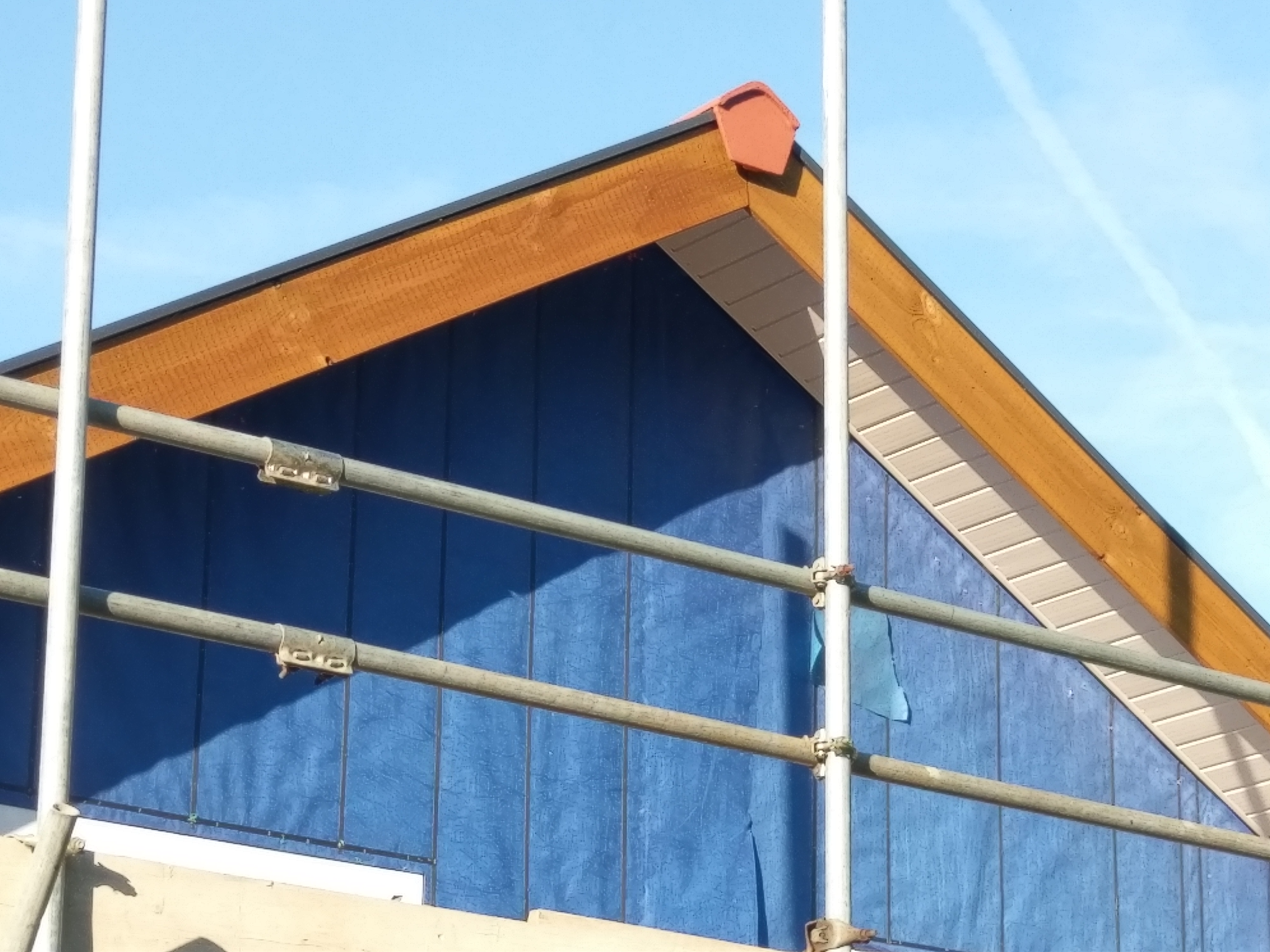

dogman Posted April 19, 2017 Author Share Posted April 19, 2017 A couple of photos by way of an update. All the slates and ridge tiles are up. 2000 odd laid. I am off to the land of no internet for a few days Yes sunny Norfolk where my parents live BT is so slow they don't even offer broadband And there is no mobile signal unless i walk down the road for half a mile. 1 Link to comment Share on other sites More sharing options...

TerryE Posted April 19, 2017 Share Posted April 19, 2017 And I see Kytun edging strips as well. All very neat. Looking good ? Link to comment Share on other sites More sharing options...

Simplysimon Posted April 19, 2017 Share Posted April 19, 2017 hi @dogman, what are the clips for holding bottom edge? is it due to being laid on battens? Link to comment Share on other sites More sharing options...
Barney12 Posted April 19, 2017 Share Posted April 19, 2017 4 minutes ago, Simplysimon said: hi @dogman, what are the clips for holding bottom edge? is it due to being laid on battens? Looks like @dogman has used slate hooks rather than nails. i.e. https://www.roofingsuperstore.co.uk/product/100mm-black-coated-slate-hooks-point-driven-304-grade-box-of-500.html?gclid=CPS5sNPAsdMCFRe3GwodLuoKRw 1 Link to comment Share on other sites More sharing options...

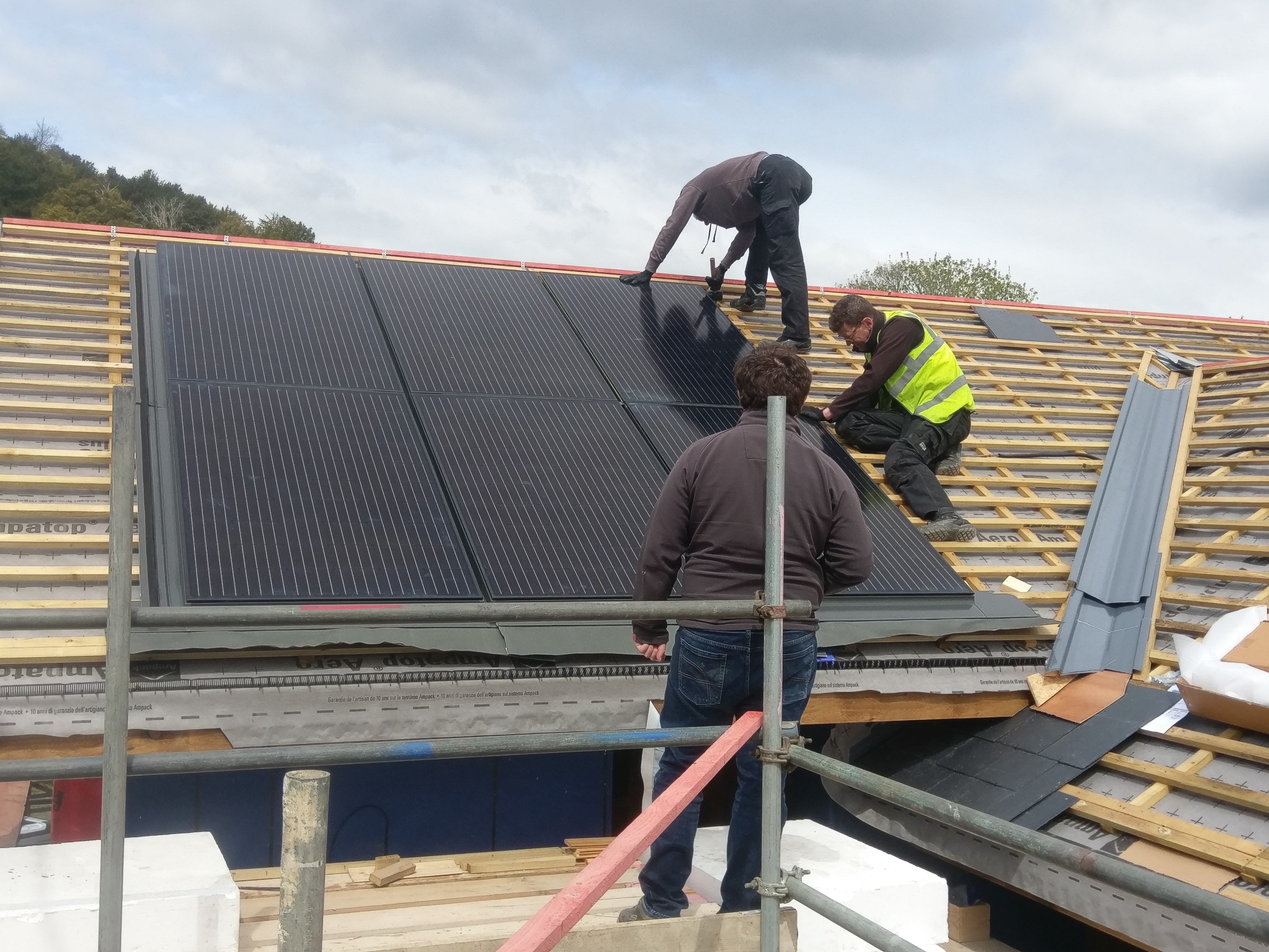

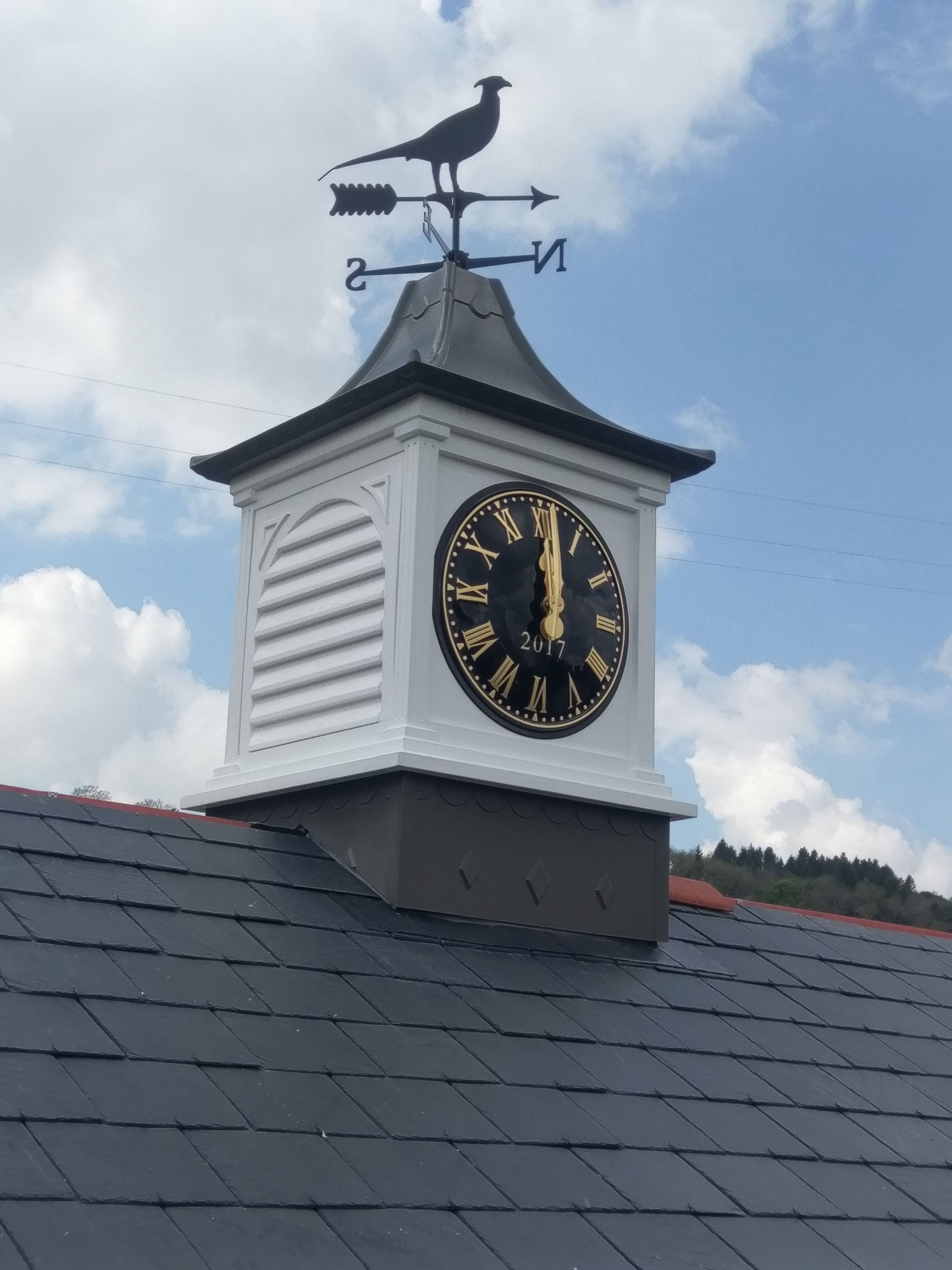

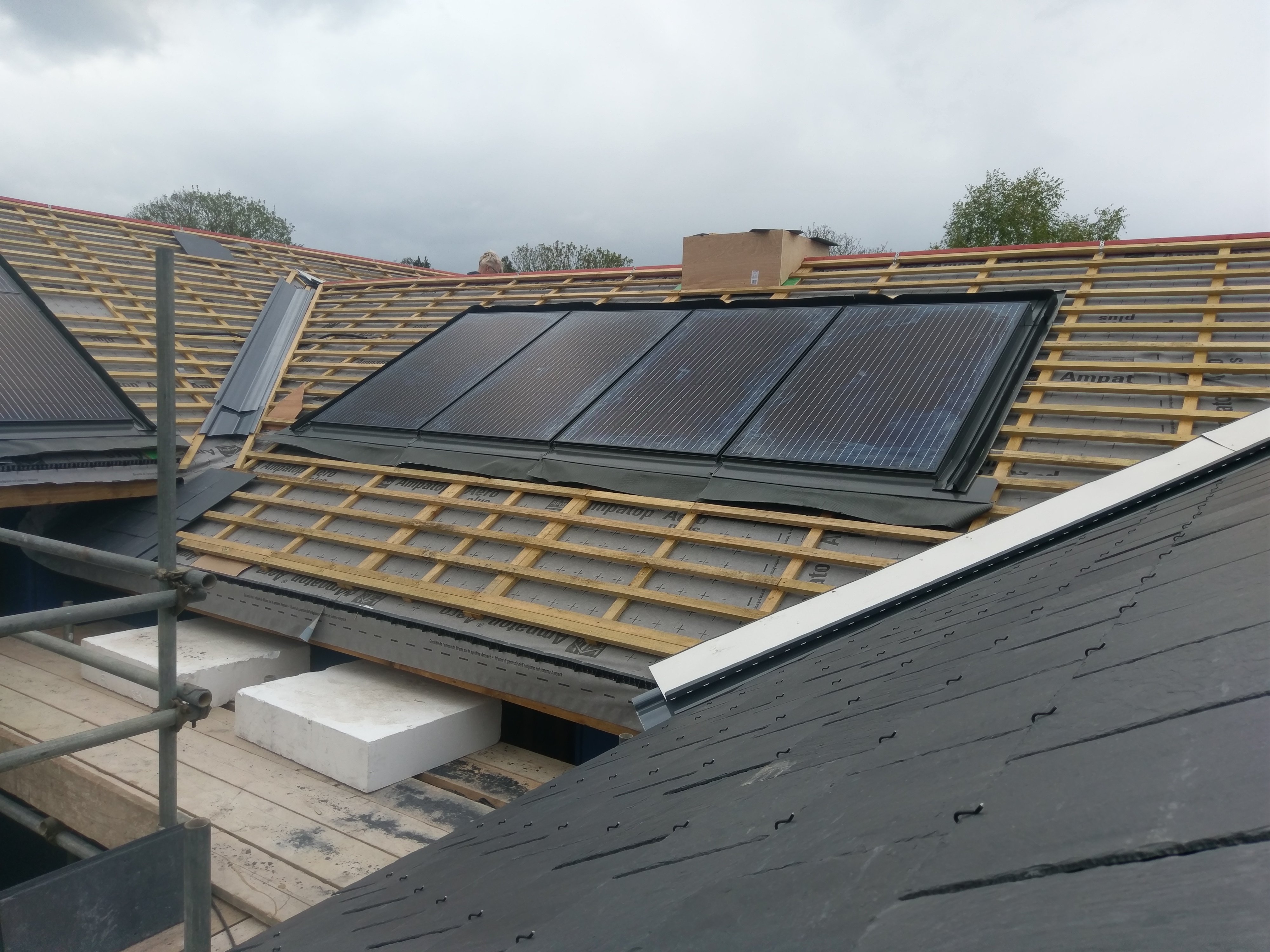

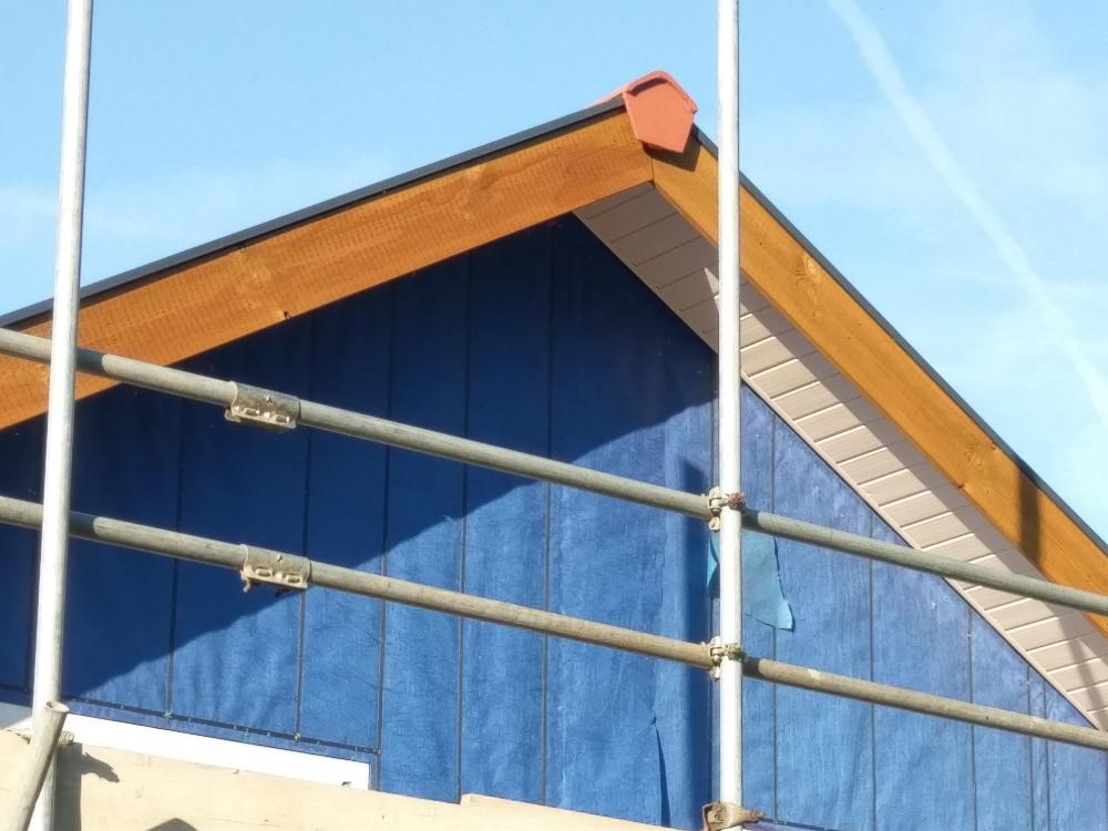

dogman Posted May 3, 2017 Author Share Posted May 3, 2017 Quick update for those interested Had a delay in the solar panels (importer not fitter) Fitted last week so can now finish the roof Not only that but the cupola was two weeks late. managed to get it up and fitted after the panels Hopefully will get the roof finished this week. Other delays are the windows. Munster shut for Easter and could only carry out the site visit on the 26th. Announced that the two week wait is now at least 5 weeks. Not happy. 3 Link to comment Share on other sites More sharing options...
Barney12 Posted May 3, 2017 Share Posted May 3, 2017 16 minutes ago, dogman said: Quick update for those interested Had a delay in the solar panels (importer not fitter) Fitted last week so can now finish the roof Not only that but the cupola was two weeks late. managed to get it up and fitted after the panels Hopefully will get the roof finished this week. Other delays are the windows. Munster shut for Easter and could only carry out the site visit on the 26th. Announced that the two week wait is now at least 5 weeks. Not happy. Well I never knew they were called Cupola's! How do you wind the clock and does it chime? I feel your pain regarding windows, the manufacturers all seem to work in a different time zone! Link to comment Share on other sites More sharing options...
dogman Posted May 3, 2017 Author Share Posted May 3, 2017 I was trying to be posh Clock is synchronised to something??? so should never need changing. even updates after powercuts. Could have had a chime but didn't want to annoy the neighbours Link to comment Share on other sites More sharing options...
Onoff Posted May 3, 2017 Share Posted May 3, 2017 4 minutes ago, dogman said: I was trying to be posh Clock is synchronised to something??? so should never need changing. even updates after powercuts. Could have had a chime but didn't want to annoy the neighbours Syncs with the National Physics Lab's "atomic clock" time signal I think. Link to comment Share on other sites More sharing options...

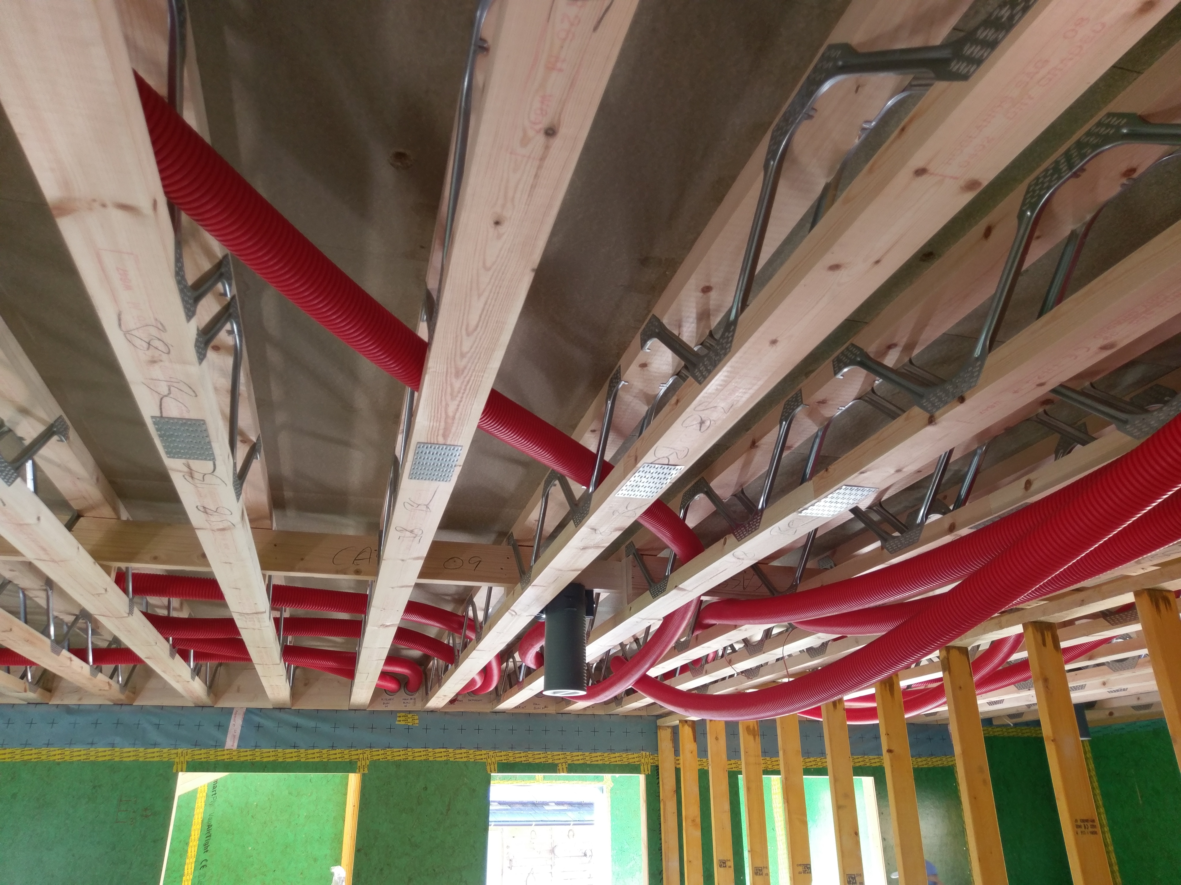

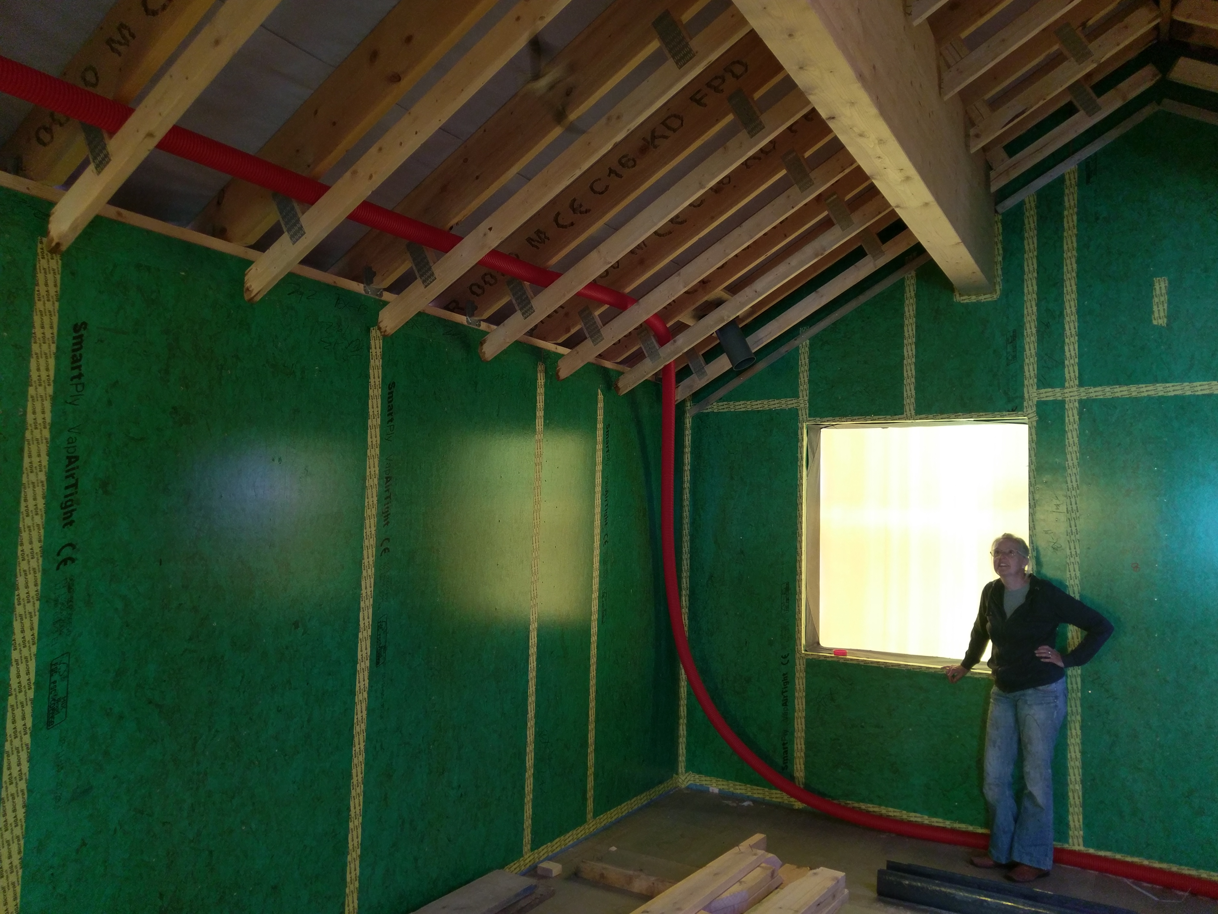

dogman Posted May 14, 2017 Author Share Posted May 14, 2017 Spent the afternoon playing with my big red snake Had to get wife to help by pulling it. Got a big problem with swallows. The birds that is. Decided they like the house and want to move in 3 Link to comment Share on other sites More sharing options...

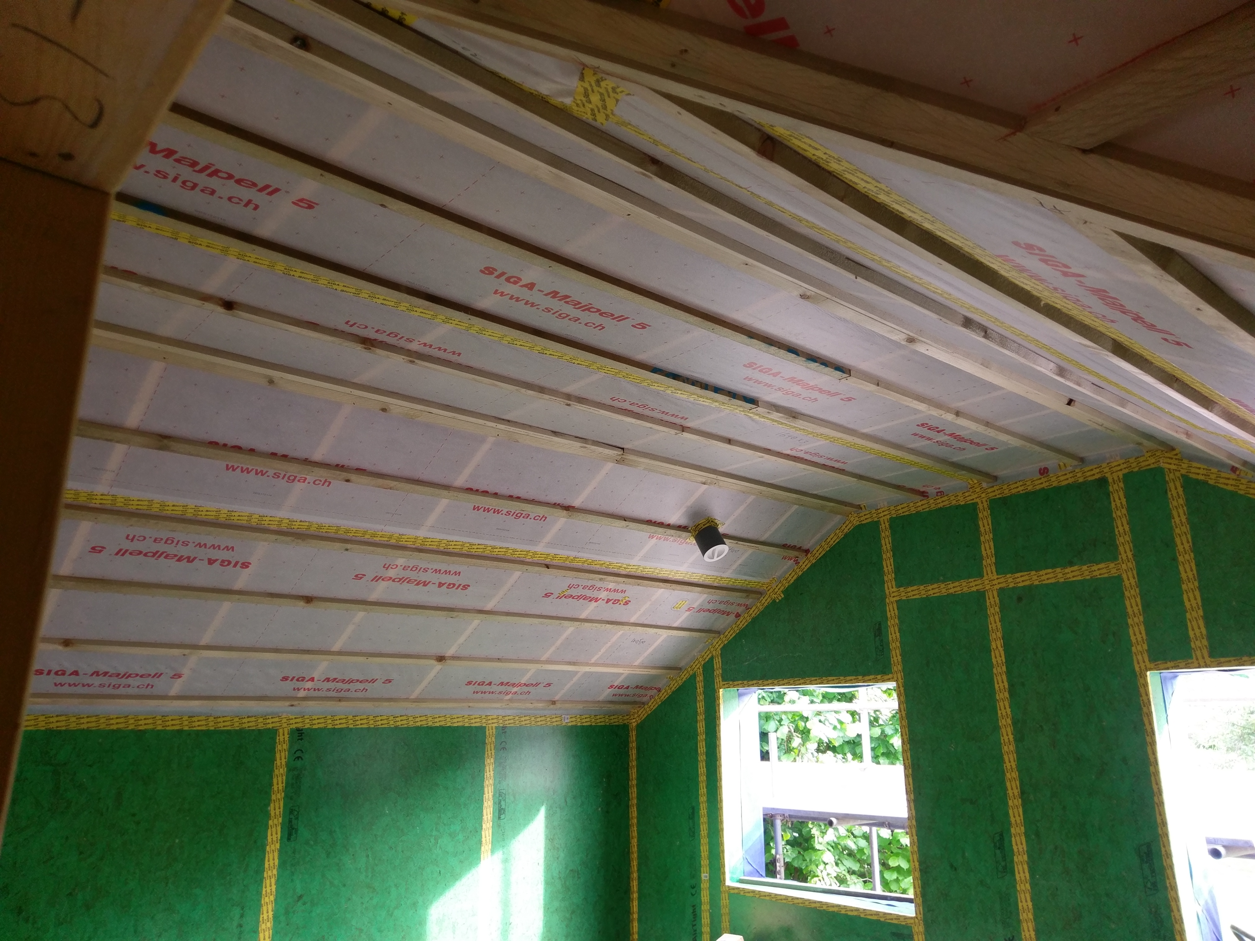

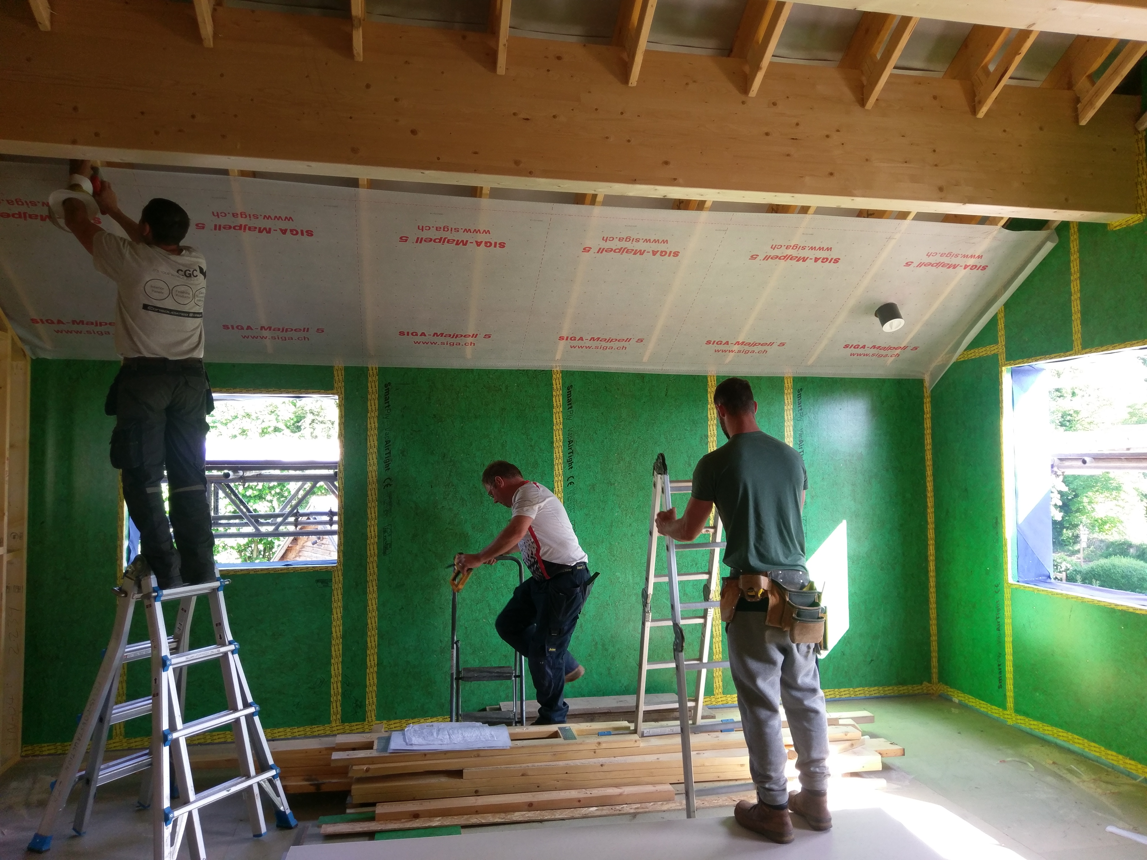

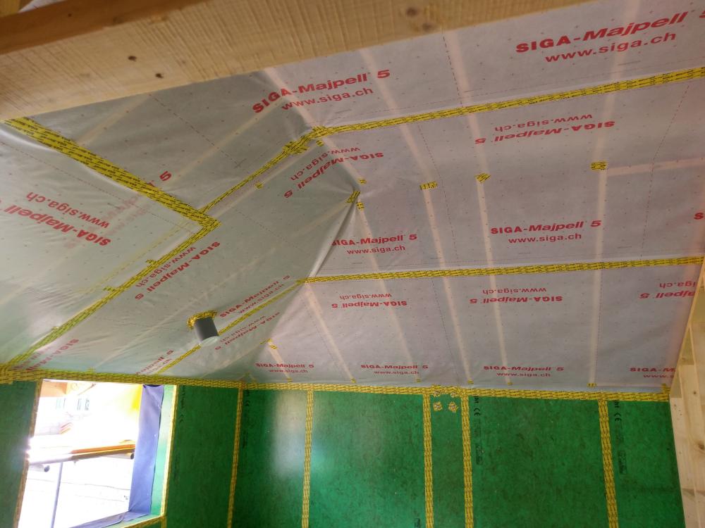

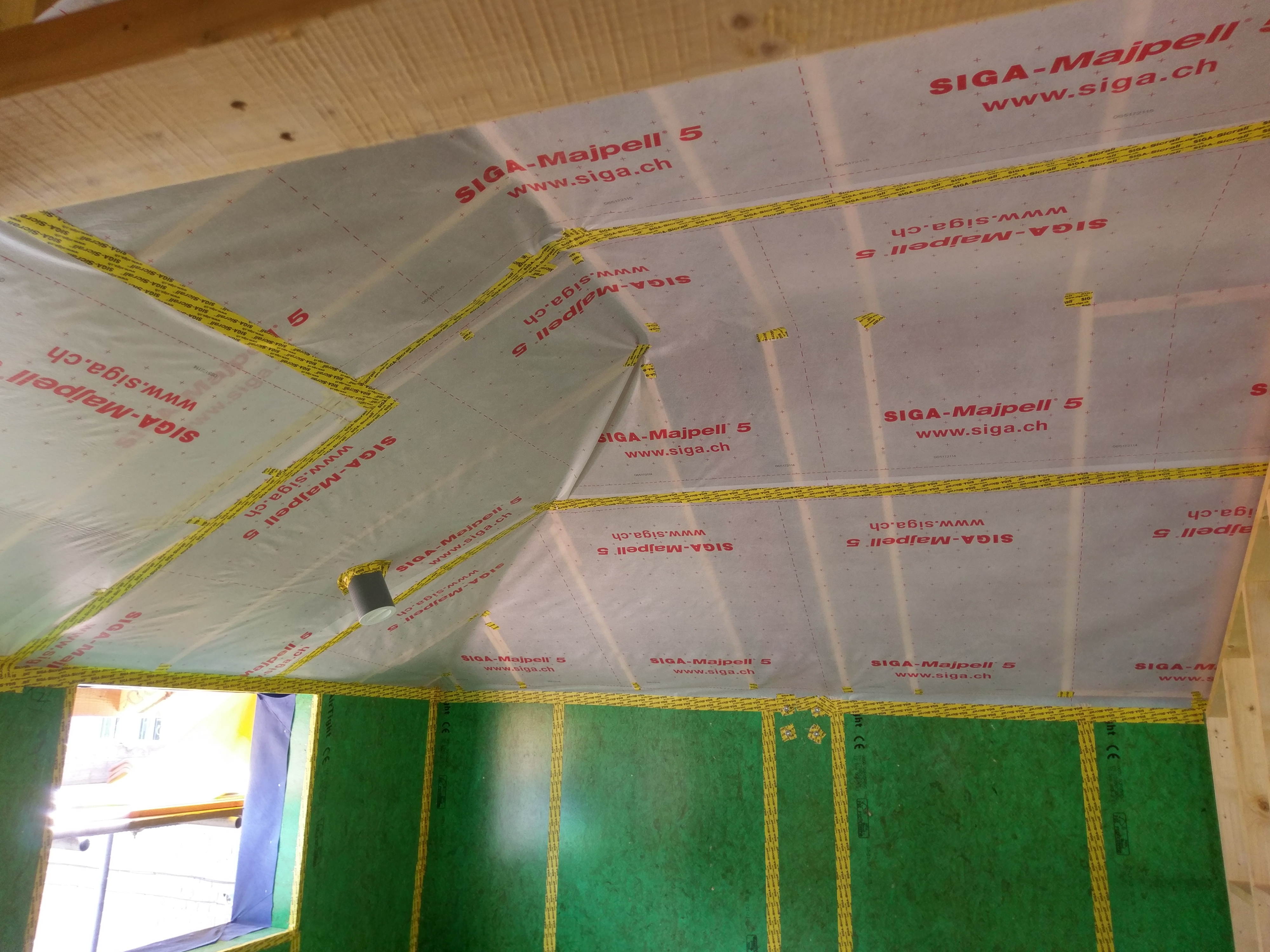

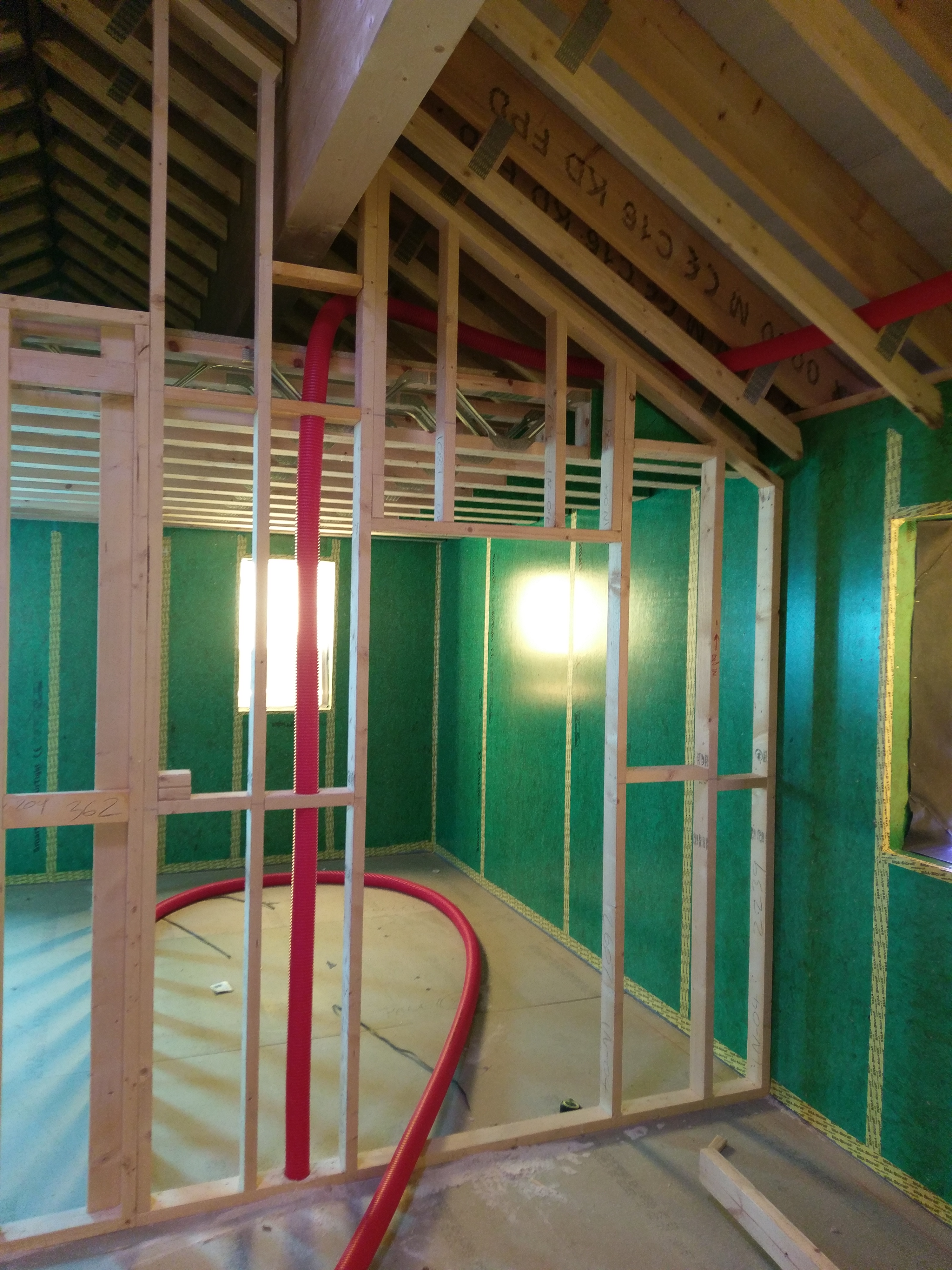

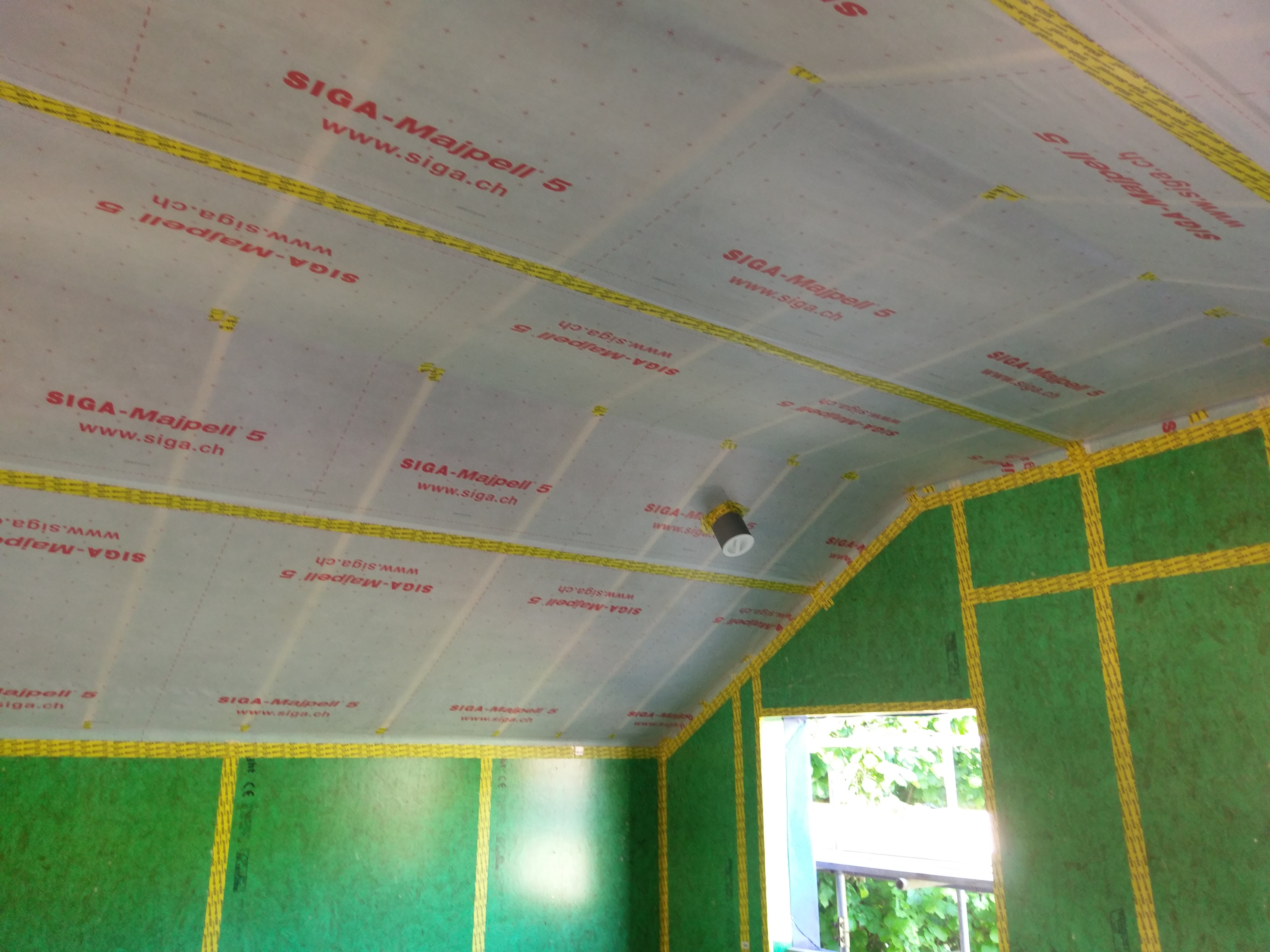

dogman Posted May 27, 2017 Author Share Posted May 27, 2017 Had MBC on site again today. Having finished the MVHR pipe work they wanted to install the membrane and battens inside We now have 2 very angry swallows who need to find a new roost. At least they didn't get chance to build a nest 4 Link to comment Share on other sites More sharing options...

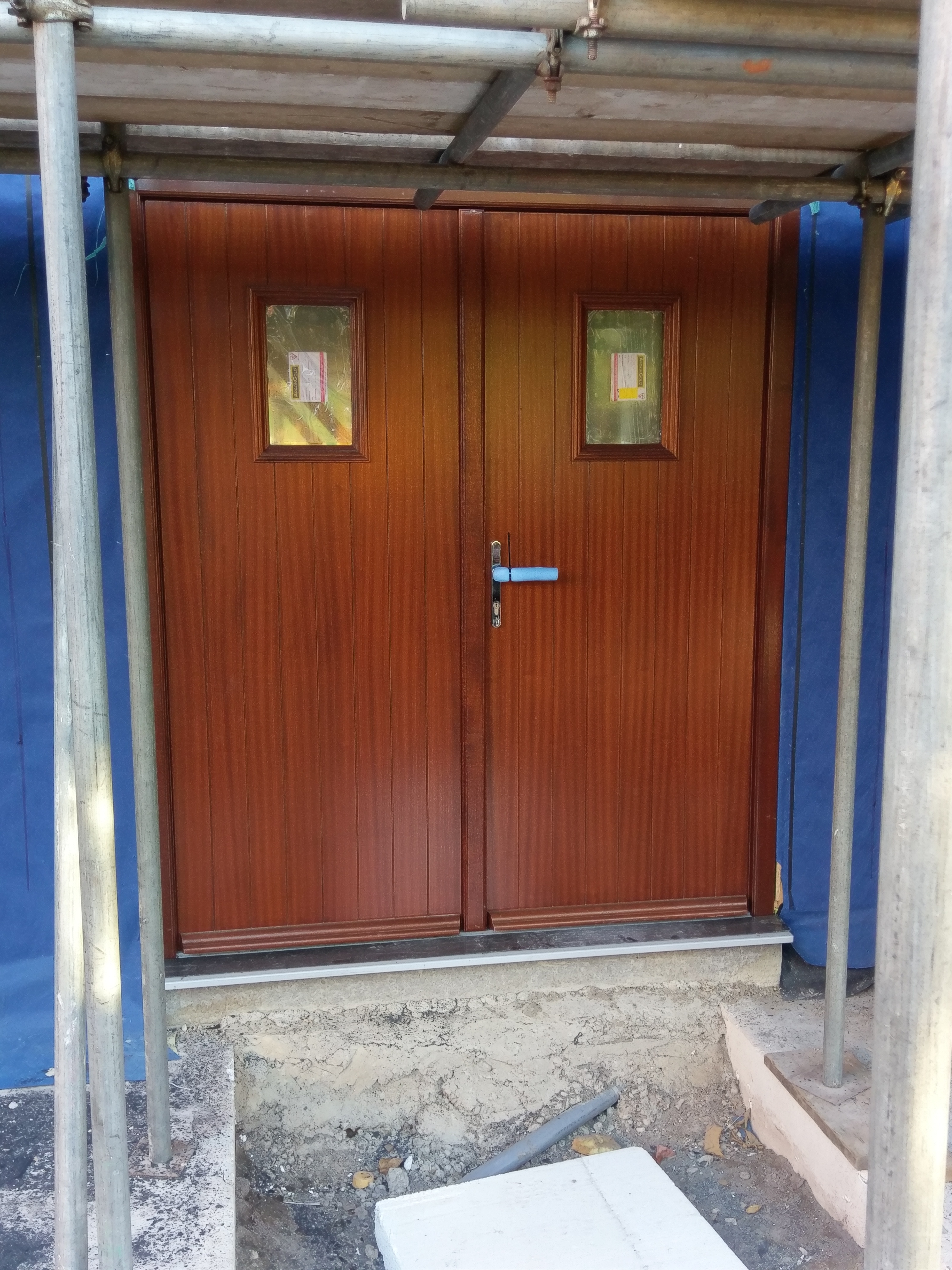

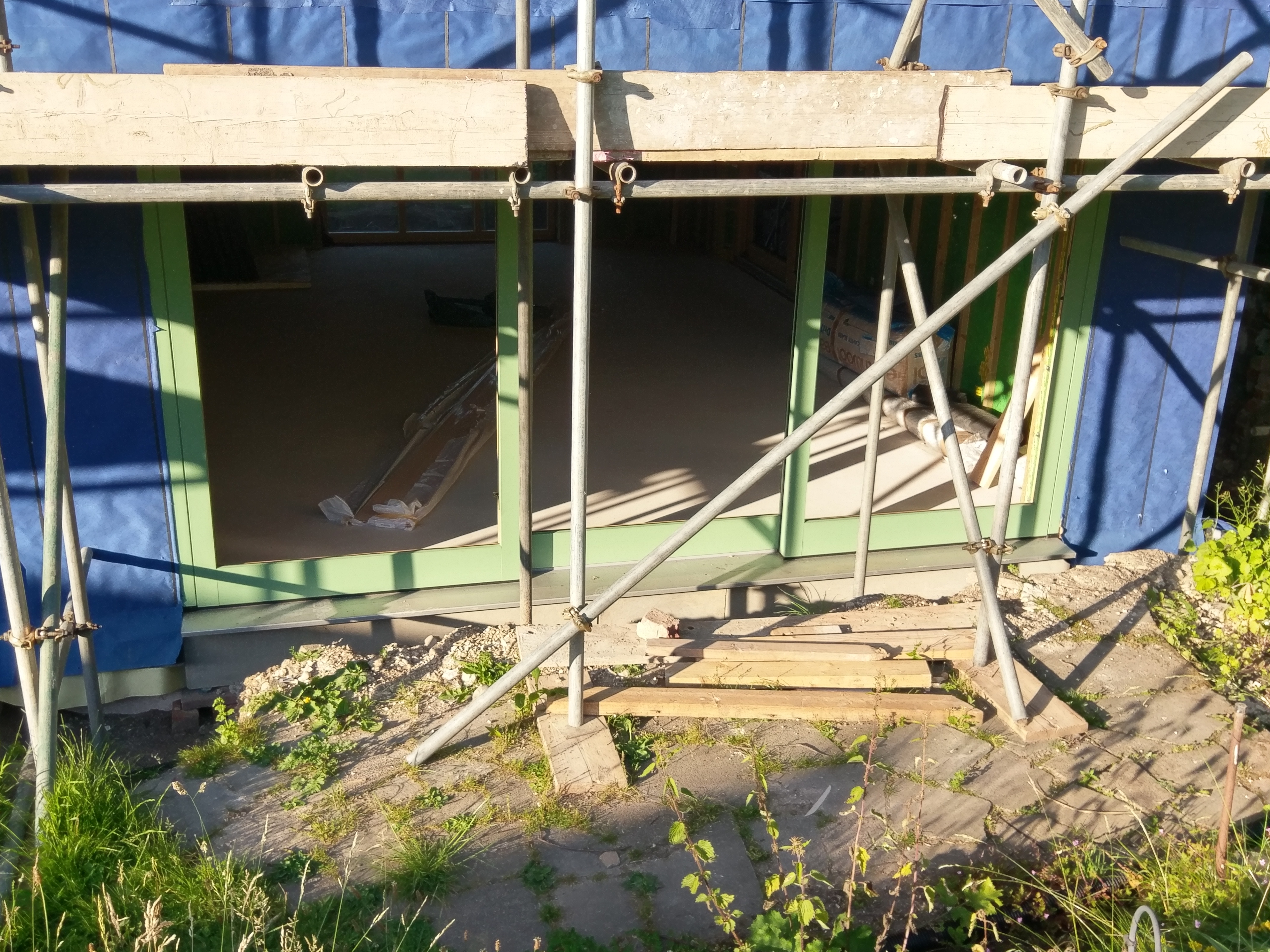

dogman Posted June 17, 2017 Author Share Posted June 17, 2017 So its been a few weeks since I posted an update. Frame is 90% battened and sealed. MBC left as windows and doors had not been fitted. Roof is finished including gutters fascias and soffits etc. The windows and doors are a different matter. Its been and still is a bit stressful. Don't want to say much as it is still ongoing. Do have a couple of pics. Hopefully we will make some progress with the windows and doors next week. As you can see with the sliding doors there is no glass fitted so house is not secure. As we have night time visitors i dont want to order in equipment until it is. 1 Link to comment Share on other sites More sharing options...
PeterW Posted June 17, 2017 Share Posted June 17, 2017 Are you having blown in cellulose insulation ..? Link to comment Share on other sites More sharing options...
dogman Posted June 17, 2017 Author Share Posted June 17, 2017 (edited) Yes i am. is this a fire question Edited June 17, 2017 by dogman Link to comment Share on other sites More sharing options...
jamiehamy Posted June 17, 2017 Share Posted June 17, 2017 Another doors and windows saga. :-( good luck. Mine lasted 9 months, if you need a sounding board drop me pm. Link to comment Share on other sites More sharing options...
PeterW Posted June 17, 2017 Share Posted June 17, 2017 1 hour ago, dogman said: Yes i am. is this a fire question No I just wondered with the MVHR pipes going the way they were and how they had finished the ceilings ..! Link to comment Share on other sites More sharing options...
dogman Posted June 17, 2017 Author Share Posted June 17, 2017 I think it was @Mikey_1980, who put me on to the pipes in the insulation layer. Mbc were quite happy and have sealed the pipes as they go through the air tight membrane Link to comment Share on other sites More sharing options...
