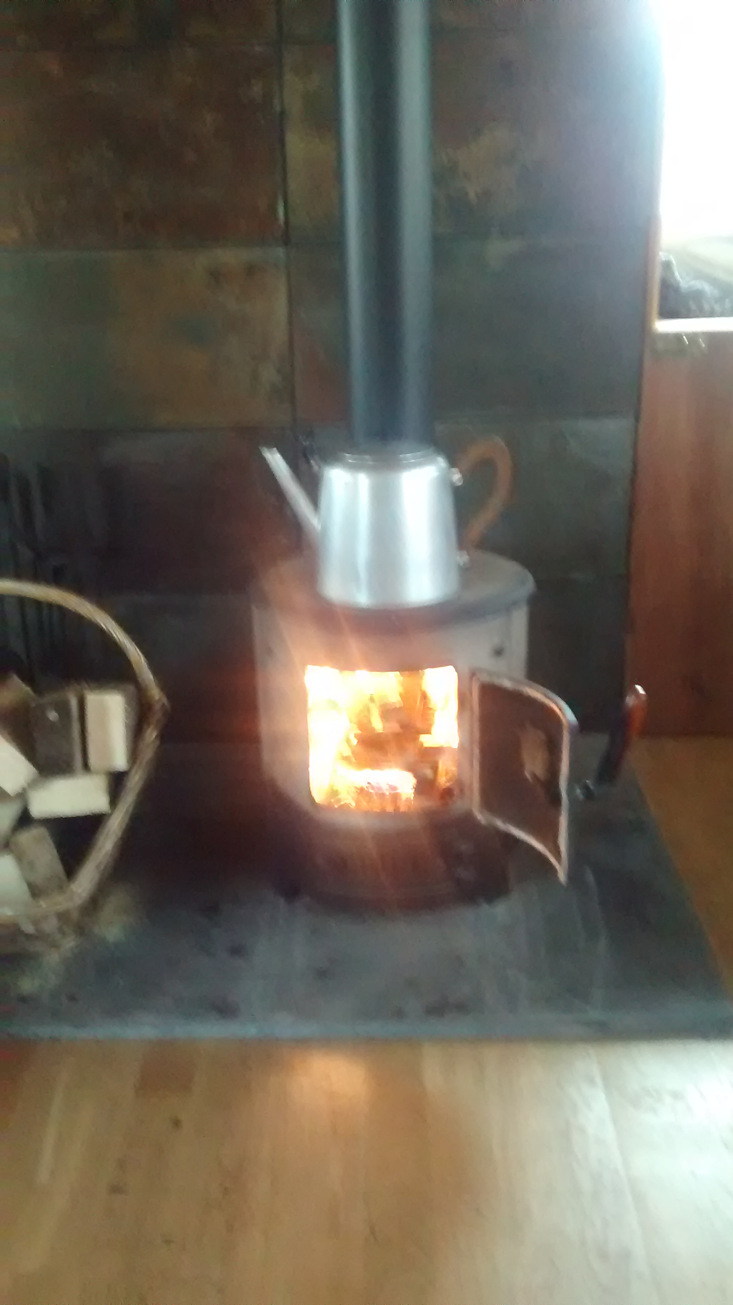

Tennentslager Posted March 7, 2017 Posted March 7, 2017 52 minutes ago, gravelld said: It would be interesting to know the test process stove manufacturers go through to derive the efficiency figures, assumptions made, and so on. I've seen maybe 20 stoves up at our hutting fraternity. In general...cold weather, poor insulation...folk want maximum output. My observations are that new stoves which equals very expensive; are fantastic to look at ( big glass and slow flickering burn) but don't pump out much heat. No great surprise as most have ceramic or fire brick lining on the inside to aid the fire temperature so less heat radiating through the stove wall. Mine on the other hand was £250 from machine mart and rated at 11kw. Probably because it's just 4 bits of cast iron bolted together. However it is fantastic for keeping the place toasty. Internal temperature is regulated by a combination of fuel type, control of the rudimentary stove vent and choosing which windows to open and how wide.? I'd call it stove art. Putting it in the middle of the floor must help too, instead of heating up the inglenook walls...horses for courses passivers? 1

ProDave Posted March 7, 2017 Posted March 7, 2017 @Tennentslager Are you saying your cheap Machine mart stove is just a "tin box" with no fire bricks to line the fire box? I am thinking SWMBO is thinking of a WBS for our static 'van, but I don't like the idea of one with no fire bricks as surely the sides and back will get much hotter?
Tennentslager Posted March 7, 2017 Posted March 7, 2017 43 minutes ago, ProDave said: @Tennentslager Are you saying your cheap Machine mart stove is just a "tin box" with no fire bricks to line the fire box? I am thinking SWMBO is thinking of a WBS for our static 'van, but I don't like the idea of one with no fire bricks as surely the sides and back will get much hotter? Yes. My stove thermometer is on the flue about a metre up...usually sits at 200 for dry wood moderately stacked. 100 for coal ticking over. It's a cast iron cylinder (okay it's got a couple of baffles for the exhaust gas) with a door.

Ferdinand Posted March 8, 2017 Posted March 8, 2017 18 hours ago, Tennentslager said: I've seen maybe 20 stoves up at our hutting fraternity. In general...cold weather, poor insulation...folk want maximum output. My observations are that new stoves which equals very expensive; are fantastic to look at ( big glass and slow flickering burn) but don't pump out much heat. No great surprise as most have ceramic or fire brick lining on the inside to aid the fire temperature so less heat radiating through the stove wall. Mine on the other hand was £250 from machine mart and rated at 11kw. Probably because it's just 4 bits of cast iron bolted together. However it is fantastic for keeping the place toasty. Internal temperature is regulated by a combination of fuel type, control of the rudimentary stove vent and choosing which windows to open and how wide.? I'd call it stove art. Putting it in the middle of the floor must help too, instead of heating up the inglenook walls...horses for courses passivers? Where are the Sheriff and the Enamel Mug? F
