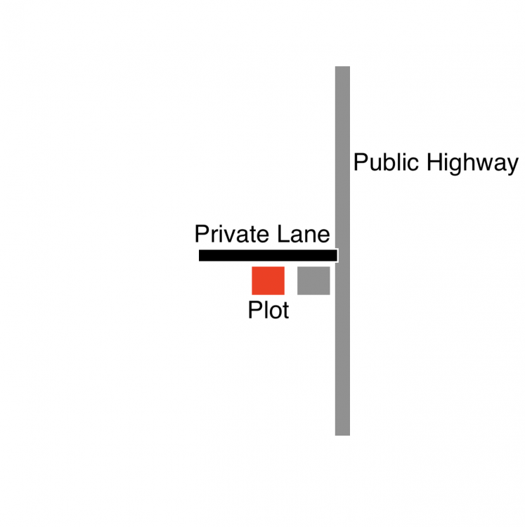

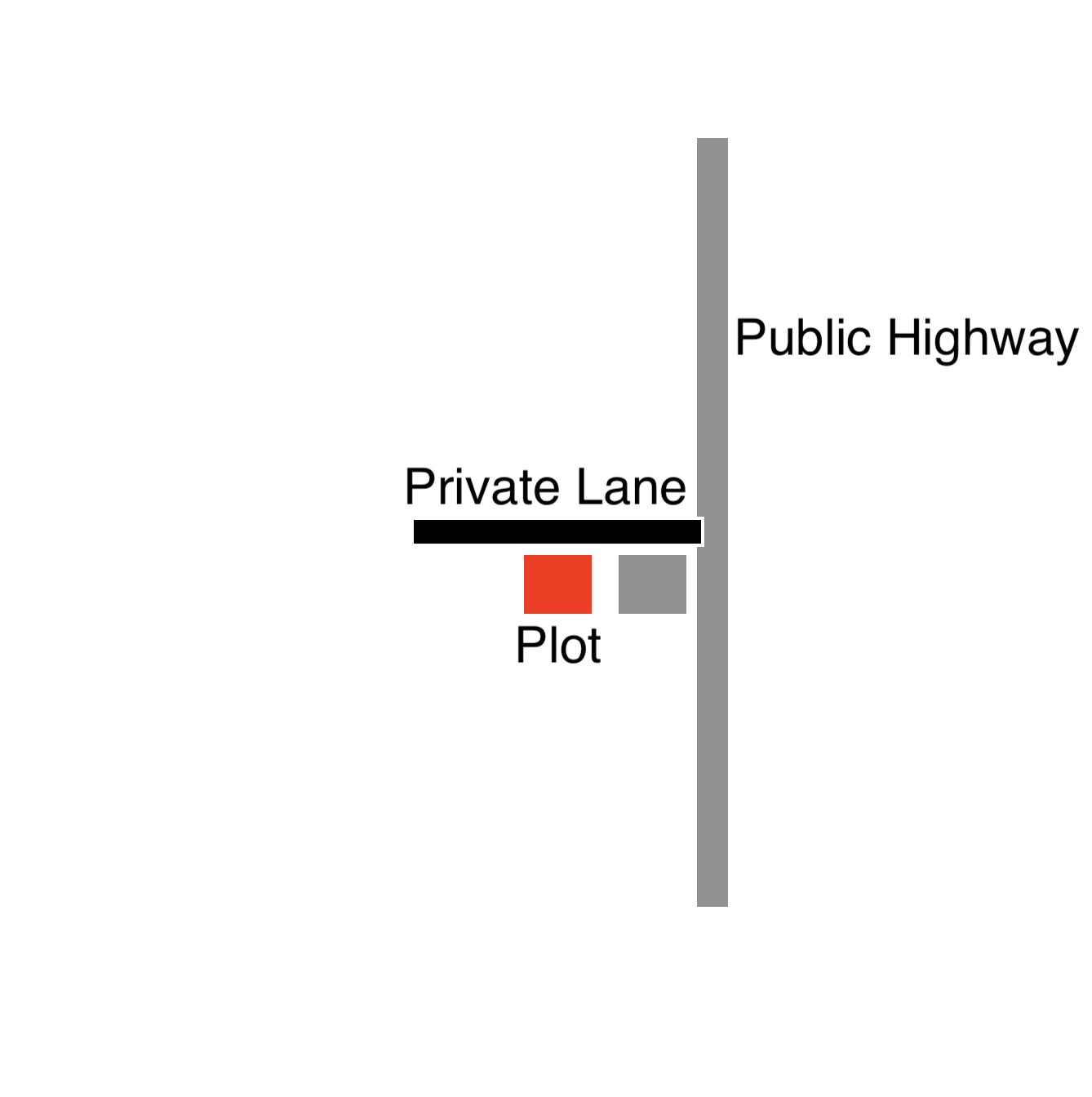

wbc978 Posted May 31, 2021 Author Share Posted May 31, 2021 Thanks all for your input! Just to clarify, I know a static caravan would be a perfectly safe, comfortable solution. My concern is my very curious, active toddler wreaking havoc on a building site! All the fencing and safety measures in the world couldn't contain my bundle of energy :) Another question - I've just found out the street this plot is on is a private lane owned by the next door neighbour. The title deed says the maintenance is split five ways between the five houses in the lane. My question is - what does this mean for building works access? I would obviously ask permission from the lane owner. But what other obstacles are inherent when building works happen on a private lane? Link to comment Share on other sites More sharing options...
Big Jimbo Posted May 31, 2021 Share Posted May 31, 2021 Be wary of the "private lane" when you have finished bringing all your heavy lorries up and down, they will want you to re do the private lane. New tarmac, sub base etc, could cost you thousands, and then some. Link to comment Share on other sites More sharing options...
wbc978 Posted May 31, 2021 Author Share Posted May 31, 2021 15 minutes ago, Big Jimbo said: Be wary of the "private lane" when you have finished bringing all your heavy lorries up and down, they will want you to re do the private lane. New tarmac, sub base etc, could cost you thousands, and then some. Ah I was afraid of that. We may need to pass this one up then. Gutted. Oh well, onto the next plot... Link to comment Share on other sites More sharing options...
Big Jimbo Posted May 31, 2021 Share Posted May 31, 2021 May not be a deal breaker, but you would defo need to sort out what they would expect from you with regards the lane at the end of your build. Link to comment Share on other sites More sharing options...
SteamyTea Posted May 31, 2021 Share Posted May 31, 2021 42 minutes ago, wbc978 said: My concern is my very curious, active toddler wreaking havoc on a building site! All the fencing and safety measures in the world couldn't contain my bundle of energy Disciplinary smacking would though. 1 Link to comment Share on other sites More sharing options...
wbc978 Posted May 31, 2021 Author Share Posted May 31, 2021 (edited) 1 hour ago, Big Jimbo said: May not be a deal breaker, but you would defo need to sort out what they would expect from you with regards the lane at the end of your build. On that note, the property isn't far from a public access road with parking. Do delivery drivers need access to drive right up to the site? How close do they need to be? I've attached a very rough drawing to illustrate the location (thanks MS Paint!). They would have plenty of room to park on the public road if they could walk a little bit? That way, they wouldn't need to park big lorries on the private road. Edited May 31, 2021 by wbc978 Link to comment Share on other sites More sharing options...
Big Jimbo Posted May 31, 2021 Share Posted May 31, 2021 There will be a lot of deliveries to your site in order to build your house. There are not going to be able to drop them out on the road. How are you going to get the digger in to do your footings ? Link to comment Share on other sites More sharing options...
