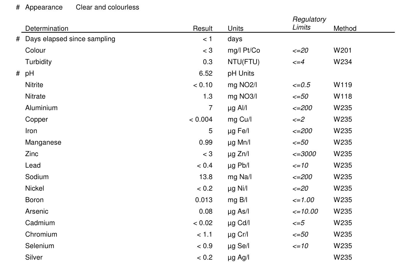

Hastings Posted February 11, 2022 Posted February 11, 2022 (edited) @saveasteading Would appreciate any progress info on this subject as I am working on a rainwater-only supply. My system needs a risk assessment and approval by the council - a condition on my planning approval. Rainwater doesn't seem to need much serious filtering compared to most boreholes and surface/burn waters in these parts. They often fail on levels Iron/Manganese and colour. To pass regulations, as well as the usual UV and sediment and perhaps carbon filters needed for all types of source, the key things for rain water seem to be pH probably needs raising a little (there's a filter that) care to remove particularly organic matter before storage to prevent stagnation (anaerobic decomposition). prevention of bird excrement (dissolved chemicals can't easily be removed later by filters) - can be solved by fitting bird spikes on the roof ridge. a first flush device discards the first few litres collected (think mini pre-tank) I don't think for me that it will be worth having separate plumbing for toilet flushing as the house is only 1.5 bedrooms and there would be little or no saving in the filtering costs (we have no mains available). Edited February 11, 2022 by Hastings

Hastings Posted February 11, 2022 Posted February 11, 2022 41 minutes ago, Nickfromwales said: ( 3 stage filtration with the facility to back-wash etc ) What is the backwash filter you are using? Only ever heard of those for use in borehole and other supplies. I have a borehole but the cost of treating (if it can be achieved at all) looks almost as much as an entire new rainwater only system but will not require nearly so much power or consumables (mainly salt) or leave sodium in the water (bad for babies and some diabetics).
Hastings Posted February 11, 2022 Posted February 11, 2022 2 minutes ago, ProDave said: Each time I read this, I wonder how our relatives in Australia survive with Rainwater as their only source of water for everything * and how when we visit and drink the foul polluted liquid we don't even get a dodgy tummy * If the dry season goes on too long they can buy in a tanker of water to keep them going I think the penny is beginning to drop over here. I've heard of one or two houses in Argyll & Bute being okay'ed by the council for entirely rain water private supplies. I just wish I could get the tech details of them (so I don't have to re-invent that wheel).
