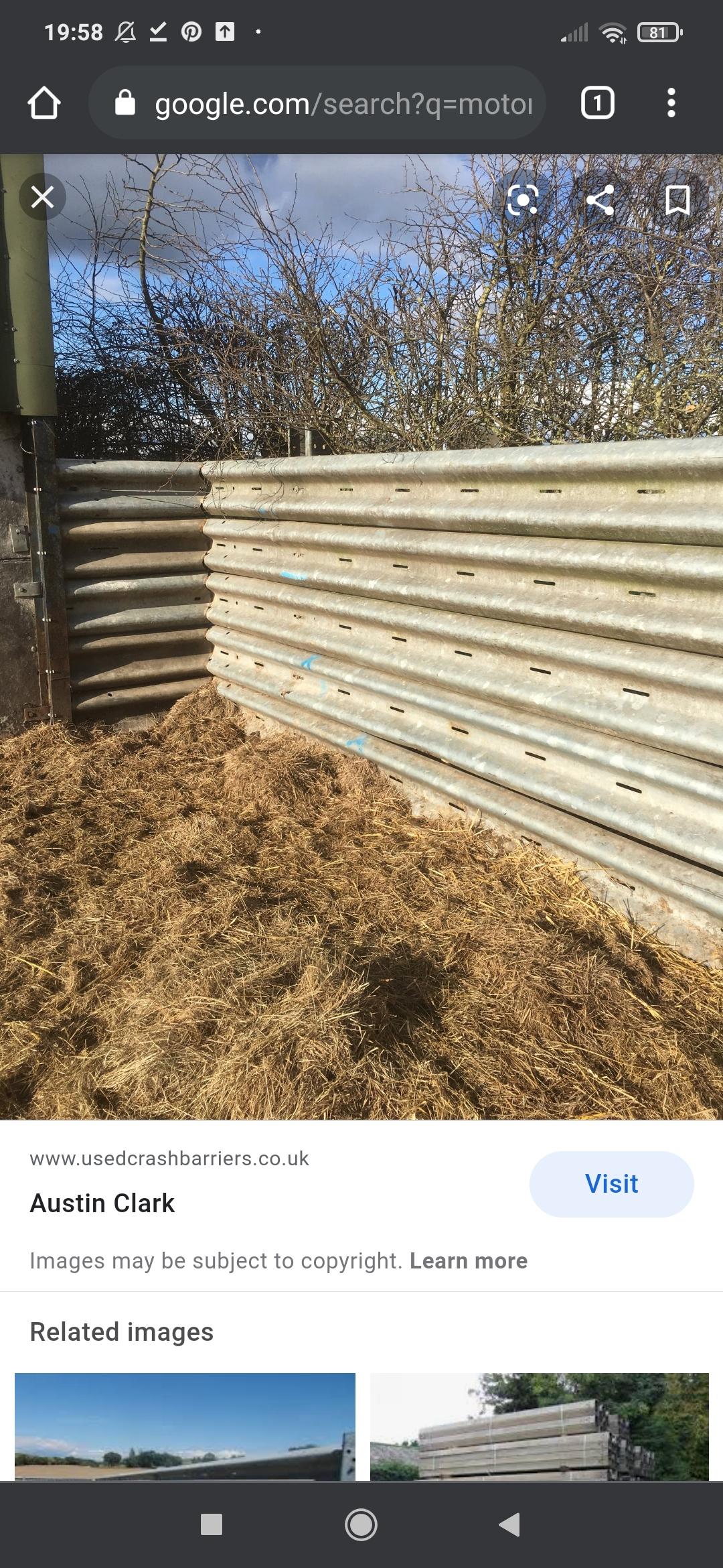

I initially thought my dad may have gone mad when he suggested motorway barriers but it could be a very cost effective method! The only picture I could find to resemble what my dad had in his head was something like this albeit not that high.
Screenshot_2021-04-20-19-58-30-290_com.android.chrome.thumb.jpg.33ff42252b8d1aeb60b7868936470071.jpg

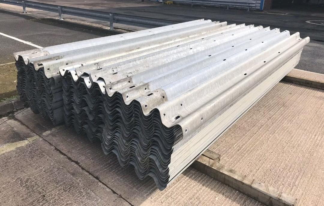

Using something like these which come in varying lengths....
Granted they are certainly not the most attractive thing but painting it perhaps could make them look a bit better and add in some trailing plants we need to move. It certainly could be far cheaper than any other option.

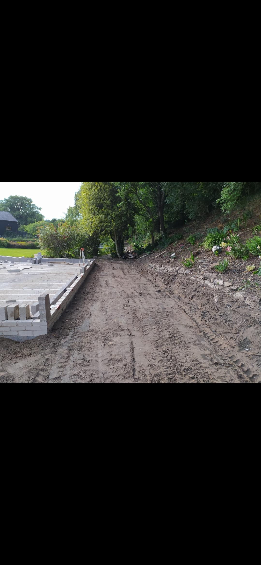

Pic taken of part of the embankment to the right early.on in the build (some trees in front of path were removed). It's not a built wall rather just bits of concrete the previous owners placed on it and in other parts there are sleepers. That is the highest point as some ground was dug out.

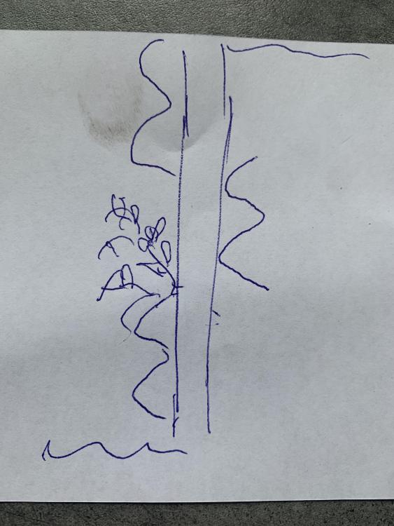

Corrosion resistant, very strong, cheap, easy to install. Sounds like a great idea. And I bet they'd be really easy to clad with timber or plant trellaces. Nice big slots you can bolt through.

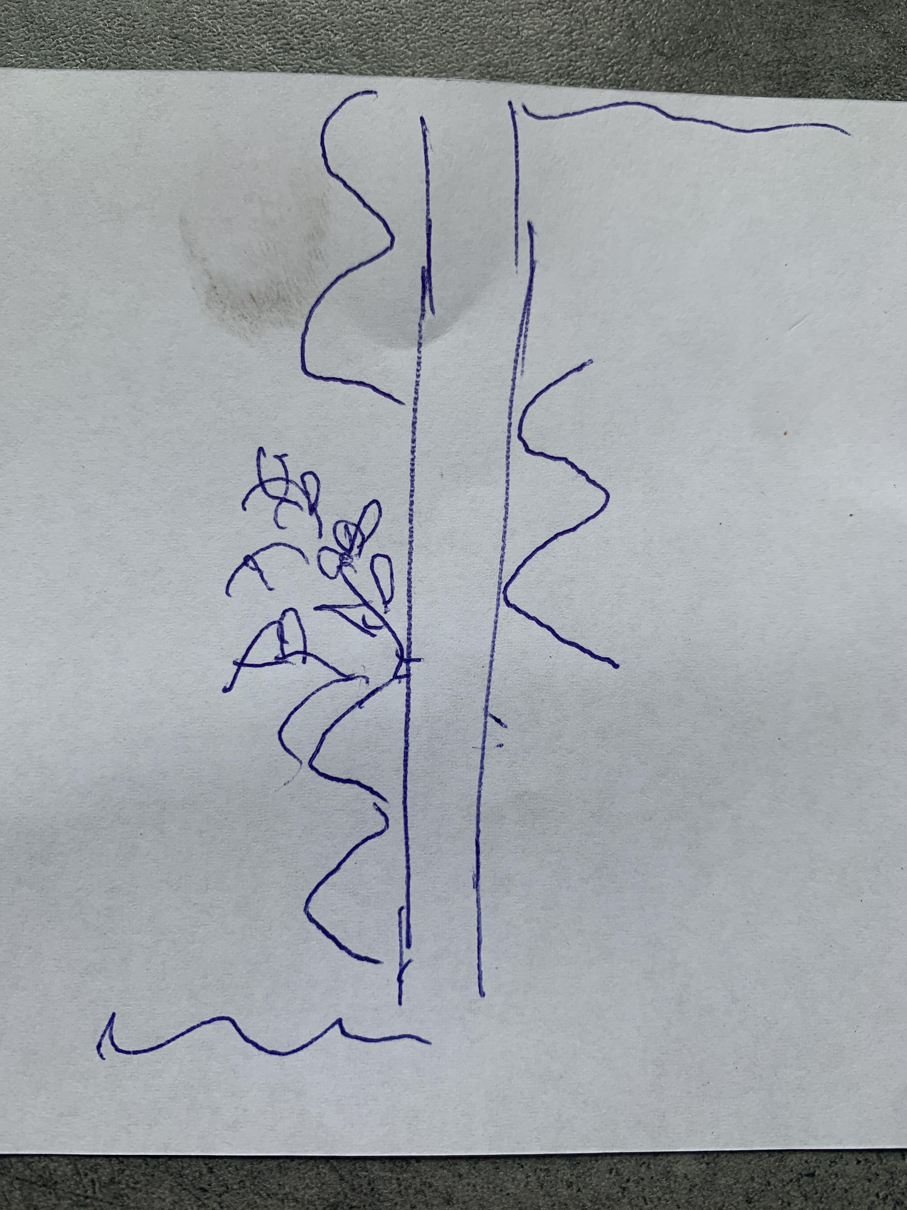

If you alternate them either side of a post then you’ll expose a planting pocket as you go up so can put stuff in them to disguise / hide / make a feature.
Agreed, would look good stepped up the bank to create terraces for planting. If you paint them, make sure you use an etch primer for galvanised steel.
Brilliant idea, certainly strong enough and will last decades, regarding the top of the embankment, if no one else is interested, if you create a “natural” woodland area you could eventually claim vacant possession. We have an old railway line near us and some people have taken over a part next to them and no one seems bothered!
Edited by joe90
I'd put a thick membrane between them and any soil bank.
Sorry what do you mean alternate them? Me and the wife have different interpretations of what we think you mean.
like this

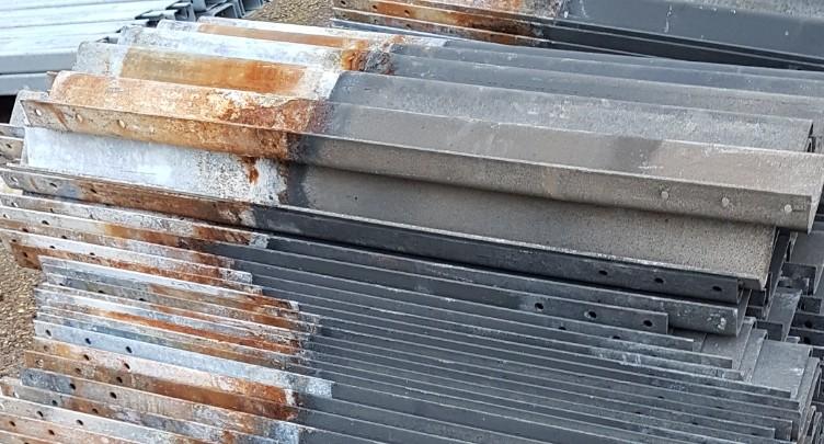

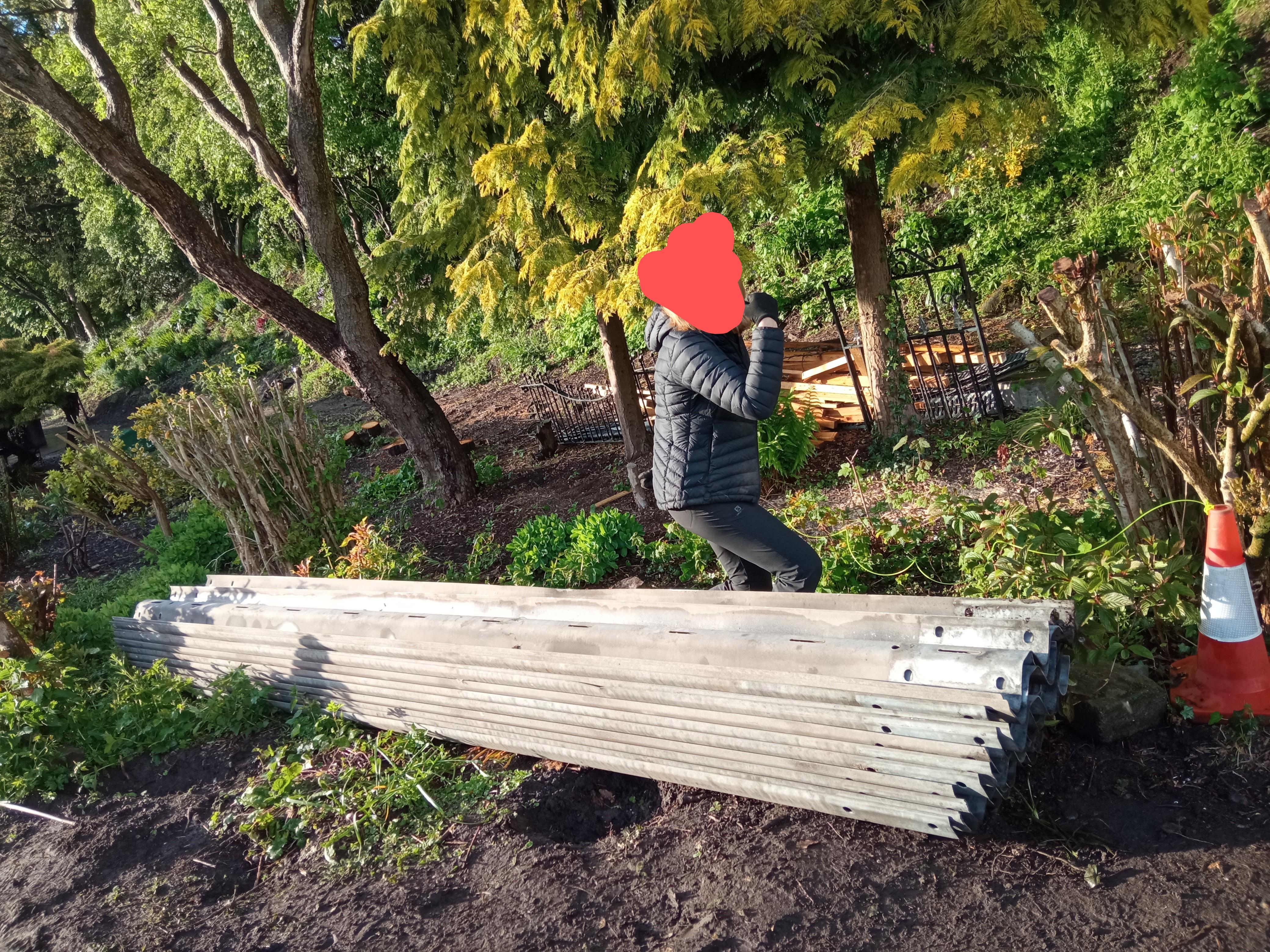

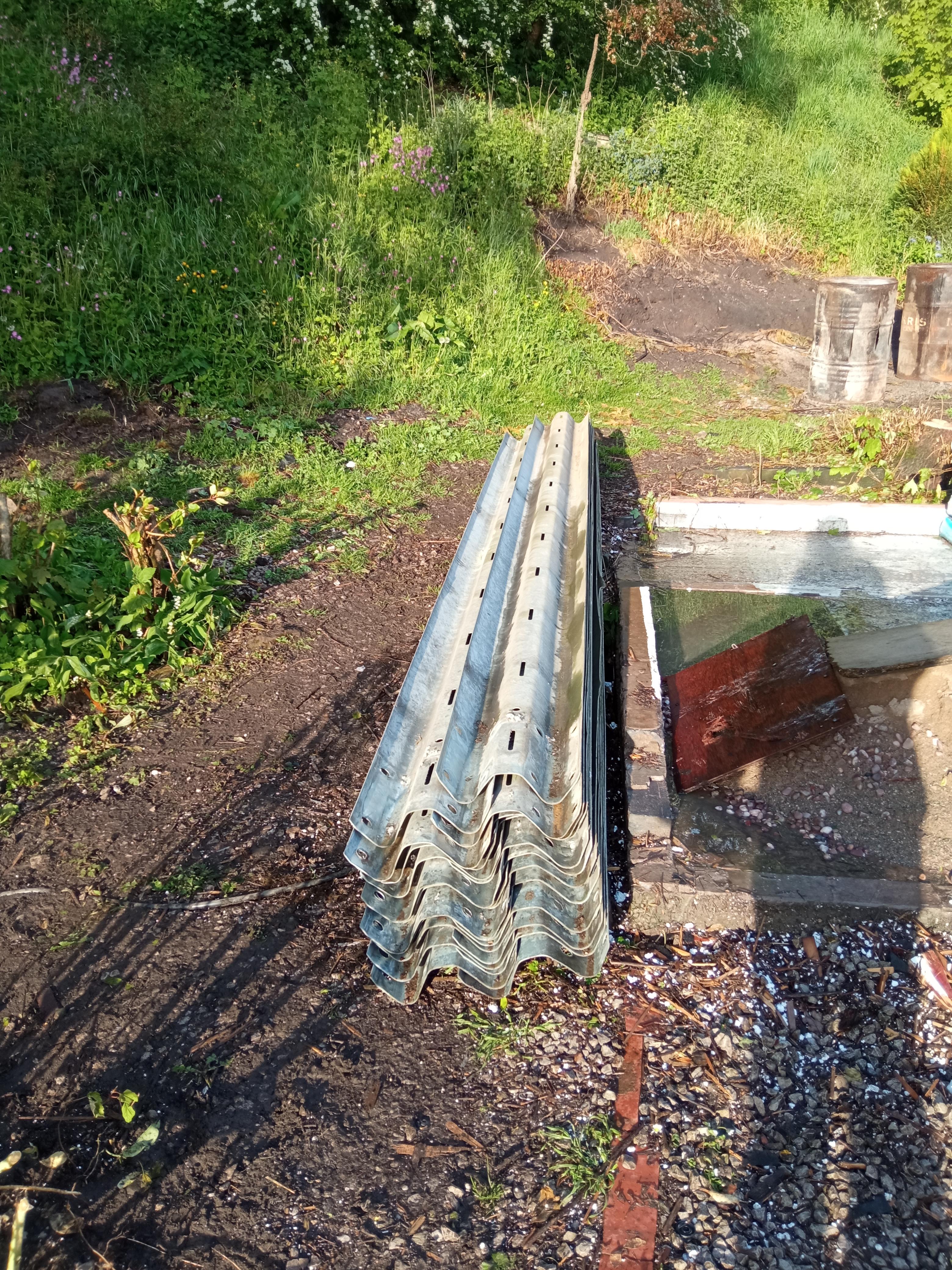

Just unloaded:
47 x 4.3m crash barriers, 20 odd posts and an enormous amount of bolts all for the grand sum of £1500 delivered which was the most cost effective solution we found. Cement and gravel/stone ready and the plan according to dad is to attach some kind of wood to them so it's like picket fencing using some kind of special type of screw (forgot what he said). I've no idea frankly what this will look like but my dad's got a vision and it will look amazing (apparently).....
I sense this is a project @ToughButterCup
would love!
Showing off the muscles after unloading them all!
IMG_20210518_192707.thumb.jpg.d7127ab81f62dbf9f4b1a98086cbdff9.jpgScreenshot_2021-05-18-20-08-26-728_com.google.android_apps.photos.jpg.01eb466a94e97eea6e071ff751b46e63.jpg

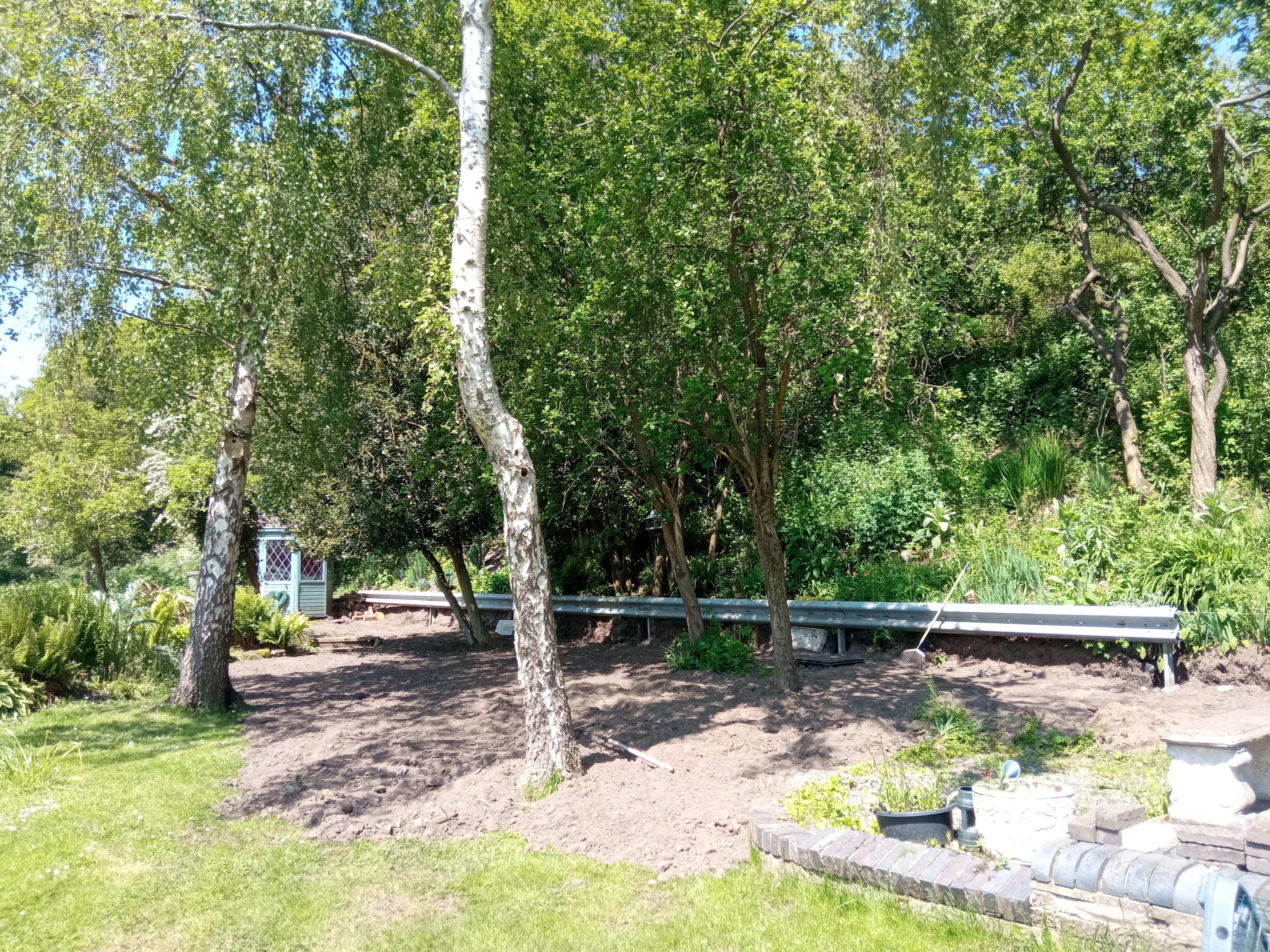

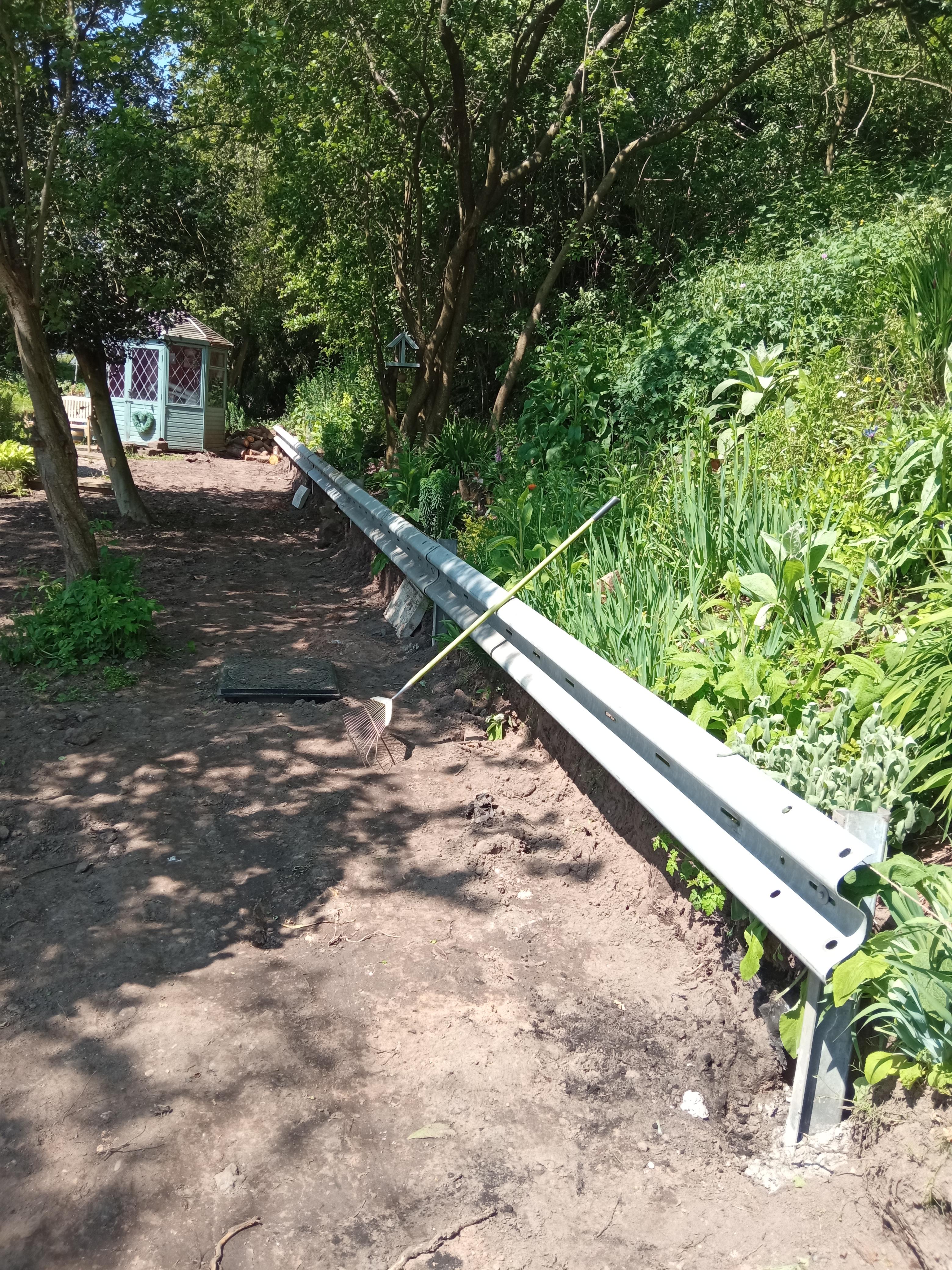

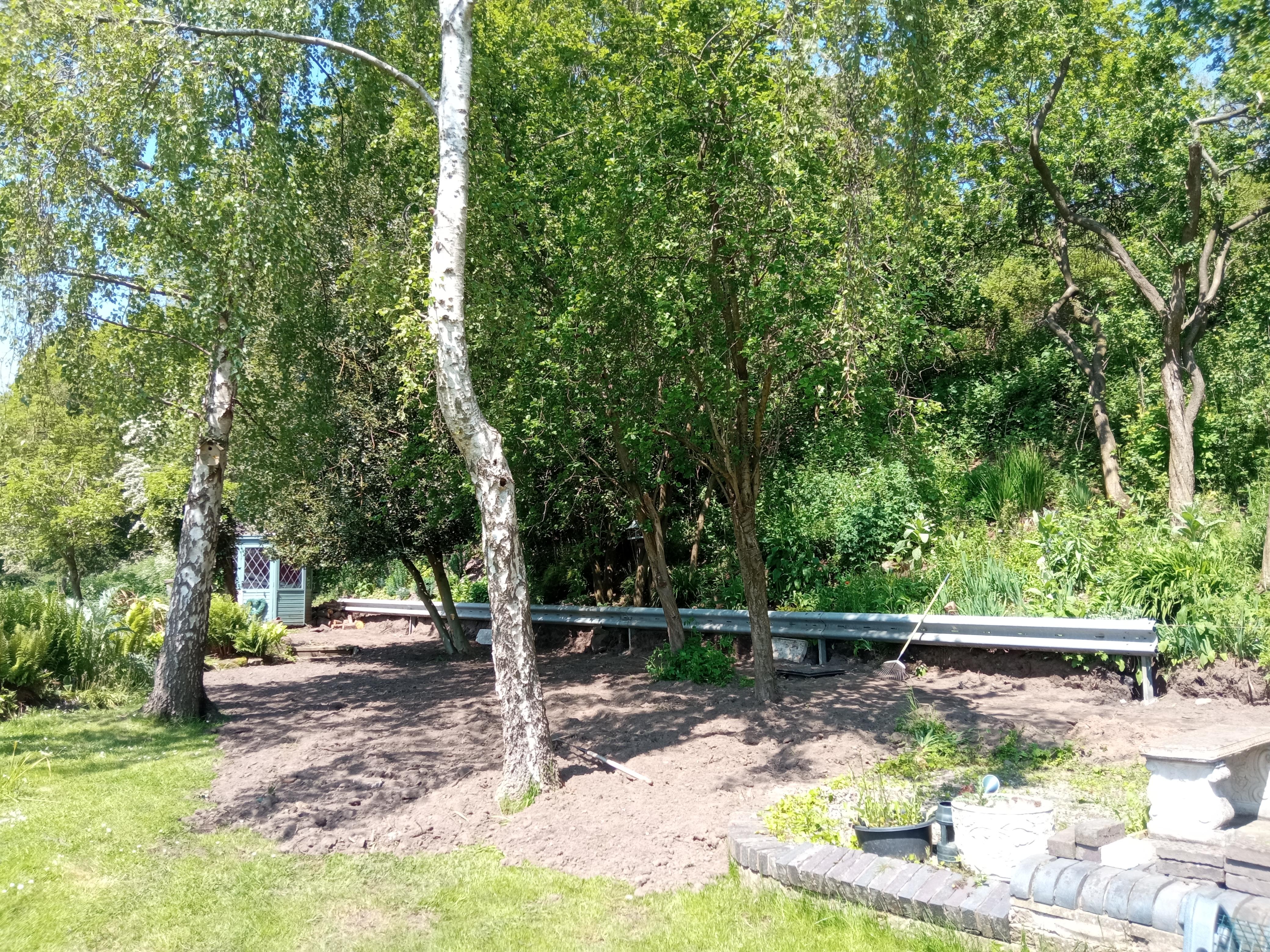

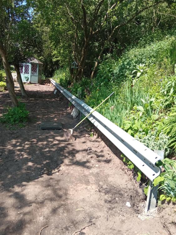

So, put in a few barriers and thought I'd share pictures.
Had quite a few looks from people on the canal at the weekend!

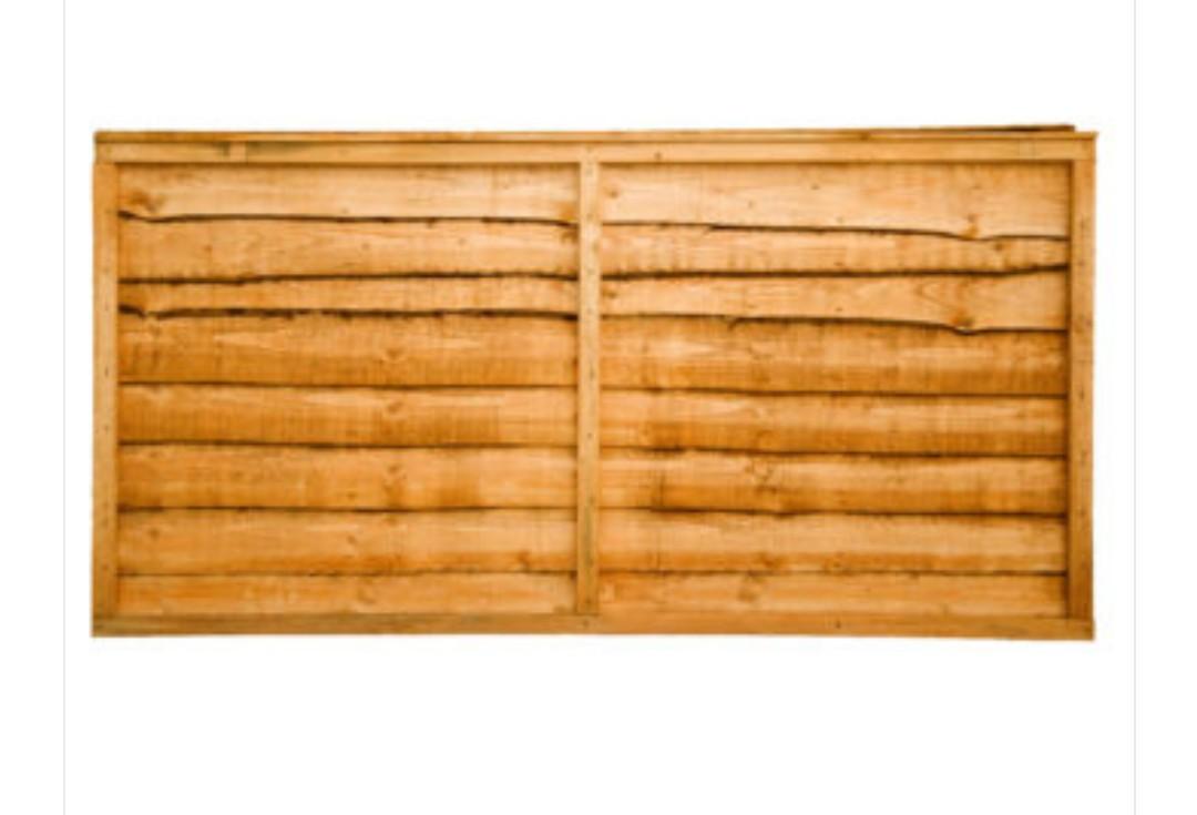

The plan is for them go be two high, so a barrier needs to be on the bottom. Dad is then going to attach some 2ft high panels like this below so you won't see the barriers.
We estimate the total cost will be just over £2500 for the whole 90 metres.
