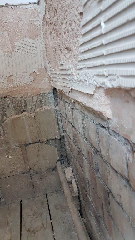

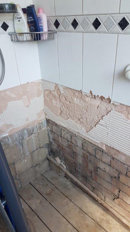

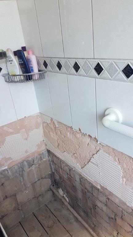

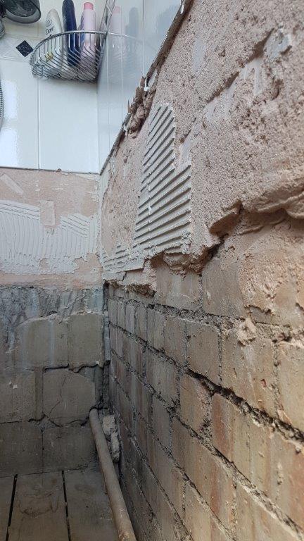

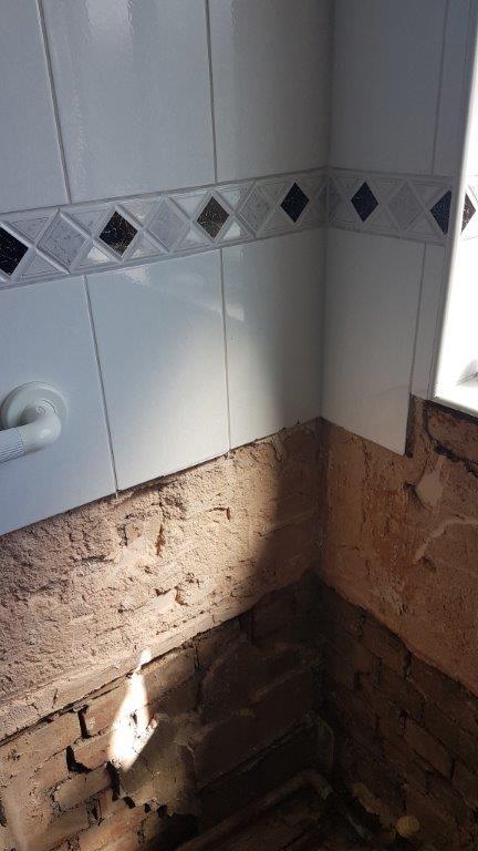

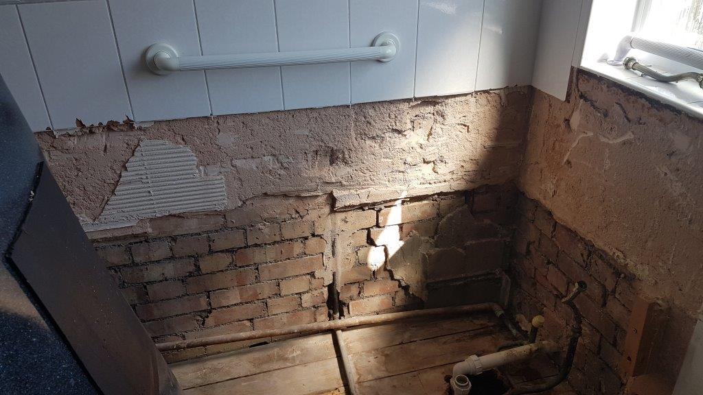

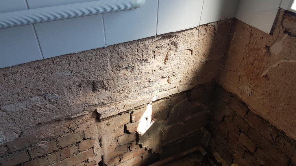

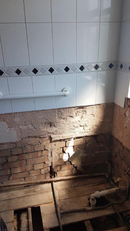

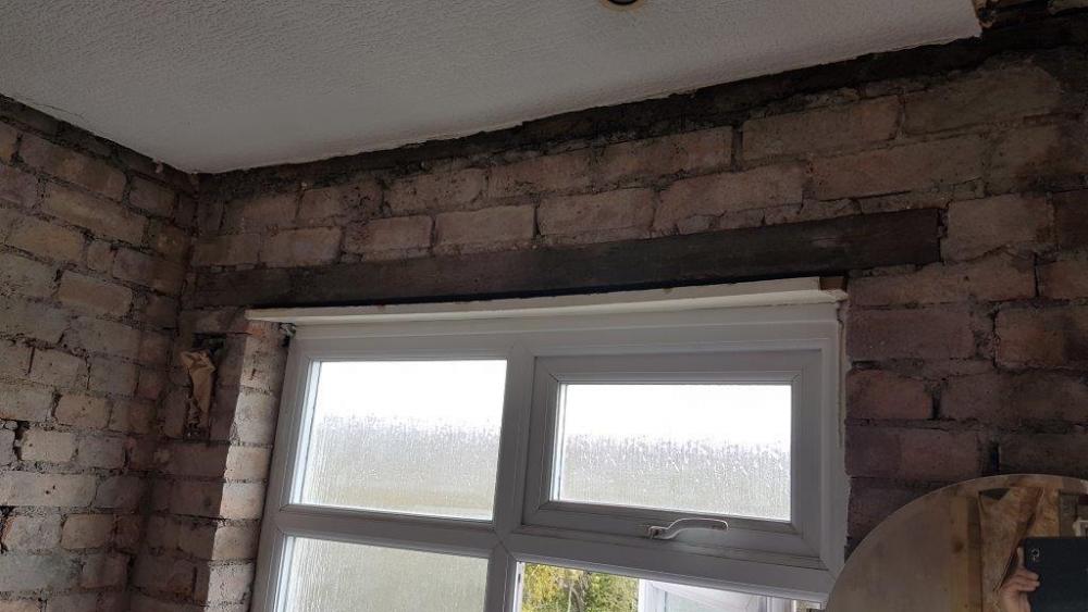

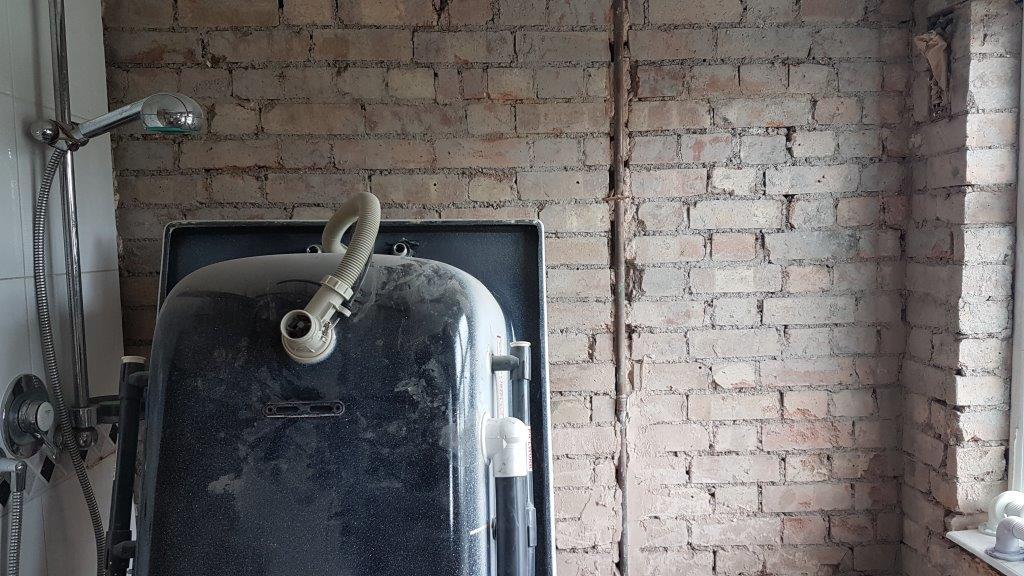

Vijay Posted April 19, 2021 Posted April 19, 2021 Removed the bath out of my parents bathroom today and my gut feeling is to remove everything back to brick. It's going to be where the shower goes, so need to get it right. Is there are reason to leave what's there and patch it on the bottom? Obviously still need to remove the rest of the tiles and some of the old plaster may well come with them anyway.................... There's also pipework in the wall that I need to address....................... I'll probably need to build it back out (to clear the ledger plate that the joists sit on) but I'll need to look at the drain position to know by how much. So would I batten then use some sort of waterproof board? Cheers Vijay

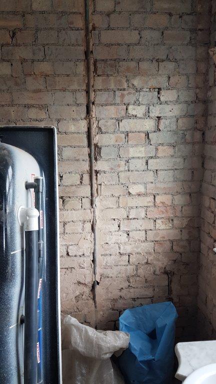

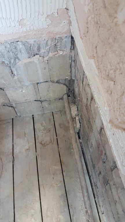

ProDave Posted April 19, 2021 Posted April 19, 2021 What's that "crack" / stepped out brickwork? Last picture in particular?
Vijay Posted April 19, 2021 Author Posted April 19, 2021 most of that is just a lump of plaster. The brickwork is a bit rough in places though.

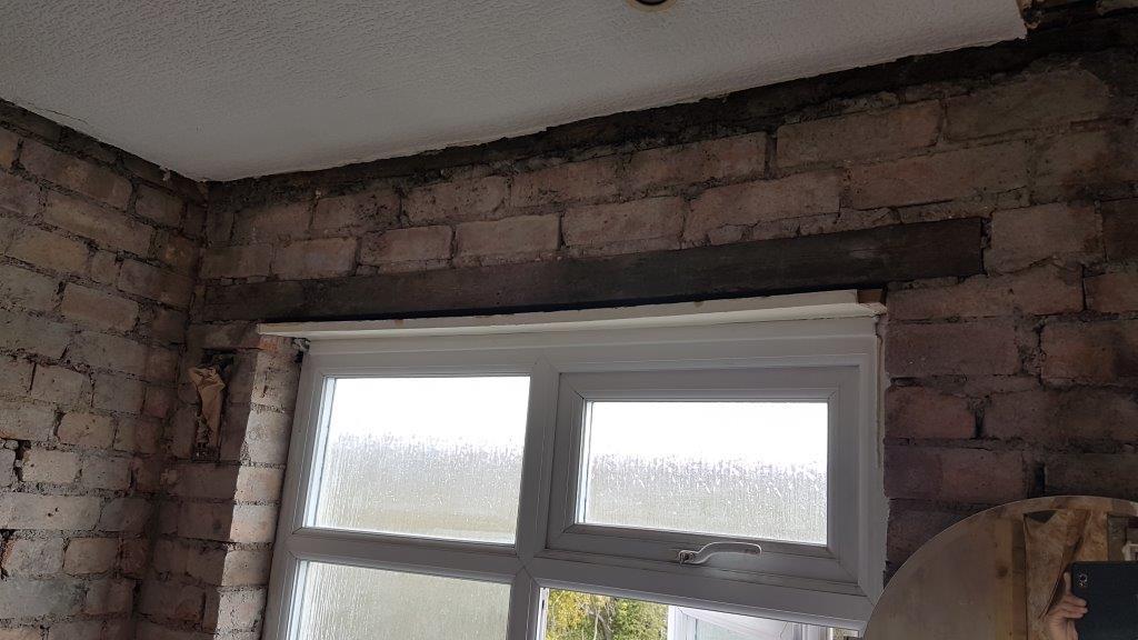

Vijay Posted April 20, 2021 Author Posted April 20, 2021 Decided to get everything back to brick and glad I did. I'm now thinking of throwing a bonding coat on, so I have a nice even surface to work off. How should I build out the wall, just studs and then a waterproof board or can I dot and dab the board on? Not sure how much I need to bring it out, but will be less than 50mm in total including tiles I believe. Cheers Vijay
Onoff Posted April 20, 2021 Posted April 20, 2021 Is it worth at least filling some of those joints where mortar is missing? Thinking to improve the air tightness, maybe stop vermin, insects etc entering from the cavity...
Vijay Posted April 20, 2021 Author Posted April 20, 2021 The main wall in the pics are a party wall, but yeah a bonding coat would fill all those gaps in. Once that pipe is out, I'll do the bonding coat I think
PeterW Posted April 20, 2021 Posted April 20, 2021 So why tiles ..? Why not just tidy up with a bonding coat then use Multipanel straight onto the walls..? Can use structural foam to hold it (DryFix works) or if you need to pack the walls true then use 25mm roofing battens and plumb them with packers - adding 25mm Jablite between the battens will stop a lot of excess condensation on the walls too.
Vijay Posted April 20, 2021 Author Posted April 20, 2021 Multipanel is still an option - the problem is getting to see the stuff as everywhere has been closed or they don't stock it. It's my Mum's bathroom and her choice, but she really has to see what ever is going on the walls. Would multipanel straight onto the walls still need tanking?

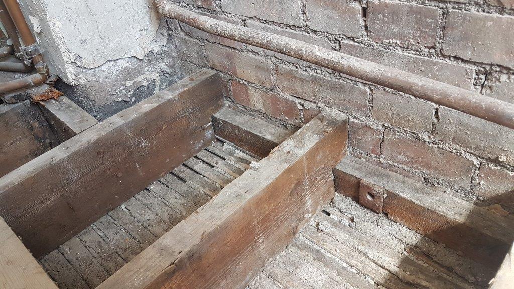

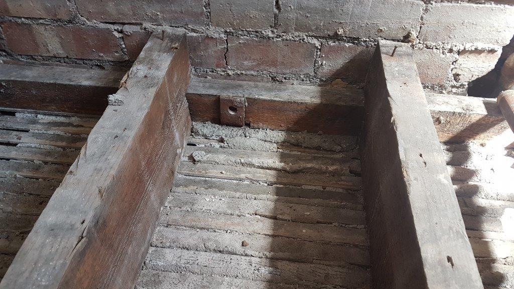

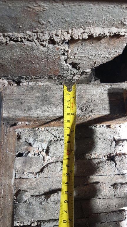

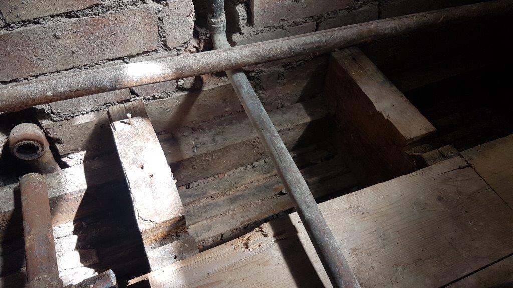

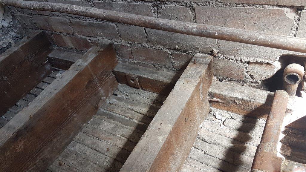

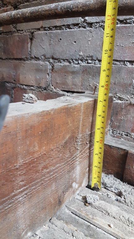

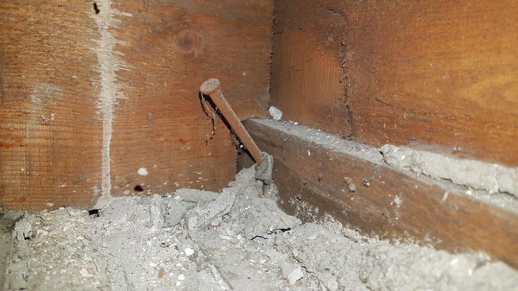

Vijay Posted April 26, 2021 Author Posted April 26, 2021 Before I carry on, can I check opinions on the joists. They are 7x2 sitting on a 3x2 ledger plate, which seems to sit on metal supports. My concern is how the joists are cut to sit on the plate. What do you think?
Vijay Posted April 26, 2021 Author Posted April 26, 2021 On 26/04/2021 at 18:20, tonyshouse said: How far do the joists span? Expand Can't believe I left out that vital information lol I need to double check the other end, but it is approx 2.5m
Adsibob Posted April 27, 2021 Posted April 27, 2021 On 27/04/2021 at 17:26, Vijay said: Same at the other end, a notch cut out Expand What are you planning on putting on the floor that is heavy? Any cast iron bath, for example?
Russell griffiths Posted April 27, 2021 Posted April 27, 2021 Check out the abacus bathroom videos, by skill builder on you tube, looks like a nice product that can either be dot and dabbed or fixed to battens.
tonyshouse Posted April 27, 2021 Posted April 27, 2021 it will be fine although there is a big notch to the underside of the joists the joists are oversized. They could be 125x47 with a 25mm notch

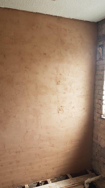

Vijay Posted April 28, 2021 Author Posted April 28, 2021 Got a bonding coat on the wall today - don't think I'll get any plastering work soon but it fills in the gaps 1
