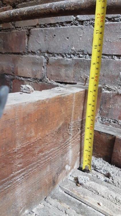

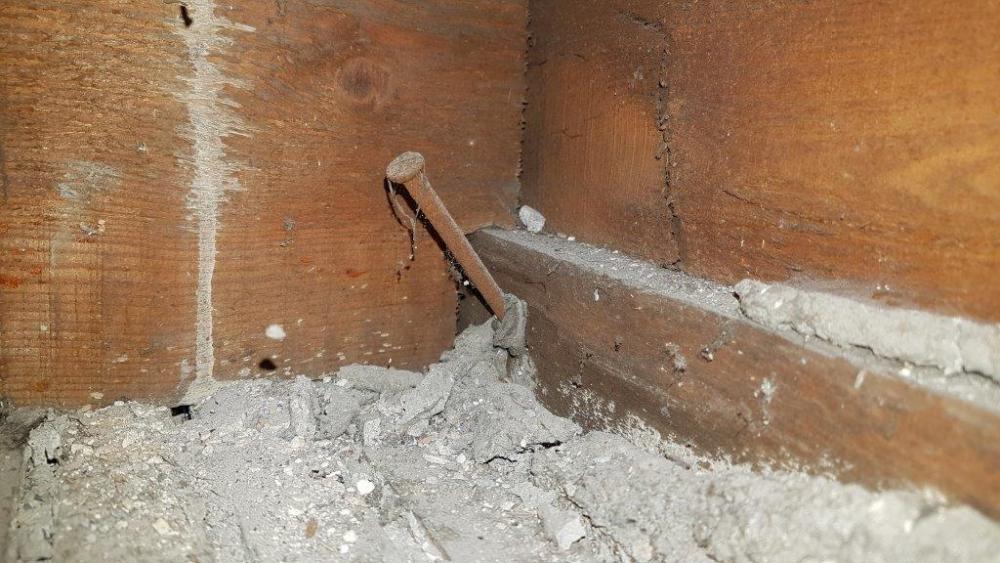

On 26/04/2021 at 17:39, Vijay said:
Before I carry on, can I check opinions on the joists. They are 7x2 sitting on a 3x2 ledger plate, which seems to sit on metal supports. My concern is how the joists are cut to sit on the plate.
What do you think?
Looks solid to me, been there for a long enough time without issue presumably.

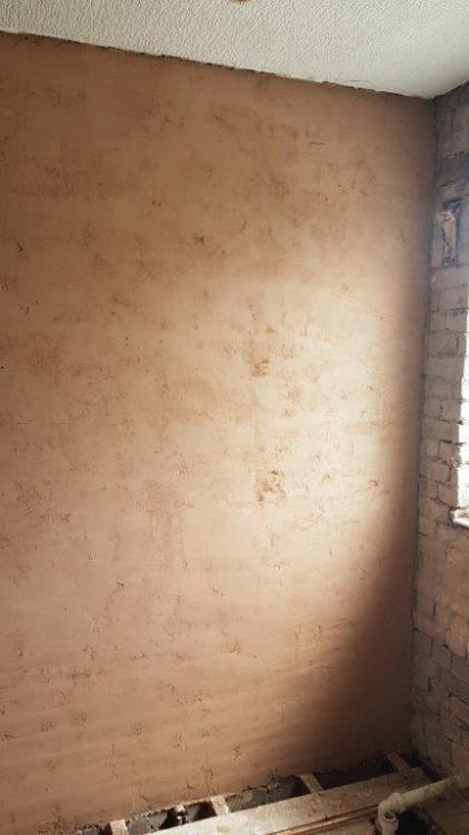

My next job is to look at the shower wall which will include a concealed shower valve and pipework run in it. It's a solid 9" party wall which I've put a thin bonding coat onto.
I haven't chosen the valve yet but I'm assuming I really need to batten out the wall which I'm thinking of 50mm with a 10mm board over it. Does that sound right? How much could I realistically chase out of the wall if I needed to?

Some concealed valves go pretty deep in the wall.
If you have space in the room I would pick a valve and work out how much depth it needs. Then build a stud/false wall the right depth from 2x4, do all the plumbing and mounting of the valve then clad with 12mm Hardi backerboard.
PS: Valve normally come with instructions that specify the range of mounting depths that they can accommodate. Remember to allow for tiling and adhesive. If you get it wrong some makes sell extension kits.

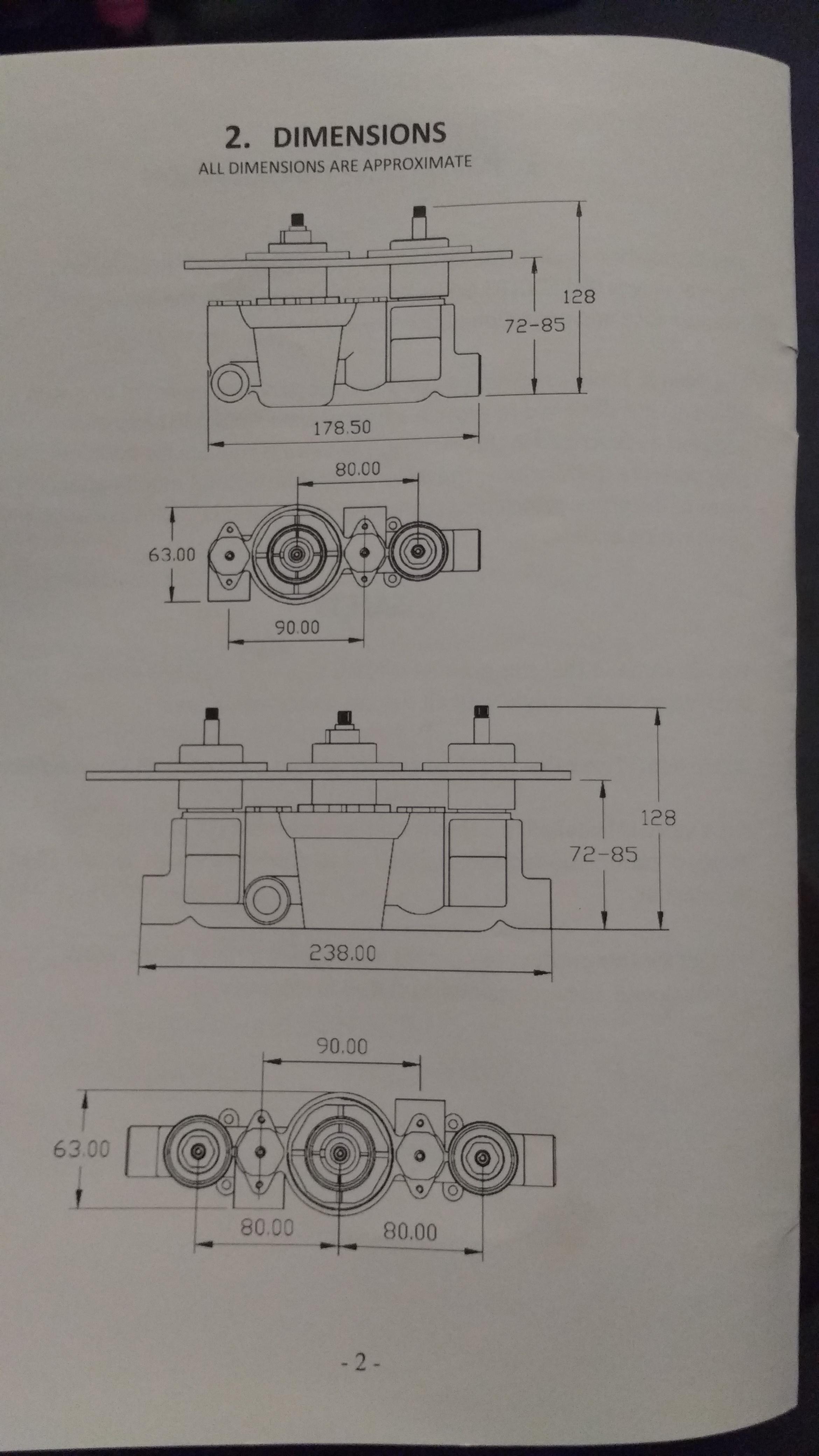

I looked at a few and they seem to be around 75-95mm (back of valve to back of wall plate). I'm struggling to find a suitable shower valve at the moment which is why I need to get on with stuff around it :(
Link to comment
Share on other sites
The dimensions of mine:
Tbh it's decision time. Either go surface mount thermostatic bar mixer or bring the wall out a bit with battens. You don't have to have the shower controls in the shower. You can have them to one side like mine. Dead handy as you can turn on and set with just your hand underneath rather than stepping in and having to get wet.

That kinda goes with what I've seen and would be great if the valve I choose for them is nearer the 72mm ;)
the shower area is 1800 x 850 and I was planning on having the controls in the middle, so they can be accessed from the 600 entrance and also within the shower both easily.
Definitely not gonna channel anything major into the wall, I only asked in case I needed to nick anything for the valve - and that would me small, maybe 25mm max
