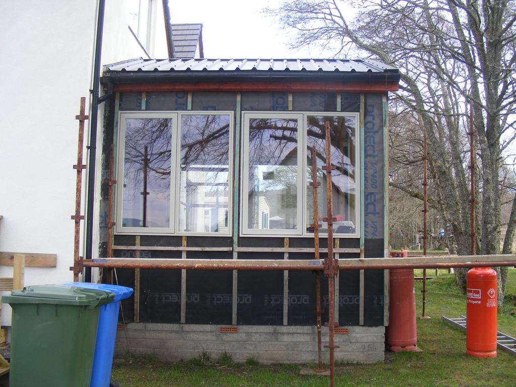

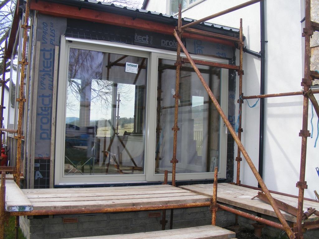

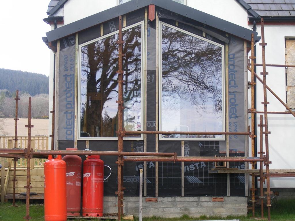

ProDave Posted April 16, 2021 Posted April 16, 2021 Mine fitted today. It took 5 hours and cost me £400 That big slider was a good 4 man lift and we had the help of a friend plus me to give some grunt. More pictures on my blog if you want, direct link. http://ardross.altervista.org/Wilowburn/the-sun-room/
Mr Punter Posted April 16, 2021 Posted April 16, 2021 15 minutes ago, ProDave said: That big slider was a good 4 man lift and we had the help of a friend plus me to give some grunt. Could you decouple it or was it the whole thing? Is it lift and slide operation and is it smooth / easy operation?
ProDave Posted April 16, 2021 Posted April 16, 2021 10 minutes ago, Mr Punter said: Could you decouple it or was it the whole thing? Is it lift and slide operation and is it smooth / easy operation? We removed the slider to reduce the weight for install, and just the fixed pane and frame was heavy enough. Then lifted the slider back in. It's lift and slide, turning the handle lifts it up onto the rollers and it slides easily but it is a big lump of window. Just shy of 3M wide so the sliding pane is probably about 1.4M wide and 2.1M high triple glazed. 1
Makeitstop Posted April 16, 2021 Posted April 16, 2021 29 minutes ago, ProDave said: We removed the slider to reduce the weight for install, and just the fixed pane and frame was heavy enough. Then lifted the slider back in. It's lift and slide, turning the handle lifts it up onto the rollers and it slides easily but it is a big lump of window. Just shy of 3M wide so the sliding pane is probably about 1.4M wide and 2.1M high triple glazed. Can I ask who manufactured the slider and what system is used for the framing?
Bonner Posted April 16, 2021 Posted April 16, 2021 2 hours ago, ProDave said: More pictures on my blog if you want, direct link They look great, are they Alu-clad? What colour please, inside and out?
ProDave Posted April 16, 2021 Posted April 16, 2021 59 minutes ago, Bonner said: They look great, are they Alu-clad? What colour please, inside and out? Yes Ali clad, Rationel Aura Plus. What they call Pebble Grey, same colour inside and out. I can look up the RAL number if you need. 1
