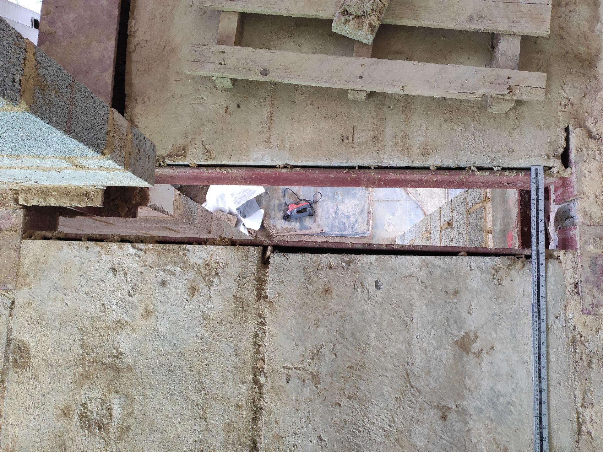

MortarThePoint Posted May 17, 2021 Share Posted May 17, 2021 Interesting reading. My experience has taught me two things: 1. At spans under 5m you can have big holes knocking out two steels with no issue. 2. When they install them it is easy for the planks to drift out 50mm or so in the direction perpendicular to span, putting your opening in slightly the wrong place. OK for services a pain for something like a chimney (I had a 700mm chimney passing through the join in two planks and had to shrink the chimney to 650mm). Make a checklist of dimensions to be checked as they install. I'd have been all over them if it hadn't been for Covid. 3. You'll forget some holes. Haven't tried drilling anything larger than 25mm, but that was very easy. Link to comment Share on other sites More sharing options...

Thorfun Posted May 18, 2021 Share Posted May 18, 2021 21 hours ago, MortarThePoint said: 2. When they install them it is easy for the planks to drift out 50mm or so in the direction perpendicular to span, putting your opening in slightly the wrong place. OK for services a pain for something like a chimney (I had a 700mm chimney passing through the join in two planks and had to shrink the chimney to 650mm). Make a checklist of dimensions to be checked as they install. I'd have been all over them if it hadn't been for Covid. this is what my Groundworker said. he said if you're having hollow core then he'll go around after and core the openings as they're never in the right place in his experience. 40 minutes ago, tonyshouse said: I was my installer and ordered my own planks if you want a job done properly....do it yourself. ? Link to comment Share on other sites More sharing options...
saveasteading Posted May 18, 2021 Share Posted May 18, 2021 Agreed, buy whole planks and cut on site UNLESS there need to be cut-outs to miss columns. Even then they are likely to be in the wrong places, but is easy to chip off some more. Big holes are made at the factory by a worker with a shovel, and a tape measure if you are lucky. I much prefer T beams where possible. No cranes or big forklifts. On small spans with block infills, it is very easy to form a hole unless it has to be precise. Cutting through a T is a bad idea. T usually much cheaper if the spans are small, all factors considered. Beware the camber on precast slabs. They vary by span (long slabs bend up further). It can cause a lot of extra screed, and eat up the headroom. If more than one load of slabs, of different sizes (or with cut-outs) check they are delivered in the right order. Link to comment Share on other sites More sharing options...

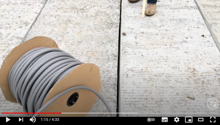

kxi Posted May 18, 2021 Share Posted May 18, 2021 (edited) Re hollowcore grouting, what's the best way to grout the planks if the gap (the keyway) is variable and a bit wide at the bottom where planks havn't been pushed together, e.g. between 1-15mm gap at the base? So far options suggested have been: 1. Stuff some backer rod down to the bottom of the cracks then can pour a wetter mix in Seems to be used in the US https://www.youtube.com/watch?v=hVs8cq3ZBA8 2. Shutter underneath Seems a lot of effort as there are a lot of joints 3. Use a dryer mix so it doesn't slop out of the bottom ? Edited May 18, 2021 by kxi Link to comment Share on other sites More sharing options...
Conor Posted May 18, 2021 Share Posted May 18, 2021 @kxi you don't need to worry about gaps unless they are more than 25mm or so. If you use a drier mix and are gentle with the first few shovel fulls, it'll most stay in place. For the bigger gaps we used a sheet of OSB propped up with a couple scaffold boards. Takes a few minutes. As we were doing an ICF build, we were able to do all the grouting with the left over mix. 1 Link to comment Share on other sites More sharing options...
