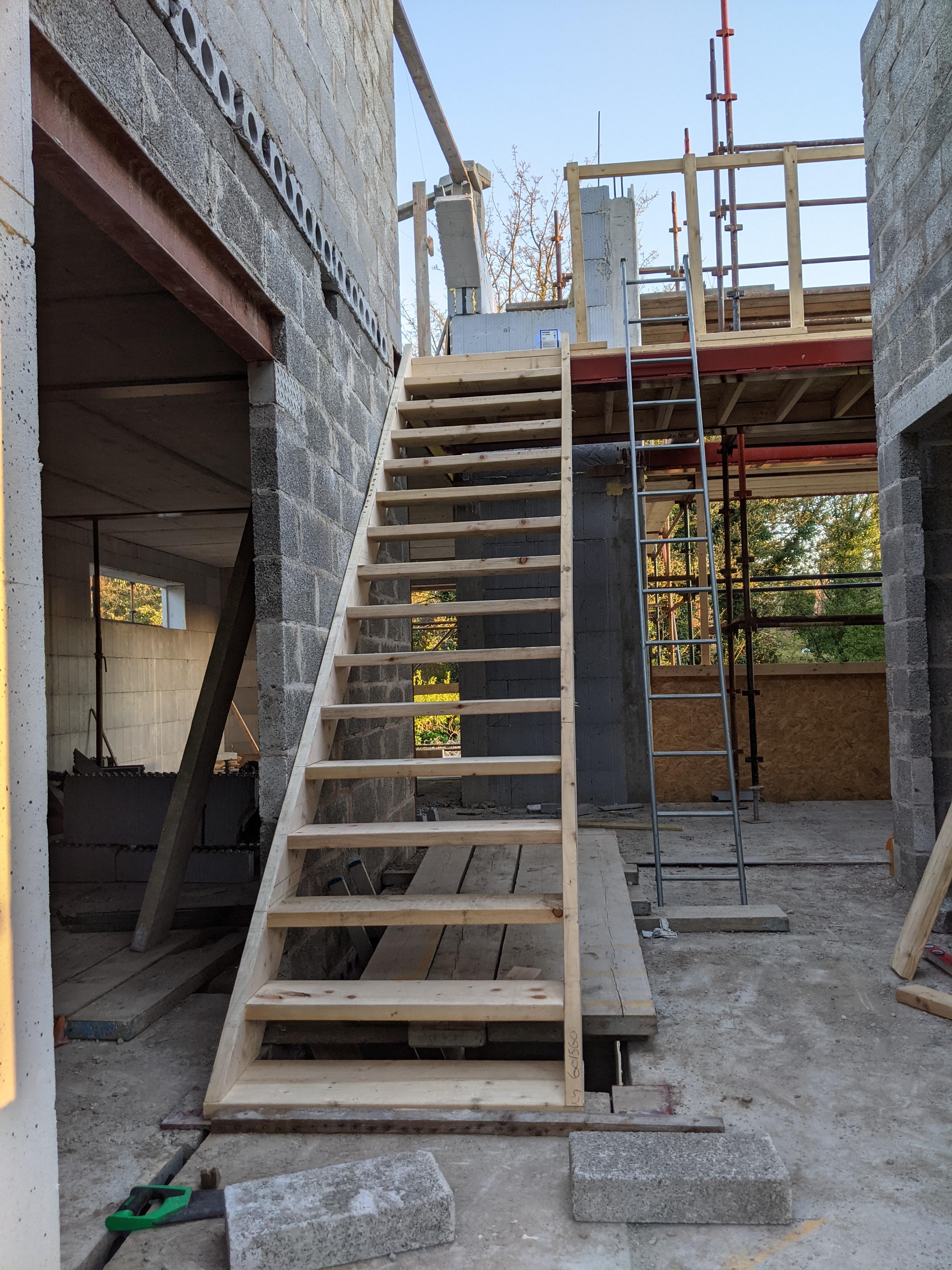

Conor Posted April 2, 2021 Posted April 2, 2021 (edited) Made these stairs today. £100 of timber and about 6 hours. 3400mm going and 3000mm rise, 900mm tread width. Made with 225x50mm cls. The lack of a protractor and basic trigonometry skills easily added two hours to the build time. Might be able to repurpose them for the basement if they survive. (Yes, handrail etc to be added) Edited April 2, 2021 by Conor 2
Gus Potter Posted April 2, 2021 Posted April 2, 2021 Well done Conor. Yes get the hand rail on and don't over load them. Let us know how "bouncy" they are once you have used them for a bit. Once you get the hang of it you can do some cracking stairs going the over cladding route.

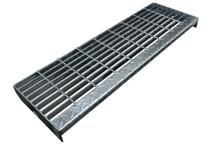

MortarThePoint Posted April 7, 2023 Posted April 7, 2023 On 02/04/2021 at 20:42, Conor said: Made these stairs today Look awesome! Did you use Coach Screws or woodscrews (6mm)?) to attach the treads to the stringers? How have you attached it at the top? I've bought some 8x2 for my stringers and 6x2 for treads. I'd like to go with Galvanised treads as that was my plan for the garage but I am re thinking that because: They have doubled in price so would cost £400+fixings for the garage stair As they are open any dirt will fall straight through to whatever is underneath. I could address using something underneath (Perspex?) but more cost They bolt to the stringer quite easily though.

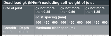

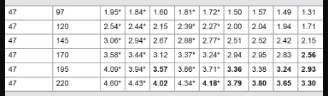

MortarThePoint Posted April 7, 2023 Posted April 7, 2023 On 27/03/2021 at 23:19, Gus Potter said: Yes is does look that way but the stringer is probably getting on some 250 + mm deep The stair in the video is a pretty low angle (30-35deg?) so that makes its life harder. There are space saving stairs online (57deg) with just 142x27 stringers but that seems too flimsy to me. My intuition is telling me that the moment and stress ends up along the lines of considering a joist with length equivalent to the horizontal projection (L_joist=L_stringer/COS[angle]=h_stair/TAN[angle]) of the stair and joist height equivalent to the vertical depth of the stringer (so h_joist=h_stringer/COS[angle]). Is that correct? If that is correct, the equivalent joist to the video would be about L_joist=2.4m/TAN[30] = 4.1m, h_joist=225mm/COS[30]=289mm. NHBC tables don't go up to 289mm, but extrapolating each 25mm step adds 0.45m of span (gk=0.25, spacing=600mm) so that would suggest (for C16) 47x295 joists would be good for a 5.37m span @600mm spacing and live load of 1.5kN/m2. That's a UDL, so a centre loaded equivalent would be half the UDL loading so 5.37m * 0.6m * 1.5kN/m2 / 2 = 2.4kN per joist. I know the treads are wider than 600mm, but this attempts to understand the point (tread) loading. As there are two stringers, it would double that to 4.8kN load capacity. Unlike a joist the loading is much more aggressive due to the bouncing motion of people climbing the stair. Think of a 100kg builder with a 25kg bag of plaster under each arm playing trampoline in the middle of our stair. For the space saver, the tables don't go that thin, but can scale: 142mm/COS[57]=260mm. 27x260 should be good for 1.5kN/m2*(27/38)=1kN/m2 and a span of about 4m(!) where as the stairs projection is probably more like 2.4/TAN[57]=1.6m. Does that make the equivalent joist point load capacity around (4m / 1.6m) * 1kN/m2 * (1.6m * 0.6m) / 2 = 1.2kN. As there are two stringers, it would double that to 2.4kN load capacity. All nonsense or vaguely right? 🤠

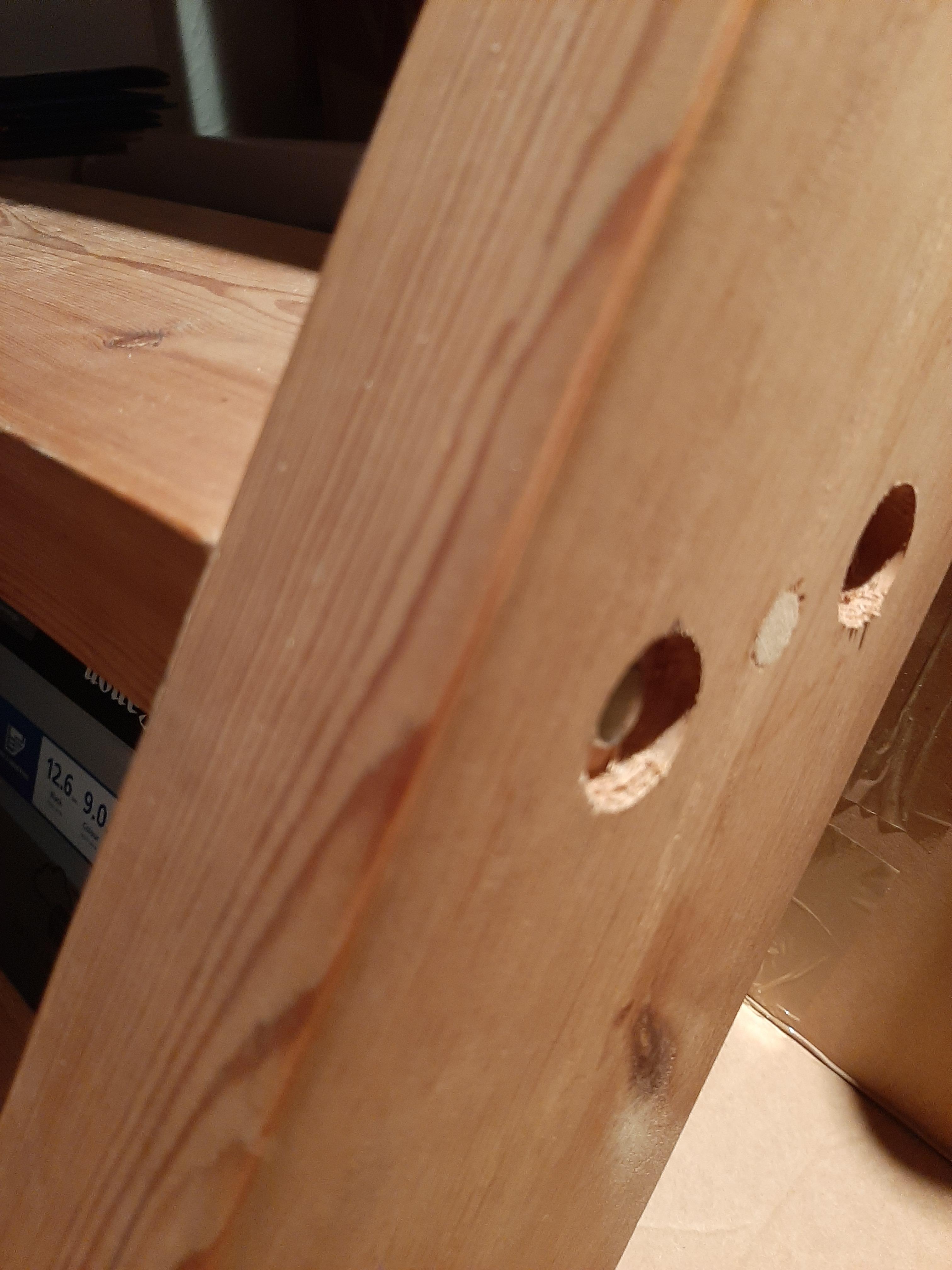

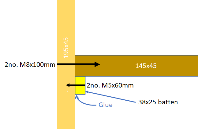

Conor Posted April 7, 2023 Posted April 7, 2023 (edited) 4 hours ago, MortarThePoint said: Look awesome! Did you use Coach Screws or woodscrews (6mm)?) to attach the treads to the stringers? How have you attached it at the top? I've bought some 8x2 for my stringers and 6x2 for treads. I'd like to go with Galvanised treads as that was my plan for the garage but I am re thinking that because: They have doubled in price so would cost £400+fixings for the garage stair As they are open any dirt will fall straight through to whatever is underneath. I could address using something underneath (Perspex?) but more cost They bolt to the stringer quite easily though. 6x100mm screws. Later one of the treads failed so I then fitted 200mm strips of roofing battens under each one, with a couple 50mm screws. Much more solid. At the top I had a vertical riser screwed between the strings and had that screwed in to the steel beam with 6.5mm X 70mm roofing screws. Edited April 7, 2023 by Conor
MortarThePoint Posted April 7, 2023 Posted April 7, 2023 6 minutes ago, Conor said: Later one of the treads failed Sounds hairy, hopefully at the bottom
