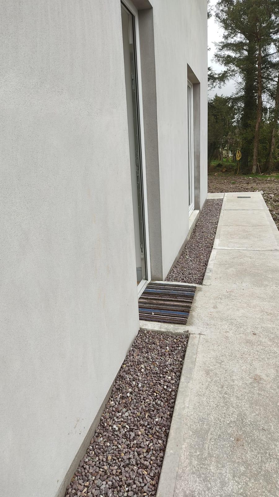

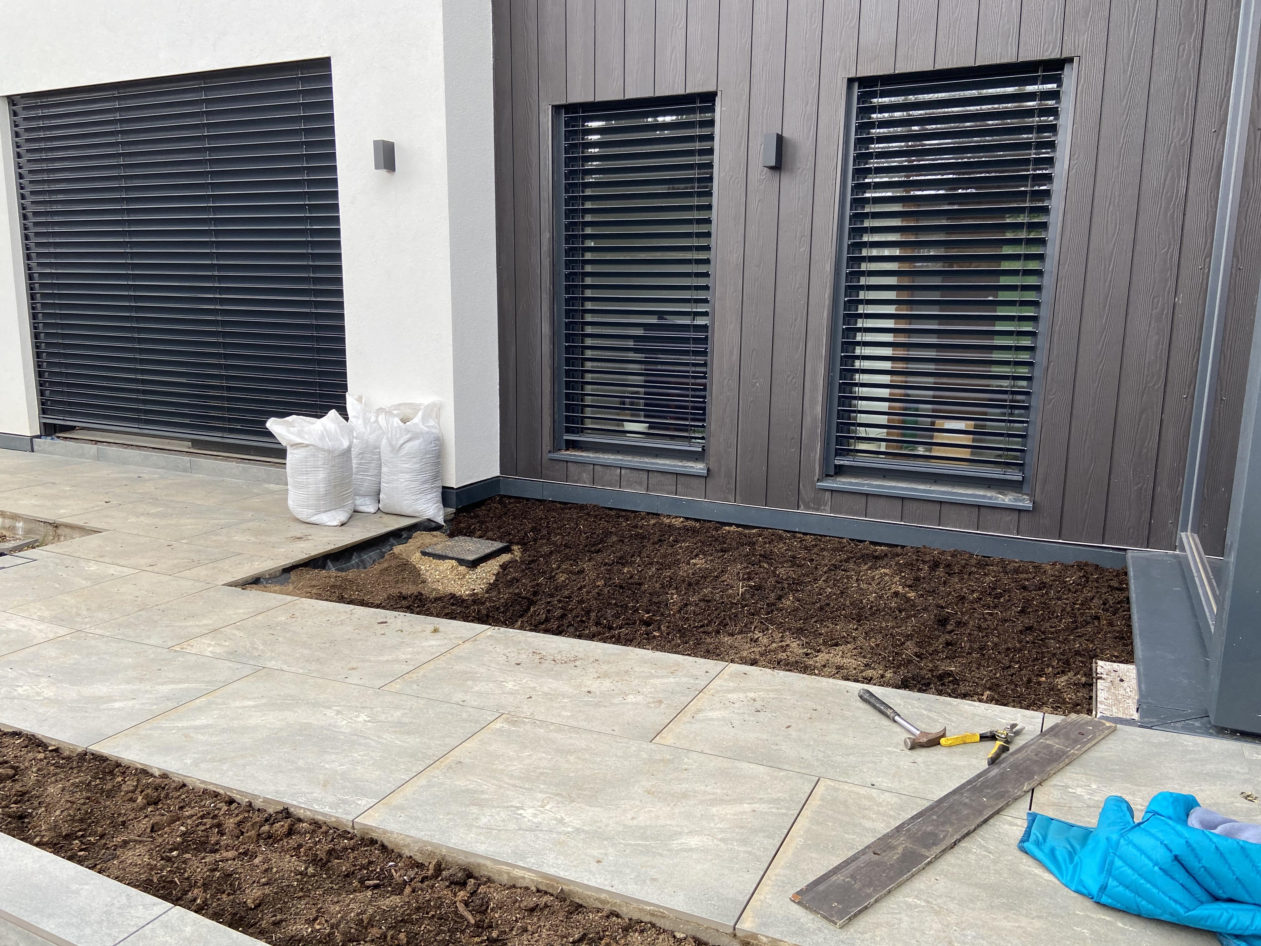

Thorfun Posted March 28, 2021 Posted March 28, 2021 On 27/03/2021 at 22:38, Weebles said: Aluminium trim around base of house for a finished bottom "edge" - looks smart Expand this sounds interesting. any chance of a photo please?

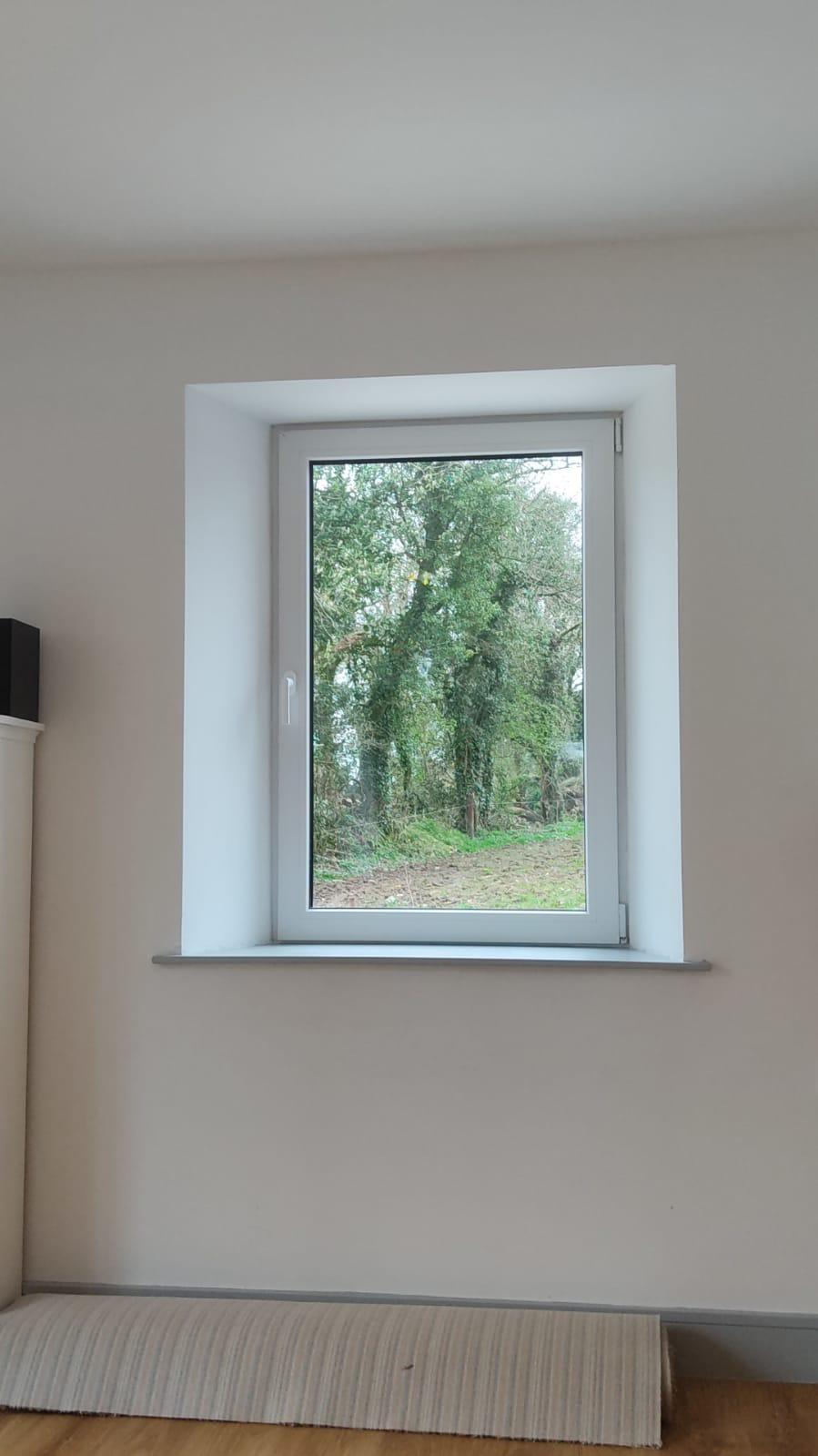

Iceverge Posted March 29, 2021 Posted March 29, 2021 On 27/03/2021 at 02:38, puntloos said: People debate this then - @Bored Shopper hates this for cleaning? Expand So Far so good. Ours is 400mm wide which I hope will help and the nearest trees are about 20m away. On 27/03/2021 at 02:38, puntloos said: Why? Aesthetics? Seems annoying to not be able to use windowsills as 'storage'? Expand It looks nice and allows more direct sunlight deeper into the room. I think you have the wrong idea.The window sills are wider if anything. On 27/03/2021 at 02:38, puntloos said: Why not? Works well as acoustic insulation, no? Expand Acoustically it's excellent. Much like a hotel or similar. Dimentionally totally stable too. Super fast to install. Less than an afternoon. You can have solid walls upstairs pretty much where you like too. It's a very thick buildup. In our case. 10mm carpet, 10mm underlay, 75mm reinforced concrete screed 150mm precast concrete floor, 110mm service void in suspended metal ceiling and 12.5mm plasterboard and 3mm skim. I had to insist the fitters kept the service void as tight as possible. Had I not it would have likely ended up nearer to 150mm if not 200mm. A posi joist floor for the equivalent span might be 100mm thinner. Its very tricky to detail well for airtightness. I've discussed elsewhere on here previously. It requires a much heavier structure on the ground floor in places. In our case 215mm inner leaf and RSJ's over the load bearing openings. It's a total PITA to route wastewater pipes if you didn't put them in first day. Cost wise there's very little difference between posi joists. I think about €30/m2 from memory. On 27/03/2021 at 02:38, puntloos said: And finally quite a bit of debate on UFH everywhere or just downstairs and in upstairs bathrooms? Expand If you build a very well detailed and insulated airtight with MVHR house the heating debate becomes a bit mute. You could put in direct electric heating, radiators, duct heating, a logburner, air to air, UFH, ASHP, gas boiler, oil boiler, GSHP, mini nuclear reactor etc etc etc and the heat will distribute pretty evenly around your house and you'll have a super comfortable home with no cold spots. No cold floors and no drafts. Just do whatever is cheapest and/or greenest IMHO. We've a small electric heater on cheap night rate electricity in the hallway and the whole house is very comfortable. I hum and ha about whether we should have included UFH pipes "just in case" but as soon as you go down that route you're throwing away all the effort of building a passive house.

Weebles Posted March 30, 2021 Posted March 30, 2021 On 28/03/2021 at 10:51, Thorfun said: this sounds interesting. any chance of a photo please? Expand It’s not a brilliant close up but you can see it. Can send some install pics if you are interested. We ordered it and fixed it ourselves. 1

Thorfun Posted March 30, 2021 Posted March 30, 2021 On 30/03/2021 at 10:30, Weebles said: It’s not a brilliant close up but you can see it. Can send some install pics if you are interested. We ordered it and fixed it ourselves. Expand thanks. it does look smart. let me run it by the other half and see what she says and I'll get back to you.
jack Posted March 30, 2021 Posted March 30, 2021 On 30/03/2021 at 12:01, Thorfun said: thanks. it does look smart. let me run it by the other half and see what she says and I'll get back to you. Expand Take a look at this thread, which references several others that have taken a similar approach. 1
