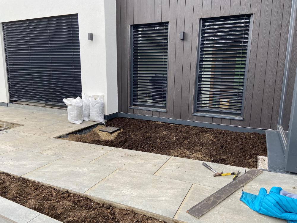

On 22/03/2021 at 18:03, Bitpipe said:
Do it again
Flush exit from front / rear to paving / patio :  Worth the head scratching to make it work
Can you elaborate why? What's the benefit?

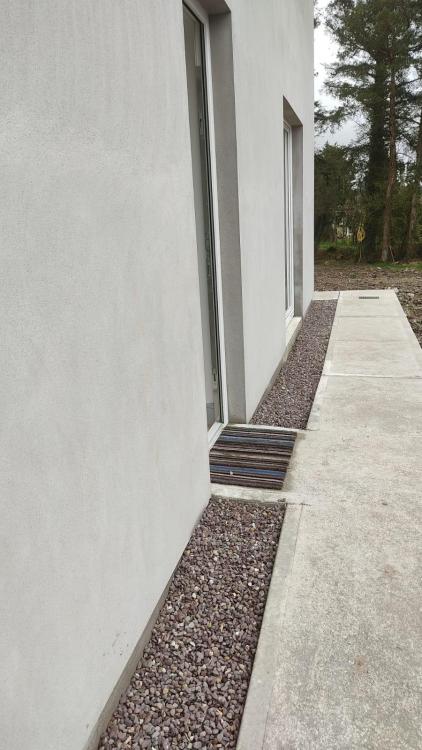

On 22/03/2021 at 21:00, Iceverge said:
French drain and gravel between footpaths and house wall.
People debate this then - @Bored Shopper hates this for cleaning?

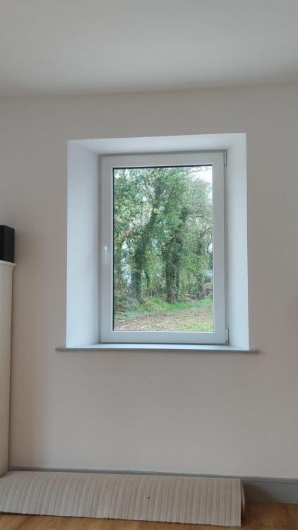

Splayed window reveals.
Why? Aesthetics? Seems annoying to not be able to use windowsills as 'storage'?
