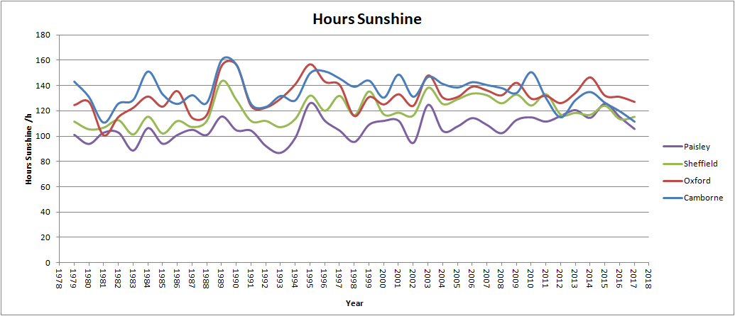

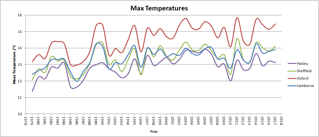

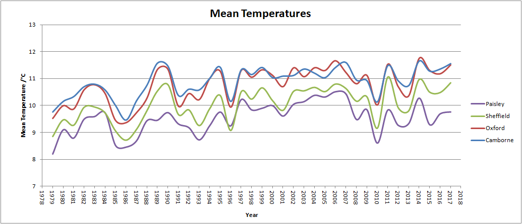

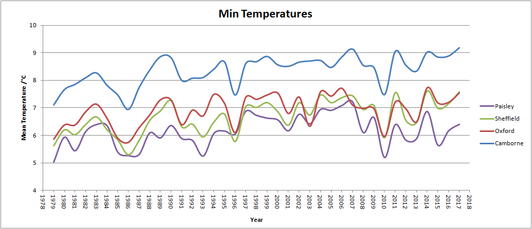

SteamyTea Posted March 19, 2021 Posted March 19, 2021 (edited) 5 minutes ago, joe90 said: Yes mine is very similar We don't get excessively high air temperatures and we normally have a breeze as well. Different up in the home counties and in more built up areas. I seem to remember looking at the temperature difference between Penzance and Newcastle, only about 1°C colder up on the East Coast, on average. But the temperature range was was much bigger than Penzance. And it is not as windy. Sun is higher in the sky down here as well, this can, depending on house orientation and design, reduce passive gain. Edited March 19, 2021 by SteamyTea

SteamyTea Posted March 19, 2021 Posted March 19, 2021 Some Charts showing variation in UK mean, min and max temperatures over the years. And a bonus one, hours sunshine
