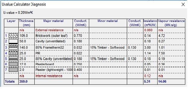

davejura Posted March 18, 2021 Posted March 18, 2021 Sorry to jump in, still trying to sort our insulation! So, out of interest, how much more thermally efficient is a wall with a U value of, say, 0.19, compared to one at 0.22? Are we talking a few ££s a year in heating costs or a lot more? I'm still trying to get U values calculated for mine, based on 140mm Frametherm between the studs and 25mm PIR inside. Also, is there a thermal membrane that can go on the outside of the kit that may help? 1
A_L Posted March 18, 2021 Posted March 18, 2021 1 hour ago, davejura said: how much more thermally efficient is a wall with a U value of, say, 0.19, compared to one at 0.22? Are we talking a few ££s a year in heating costs or a lot more? Typically this would save about 1.7kWh/m2 /yr in Central England 54 minutes ago, davejura said: I'm still trying to get U values calculated for mine, based on 140mm Frametherm between the studs and 25mm PIR inside Here is a similar wall below, U=0.20. If Protect TF200 Thermo, a low emissivity layer is added to the unventilated cavity the U value will improve to 0.17 1
davejura Posted March 18, 2021 Posted March 18, 2021 7 minutes ago, A_L said: Typically this would save about 1.7kWh/m2 /yr in Central England Thanks. So about £40 - £50 per year for a 175 sq M floor area 2 story house, at a guess? I'm keen to use Frametherm as it is cheaper and easier to fit. I'll look into using the Protect 200 thermo and also an internal layer of 25mm PIR.
A_L Posted March 18, 2021 Posted March 18, 2021 3 minutes ago, davejura said: Thanks. So about £40 - £50 per year for a 175 sq M floor area 2 story house, at a guess? N.B. the m2 is wall area, remember it is energy lost through wall, allow for any inefficiency in turning fuel into heat, e.g. saving 1kWh of heat saves about 1.2kWh of gas
davejura Posted March 18, 2021 Posted March 18, 2021 OK thanks, so a bit more then. Heating will be by ASHP and UFH. Really struggling to get my head around this SAP calculation carry on!

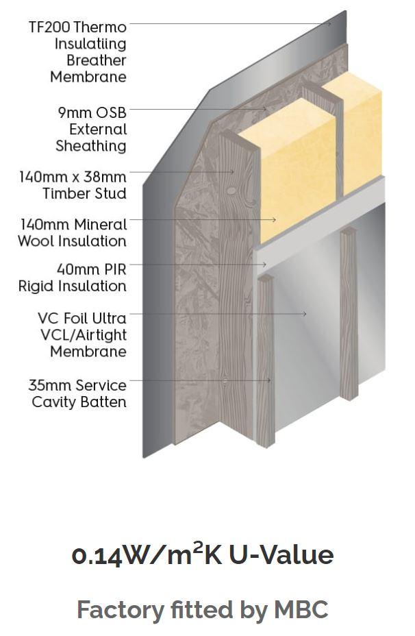

Ian Posted March 19, 2021 Posted March 19, 2021 (edited) On 17/03/2021 at 08:49, Thorfun said: agree with @dpmiller and @Russell griffiths. we're simply copying what a lot of the major TF manufacturers do in the factory. here's the MBC example. https://www.mbctimberframe.co.uk/closed-panel-wall-options/ I had a look at the MBC examples in that link and I think they've got the 'U' value calculation wrong for this one. I reckon it's somewhere between 0.16 and 0.17W/m2K instead of the 0.14 they are showing on the website. Edited March 19, 2021 by Ian
Thorfun Posted March 19, 2021 Posted March 19, 2021 4 minutes ago, Ian said: I had a look at the MBC examples in that link and I think they've got the 'U' value calculation wrong for this one. I reckon it's more like 0.16W/m2K instead of 0.14. yeah, I've questioned this before (can't remember on what thread though) and also can't comment on MBC's marketing figures. I guess I should have caveated the post with 'make sure you get your own calculations done on the expected U-values'.
Ian Posted March 19, 2021 Posted March 19, 2021 22 minutes ago, Thorfun said: yeah, I've questioned this before (can't remember on what thread though) and also can't comment on MBC's marketing figures. I guess I should have caveated the post with 'make sure you get your own calculations done on the expected U-values'. not intended as criticism of you in any way....I just thought it looked wrong so checked and I couldn't get it any better than 0.16W/m2K using 2 different 'U' value claculators. It's more likely 0.17W/m2K. I still find it very strange that MBC seem to have got it so wrong (maybe its me that's wrong?)
Cpd Posted March 19, 2021 Posted March 19, 2021 Just remember that PIR between studs had to be done very well (foamed AND Taped) if it’s done shite then it’s as much use as an ashtray on a motorbike.... Doing it really well is very time consuming (I am doing it right now....) and you should not “assume” your builder is going to do a pukka job if working to a set price or finds this sort of detailing “unnecessary” using a compressible insulation between the studs gives you a much better chance of getting it right and then stick as much PIR as you can (within reason...)on the inside to really bolster up your U-Values. 2
Thorfun Posted March 19, 2021 Posted March 19, 2021 29 minutes ago, Ian said: not intended as criticism of you in any way none taken! we are in agreement that it's strange MBC seem to have gotten it wrong. I'll see if I can find the previous posts on this wall make up and link them here...
Thorfun Posted March 19, 2021 Posted March 19, 2021 @Ian I found the post I was referring to, although no one actually responded as to the difference as that's probably as I'd answered it myself. @A_L and @ADLIan are both wizards at U-value calculations and they've helped me loads on various posts, but I still find it hard to get my head around all the nuances. I think I need to re-read all my previous threads on this subject for a recap. 1

SteamyTea Posted March 24, 2021 Posted March 24, 2021 I questioned MBC at the self build show about this. Guy said it was to do with the staggered studs, and something else I cannot remember.
Dan F Posted April 6, 2021 Posted April 6, 2021 @Ian When we modelled the 140mm option alongside the 300mm twin-wall, we were advised to use 0.17W/m2K Few reasons: - MBC calculation assumes external 100mm concrete. - MBC calculation assumes external 50mm unventilated external cavity. - Value of foil breather membranes is questionable. 1
