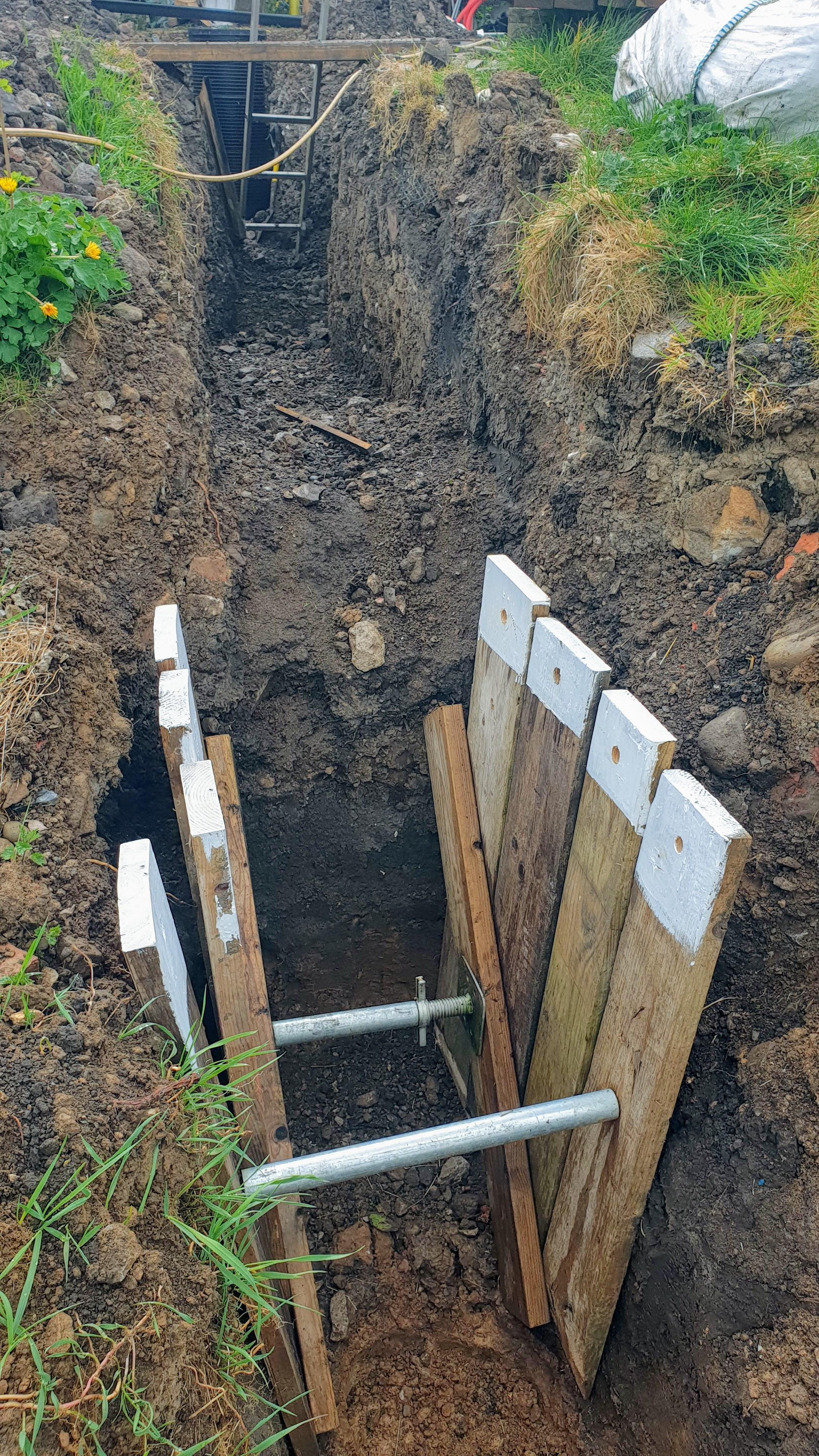

ToughButterCup Posted March 13, 2021 Share Posted March 13, 2021 1 hour ago, AliG said: ... Would it be doable to get a couple of guys out to dig a hole this deep by hand to locate the exact top of the pipe? ... Yes. Here's the evidence. Just over 3 meters in one place. Glad most of it was clay but...... 31 cubic meters by hand during lockdown 1 Link to comment Share on other sites More sharing options...
