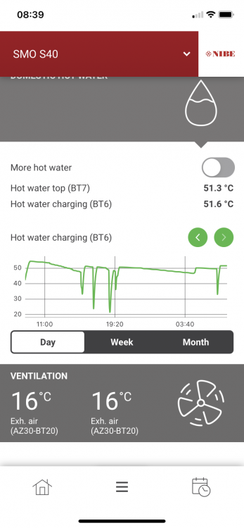

Thedreamer Posted March 1, 2021 Share Posted March 1, 2021 A well done self build requires little to no heating. I didn't see the point investing in an expensive heating system that would be rarely used. Have you considered an exhaust heat pump? Our one acts as MEV, but you can connect it to extract air from the outside like a conventional heat pump if you already have MVHR in your design. 1 Link to comment Share on other sites More sharing options...
