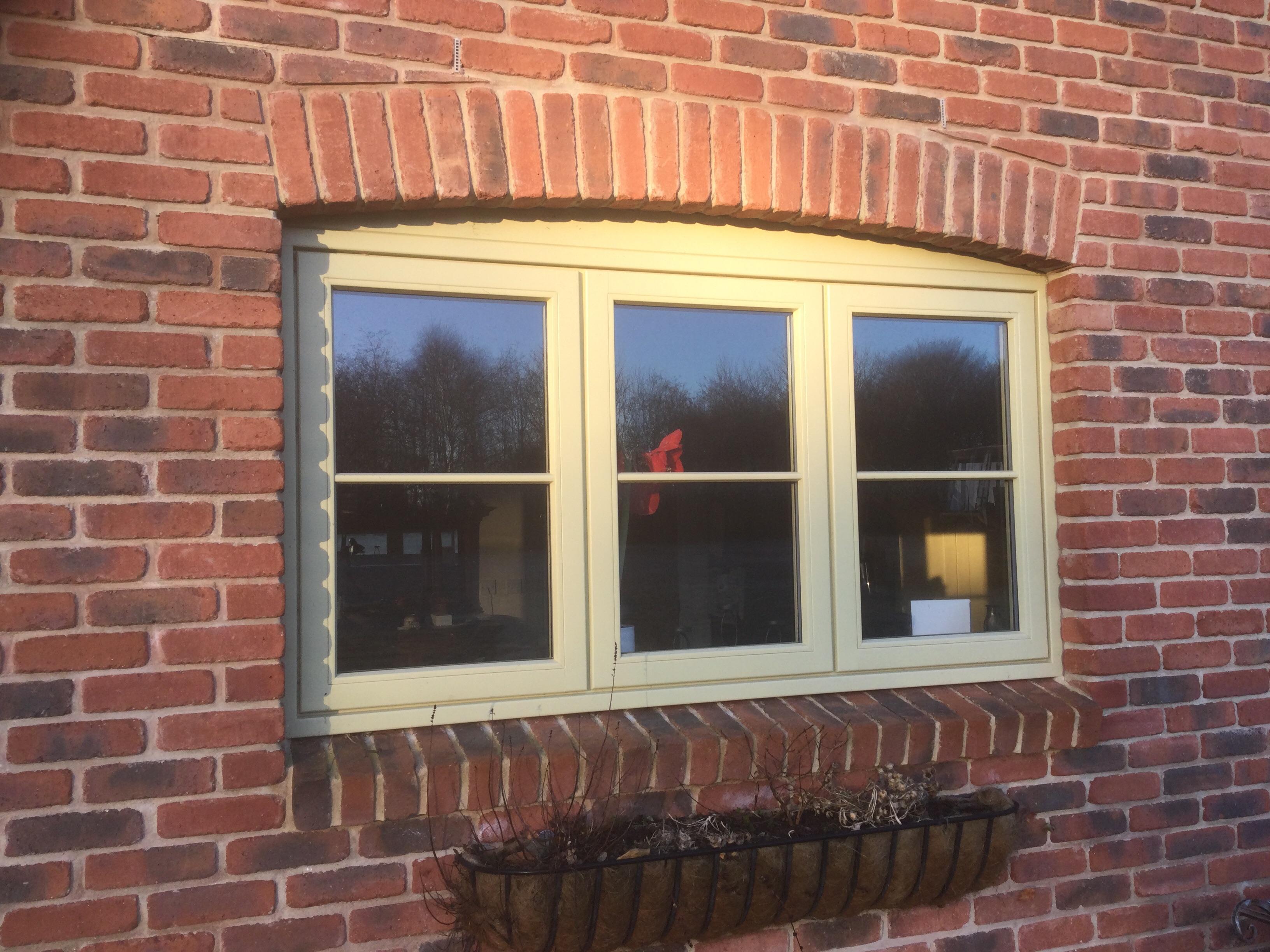

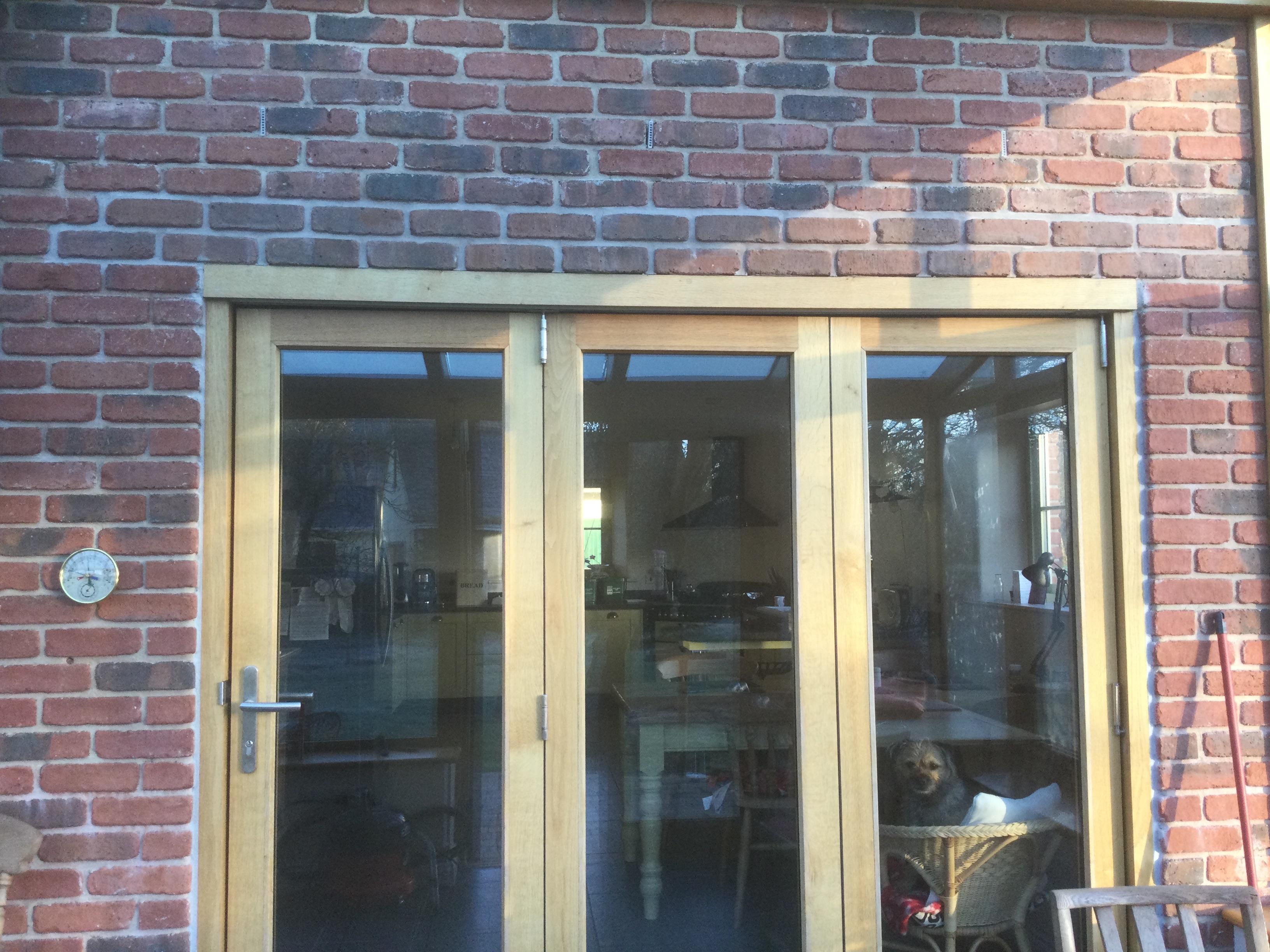

joe90 Posted February 26, 2021 Posted February 26, 2021 (edited) 27 minutes ago, Matt60 said: but you cannot get an off the peg Catnic to span that distance Why are you hung up on catnic lintels, they are cold bridges, why have lintels at all in the outer brick skin (you spec brick outer leaf), why not build arches like they did hundreds of years ago (and I did a couple of years ago). For the bifolds where arches were not possible I used concrete lintels (set back slightly) and cut bricks into slips which when glued on matched the bricks ? I will post pics in the morning when it’s light if you want? The best solutions are the easiest ones! Edited February 26, 2021 by joe90
Matt60 Posted February 26, 2021 Author Posted February 26, 2021 4 minutes ago, joe90 said: Why are you hung up on catnic lintels, they are cold bridges, why have lintels at all in the outer brick skin (you spec brick outer leaf), why not build arches like they did hundreds of years ago (and I did a couple of years ago). For the bifolds where arches were not possible I used concrete lintels (set back slightly) and cut bricks into slips which when glued on matched the bricks ? I will post pics in the morning when it’s light if you want? The best solutions are the easiest ones! It's not me that is hung up on anything, I know sod all about this. I have an architect, bricklayer and builders merchant who have all independently said the same thing, and I do not have the knowledge to challenge it or suggest an alternative, though I have suspect there are some from the outset. I get what you are saying re brick arches, I think but cut bricks into slips when glued.... not the foggiest. Yes please, do post - simpler the better, nothing to prove, I know lots about stuff I like and need to know to earn a living, but very little about this. ? 1

joe90 Posted February 27, 2021 Posted February 27, 2021 (edited) Pics as requested,, as above, don’t forget your the client, they are building/working fir you!!, ask as many questions here as you want, lots of knowledge here ? Edited February 27, 2021 by joe90 2
joe90 Posted February 27, 2021 Posted February 27, 2021 brick slips are thin sections of genuine bricks that provide the same look as conventional brick work which are commonly used to replicate the appearance of a conventional brick wall in both internal and external applications. 2
