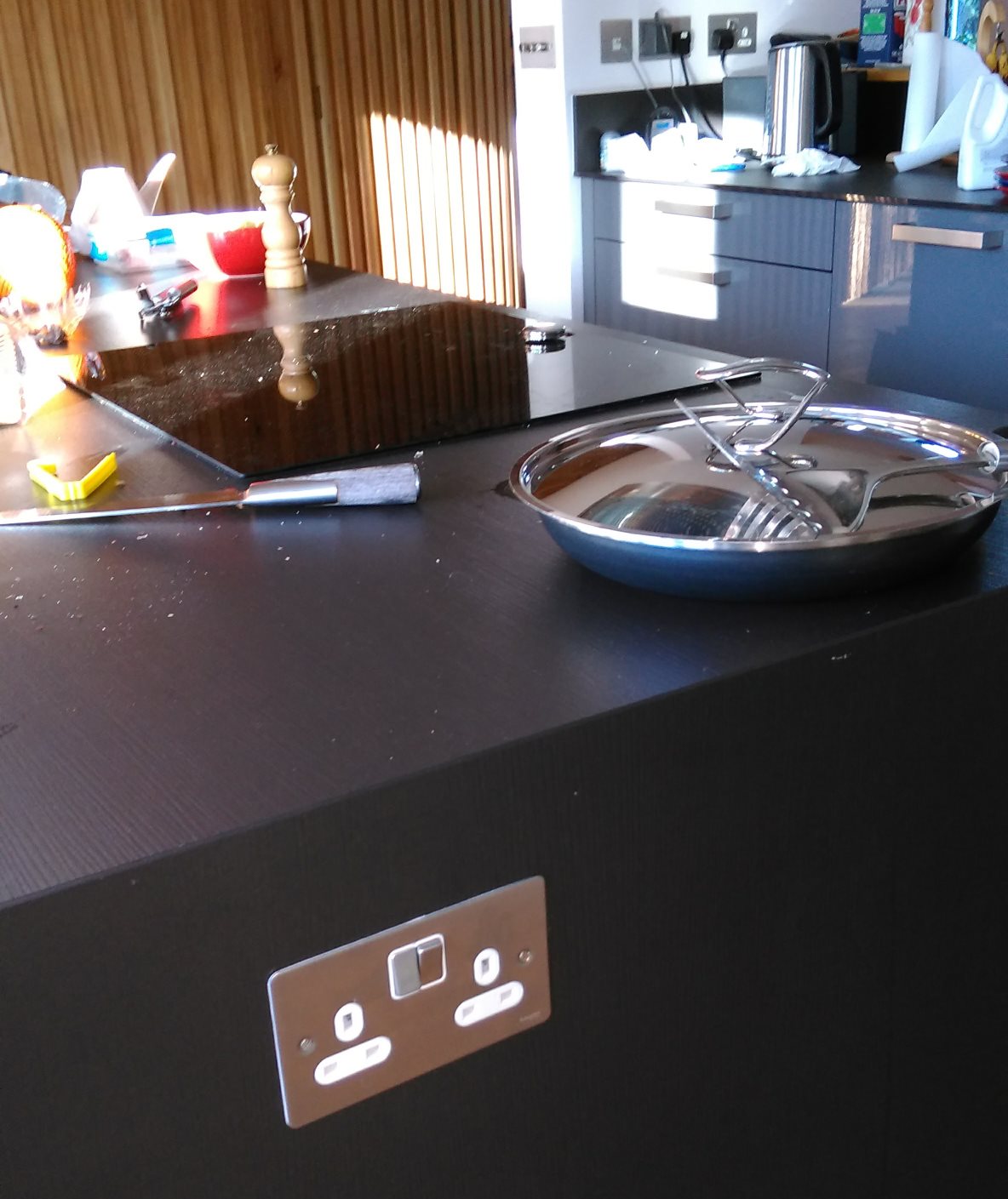

ragg987 Posted February 4, 2017 Share Posted February 4, 2017 I wanted to avoid pop-ups - felt it was too complicated, requires space underneath and is another moving part that might go wrong. Ended up with this - excuse the mess, this is post a late Saturday lunch. Looks very subtle IMO and this is in an open plan kitchen / lounge / diner. 1 Link to comment Share on other sites More sharing options...
volcane Posted February 4, 2017 Share Posted February 4, 2017 I did similar on the last house and plan the same for the new place only I fitted the socket face upside down to allow the cables an easier run to the surface of the island. Link to comment Share on other sites More sharing options...
Jeremy Harris Posted February 4, 2017 Share Posted February 4, 2017 (edited) 34 minutes ago, volcane said: I did similar on the last house and plan the same for the new place only I fitted the socket face upside down to allow the cables an easier run to the surface of the island. That makes a tiny bit more sense. For those thinking of putting sockets on the outside of an island, though, I'll just relate my experience in my workshop. I fitted 6 outlets just under the top of my bench, set back slightly so the plugs don't stick out, and to protect them a bit from any swarf etc falling on them (there's a lathe and a milling machine on top of this bench). I've lost count of the number of times I've accidentally snagged a cable and pulled a power tool off the bench. I know that I've broken a Dremel, bent a few drill bits and smashed a grinder disc doing this. I'm a reasonably careful adult. Just think of the consequences of trailing leads leading to things like kettles, coffee makers etc on top of the island if a small child was to tug on the cable, or even a dog or cat using the trailing lead as a plaything....................... Edited February 4, 2017 by JSHarris Link to comment Share on other sites More sharing options...
Barney12 Posted February 4, 2017 Author Share Posted February 4, 2017 1 hour ago, JSHarris said: I'm a reasonably careful adult. Just think of the consequences of trailing leads leading to things like kettles, coffee makers etc on top of the island if a small child was to tug on the cable, or even a dog or cat using the trailing lead as a plaything....................... Exactly why the idea wont work in our house. There is no way a trailing lead plugged into the side of an island is Cocker Spaniel proof! 1 Link to comment Share on other sites More sharing options...
Jeremy Harris Posted February 4, 2017 Share Posted February 4, 2017 1 minute ago, Barney12 said: Exactly why the idea wont work in our house. There is no way a trailing lead plugged into the side of an island is Cocker Spaniel proof! My personal view is that, even if it's fine for the residents (and pets etc) of the house right now, how safe would it be in the future? In our case, the power outlets will most probably be used to charge my other's half iPad (hence the reason for getting the one with USB outlets) so she can look at it whilst cooking, or for powering the little hand-held whizzer food mixer thing. Both probably low risk in terms of safety hazard if they were pulled off the work surface (although a small child and the food mixer thing would be a damned dangerous combination). The consequences of catching an iPad charging lead from a side-mounted socket and smashing it on the stone floor would be expensive and that was my main reason for fitting the pop-up. It so happens that it makes a very good iPad prop as well, making it easier to see the screen when cooking. Link to comment Share on other sites More sharing options...

ragg987 Posted February 7, 2017 Share Posted February 7, 2017 I agree with the safety points of side sockets - in our case these are meant to be "temporary" supplies whilst cooking - e.g. for plugging in the hand mixer whilst using it, then unplug and put away. The more permanent gadgets (radio, chargers etc) are kept away from the island. I also use a couple of the cupboard drawers as homes for some of the appliances - blender, toaster, juicer and the sort. Have wired 13A sockets inside the cupboard and we just pull the drawer out, use the appliance, then shut the drawer. No need to plug and unplug, no trailing leads and the mess is hidden away. Link to comment Share on other sites More sharing options...
