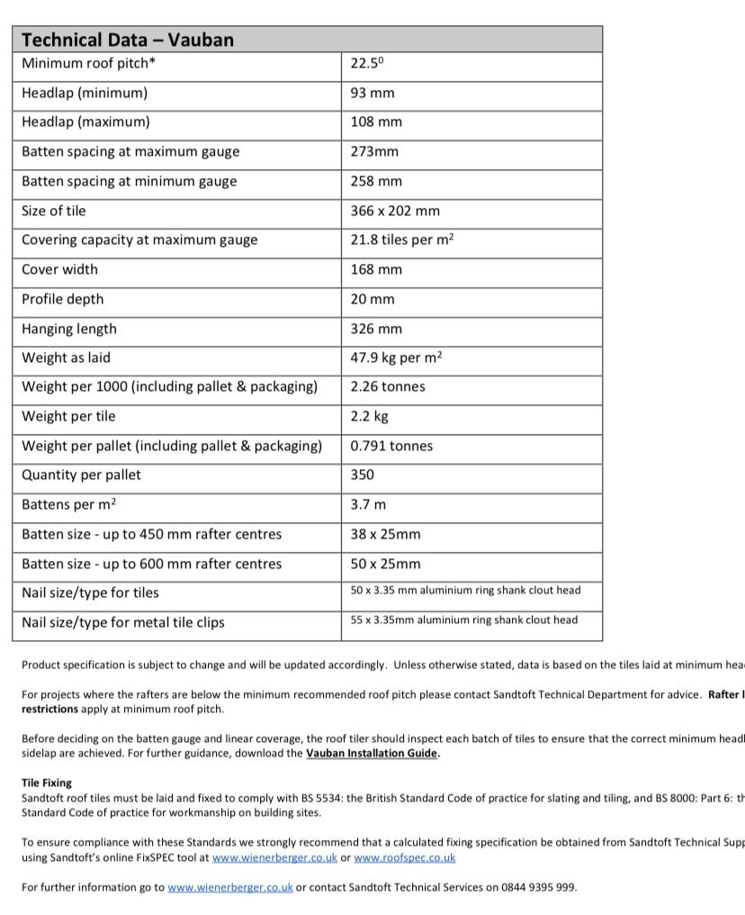

Adsibob Posted February 20, 2021 Author Posted February 20, 2021 Actually, just found this interlocking tile from Weinerberger Sandtoft called a Vauban that refers to the magic 168mm width as the covering width. Would this tessellate with my neighbour’s plain tiles? I attach the data sheet.
