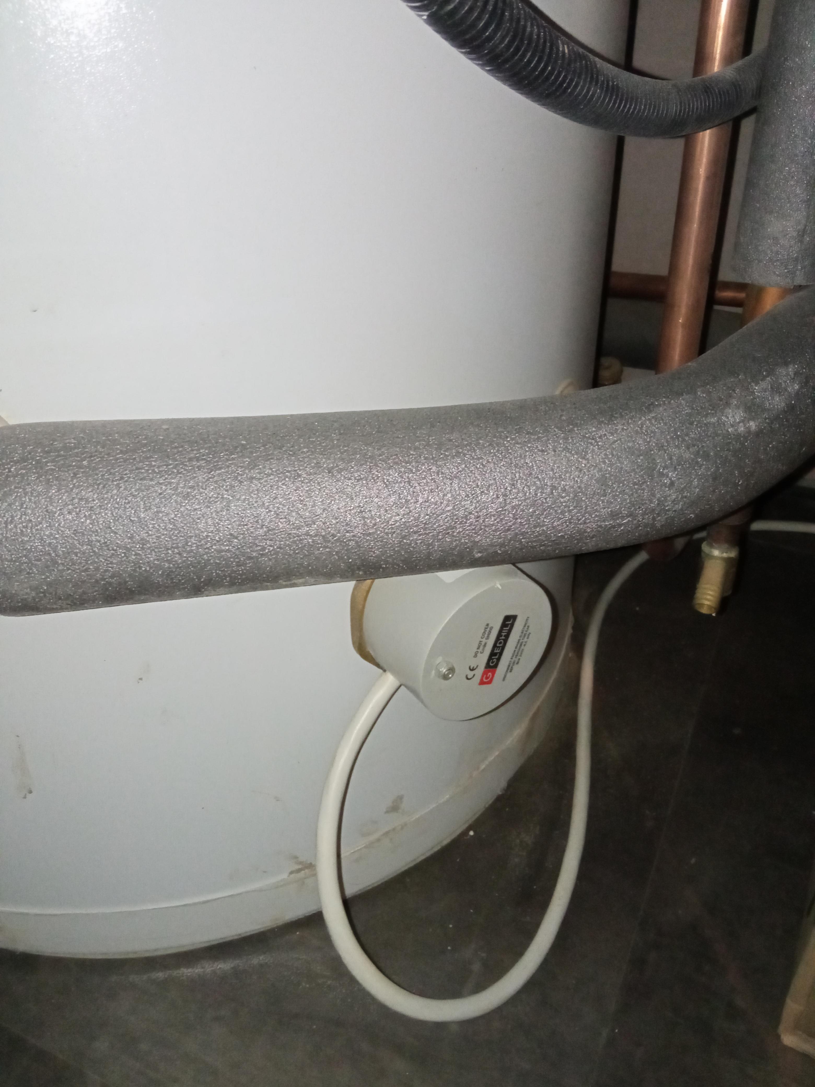

canalsiderenovation Posted January 19, 2021 Author Posted January 19, 2021 (edited) 33 minutes ago, TonyT said: Best get the current set up working first before the diverter is added into the mix, further complicating the set up/ energy consumption tracking process Unfortunately we don't have any choice. The electrician is back for two days to finish off before he goes into hospital for an operation and then won't be working for 12 weeks! @AliG the only thing on our tank that resembles your picture is this below wired into the heat pump and there is no temperature dial and I've literally had a torch all round the tank. Is it possible this is set by the heat pump? On the plus it does seem like since the excessive unit consumption on the immersion at some point between yesterday and 3:30pm today now seems to be likely to have been the legionella cycle as having just now taken another reading the immersion meter reading is the same as 3:30 so I'm hopeful that now I've deactivated it, it won't happen again. I'll keep monitoring that. Edited January 19, 2021 by canalsiderenovation 1

AliG Posted January 20, 2021 Posted January 20, 2021 8 hours ago, canalsiderenovation said: @AliG the only thing on our tank that resembles your picture is this below wired into the heat pump and there is no temperature dial and I've literally had a torch all round the tank. Is it possible this is set by the heat pump? That's good, so as you say the heat pump sets the hot water temperature and the immersion is used for the legionella cycle. Just switching off the legionella cycle should eliminate the immersion use and you should be sorted. 1
