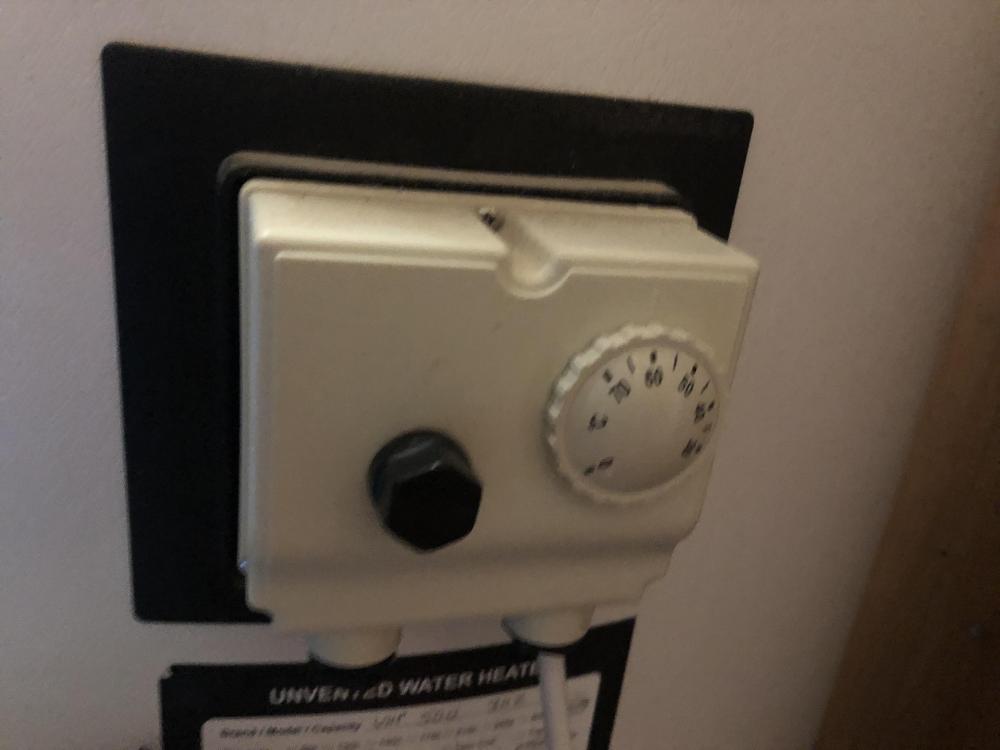

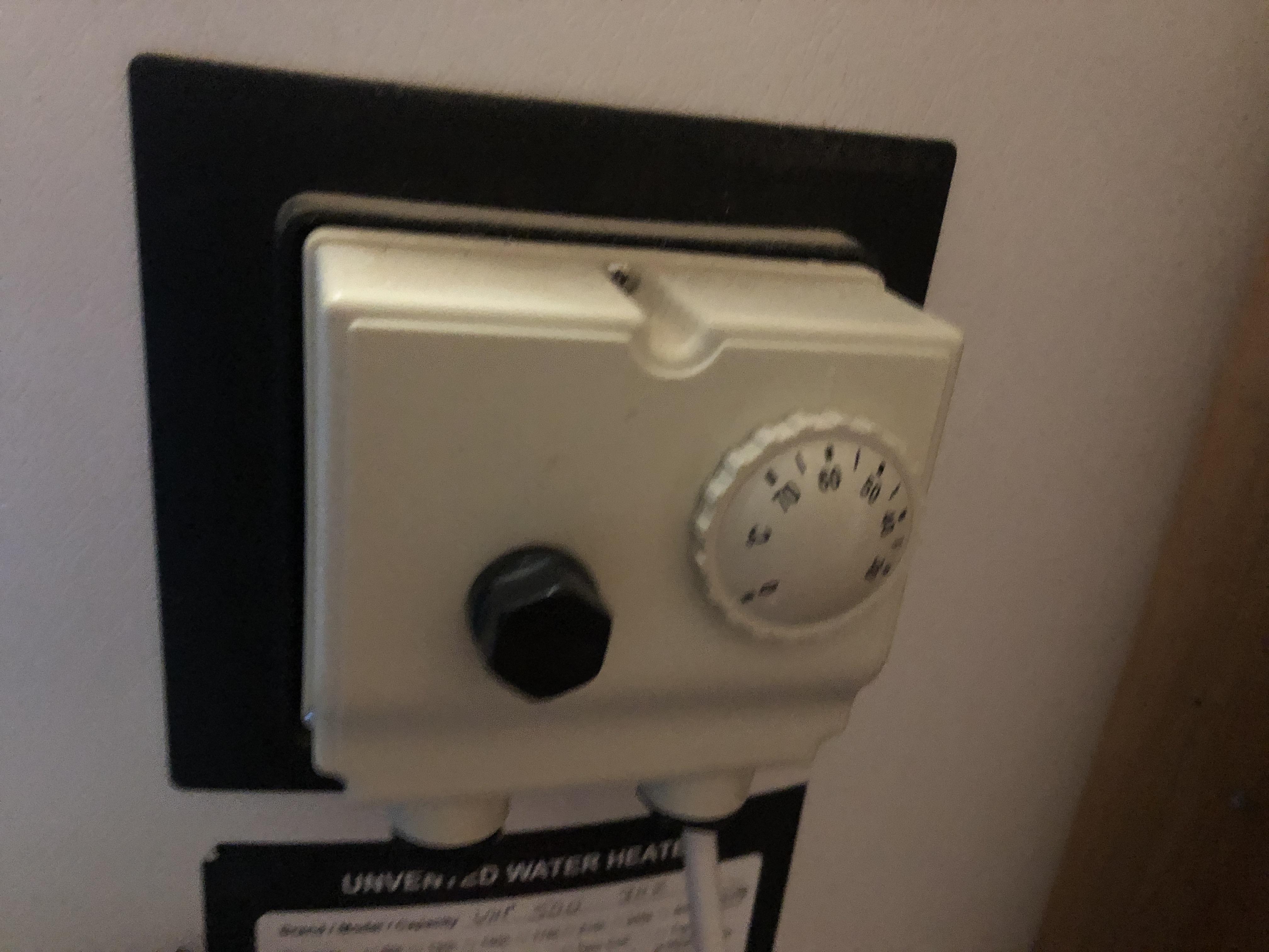

Is there something that looks like a thermostat on the side of the hot water tank. It is a little grey box with a circle you can turn to change the temperature on ours.
If this is set much higher than 48C I wonder if the immersion kicks in to finish off heating up the wate, either that or as you posted it keeps trying to heat to 60C and not getting there

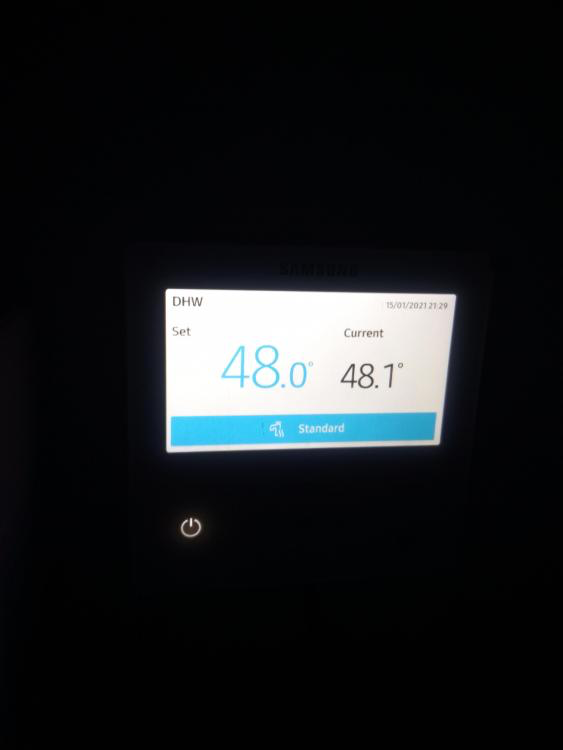

That pic is the main screen.
That is what is on the main screen, which I've just checked again and this is what is on the main screen.
There is then the additional option under advanced settings under the *302 menu to change the heat pump DHW max temp which was set at 55 degrees which I've also reduced now to 46 to match the home screen. Seems there was some conflict there.

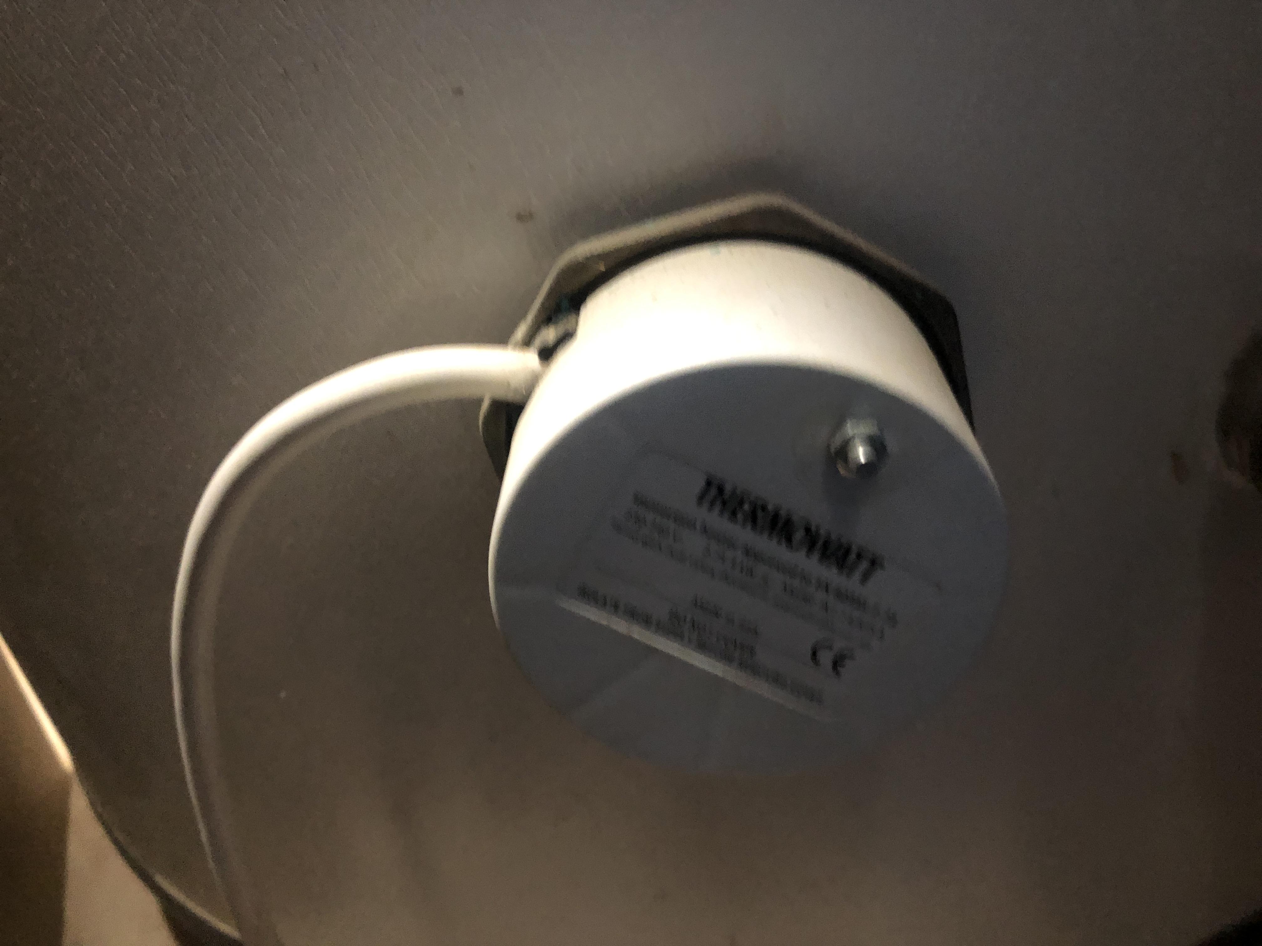

The immersion will be set into the side of the tank with a wire coming out of it. It might be wired into the ASHP due to the legionella cycle. Simply switching that off may sorry things out.

I can't see any wire, just this (excuse the dust)IMG_20210119_203721.thumb.jpg.274810e917abe36daa461f11710548dd.jpg
I remember when I set up my ASHP I found it wanted to only heat the DHW part way with the ASHP then turn on the immersion heater.  It took quite a lot of settings to disable that and heat it just with the ASHP.
