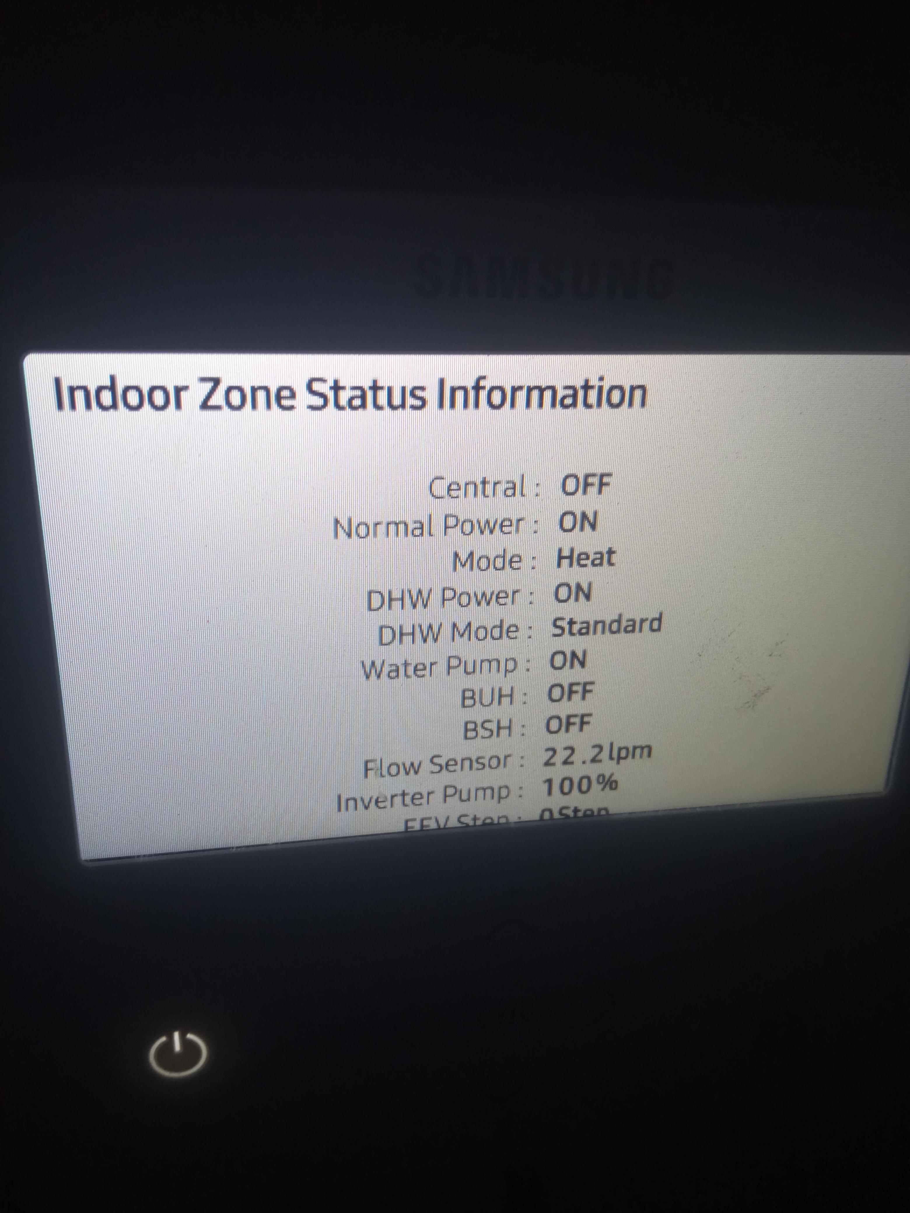

48 looks to malice the DHW temperature which is OK. You can see it is hot water in the top left hand corner.
However, Water Law seems to be Samsung's catchy name for weather compensation. This is switched on and it looks to me like your UFH flow temp is running at 56C currently (water outlet on the water law page). I am not sure how to switch it off and just set a flow temp. I tried reading the manual but it is not easy going.
The Water Law setting that you have at 0 I think adjusts relative to whatever temperature the weather compensation has been programmed to give out. I believe from Google that this can be set between -5 and +5, but you can see what it will let you set. Thus if you set it to -5C then your flow temp should drop by 5C.

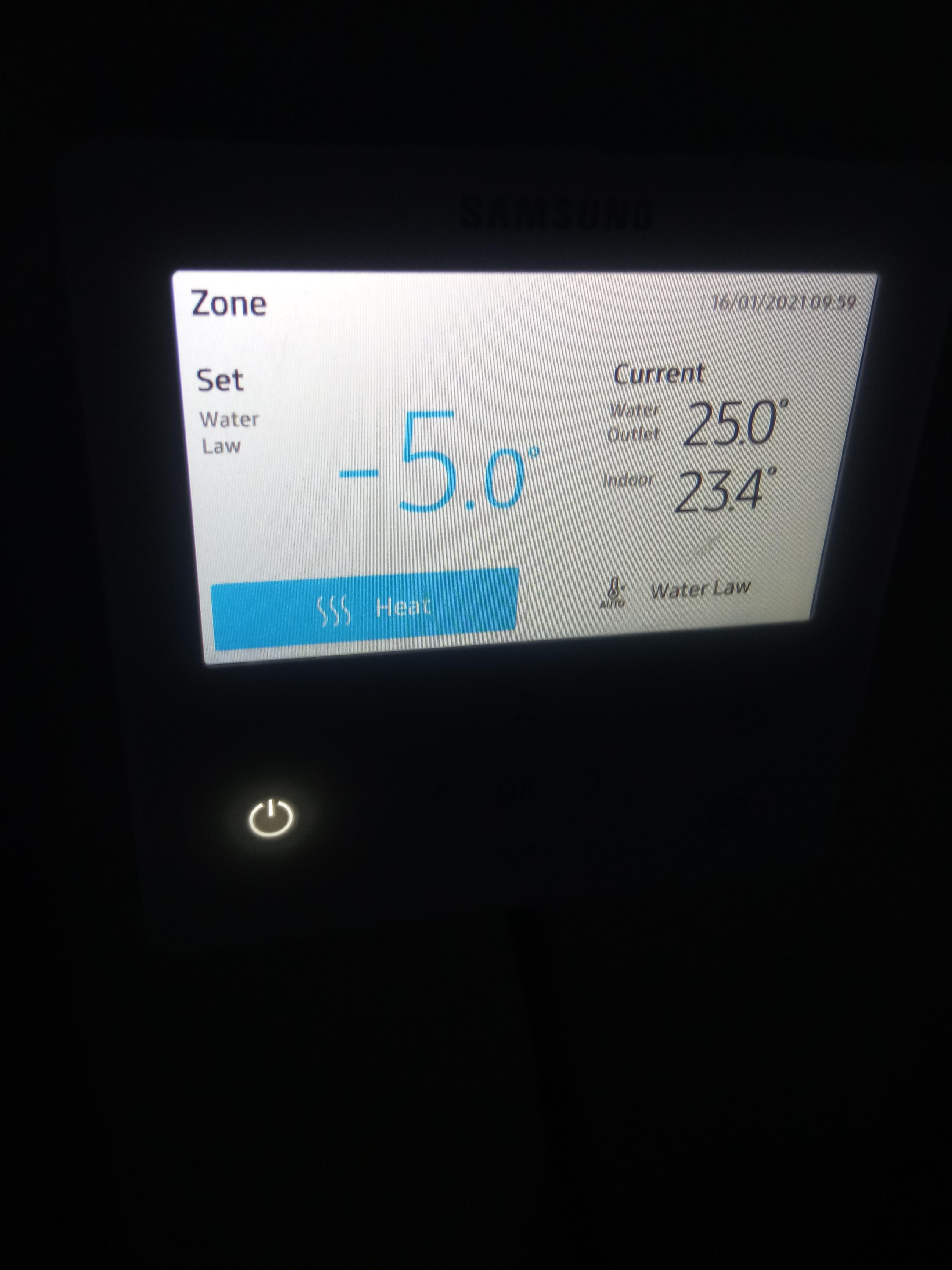

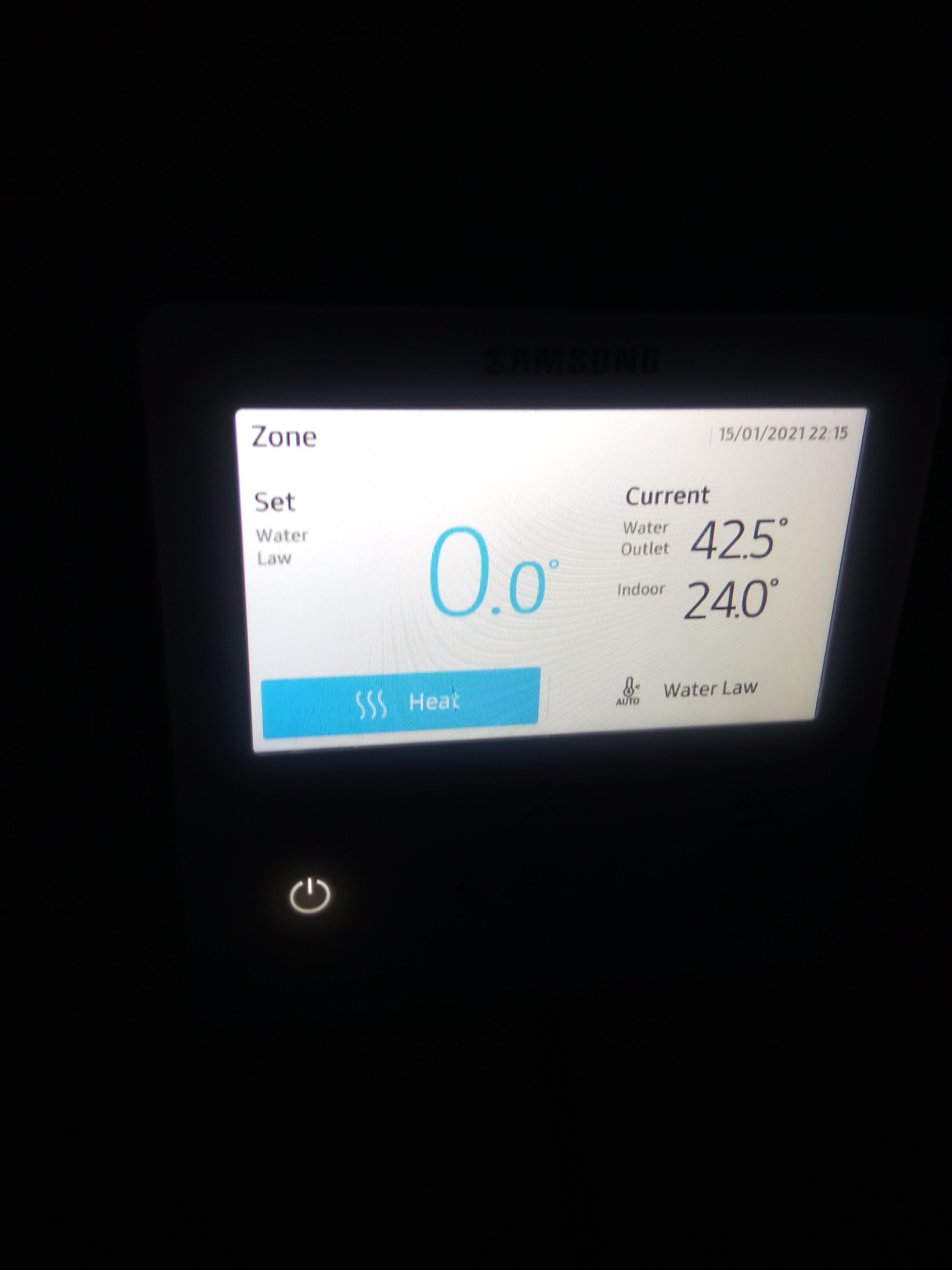

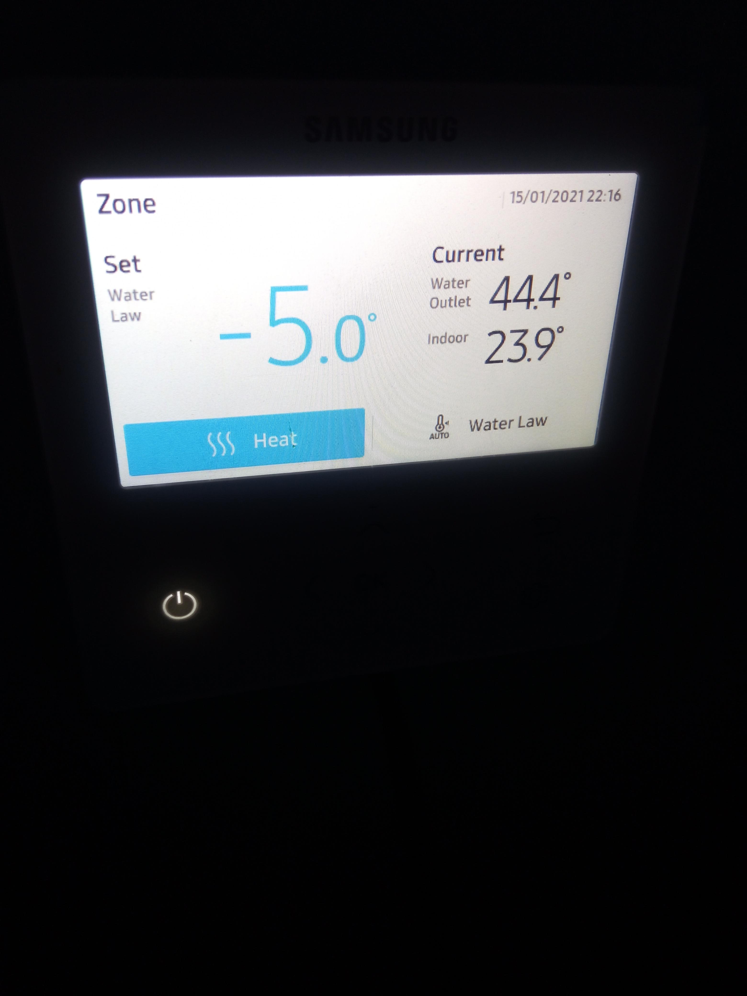

I did some adjusting. So when I went in just now it was zero.
I then adjusted the temperature to minus 5 and got this.
And you are right it only goes +5 and -5 it won't go any more or below.

The flow temperature will go up and down depending on the outside temp. It seems a lot lower than it was earlier.
I think quite a few people don’t like the weather compensation option because of this but someone with an ASHP can probably answer better.
Nevertheless setting it at -5 will have it running a bit cooler which should mean a better COP and is a start.
I'll set it at -5 thank you.

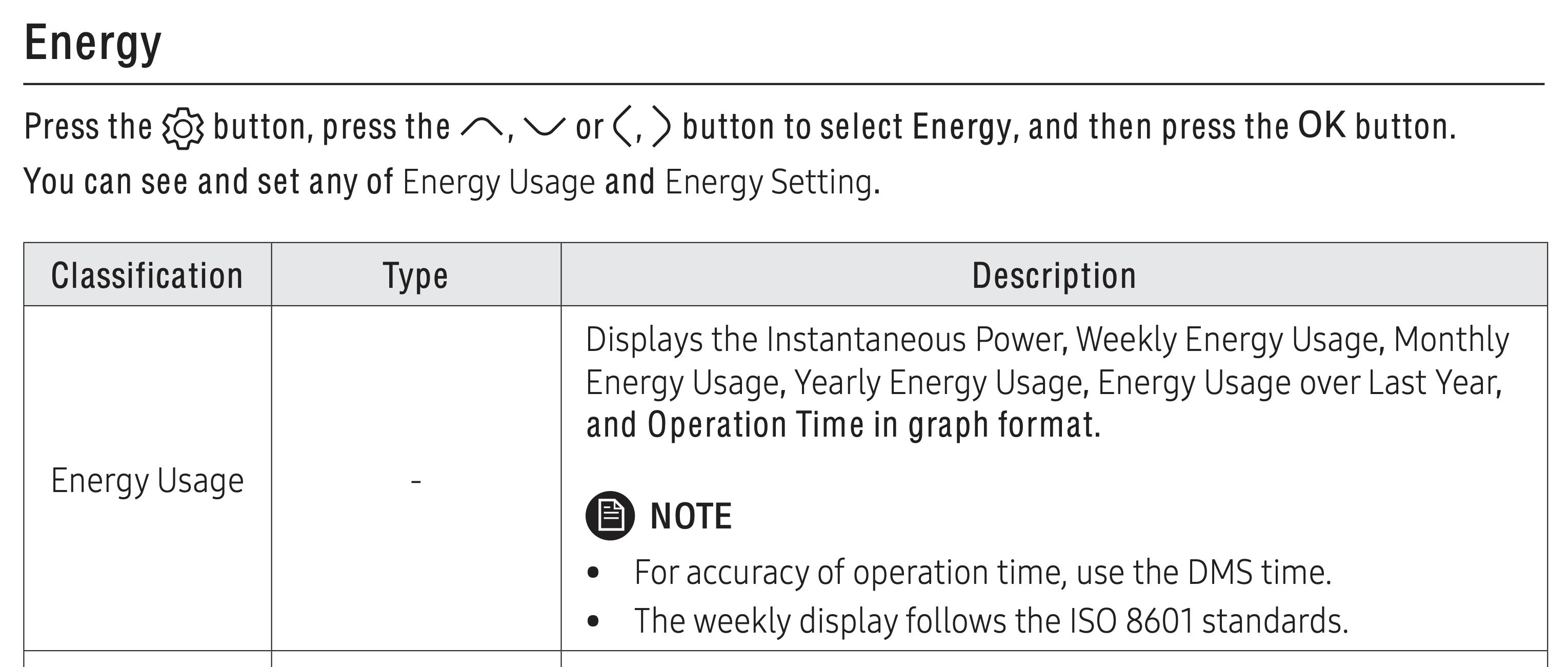

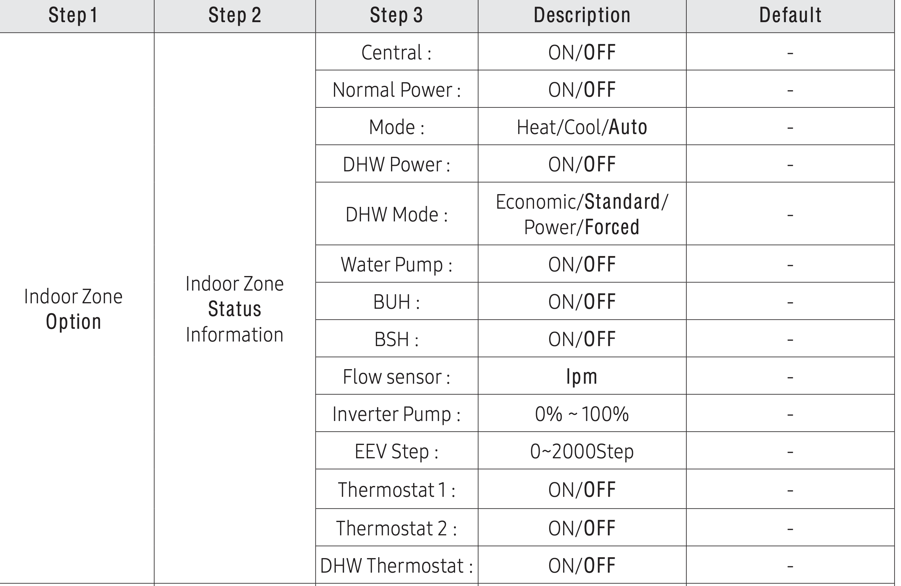

I have had a further read of the manual.
P11 gives instructions on showing the ASHP's energy usage. perhaps you can use this to see how much electricity it has used in the last week.
You should be able to turn off "Water Law" from the zone page and change it to Heat mode where you can set the Water Outlet temperature. If it is locked and you cannot do this, p13 of the manual describes how to remove the function lock that may have been switched on by the installer.

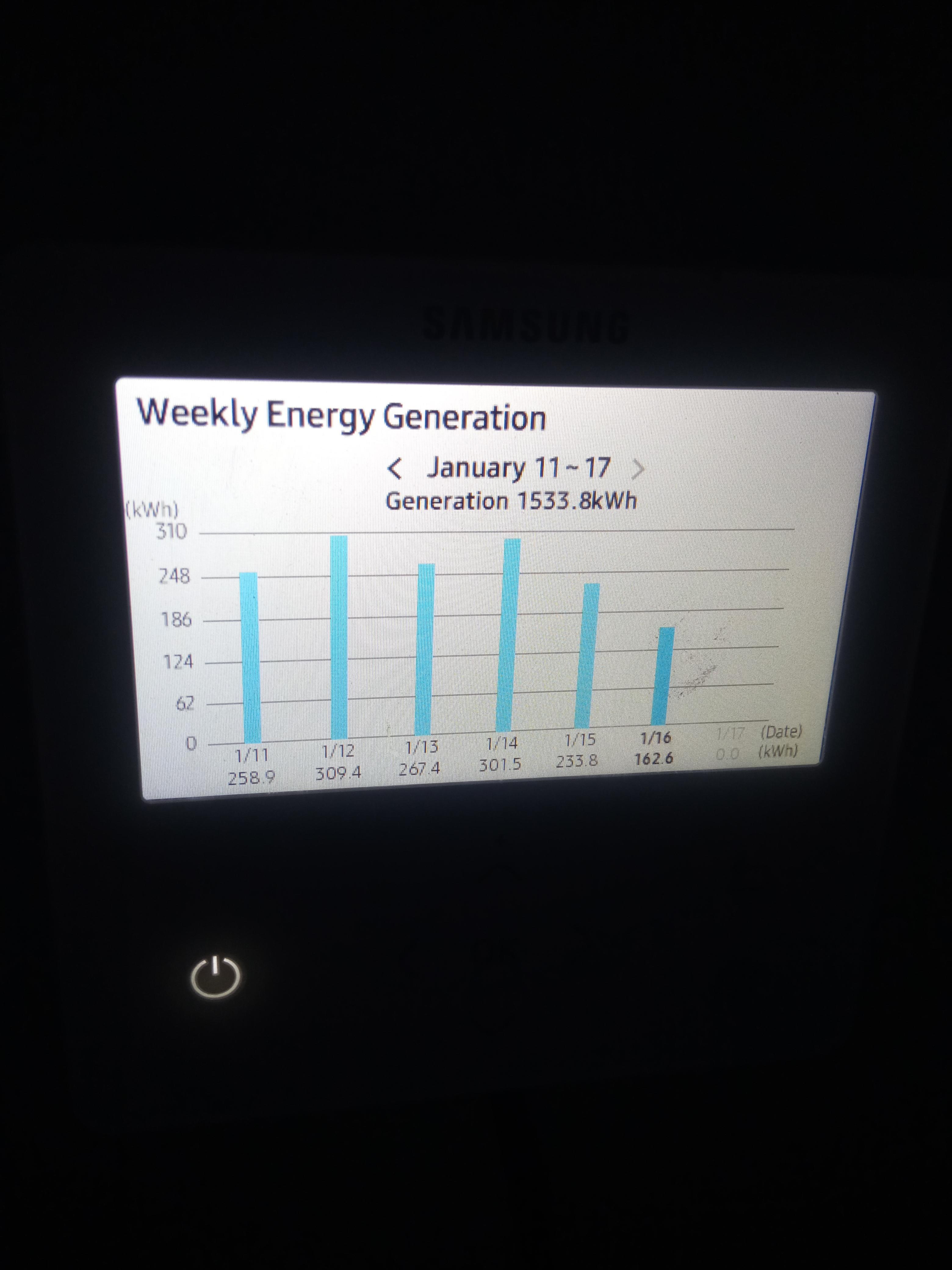

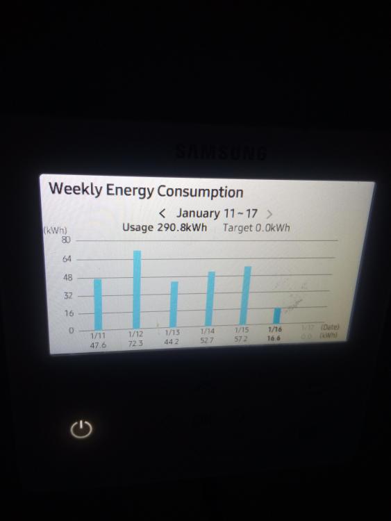

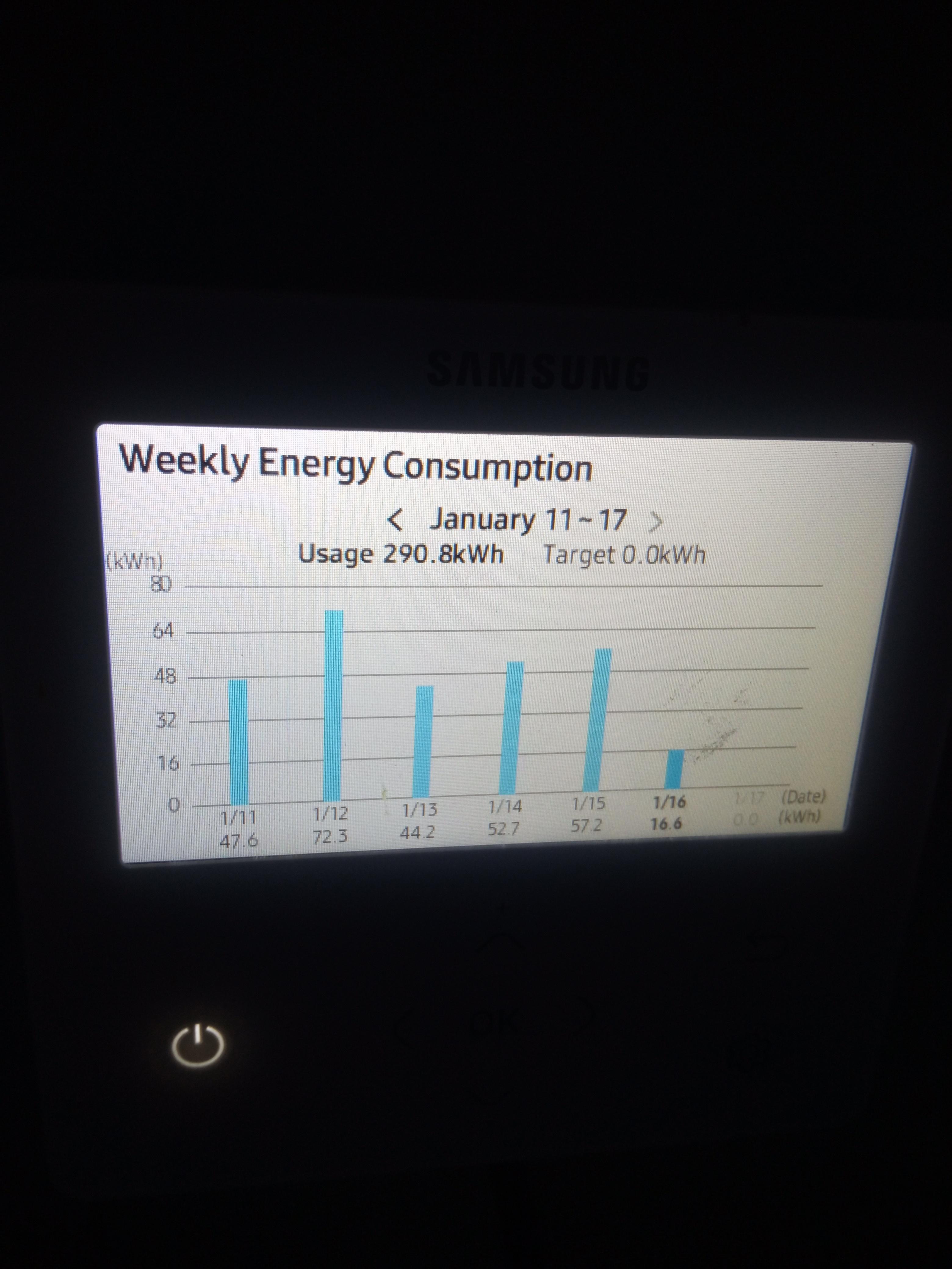

Ok so woke this morning and after changing that setting to -5 this is the screen:
I also found the energy setting info:
Consumption:
Will be interesting to see what happens for the next week now.
Operation:
Generation:
I haven't messed with any other settings yet.

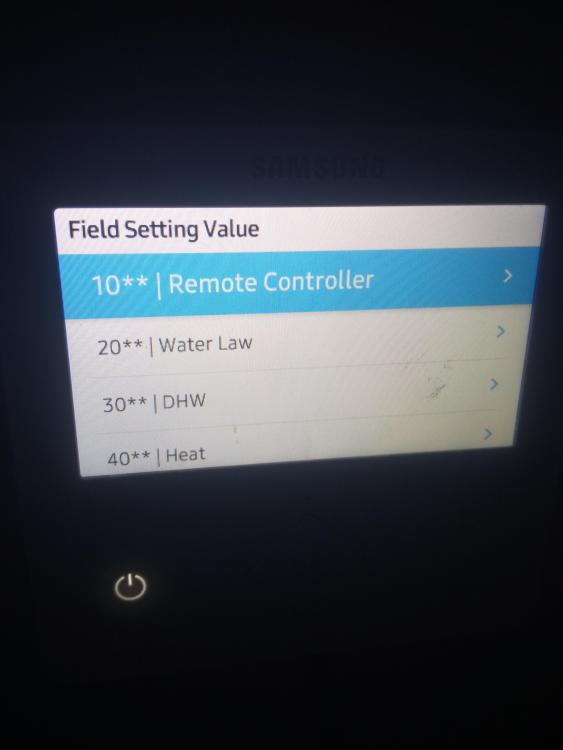

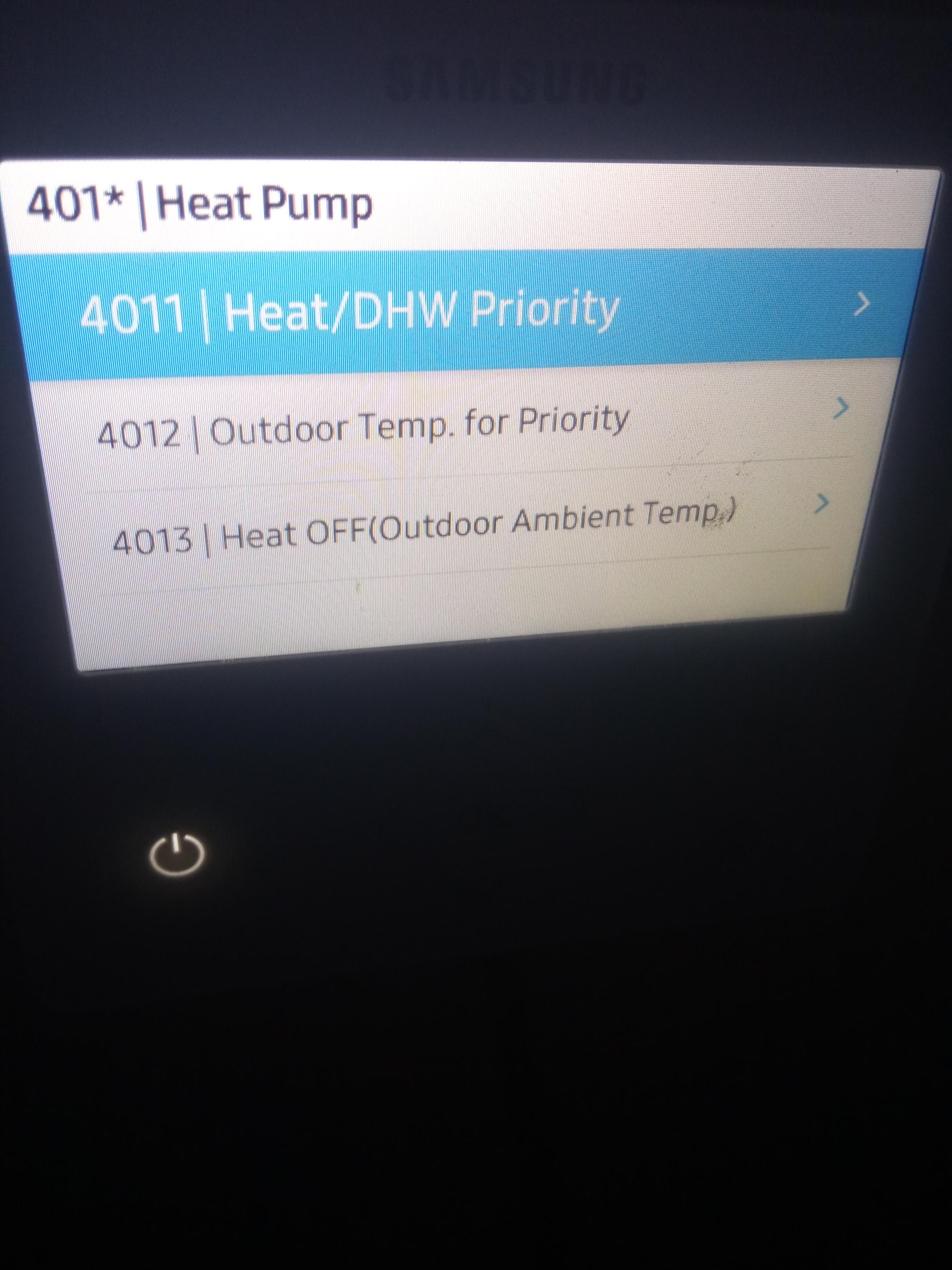

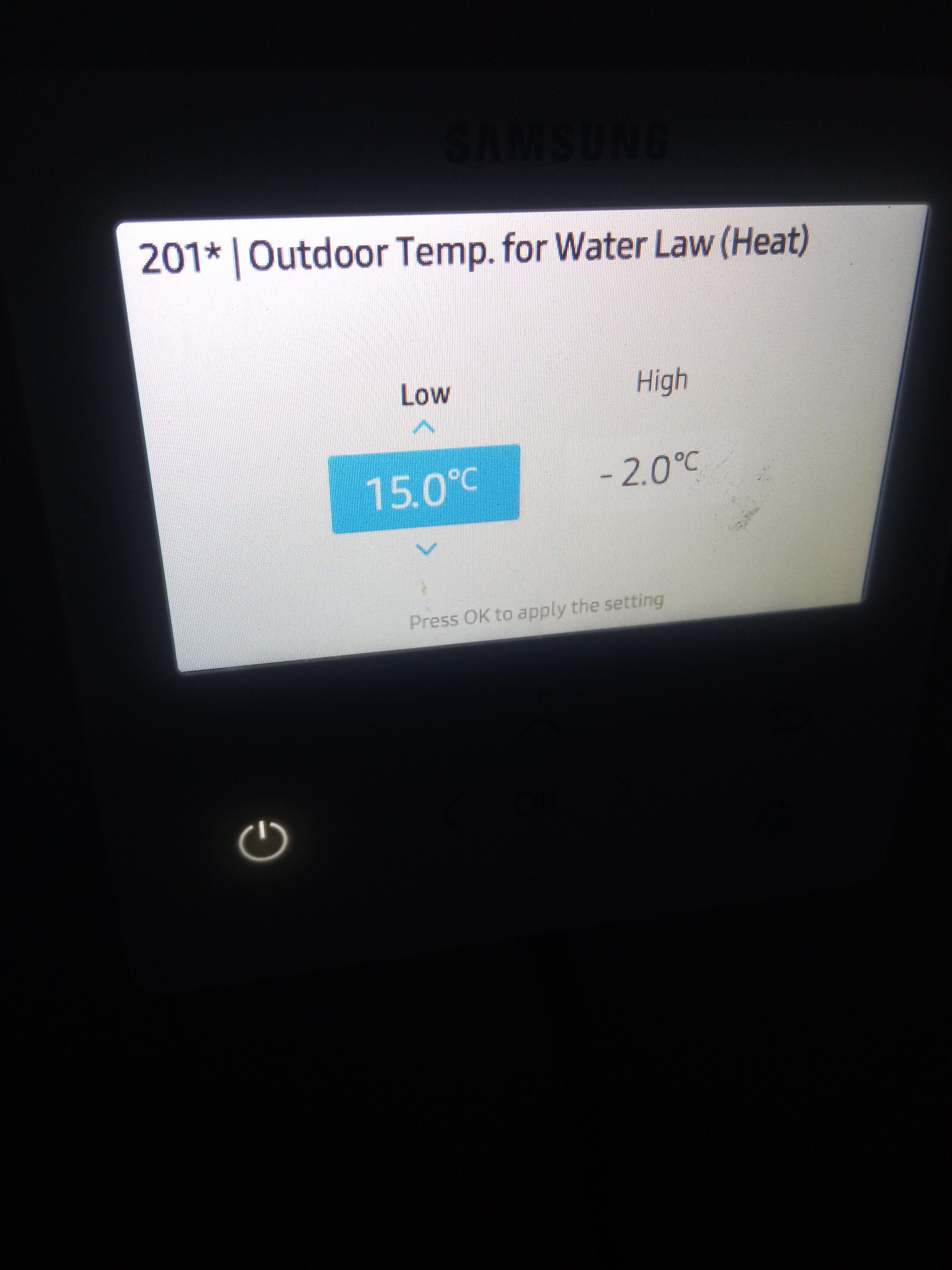

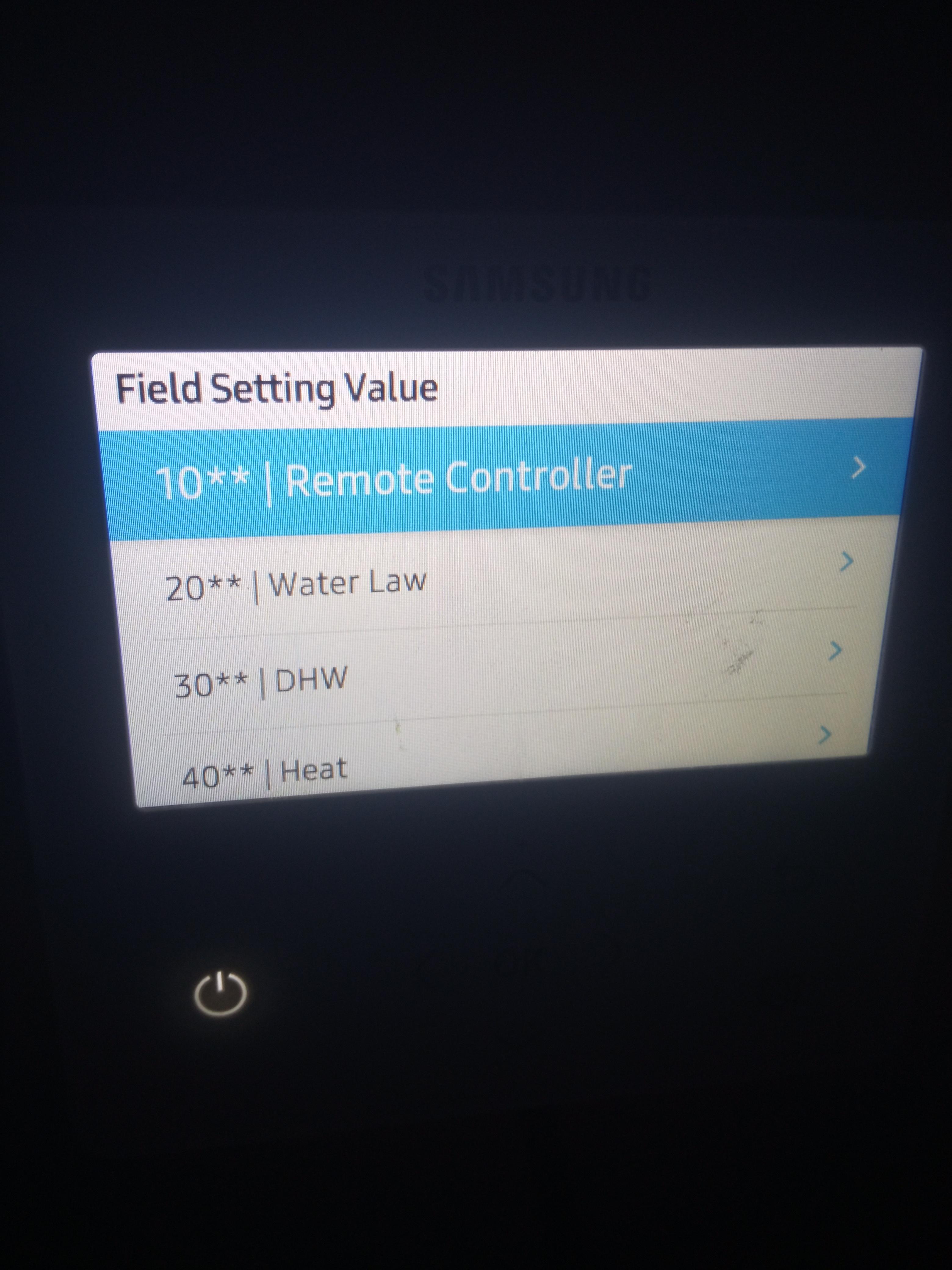

Right, managed to access the installers menu. Lots of options. Any suggestions... @AliG
I've got the manual but to be honest it's far more complicated than the actual screen.

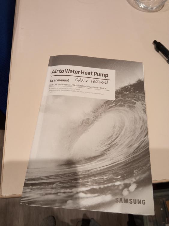

15 hours ago, canalsiderenovation said:
Is 0202 a passcode
Just need to find out where to punch it in.
Just now, SteamyTea said:
Is 0202 a passcode

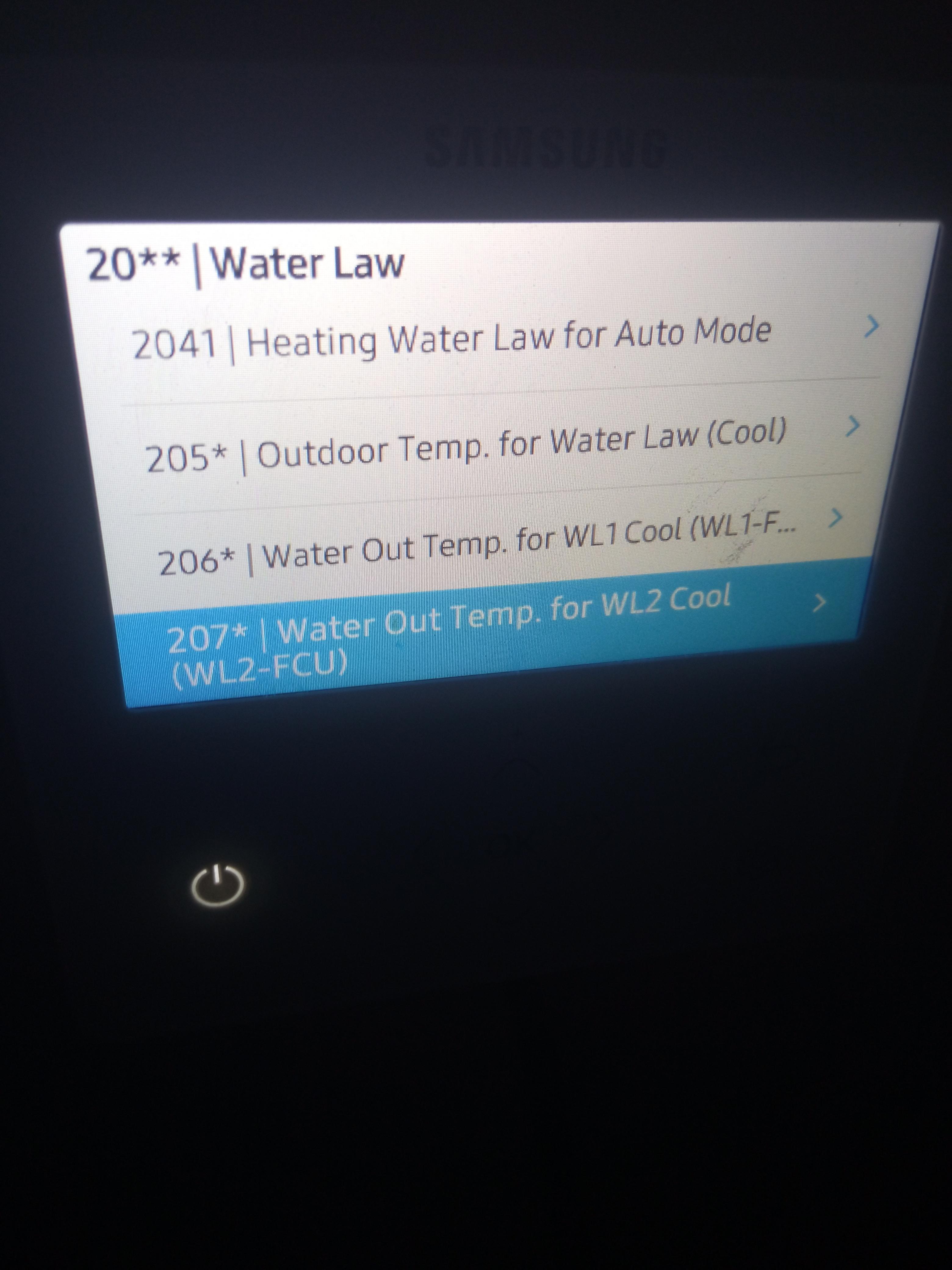

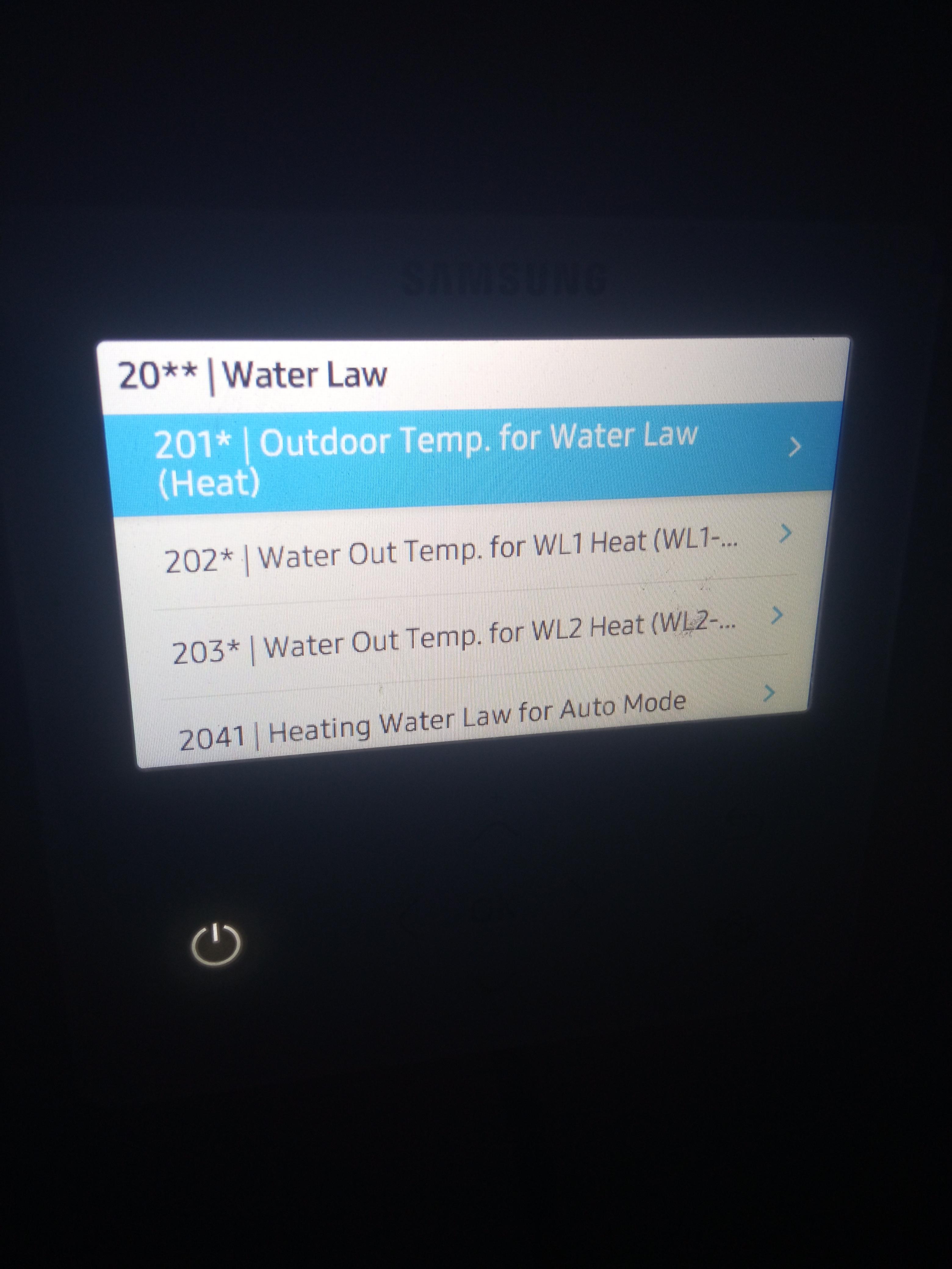

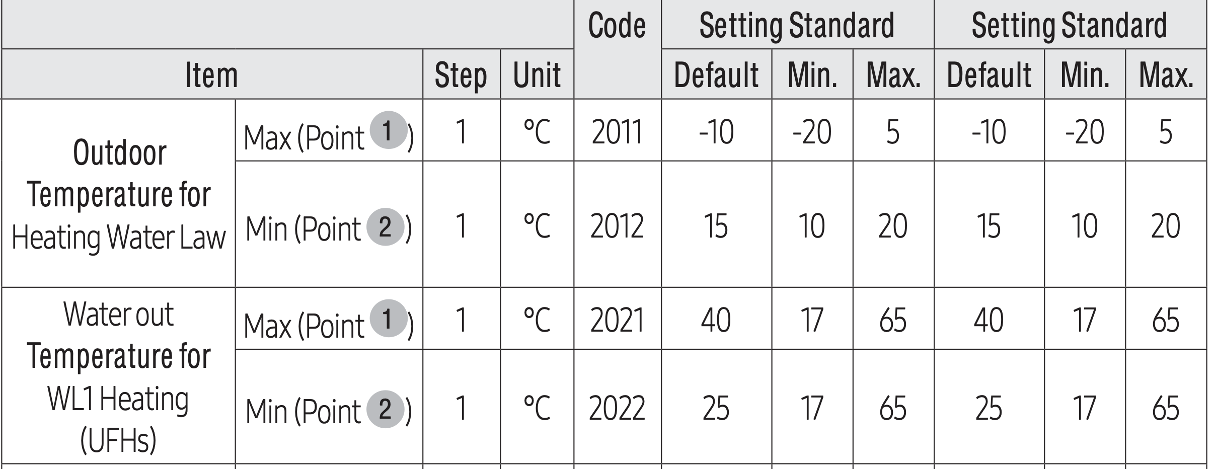

Got it, I actually wrote it down ? you have to hold the ^ and down button at the same time for about 5 seconds and then it prompts you. That's how I accessed the menus above. If you then don't touch anything for 2 seconds it locks again!

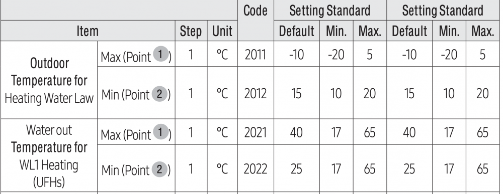

20** are the Water Law settings.
You could look here to see what curve they have programmed.
2021 is the max Water Out temp
2022 is the min Water Out temp
2011 is the outside temperature where the max temp is hit
2012 is the outside temperature where the min temp is hit
I would guess that they have considerably raised the default temperatures. If you think about it, they don't want hassle after the system is installed. People will notice a lot faster that their house doesn't get hot than they are using more electricity than expected and so the tendency is probably to set flow temps too high.
As ASHP owners have said, theoretically weather compensation would cut your bills. Ideally you are always using the lowest flow temp required to heat the house which maximises your COP, but this would need careful setting. However, you use a lot more energy when it is very cold than when it is say 7-10C, thus setting a fixed flow temp that works when it is cold is probably the easiest way to start. As @ProDave said you could then set this as the flow temp at the low end of the weather compensation curve and a lower temp at the high end of the curve but this would require a lot of experimentation.
Edited - 2041 is UFH/Radiator setting not WaterLaw off or on
Now that you are in installer mode you should be able to change the mode from Water Law to Heat as shown on P18. First I would be interested to know what the flow tempsthey have set in 2021 and 2022 are.
Edited by AliG

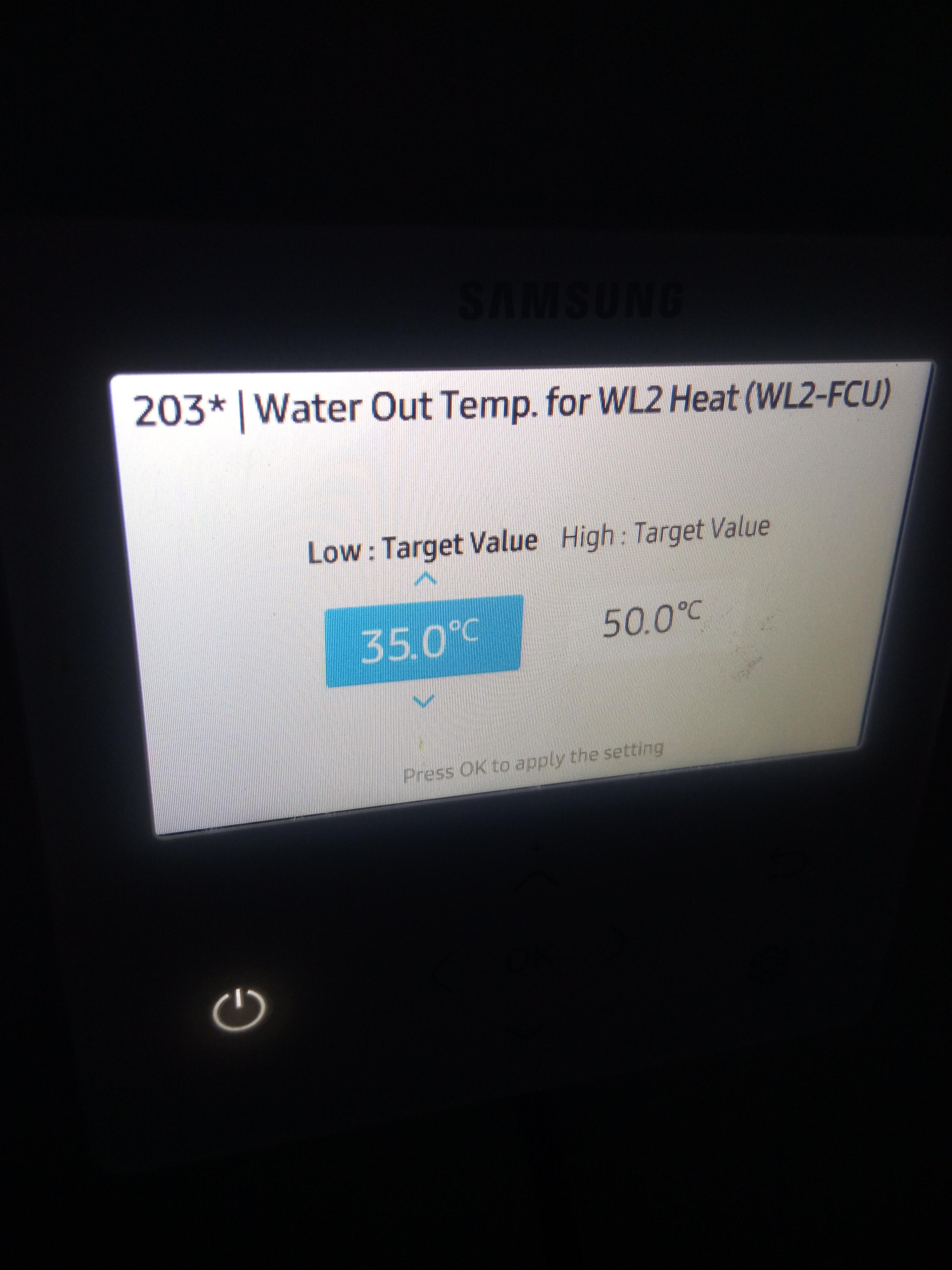

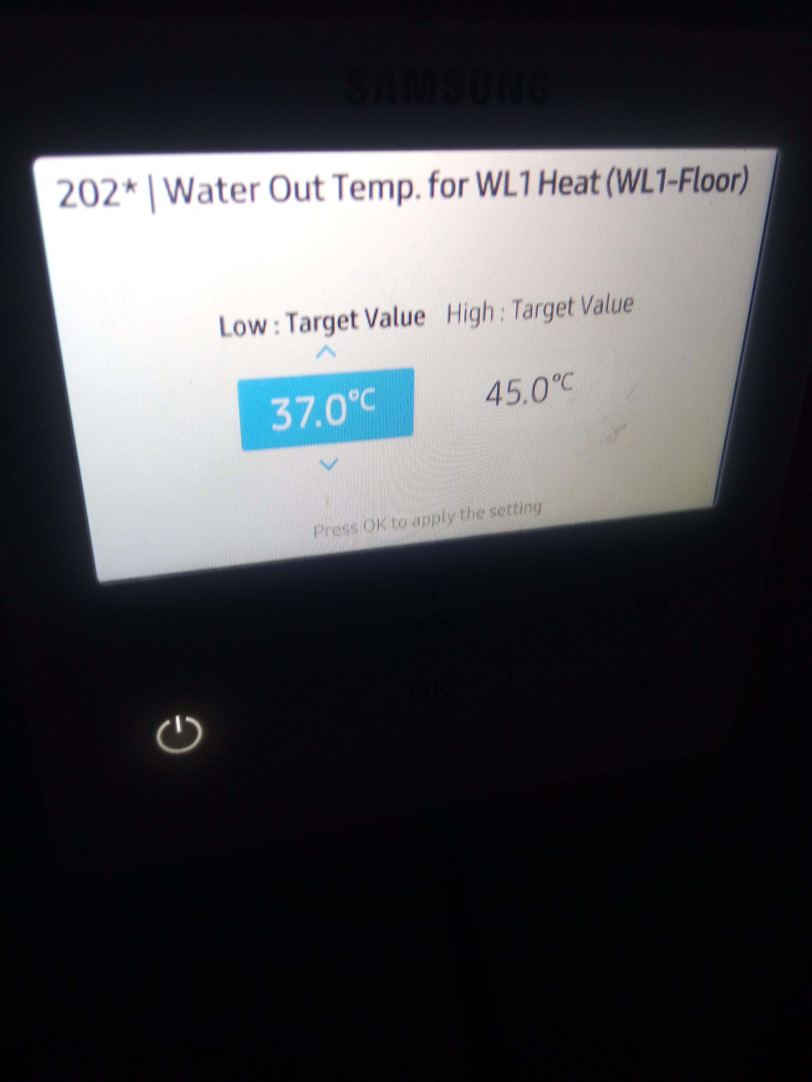

So at -2°C it’s trying to give you 45°C water into the floor. What is the mixer valve on the UFH set at ..??
I would be looking at -5°C High and 10°C low, and 35/42 as the values.

TBH those settings look OK.
I am not clear why the flow was 56C the other day if it is set at 45C max. Maybe it was heating hot water at the time.
Considering those settings I would just set the Water Law setting to -3C which would theoretically give a maximum flow of 42C and set your thermostat at 21C and see what happens.

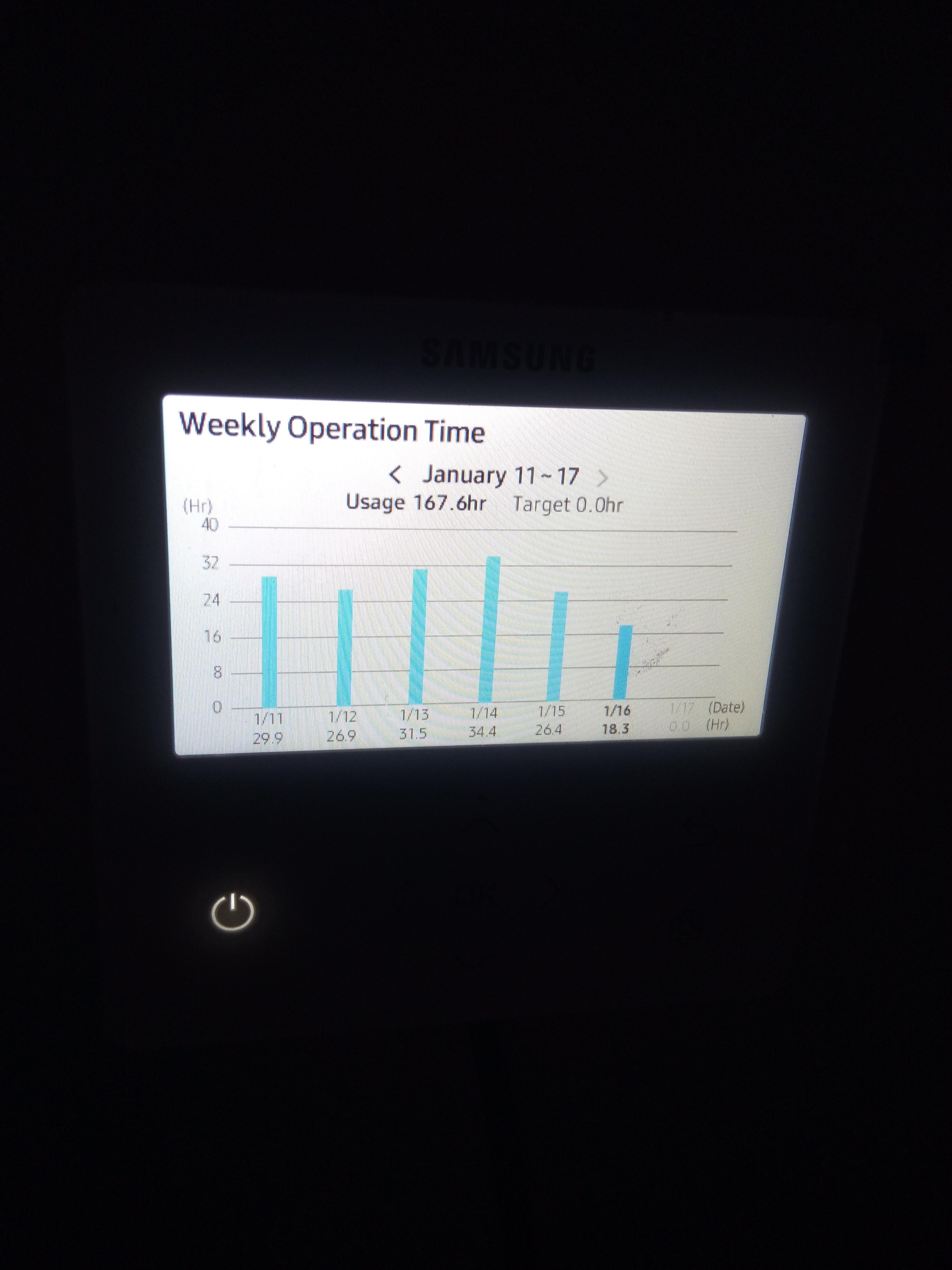

It looks like the ASHP was averaging just over 50kWh a day before the 16th when you were fiddling with it. It is not that far above the 45 a day I was estimating. That suggests that you are using 20odd a day for other electricity which is quite a bit higher than the 300 units a months you said you were using before the renovation. You might want to investigate that.
Maybe the 300 was average over a year and you are using more because it is darker, or maybe you have treated yourself to an 85inch TV over Christmas. It does seem a bit high. I don't think our electricity usage is that much higher in winter than summer.
