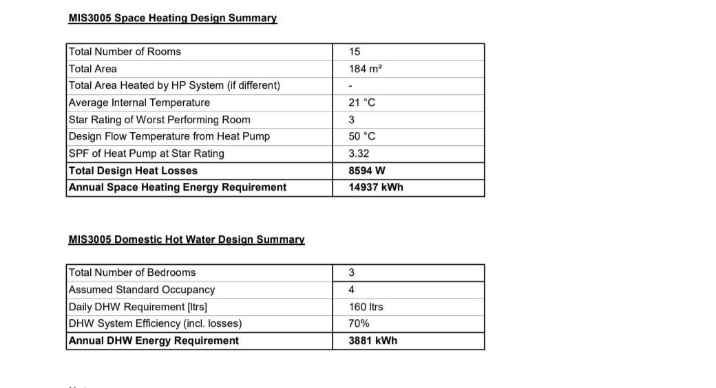

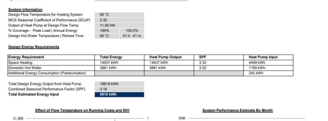

Did your installers not do a heat demand summary? This is the first page of the summary I received from an MCS installer when I asked for a quote. It was produced using the MCS software.
If it appears to be using much more electricity than you were led to believe I would contact the installers.

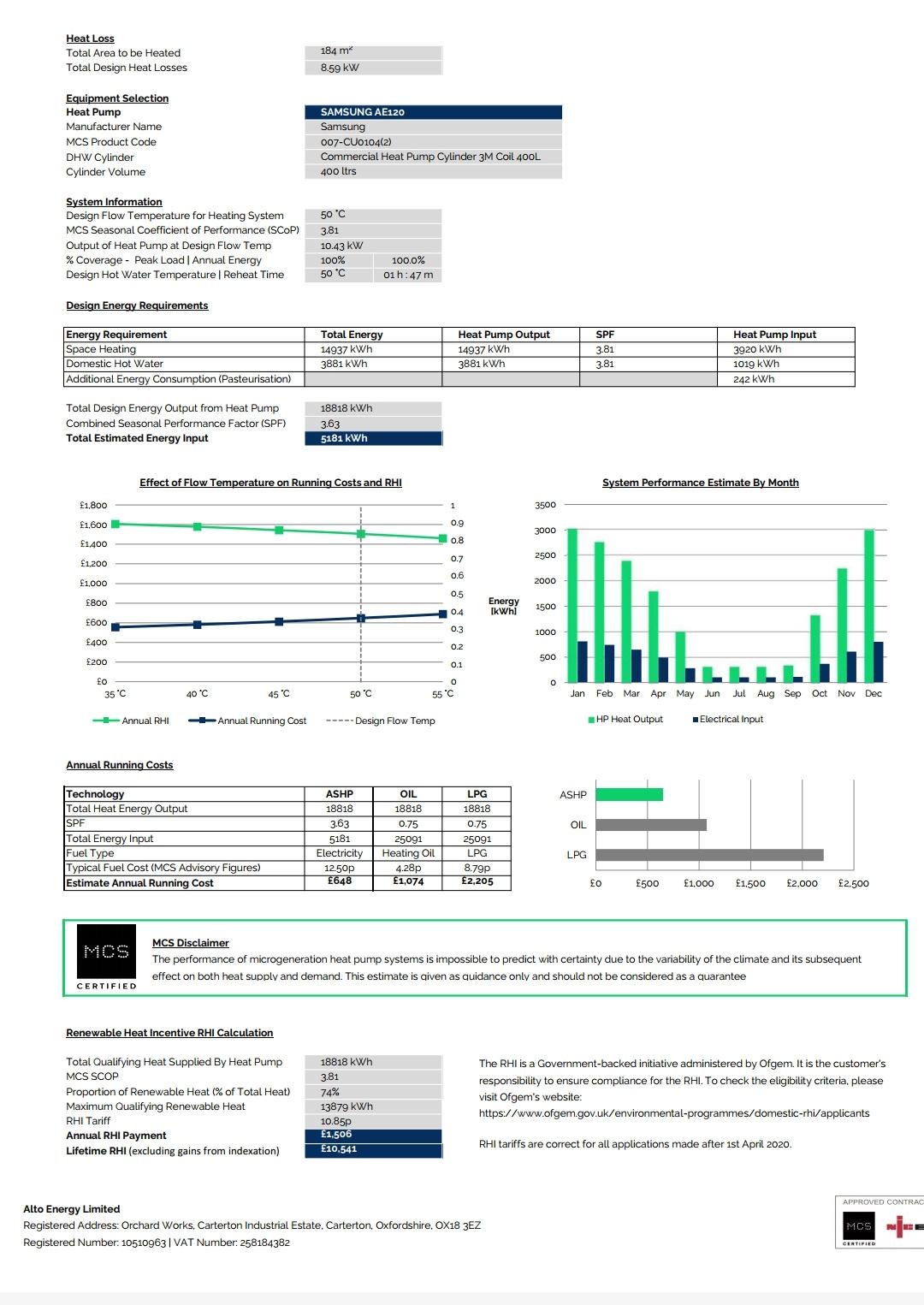

I'll check our variable tarrifs. I've found some information from the MCS installers.
IMG_20210115_140958.thumb.jpg.84e727e96b3647dac0a5412065a4d637.jpgScreenshot_2021-01-15-14-02-31-515_com.google.android_apps_docs.thumb.jpg.a09b1cbc3189ab0d1f1dfd30bd5ac451.jpg

Dropping the temperatures from 22 to say 19C will reduce consumption but not by a huge amount. If its 0C outside the temperature drop through walls and windows changes from 22 to 19 so I would expect consumption should go from 586 units/week to 586 * 19/22 = 506 units/week at best (as the DHW demand hasn't changed).

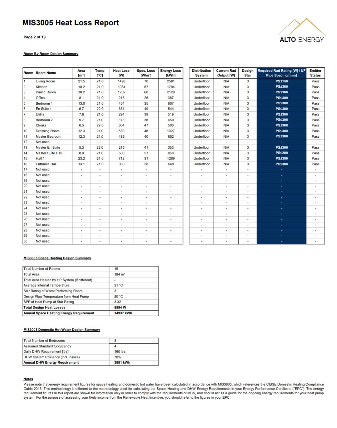

"Total Design Heat Loss 8594W"
Assuming that is how much they have calculated the heat loss of the whole building to be and assuming we are at the coldest temperature now so you will be running at that level at the moment.  also assuming that is all delivered 24/7
So 8594 at a COP of 3 for the heat pump, would use 2864W of electricity.  So in a week that would use 2.864 * 24 * 7 = 481kWh.  Then add on hot water heating and "other stuff" and your total usage for the week does not unfortunately look unreasonable.

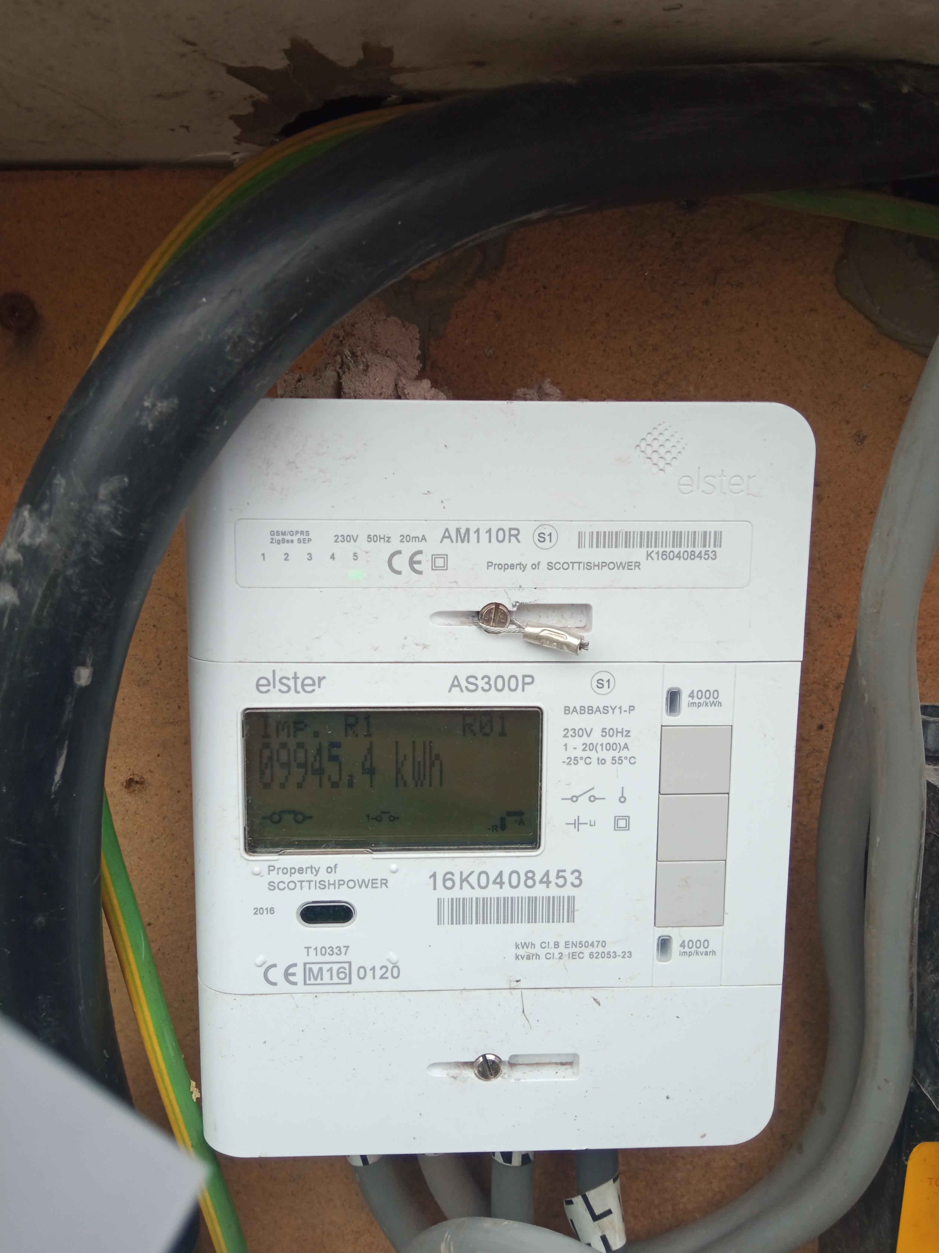

Ok so I just spoke to Alto and they told me to take the meter readings from the H/P and immersion and to keep a record of this along with my normal electricity meter reading.
So:
HP 11903.98
Immersion 0155.14
Electricity reading 09945.3
Reduced all thermostats to 19 degrees and will monitor for a week.

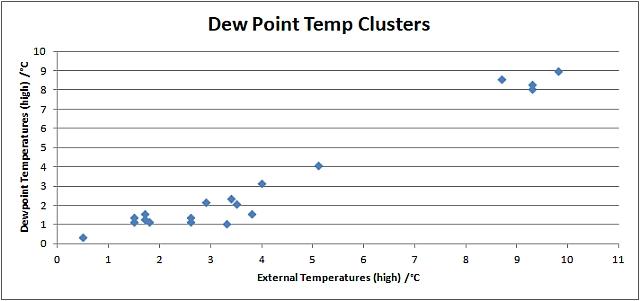

Just before I go off to work, thought I would have a look at your local temperatures.
Got some data from Whitchurch, which is fairly close to you I think.
Looked at the highest air temperatures on any given day, and the highest dew point temperatures on the same day.
Then plotted them.  This will give the best case.
Time period is 28/12/2020 to 15/01/2021
As the majority of the data points were between 0°C and 4°C, this is about the worse point for an ASHP to be working (there has been a few comments about them freezing up)

Thanks @SteamyTea yes we are in Whitchurch (as long as you have the Whitchurch in Shropshire not any of the others)!
Let's see how we get on over the next week and I'll monitor. I wonder if we just have had the house very hot unnecessarily! We haven't got our external wall insulation yet and hopefully once the solar is up and running it will fair better.
