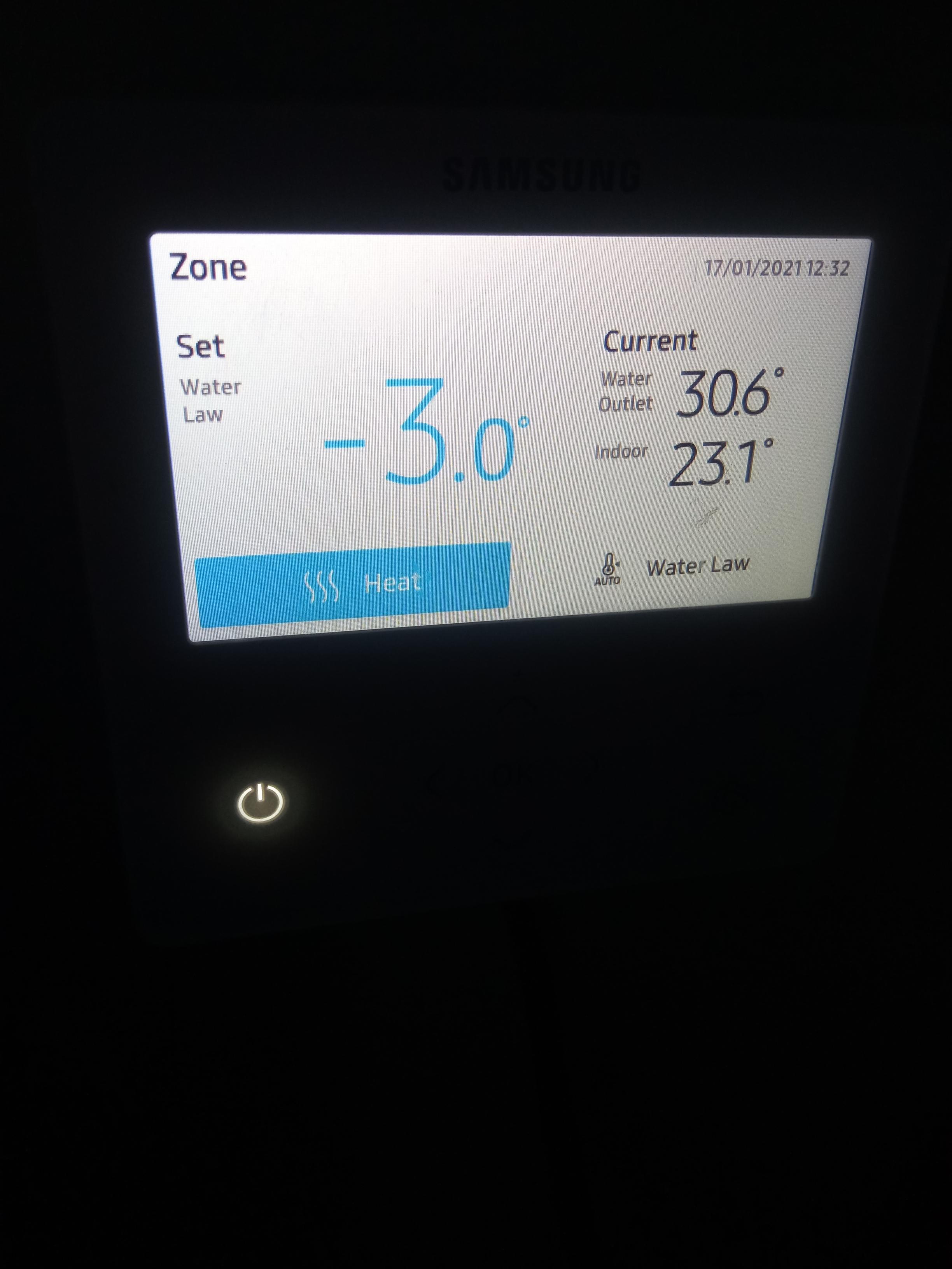

1 hour ago, AliG said:
Considering those settings I would just set the Water Law setting to -3C which would theoretically give a maximum flow of 42C and set your thermostat at 21C and see what happens.
@AliG This is the main one I had set at -5 to change change to -3? Our room thermostats are all set to 19 degrees but it is a bit cooler than I'd like but I'll perhaps leave them here just to see what impact it has.
-3 would be the same as setting it to 34 and 42 (-3 from the current 37/45 setting) so it is just a less faff way to do the same thing.

Seems yesterday the energy consumption of the ASHP went down. I'm now obsessed on this function!
And this is the setting we have set on the water law now which I changed yesterday.
I also did what @PeterW suggested and changed the  201* settings to 10 and -5.
We have turned the room thermostats up to 20.5 degrees though as 19 was a bit chilly for us.

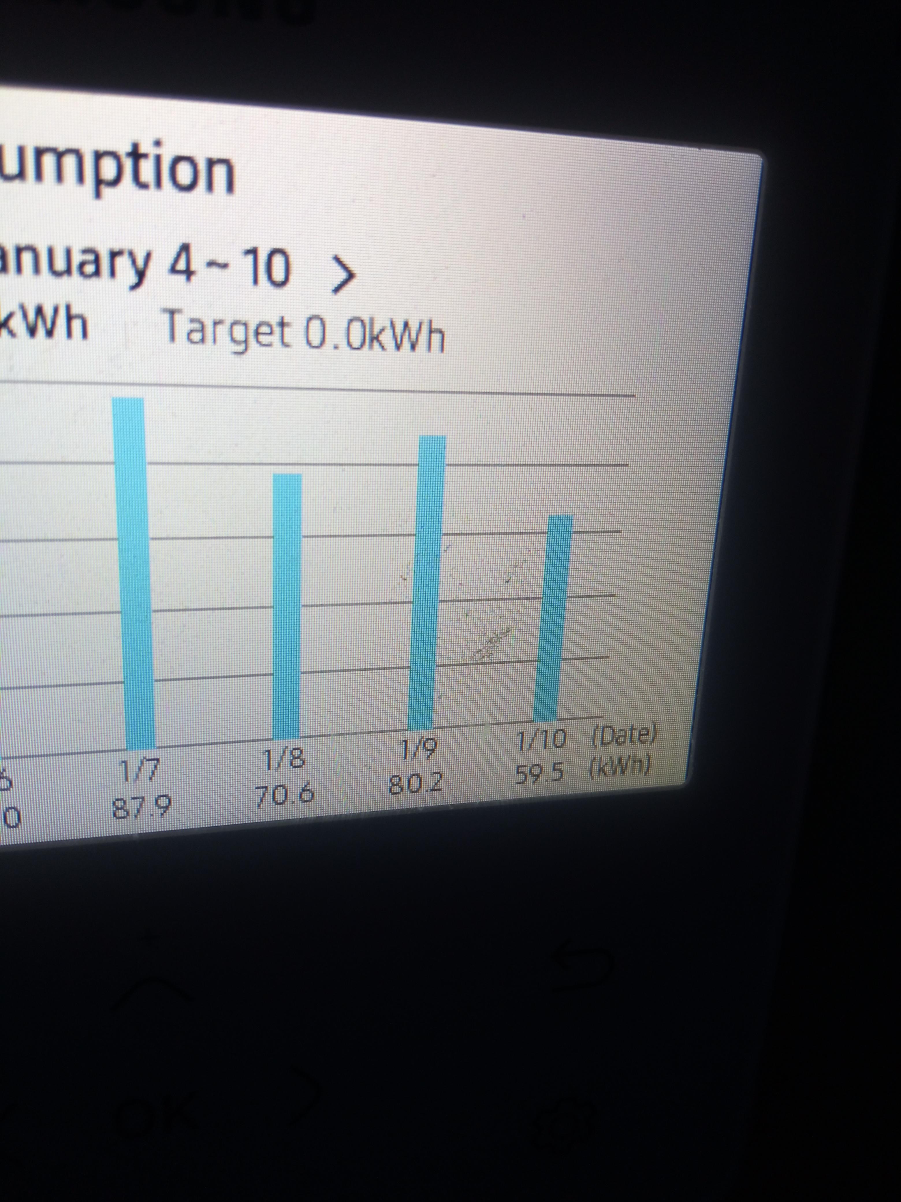

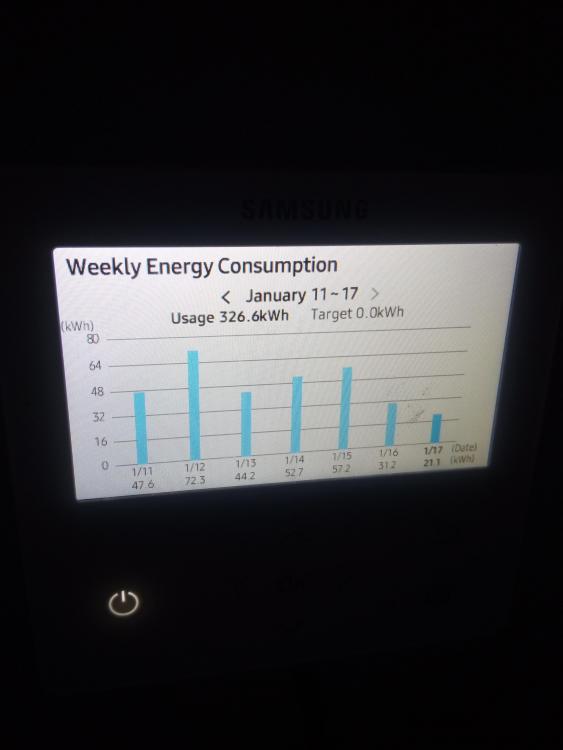

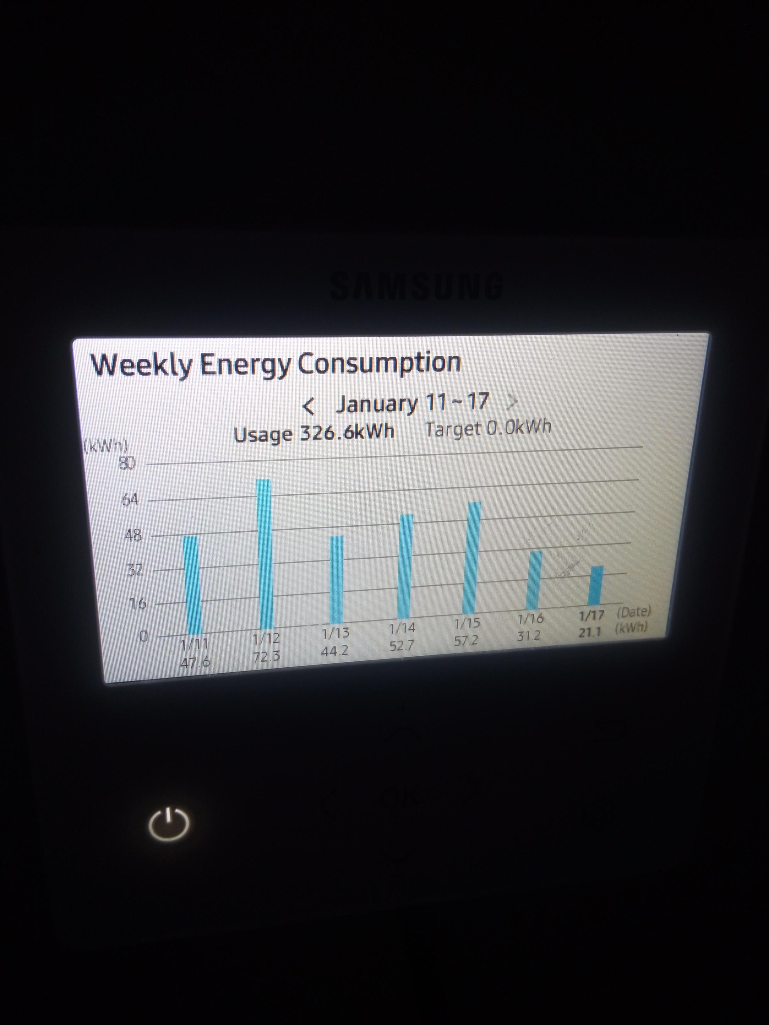

Ok right I need to check something. I took a meter reading on 7 January and it was 09359 and on 15 January it was 09945 it suggests we used 586 units of electricity during that time.
Using the heat pump energy consumption setting I've found our daily kWh usage from that period. Granted on 7th and 15th that kWh on the heat pump is for a 24 hour period but in total it is 572kwh for those time periods (see bar charts below).
If our total units of electricity used was around 586 for the 8 days (acknowledging I don't know what time of day it was on 7th I took the intial meter reading and was lunchtime on 15th when I took the subsequent meter reading) it suggests that our 'other' energy use was likely to be minimal. Does this sound right?
When I rung Alto they were quite dismissive on the energy use of the heat pump and suggested we were likely using a lot of other energy elsewhere but this seems to contradict that point.

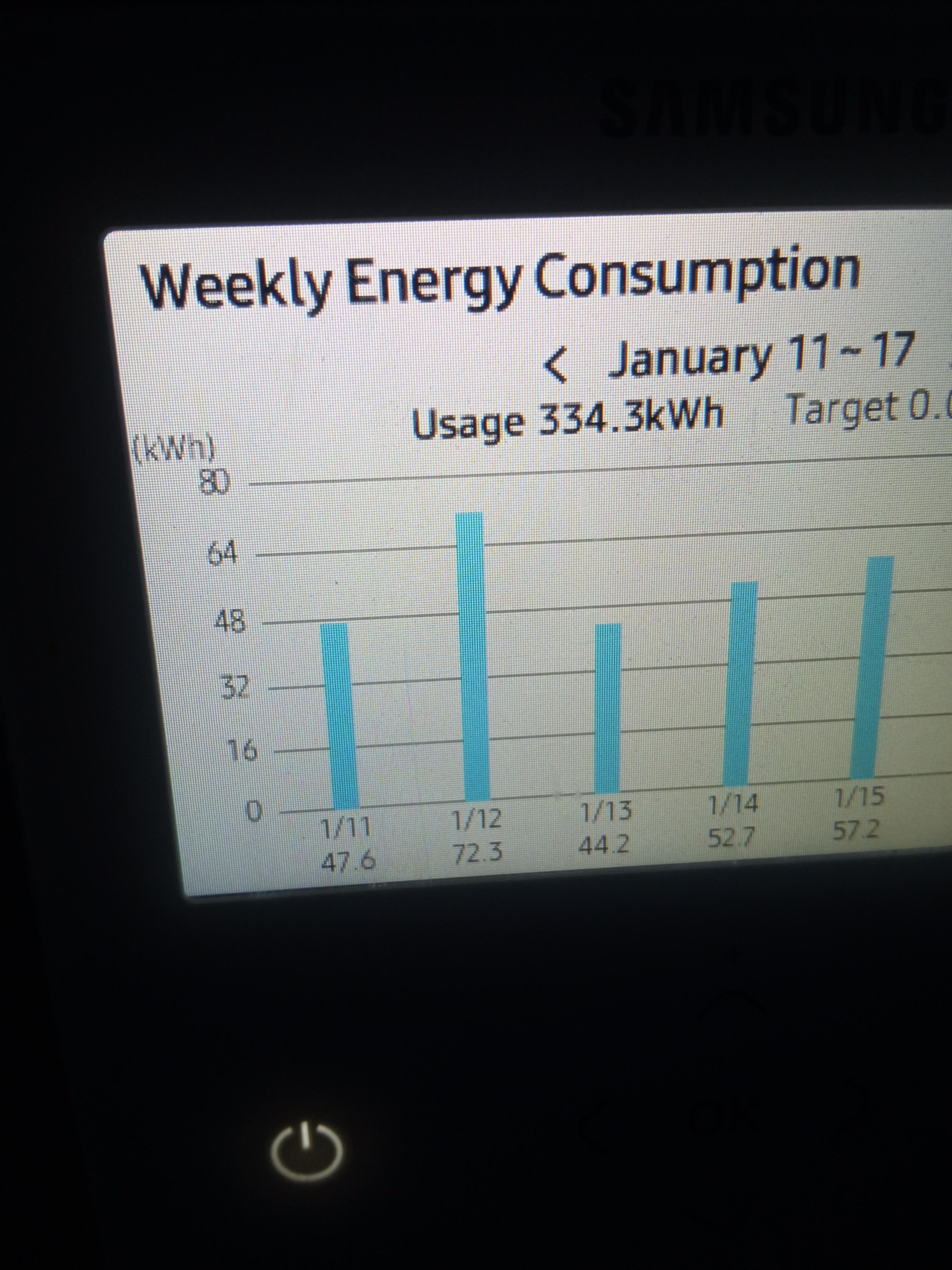

Ok I know you are all probably sick of me now. I don't quite know why I'm posting this but just for my own sanity at least it's out of my head.
Alto have just rung. Apparently the energy usage screen on the heat pump isn't accurate and is only an estimation! I think this may be a bit of BS
(but if someone tells me I'm wrong I stand to be corrected) but I'll monitor that but our figures suggest it isn't and is surprisingly accurate.
They were quite dismissive about the flow rate temperature and indicated it will take longer to heat up so electricity use will be the same but based on the conversation on here and what I've read I think this is something I'm going to monitor and it's set at -3 as I think @AliG suggested so the flow temperature is slightly lower now
Since we took the meter reading of the heat pump and immersion on Friday and again at 3:30pm today we have used a total of 101.74kwh split between 6.96 on immersion and 94.78 on the heat pump.
Our total meter reading since Friday lunch and just now suggests we have used 122 units of electricity in total. Allowing for 101.74 on the heat pump that means we have used 20 units of electricity which when we used dishwasher and washing machine, dryer over the weekend as well as charging chain saws, hedge cutters etc since we were gardening seems pretty low and fits with what I thought our general usage was.

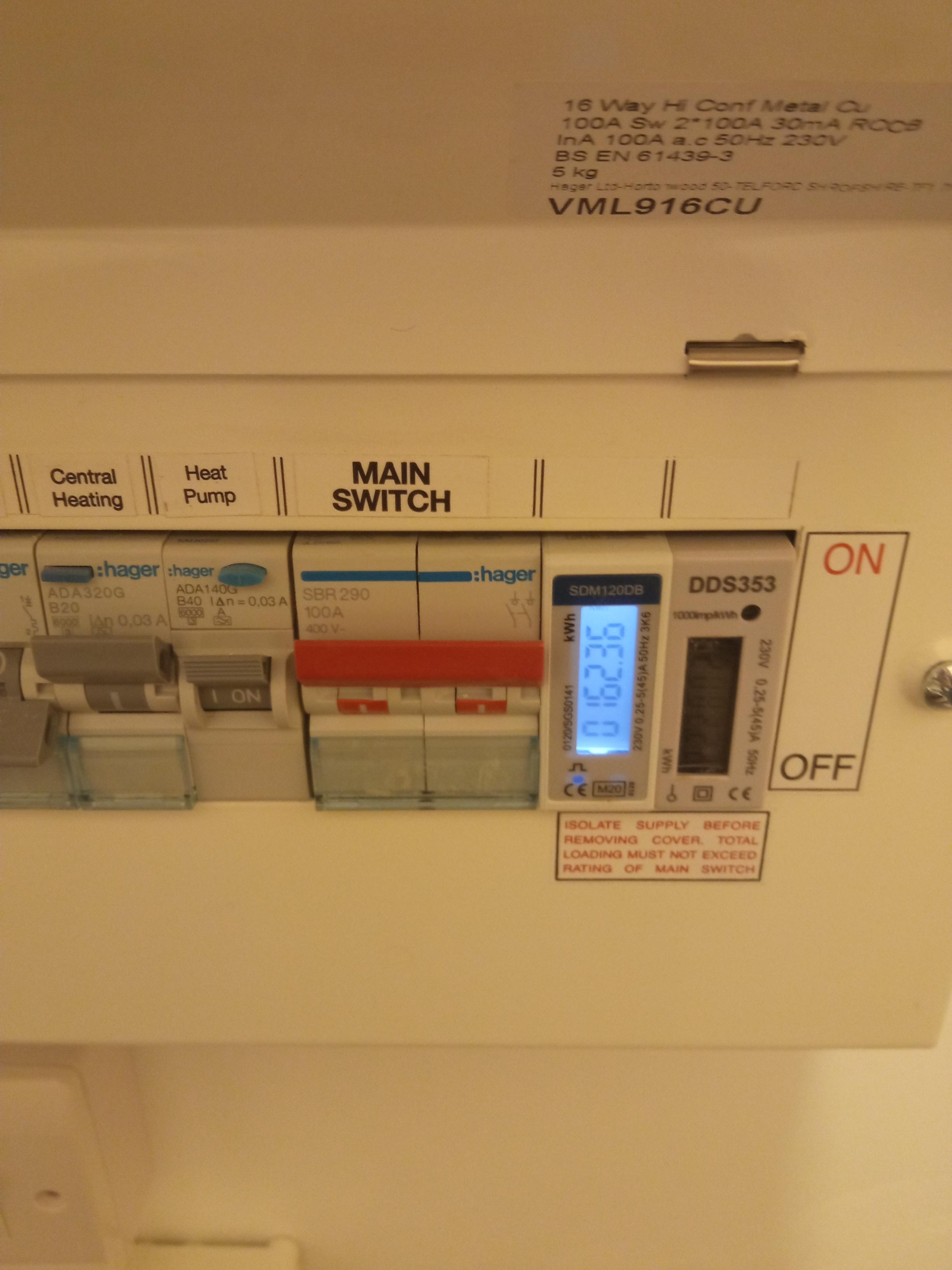

What about getting a few electricity meters fitted to the heat pump, immersion so you have accurate data?
It’s an easy job for an electrician, meters can be purchased for £25 upwards.
I think that's what we have already. That's how I've been able to seperate out the usage.
End two - blur light is immersion and one to right of it is heat pump.

Yesterday (Monday) I took the meter readings of the heat pump and immersion so we were able to calculate we had used, since the same time on Friday 6.96kwh on the immersion and 94.78kwh on the heat pump over the 3 days.
Strangely now at 24 hours since I took the readings yesterday I've taken a reading again on the heat pump and immersion and we have used 8kwh on the immersion since 3:30pm yesterday versus 6.96kwh on the immersion over Friday-Monday.
Confused because I haven't actually changed anything since yesterday so I don't know why the immersion has used more in one 24 hour period than a 72 hour period over the weekend when we had baths etc. Any ideas anyone @AliG?
On the plus on the 4 days since the readings I took on Friday I have a bit of a clearer picture now of our use which I can say over 4 days is seperated out as follows.
Total units 162 between 3:30pm Friday and 3:30pm Tuesday, of which:
115 units is the heat pump
15 units is immersion
32 units of 'other' electricity use
Averaging out our usage over 4 days just for the heat pump/immersion seems to come in at 32.5 kWh which is still more than others but recognise we don't have our EWI. Do you have a ASHP @Thedreamer as your usage seems to be far lower.
