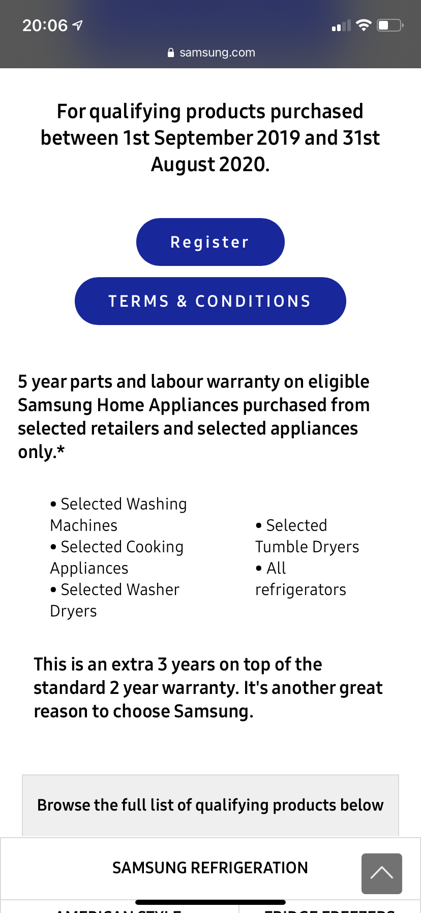

21 hours ago, Gav_P said:
it does cover new purchases up to aug 21 (just off the top of the page in my screen grab).
I have a Samsung fridge freezer with extended guarantee.  Lucky as it has gone wrong 3 times in 2 years.  Engineer due back out for yet another fault.  They are poor quality design and build.
