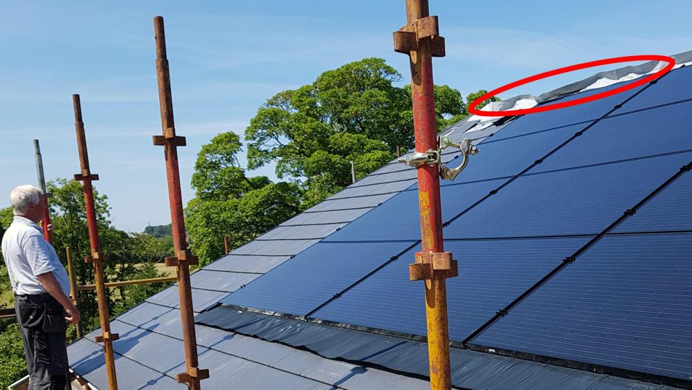

By  now, I can throw a scaffold up in a morning : safe, level and built with an eye to making it easier to take down. Roof ladder delivered Monday. So far so good.
But, as is the way with stuff I do, the first thing I manage to bugger up is breaking a tile - one thats right next to the gutter and 100 mm above  the scafffold platform on which I'm standing. Unaccountably, I just picked my foot up and put it on the tile.  The outrage I felt when it cracked. How dare it!
So now there are two to replace. Eeeeejit.
Heave the roof ladder up and wheel it gingerly to the roof ridge, and roll it over so the hooks on the other side. And just then, just at that moment, I start feeling uneasy. But pleased - success afterall innit - roof ladders in place ?
Over the years I have come to trust that 'feeling'
Sheeeet. The other side of the roof is full of solar panels, some very close to the ridge.
Off the platform, shoot down the scaff ladder , scoot round to where I can see the hook - and sure enough the ladder hook is resting on one of the solar panel.
Ferkety Ferkety Fookety fook.
I haven't put any weight on the ladder.

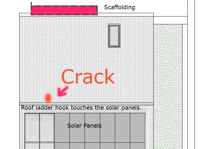

Here, look at this: the cracked tile I need to mend is marked in red.
Can't take a joke? Don't self build.
Wot's to be done folks?

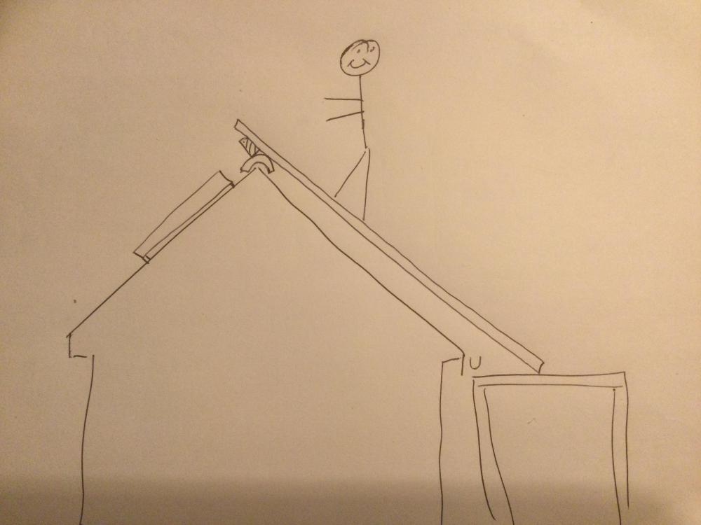

I doubt it would pass hse but i would put some some decent "outriggers" on the scaffold away from the building. Then clip down the boards so the cant flip up. Screw a batten /4x2 to said boards so the ladder cant slip and use a normal ladder so you dont have an issue with the solar panels.
Then use a sofa cushion under the ladder like suggested above. Failing that fix a bit of wood across the top of the ladder to try and spread the weight but the cushion would be my no 1 choice
Or put the ladder up the gable and shimmy along the ridge but that would be dangerous and is fairly scary getting back off

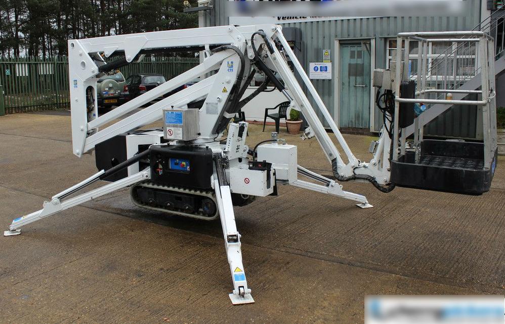

Well wad'ya know: a knight in shining armour has just popped in. Man wiv Sherree PiKa. He came to pick up the ladder.
Looking at the job he suggested that I could be let loose on a tracked  one (T135)
While I'm up there, I can feel a couple of other little jobs coming on.....  I mean, like Ed ( @Construction Channel ) says  Wot could go wrong?
Only one more sleep until I get to play with this........ Christmas reinvented.
Photos while I'm up there ... good weather forecast too.

This looks a fantastic bit of kit - I was only pondering the other day how best to paint the gable ends - I thought of a cherry picker but dismissed it due to the likelihood of it curning up my lawn etc. But this beast could be the answer. Thanks for sharing - Out of curiosity , what is the hire rate ?

Have you ever used one before?
Years ago I did the course to drive one at work, the bit of paper has long been lost and has probably expired anyway.  When you are outside and reaching over a lot, you start to question if it really can reach that far.  That's one of the things you do on the course, take it right to the extremes 2 up until the alarm sounds.
Go careful, you don't want to bounce it onto the roof and break another tile (I may regret saying that)

The machine's vertical reach is 10 meters (platform height) I need 5, and about 2 meters laterally. The machine offers 6 meters reach laterally. This is one instance where I will be wanting to operate well within the machine's capability: and the wind forecast is about as good as you can expect.
I take your point Dave about bounce. I'll take a few tiles up with me  ?

That white monster looks like a next generation robot from Boston Dynamics, are you sure is has not escaped from an AI research lab. Just hang on if it decides to execute a back flip while you are fixing the roof.

They are good for vertical and overhangs.  Not so great for roof as it is underneath you.  Hardstanding required, not soggy grass.
We have compacted MOT1.
I take your point about reaching across to do a job, thanks. I'll  take it slowly : maybe do a couple of other jobs lower down first to get used to it. I certainly won't be taking it out or up as far as the spec will allow.
Yes @epsilonGreedy it looks a bit Dr Who-ish dunnit?
