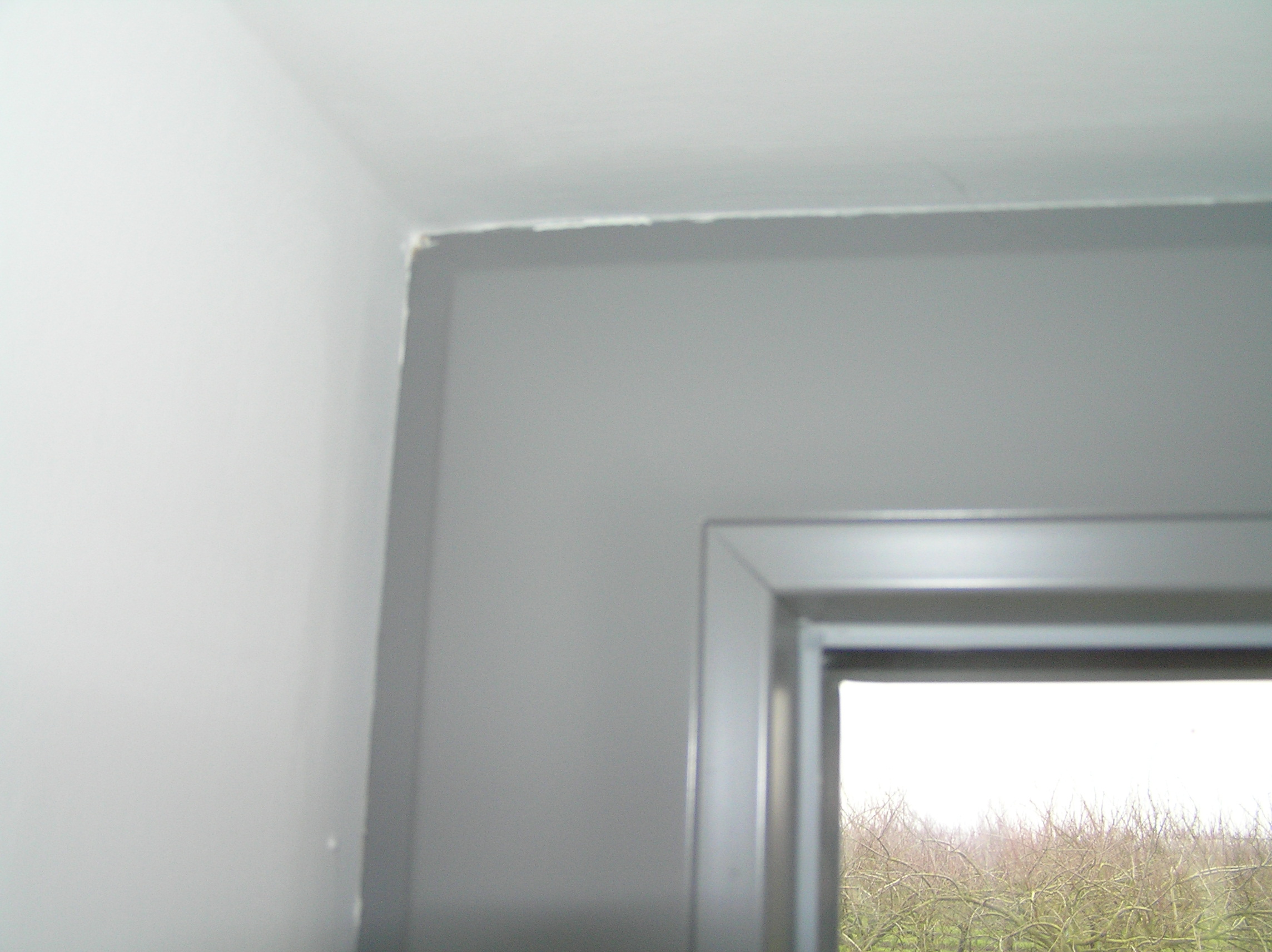

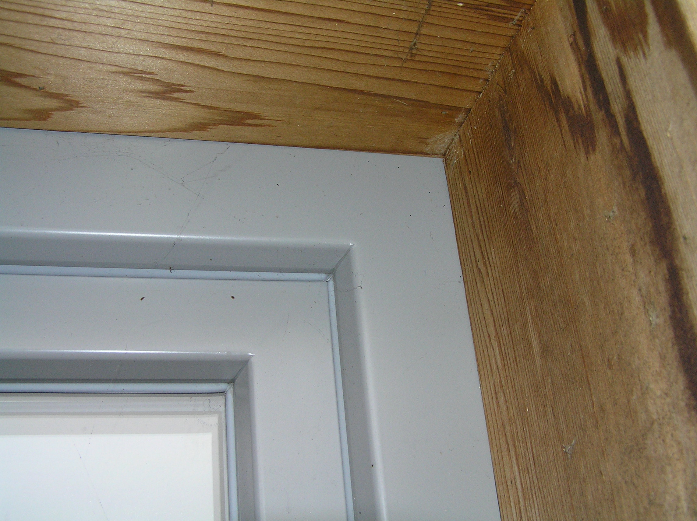

MikeSharp01 Posted January 31, 2017 Share Posted January 31, 2017 On Sunday, January 29, 2017 at 16:28, PeterStarck said: We had the mitres filled on our Rehau frames before they were sprayed. Everybody who has commented on them think they are ali not plas Do you have any pictures of the internals of your so treated Rationel windows? Think the other half might be coming around! Link to comment Share on other sites More sharing options...

Gone West Posted January 31, 2017 Share Posted January 31, 2017 3 hours ago, MikeSharp01 said: Do you have any pictures of the internals of your so treated Rationel windows? Think the other half might be coming around! I haven't got Rationel windows, did you mean Rehau? Link to comment Share on other sites More sharing options...

MikeSharp01 Posted January 31, 2017 Share Posted January 31, 2017 2 hours ago, PeterStarck said: 6 hours ago, MikeSharp01 said: Do you have any pictures of the internals of your so treated Rationel windows? Think the other half might be coming around! I haven't got Rationel windows, did you mean Rehau? Sorry Peter, my mistake. A pic of the corner without mitre is all I am looking for I guess if Rehau can do it they all can. Link to comment Share on other sites More sharing options...

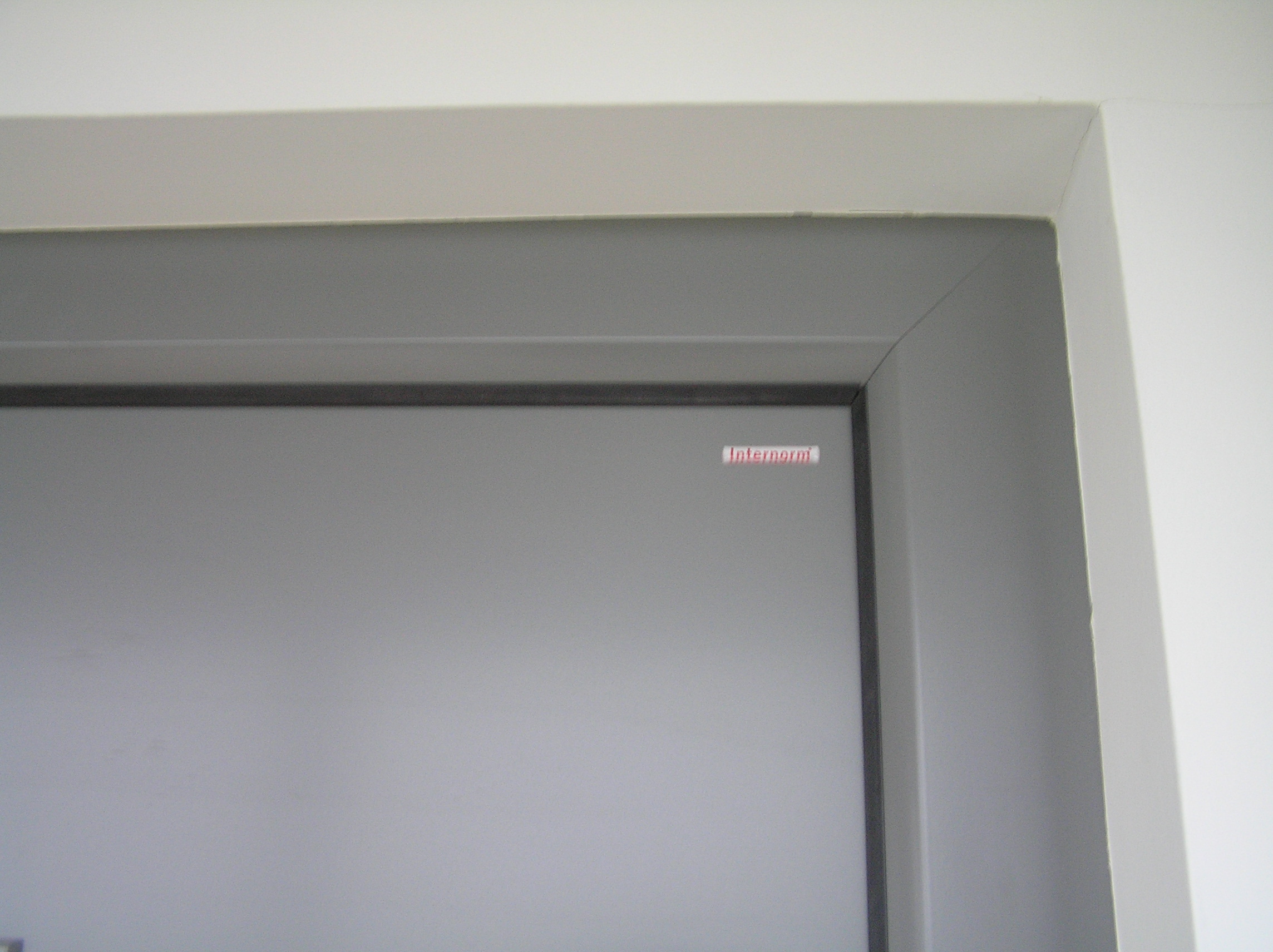

Gone West Posted February 1, 2017 Share Posted February 1, 2017 @MikeSharp01 It's a bit grubby outside, not best time for taking pictures. So it's outside, then inside same window, then as a point of interest an Internorm entrance door that is ali clad. Link to comment Share on other sites More sharing options...

MikeSharp01 Posted February 1, 2017 Share Posted February 1, 2017 6 hours ago, PeterStarck said: It's a bit grubby outside, not best time for taking pictures. So it's outside, then inside same window, then as a point of interest an Internorm entrance door that is ali clad. Many thanks Peter that looks great let's see what the other half thinks. Link to comment Share on other sites More sharing options...
