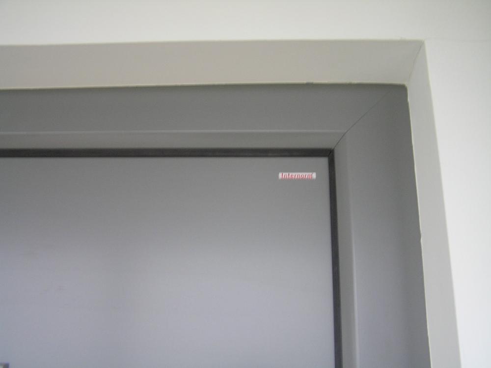

IanR Posted January 29, 2017 Posted January 29, 2017 We have mostly timber/ali Internorm windows in our build, with white UPVC/ali Internorm windows and door in our Utility. I can't remember the price difference, but I'm sure it was in the order of 25% cheaper for the UPVC. Externally you can't see and difference between the timber and UPVC options. Internally it's down to the "look" you are going for. If you can get away with UPVC then I'd definitely go for it. Internorm UPVC are very well put together, very nice jointing in the frames, they look a quality product. UPVC frames are more robust that timber and are lower maintenance. Not that timber will be particularly high maintenance, but would require better looking after. The Internorm supplier we used made a point of mentioning humidity levels whilst plaster and decoration is drying out, and telling us to ensure the house was well ventilated during this period as the timber framed windows can be susceptible to swelling at the joints. This was part of our decision to have UPVC in the Utility, that and the money it saved on a few windows and a door paid for us to go up to the Studio range for the whole house.

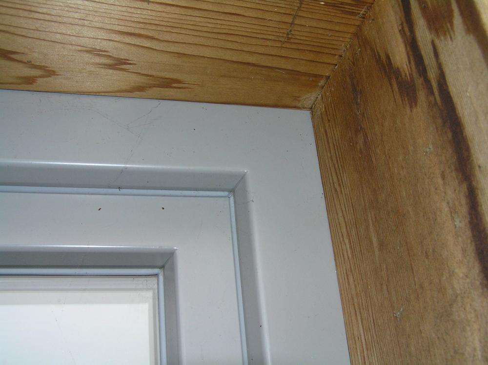

Gone West Posted January 29, 2017 Posted January 29, 2017 On 29/01/2017 at 11:08, MikeSharp01 said: We are at the point of choosing now and my other half won't have UPVC as the corner joining (mitre) on the inside offends her Expand We had the mitres filled on our Rehau frames before they were sprayed. Everybody who has commented on them think they are ali not plastic.

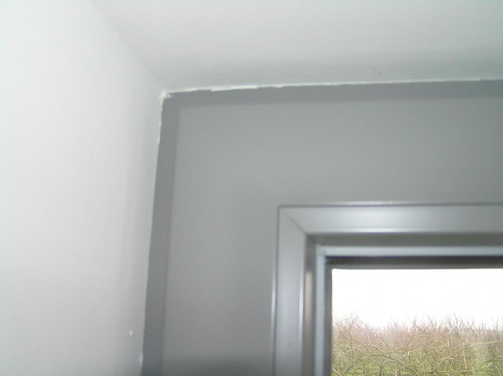

TerryE Posted January 29, 2017 Posted January 29, 2017 We have AluClad PVC KF200 range. Absolutely no complaints. Zero maintenance, and the outside is sun-proof. As to the cornered mitres, my immediate reaction was Eh? I am not in the house at the mo, and so I checked some of our internal photos for a blow-up of the detail. Yes, you can see a very slight line at 45° in the window corners, but it is extremely subtle. @MikeSharp01, Mike do your picture frames have mitred or square corner joints in your house? A mitred corner is just a different approach. It doesn't make rational sense for one to be fine and the other offensive; this is purely cultural. Having inward opening windows is another thing that some people hate the idea of, but once you see them in practice they are brilliant.
