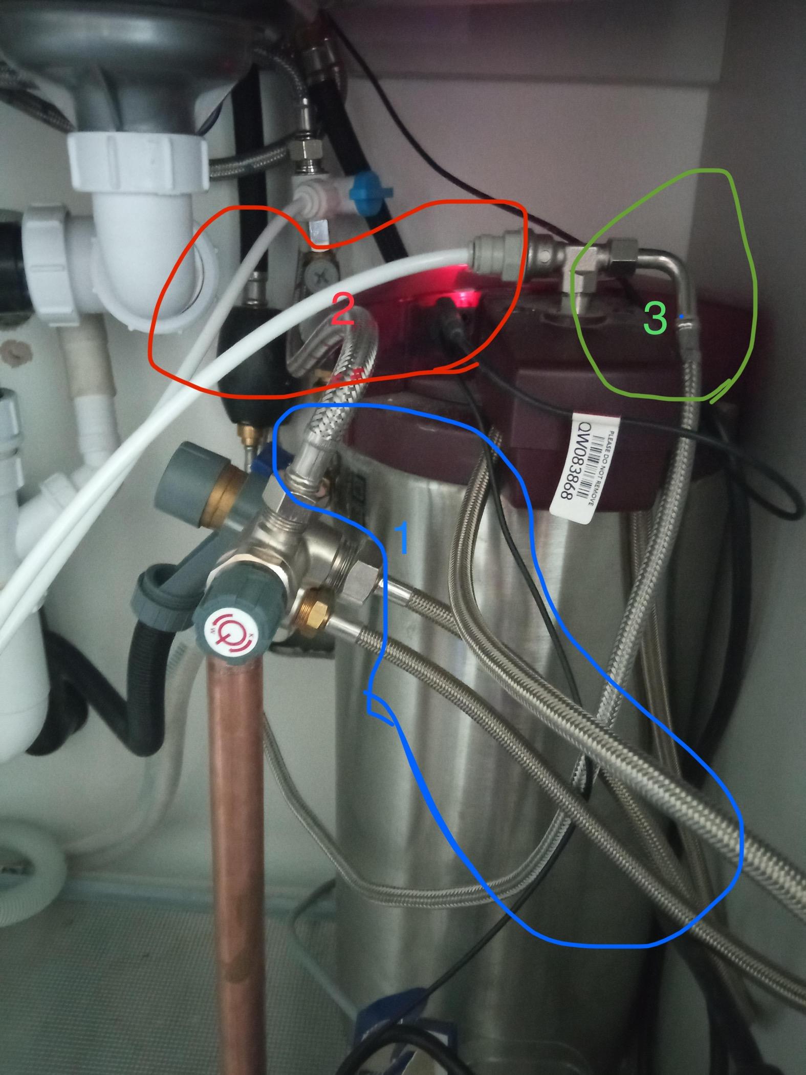

ProDave Posted December 21, 2020 Share Posted December 21, 2020 Look carefully, I bet there is a fine jet of water spraying from somewhere around the white nut and that just happens to be where it lands. That brass bit will be full of water all the time and not affected by the blue tap. It may be as simple as the white nut is not even tight? It does seem to dismiss his statement that he tested it. Link to comment Share on other sites More sharing options...
joe90 Posted December 21, 2020 Share Posted December 21, 2020 If it were me I would turn blue tap off again (90’), undo white nut (some water will escape so towel underneath), check filter is clean (little blue thing in your first photo from machine instructions). There is a rubber washer (may be part of the filter) make sure this has no damage to it. I like to put just a smear of Vaseline or cooking oil (very little) onto both sides of that rubber washer and tighten by hand (hard). Turn it back on and see if any leaks appear . Let us know. 1 Link to comment Share on other sites More sharing options...
MikeGrahamT21 Posted December 21, 2020 Share Posted December 21, 2020 if its not coming from the dishwasher pipe, as long as the leak is extremely slow, in the past i've left them, put something under it to catch anything, and limescale will seal anything up after a few days. If its coming from the dishwasher supply pipe though, definitely what @joe90 said, and obviously make sure there is actually a rubber seal in there too as there should be. Link to comment Share on other sites More sharing options...

Russell griffiths Posted December 21, 2020 Share Posted December 21, 2020 Does that hot water tap connector block thing not have a mounting bracket, I cannot believe it just hangs on the weight of the pipes. And the waste pipe is that not running up hill why is the waste pipe pipe in the cupboard and not underneath it. All looks a bit crap to be honest. Link to comment Share on other sites More sharing options...
ProDave Posted December 21, 2020 Share Posted December 21, 2020 1 minute ago, Russell griffiths said: Does that hot water tap connector block thing not have a mounting bracket, I cannot believe it just hangs on the weight of the pipes. And the waste pipe is that not running up hill why is the waste pipe pipe in the cupboard and not underneath it. All looks a bit crap to be honest. I was hoping someone else with the same tap would post a picture of how it should be done? Link to comment Share on other sites More sharing options...
Russell griffiths Posted December 21, 2020 Share Posted December 21, 2020 The more I look at that waste pipe the more it offends me. Do your kitchen units not have a void underneath them and a kick panel waste should run along the floor, low and come up in the cupboard, not run through the cupboard taking up storage space. Link to comment Share on other sites More sharing options...

Russell griffiths Posted December 21, 2020 Share Posted December 21, 2020 I did a bit of google searching as well it looks as though the quooker connection thing is fairly heavy, so it is installed on a short stub of copper with pipe clips close by to keep it all tight and neat, your guy has first cut a T in to feed the dishwasher this has put the quooker connection further from the feed pipe so putting more pressure on the junction, hence his bodgy bit of pipe to prop it up. I would live with it over Christmas and get someone to yank it all out and plan it properly in the new year. Link to comment Share on other sites More sharing options...

Gav_P Posted December 22, 2020 Share Posted December 22, 2020 9 minutes ago, ProDave said: It won't be a faulty item, it will be fitting. I have not seen one of these in the flesh, but for the hose to pull out of the tap, an equal amount of hose must go up into the fitting under the sink. Am i right saying that hose with a "bulb" on it is the hose in question? Gently pull the house out of the tap, I am willing to bet if you look under the sink unit you will see that hose with a bulb rising up as you pull the tap hose down, and I am also willing to bet due to the shambolic install, there is not enough free hose, or it is jaming on something which is restricting its travel. Once you see what is jaming on what, you can show him what needs to be changed. You shouldn't be charged for snagging. I second this... you can see why it won’t reach from your earlier photos. The flexi pipe to the bulb is coming forward out of the unit before heading to the back of the cupboard and up to the tap... needs completely rerouting. Link to comment Share on other sites More sharing options...

Gav_P Posted December 22, 2020 Share Posted December 22, 2020 On 21/12/2020 at 11:53, canalsiderenovation said: Does anyone else think that all those flexis into that valve unit thing should actually be copper? Seems lazy even by my standards. Link to comment Share on other sites More sharing options...
canalsiderenovation Posted December 22, 2020 Author Share Posted December 22, 2020 2 minutes ago, Gav_P said: I second this... you can see why it won’t reach from your earlier photos. The flexi pipe to the bulb is coming forward out of the unit before heading to the back of the cupboard and up to the tap... needs completely rerouting. I'll have look tomorrow and report back. I can then put this into my email to him. I guess if he is that confident in his work he will let me get Quooker out, if he isn't he will reinstall it. As yet I've not paid the £4500 bill. Link to comment Share on other sites More sharing options...
Gav_P Posted December 22, 2020 Share Posted December 22, 2020 (edited) Not knowing anything about this kind of thing, there would be 3 key points that I can see that I don’t like... here is my high text graphic to show where I’m taking about 1. These flexis should be in copper. Just lazy. Or if they need to be flexis then fit ones the right length. 2. The white pipe I assume is to the drinking water? Why is the pipe not cut to length? 3. I guess this is the pipe to the tap. It needs planning and re-routing. Edited December 22, 2020 by Gav_P 1 Link to comment Share on other sites More sharing options...
JFDIY Posted December 22, 2020 Share Posted December 22, 2020 34 minutes ago, canalsiderenovation said: Quooker tap - the hose doesn't pull out Here is the tap installation video https://youtu.be/_SaOlYI8rJo The black and silver hose from the bulb that @ProDave mentions need to be able to rise and fall without snagging. Both of the attached hoses don't looked routed without obstruction. The black one appears to be close to the copper pipework/regulator at the back of the cupboard and the silver braided one would perhaps be better routed over the top of the other plumbing pipes so it can come up without getting caught under the other pipes. 1 1 Link to comment Share on other sites More sharing options...
