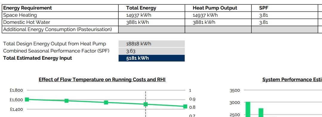

ProDave Posted December 19, 2020 Posted December 19, 2020 Are you sure that heating estimate is right? That's over 10 times my heating usage. Lets hope the real world figures come out lower.
canalsiderenovation Posted December 19, 2020 Author Posted December 19, 2020 (edited) 11 minutes ago, ProDave said: Are you sure that heating estimate is right? That's over 10 times my heating usage. Lets hope the real world figures come out lower. That's what the EPC guy came up with who came a week ago but he was a bit useless (I guess that's what you get for paying £45 for an EPC) and not the heat pump design spec which I said in my first post. Strangely I've just checked the design for the heat pump and the spec and gives different figures. Edited December 19, 2020 by canalsiderenovation

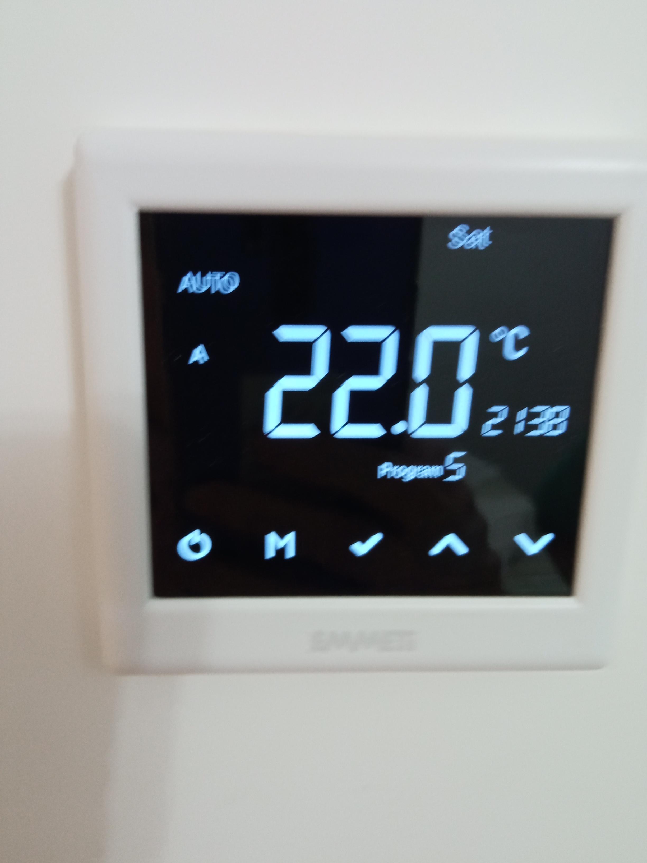

canalsiderenovation Posted December 19, 2020 Author Posted December 19, 2020 5 hours ago, MikeGrahamT21 said: arent you too warm at 22C? I struggle with anything above 19.1C in my bungalow, end up getting too warm. No! We are in the process of moving back in now although have a long snagging list. I'm still trying to get my head around all 11 of these controls which are all at 22 degrees but what I can't understand is some floors are completely cold even though the thermostat says 22 degrees but perhaps it is sensing the overall temperature.....
ProDave Posted December 19, 2020 Posted December 19, 2020 I assume that 22 degree reading is the "set point" If so all the rooms that have reached that temperature will have switched off and the floors cooled down. The rooms that have not yet reached 22 degrees will still be warming up and the floor will feel warm. 1
canalsiderenovation Posted December 19, 2020 Author Posted December 19, 2020 (edited) 22 minutes ago, ProDave said: I assume that 22 degree reading is the "set point" If so all the rooms that have reached that temperature will have switched off and the floors cooled down. The rooms that have not yet reached 22 degrees will still be warming up and the floor will feel warm. Well one room is saying 22 degrees but it's bloody cold when I go in there (small bathroom). It's set to 'air sensor using built in sensor' and we have an manual mode where it's set to 22 degrees for all rooms. I should say initially we had the auto setting where each day had 6 programmes with times but since that picture was taken I have take it off the auto and manually set every one to 22 degrees. Edited December 19, 2020 by canalsiderenovation

ProDave Posted December 19, 2020 Posted December 19, 2020 15 minutes ago, canalsiderenovation said: Well one room is saying 22 degrees but it's bloody cold when I go in there (small bathroom). It's set to 'air sensor using built in sensor' and we have an manual mode where it's set to 22 degrees for all rooms. Give it a bit more time yet. Then go around with a handheld thermometer and see what the actual temperature is in each room. That will start to tell you if you have issues. Let us know what you find. 1
canalsiderenovation Posted December 19, 2020 Author Posted December 19, 2020 1 minute ago, ProDave said: Give it a bit more time yet. Then go around with a handheld thermometer and see what the actual temperature is in each room. That will start to tell you if you have issues. Let us know what you find. Hmm handheld thermometer.... Haven't got one I'm sure our neighbours have though will ask tomorrow.
TonyT Posted December 19, 2020 Posted December 19, 2020 (edited) Or turn the temps on the rooms that are reaching set point down to force more heat into the other rooms to see if they reach temp Edited December 19, 2020 by TonyT 1
canalsiderenovation Posted December 19, 2020 Author Posted December 19, 2020 13 minutes ago, Gus Potter said: And running about in bare feet, saves a fortune on slippers which offsets the time you may be extravagent with the heating. Our hall is toasty, probably as our manifold is in there and it's the main point but some rooms are noticeably different in temperature. What I don't get is the kitchen says 22 degrees and the floor is warm, the small bathroom says 22 degrees and it's really cold, no warmth in floors at all.

ProDave Posted December 19, 2020 Posted December 19, 2020 What I am trying to establish is which rooms are meeting their temperature and the floor heating has turned off. Which have still to reach their temperature and the heating is on. Then there are the other possibilities. The room has not met it's temperature but the floor is cold. The room is above it's set temperature and the floor is still warm. You would not be the first to have the wrong thermostat connected to the wrong room. go get that handheld thermometer.......
PeterW Posted December 19, 2020 Posted December 19, 2020 So those are Emmeti CS17 stats ... if they are calling for heat then a little flame appears top right on the screen. There is a way to get them to show the room temperature - that’s the set temperature currently.
canalsiderenovation Posted December 19, 2020 Author Posted December 19, 2020 3 minutes ago, PeterW said: So those are Emmeti CS17 stats ... if they are calling for heat then a little flame appears top right on the screen. There is a way to get them to show the room temperature - that’s the set temperature currently. Yep they are I have their page instruction guide here and have programmed them all manual rather than the auto setting. The room temperature is showing as 22 degrees and if I whack it up then the flame appears I'm just not convinced all rooms are at 22 degrees when some floors are warm and some are completely cold and the rooms feel cold. Need a thermometer

TonyT Posted December 19, 2020 Posted December 19, 2020 Are the flow indicators on the zone valve showing flow to the rooms that are struggling to be heated?
Gone West Posted December 20, 2020 Posted December 20, 2020 10 hours ago, canalsiderenovation said: Well one room is saying 22 degrees but it's bloody cold when I go in there (small bathroom). Our house is heated by the towel rails in the bathrooms so the bathrooms are a bit warmer, 24C, than the rest of the house. You might feel more comfortable increasing the bathroom temperature by a degree or two.
