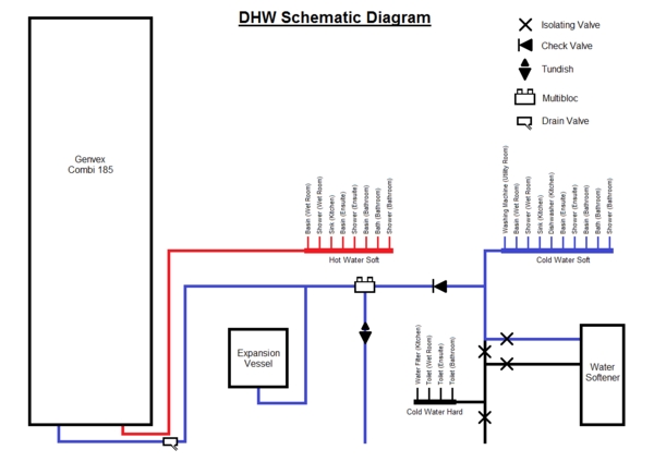

Nickfromwales Posted January 28, 2017 Share Posted January 28, 2017 @Bitpipe. Hugh, didn't you and herb share a similar design schematic? Could you pop it on if possible please? ?? Link to comment Share on other sites More sharing options...

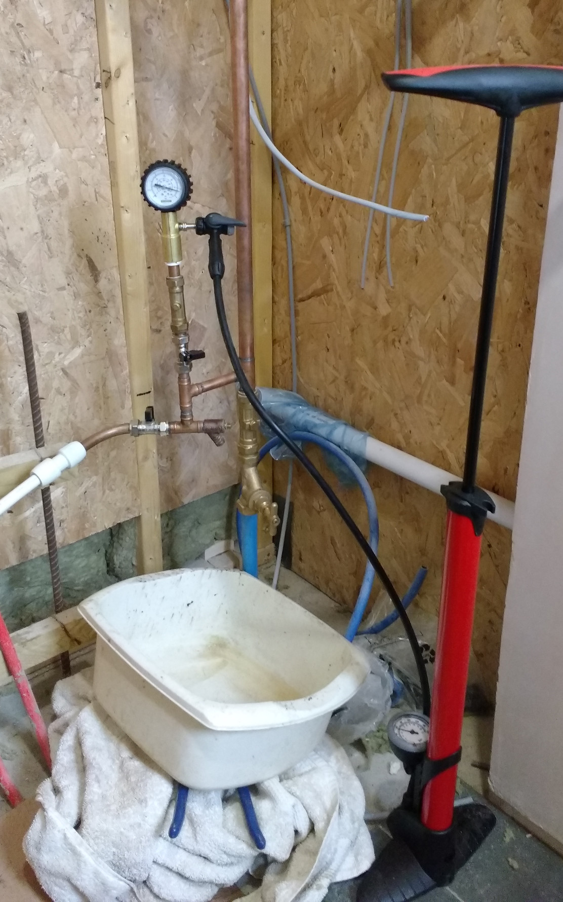

TerryE Posted January 28, 2017 Author Share Posted January 28, 2017 OK, One of the benefits of a manifold system is that we can do all of the pressure testing centrally. So is the T&J setup as per various feedback from Nick et al. I don't use the mains supply at the moment for anything other than testing. So coming from the mains I have: MDPE - Cu 25/22 stopcock : 22 Cu Double check valve : 22/15/22 T to (2) and finally a length of 22mm with an elbow and draincock at the top to act as a sort of air catcher / mini expansion Short 15 to 15/15/15 up to (3) and down to (4) 15 isolation valve, 15 double check valve and a Monument Dry Pressure Test Kit (£30) pumped by a Halfords Metal Trackside Pump (£18) 15 T to draincock and (5) 15 isolation valve and tail with Hep2O straight to hep2o flying lead which connects to whatever pipe or assembly that I wish to test. Most of these bits were old spares apart from the two price listed items so the setup was cheap and easy to make. The main disadvantage is that this Munson gauge only measures to 4 bar. But the set-up works well and the trackside pump is good for flushing out the test water so you don't leave drippy pipes after testing. Thanks guys Link to comment Share on other sites More sharing options...
Bitpipe Posted January 28, 2017 Share Posted January 28, 2017 6 hours ago, Nickfromwales said: @Bitpipe. Hugh, didn't you and herb share a similar design schematic? Could you pop it on if possible please? ?? Sure will need to dig it out and scan it. 1 Link to comment Share on other sites More sharing options...
