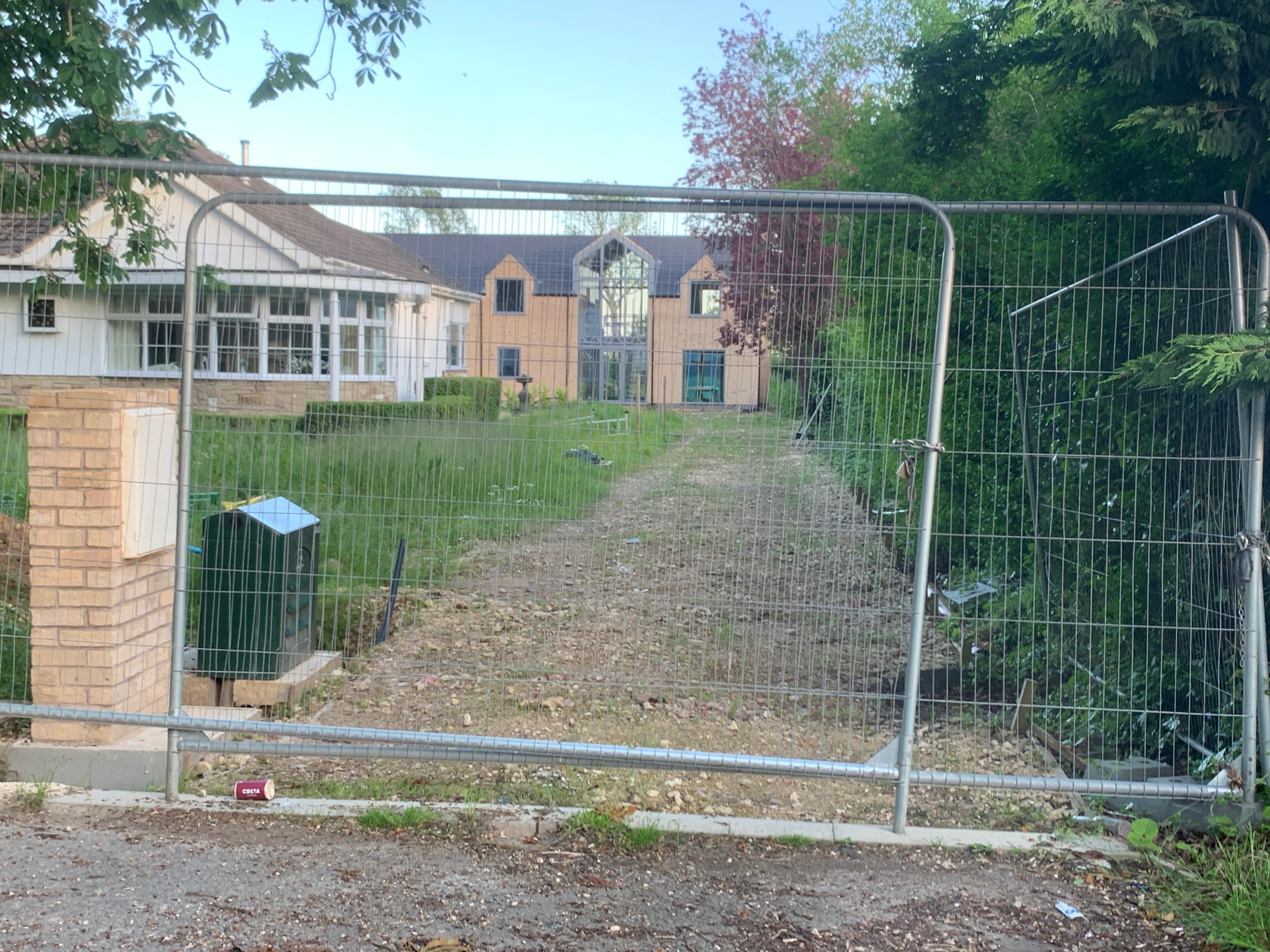

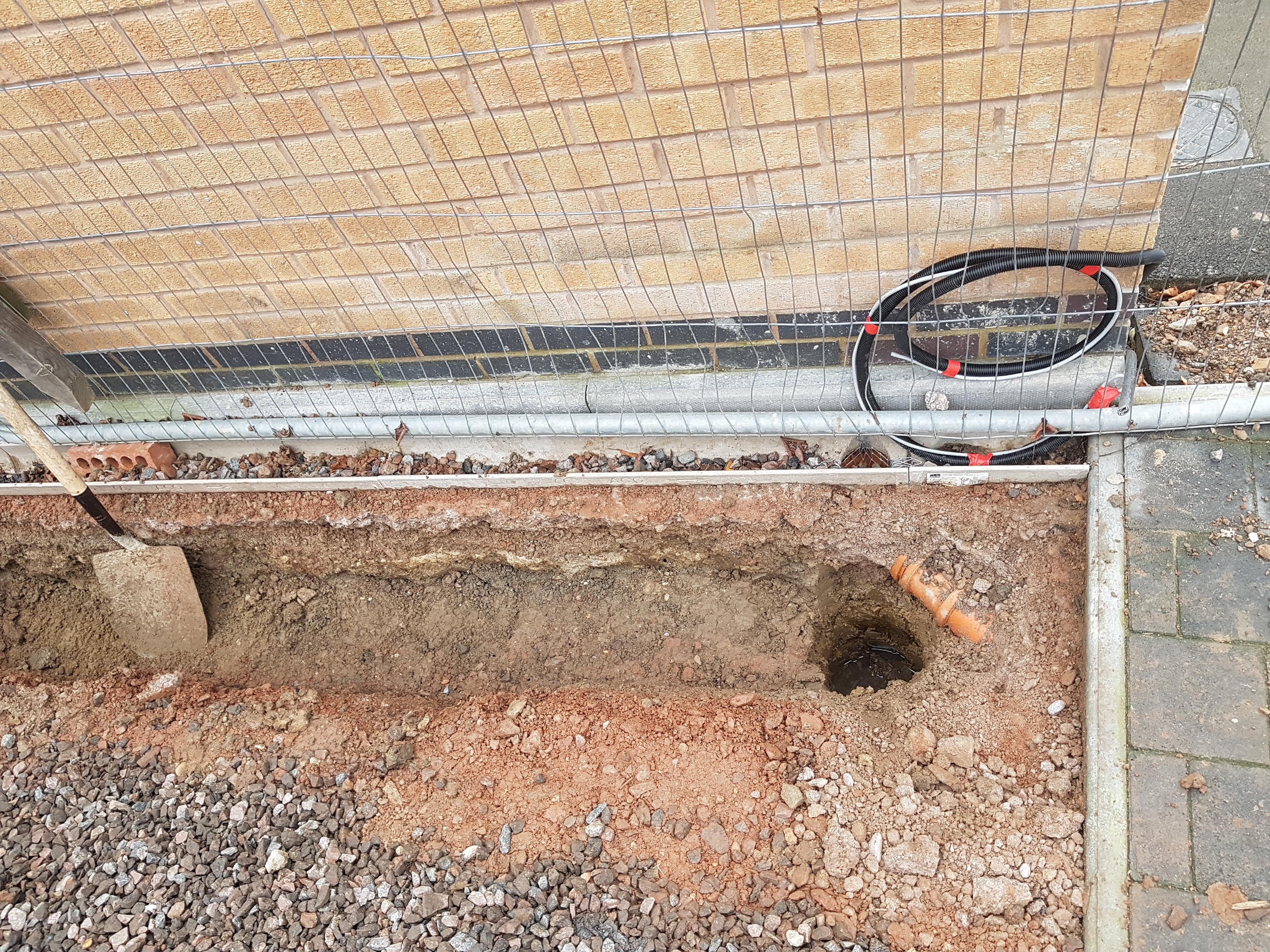

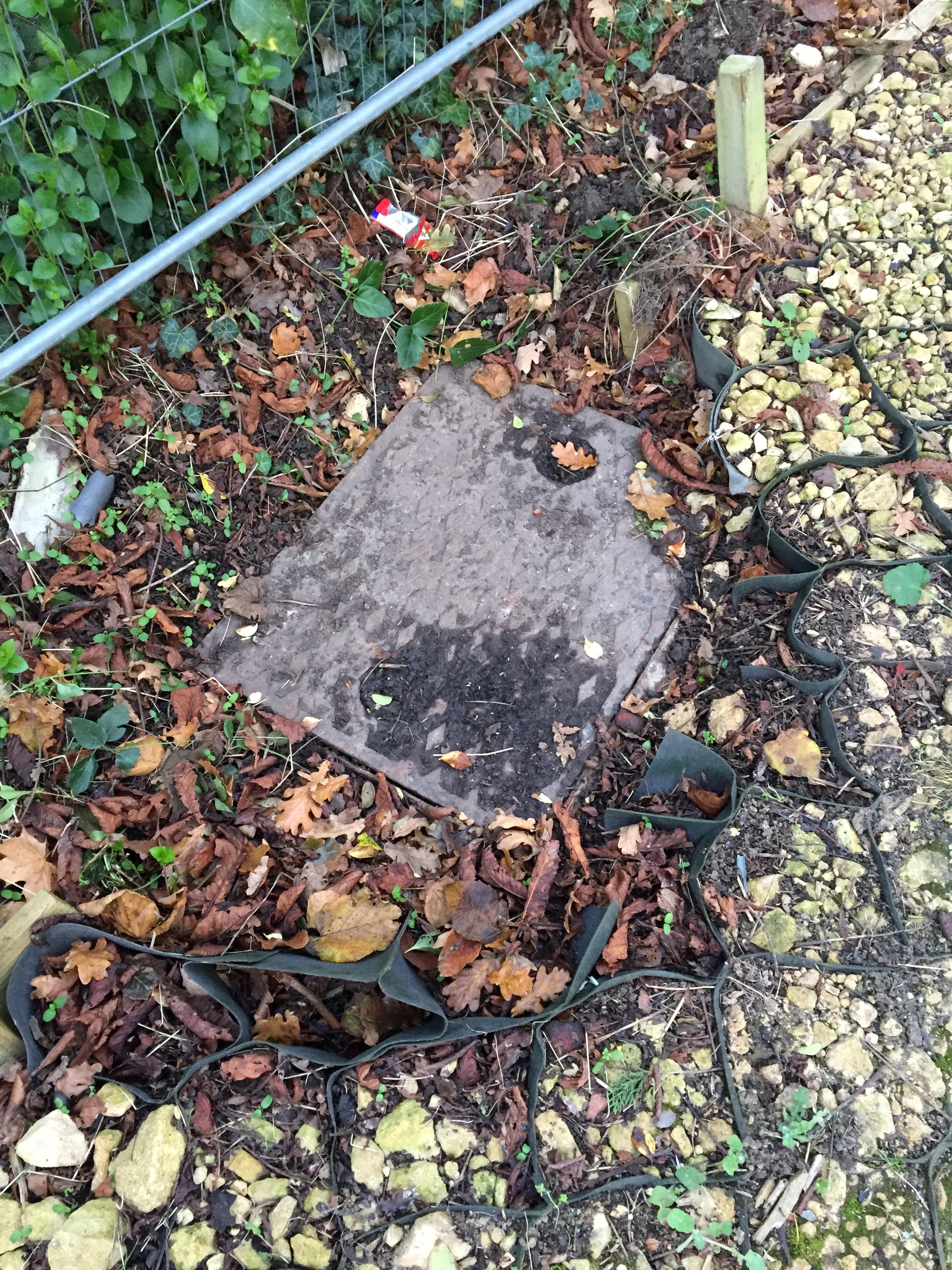

James94 Posted November 27, 2020 Posted November 27, 2020 Not really ready for gates just yet but need to sort this out soon as possible, we’re about to back fill the service trench but I need to sort my gate pillar foundations. As you can see from the pictures it’s directly on top of the services, will we be ok going over the top of these ? If so can you recommend best way to back fill over ducting when its in. There is a drain on the other side which will run under the pillar I think it’s about 3” down, will we be ok to go over this too? Gate pillars will be 2/3 bricks wide and 6” or so in height with electric wooden gates , the span between pillars will be approximately 3m. Regards. James
Onoff Posted November 27, 2020 Posted November 27, 2020 When you say "foundations"...if swinging gate leaves then you must surely be having a post into the ground? My (sliding) gate pillar foundations are 1m deep rounds dug with a PTO driven auger on the back of a tractor. The running base and base for the piers I then cast on top. There's a 4x4 steel up the centre of each column. All my gate side loads transmit to the steel post not the brick column. Should look nice if ever I finish it!
Oz07 Posted November 27, 2020 Posted November 27, 2020 Mine is a sliding gate had a trench about 300 square 1.8 long with 2 further holes. The steel was like an rsj goal post buried in concrete. If op is having swinging gates I think you'd need steel post buried in foundation quite deep to take the weight. Bricks built around this.
PeterW Posted November 27, 2020 Posted November 27, 2020 Your founds want to be as deep as possible and it doesn’t look like on the right side over the services you will have that opportunity. Other option is to frame the opening either with steel as per @Oz07 suggestion or create a solid “U” from rebar and framed concrete that runs up the inside of the pillar. 2 bricks is about the minimum you can make a pillar - that being 2 on each side - 2 1/2 or 3 is better and also would allow you more reinforcing. Don’t underestimate the weight of gates pulling downward and twisting a post ! 1
Russell griffiths Posted November 27, 2020 Posted November 27, 2020 I have seen a 450x450 brick pillar snap clean off at ground level when the gate swung in a gust of wind, I think you need to re think this and look at gate type and location steel post in the centre of the pillars concreted into the foundation at least 600 into the ground, and if ground is loose through excavation for services then a lot further. 1

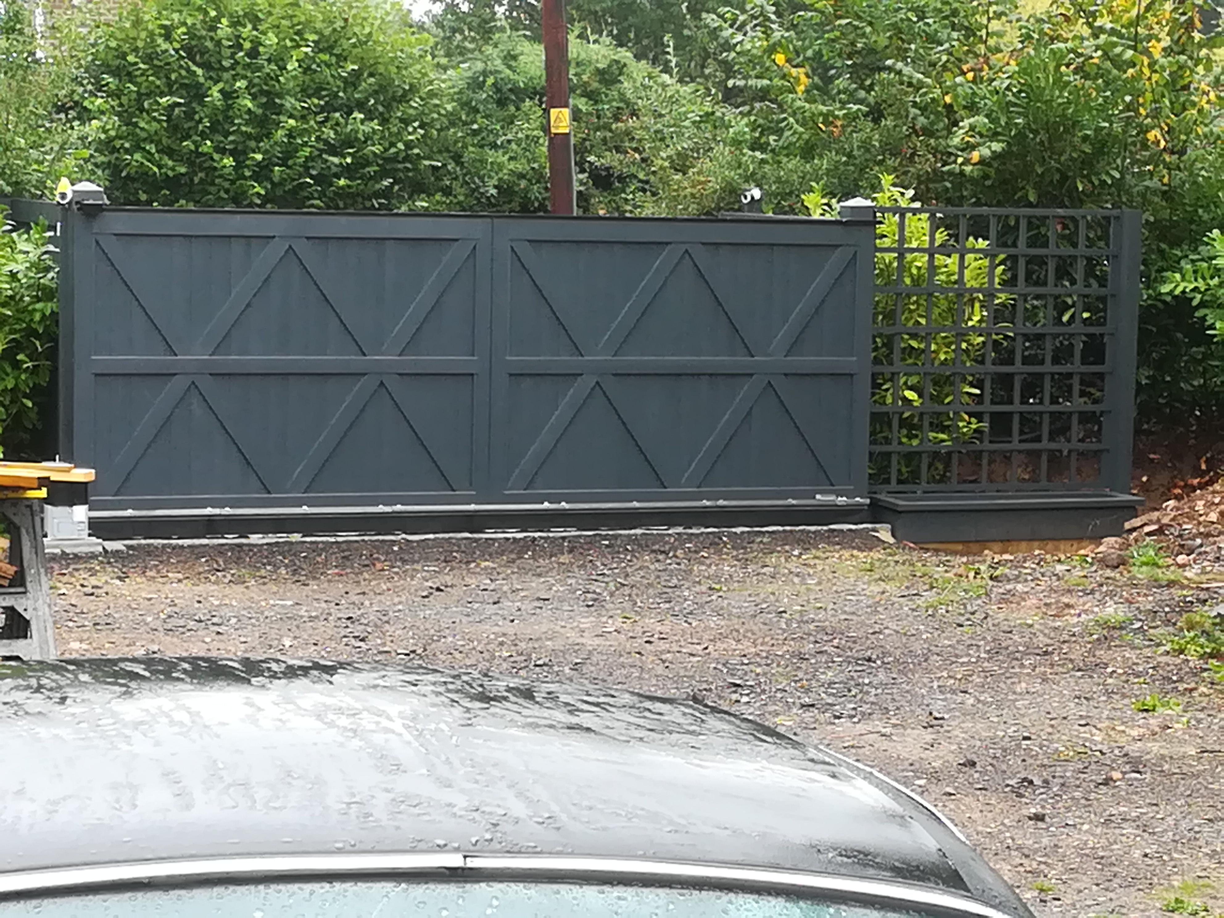

Big Jimbo Posted November 27, 2020 Posted November 27, 2020 This single sliding gate is 16ft long. I an going to have to redesign the catch due to the wind. Do not underestimate the power of mother nature.
Oz07 Posted November 28, 2020 Posted November 28, 2020 Mine is 4.5m and open with vertical bars, the wind still moves it!
Onoff Posted November 28, 2020 Posted November 28, 2020 I'm lucky in that if the wind comes up the valley it hits the gate edge on. Pretty impossible for the wind to hit the gate face on from either side due to the valley walls.
James94 Posted November 29, 2020 Author Posted November 29, 2020 Thanks for all your replies, looks like we’ll have to rethink the wooden gates and go for metal. We have quite a long drive so privacy isn’t to much of an issue.If we are to concrete over the services and drain for the pillars is there anything we should do above the ducting and drain, maybe some sort of bridging to transfer weight? Regards. James
James94 Posted June 10, 2021 Author Posted June 10, 2021 Hi Hoping to get trench hug very soon for the services from boundary boxes to house. I will require cables to power electric gates at some point, would it be ok to power gates direct from boundary box or will I have to run a cable in trench from consumer unit in house? Regards. James

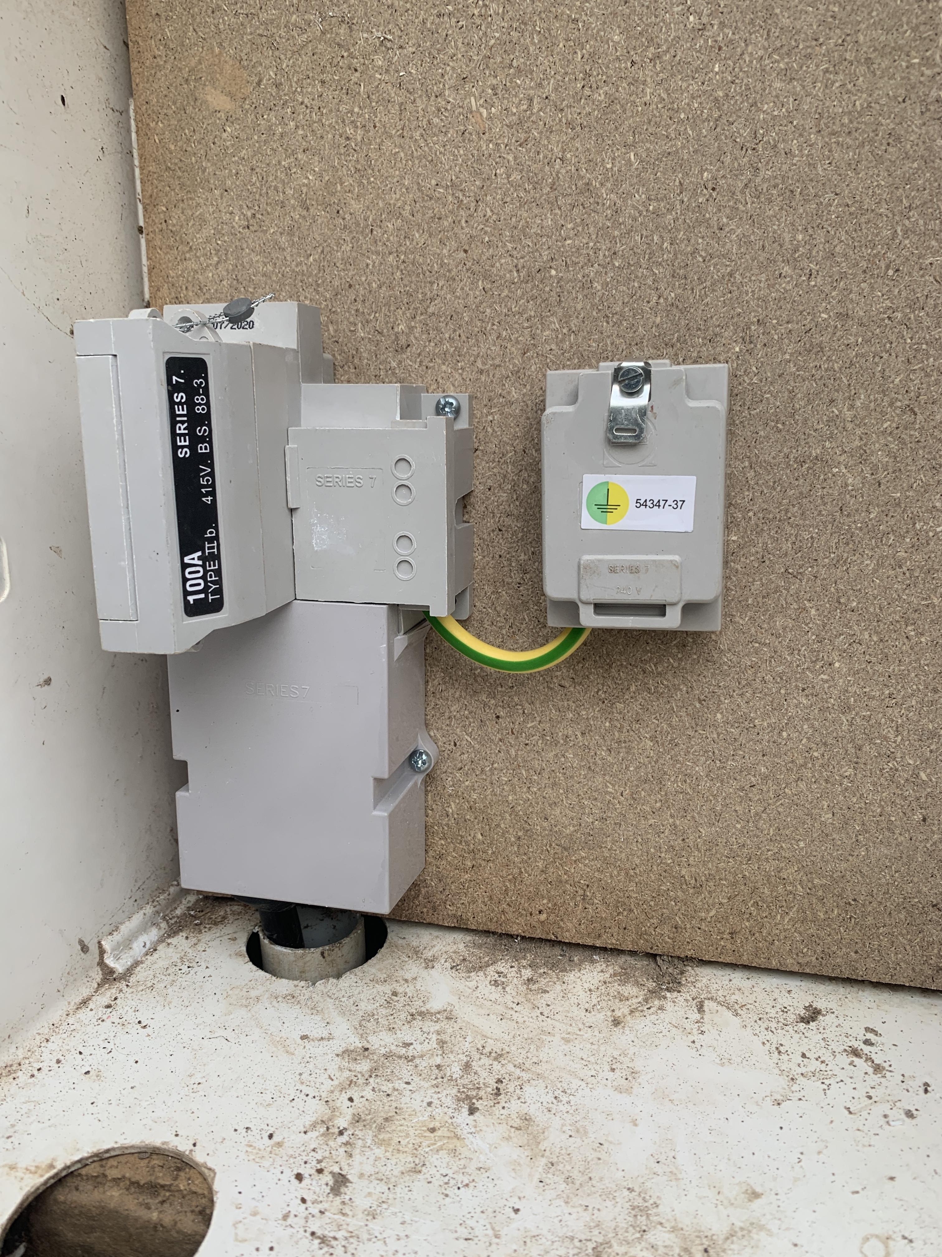

TonyT Posted June 10, 2021 Posted June 10, 2021 And best make sure the metal gates aren’t fed from a PME supply
James94 Posted June 10, 2021 Author Posted June 10, 2021 @TonyT At the moment its just the mains feed from the road capped of, wasn't going to get a meter until ready which could be some time don't want to start paying a standing charge or have council banging on door for cash.Do you think it would be ok maybe some sort of small consumer unit and short cable feed to gates other than that its 70m from house , not sure what PME supply is. Regards James
TonyT Posted June 10, 2021 Posted June 10, 2021 Your not meant to put your own equipment in the same meter box enclosure where the DNO have their meter, however you will be having a switchfuse like a Wylex KMF unit to protect your sub main back to the house. so you could just install a small consumer unit and split the rails. PME is a type of earthing arrangement that’s not great for hot tubs, EV’s and chunks of metal with electrical supplies that you can touch the general mass of earth at the same time.
James94 Posted June 11, 2021 Author Posted June 11, 2021 @TonyT I'll price up for 70m swa 3 core as an option but when I get the electrician round I'll see if he's prepared to install a small consumer unit and split the rails like suggested. This PME earthing arrangement is it something there likely to give me or can I request a different arrangement, if so which should I go for. Regards James
TonyT Posted June 11, 2021 Posted June 11, 2021 (edited) Just get 2core as you will be exporting the PME earth (take a picture of the electricity cut out for us to see to confirm ) bash in a local earth rod next to the gates and connect a 10mm earth from the rod to the gate electrics, isolator etc. Edited June 11, 2021 by TonyT
James94 Posted June 24, 2021 Author Posted June 24, 2021 @TonyT here’s the electric meter box as requested. Sorry I didn’t reply sooner been busy getting married.
