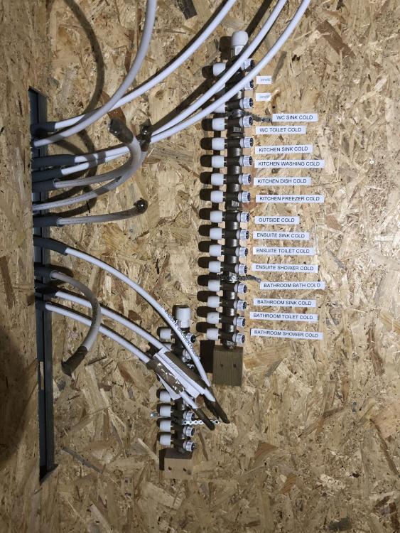

SuperJohnG Posted October 31, 2020 Share Posted October 31, 2020 (edited) On 29/10/2020 at 07:37, Nickfromwales said: If the OP has 16 x cold feeds ( assuming 3 x WC’s / 2 x cold mains appliances ) that’s 11 outlets requiring cold supplies ( so also assuming 11 hot supplies ) then the cold supply would need to get to at least the first two bathrooms in a minimum poor size of 22mm. Same for the hot, but the hot more like starting off in 28mm, then picking up the first bathroom, and then 22mm from there forward, and then reducing to 15mm as seen fit. Really if a bathroom is the last item then you can’t drop to 15mm until you’ve picked up the shower & bath. So, a minimum of 26 x T connections if you don’t adopt a radial manifold setup and fingers crossed after you’ve tested initially and boarded up. Another benefit is that for a new / self builder, you can just bring on items as work progresses, so no need to keep draining down / connecting / re-pressurising each time you add a new item. And, the party piece is hot return and flow rates. With a large single bore series setup you’ll be waiting for a very long time to get hot water out of basin sinks in particular as they are low flow / high frequency use and by the time hot had got there you’d have got fed up waiting. Pressure and flow rates are as uniform as you can get too, so question has to be.....why wouldn’t you do it? Not having isolations on the end of every run / at each outlet is a no-brainer, as most modern bathrooms won’t have somewhere for such valves to be easily / practically accessed, particularly for baths and showers etc. Regular ( series ) 0 Manifold ( radial ) 1 ( well 4 actually ). God damn.....again the forum strikes.and gives me a reason to make something better. I now see the added value.....maybe. Edited October 31, 2020 by SuperJohnG 1 Link to comment Share on other sites More sharing options...
SuperJohnG Posted October 31, 2020 Share Posted October 31, 2020 On 29/10/2020 at 07:37, Nickfromwales said: And, the party piece is hot return Are you talking about adding a loop through the manifold and extra pump? If I do a manifold then it would be adjacent to the UVC in the plant room. Is there any value there? Link to comment Share on other sites More sharing options...
Nickfromwales Posted October 31, 2020 Share Posted October 31, 2020 7 hours ago, SuperJohnG said: Are you talking about adding a loop through the manifold and extra pump? If I do a manifold then it would be adjacent to the UVC in the plant room. Is there any value there? Hot manifold adjacent to the water heater is best practice, and implementation of an HRC ( hot return circuit ) is always gauged on the dwelling. It depends on how far away your basin and sink taps are from the manifold tbh. You could shift the hpt manifold to a strategic centralised location and just have the ( HRC ) running between the UVC and the manifold and then leave as is.. Two current jobs for eg's; HRC to hot manifold at the hot water device, kitchen sink as last point of draw off on the manifold to promote flow across the whole manifold ( pre-heat ), HRC pump only pulling back from the kitchen sink therefore the whole hot manifold is warmed routinely hugely reducing waiting times at the other reasonably close outlets. Timer to be fitted for the HRC pump so that operation is in line with activity / occupancy.. HRC to hot manifold at the hot water device, HRC pump pulling back from the 2 upstairs bathrooms ( wash hand basins only ), manifold 'warmed' / 'pre-heated' as above, micro-PIR's to be fitted under each of the 2 wall-hung vanity units to trigger the HRC pump. Same PIR's to be used to also bring on ( automatically ) the night-time 'pee lights' under the vanity. Manual lighting circuit will be set to bring pee & other low-level lights on constantly for chilling in the bath ( so no overhead spots need to be on, and no disco lights from the PIR ). Timer to isolate pee lights during daylight hours if necessary. All depends on the layout of the house, so if you add distances to the basins / sinks from the UVC I can recommend something for you. 1 Link to comment Share on other sites More sharing options...
SuperJohnG Posted October 31, 2020 Share Posted October 31, 2020 4 hours ago, Nickfromwales said: All depends on the layout of the house, so if you add distances to the basins / sinks from the UVC I can recommend something for you. Thanks @Nickfromwales I will add some once i calculate. Where donyoubgetbthose Hepworth manifolds you mentioned? Google seems to eluding me! Link to comment Share on other sites More sharing options...
Russell griffiths Posted October 31, 2020 Author Share Posted October 31, 2020 Just now, SuperJohnG said: Thanks @Nickfromwales I will add some once i calculate. Where donyoubgetbthose Hepworth manifolds you mentioned? Google seems to eluding me! I’ve looked on line all week, best price is the plumbers merchants at £42 for a 4 port, you can find them cheaper but not come with no fittings, so the time you add 4 fittings your back to £42. 1 Link to comment Share on other sites More sharing options...

Nickfromwales Posted October 31, 2020 Share Posted October 31, 2020 44 minutes ago, Russell griffiths said: I’ve looked on line all week, best price is the plumbers merchants at £42 for a 4 port, you can find them cheaper but not come with no fittings, so the time you add 4 fittings your back to £42. What fittings? Link to comment Share on other sites More sharing options...
Nickfromwales Posted October 31, 2020 Share Posted October 31, 2020 25 minutes ago, JOE187 said: https://www.jtmplumbing.co.uk/search/manifold#sort9 JTM offer a good variety keenly priced! https://www.jtmplumbing.co.uk/pipe-fittings-c433/hep2o-brass-manifolds-c661/hep2o-four-port-valved-manifold-15-tm-tf-fp-p21691 Remember you can’t mix JG Speedfit manifolds with Hepworth pipe. Has to be like for like for manufacturers warranty to remain intact. 1 Link to comment Share on other sites More sharing options...
Pocster Posted October 31, 2020 Share Posted October 31, 2020 2 minutes ago, Nickfromwales said: https://www.jtmplumbing.co.uk/pipe-fittings-c433/hep2o-brass-manifolds-c661/hep2o-four-port-valved-manifold-15-tm-tf-fp-p21691 Remember you can’t mix JG Speedfit manifolds with Hepworth pipe. Has to be like for like for manufacturers warranty to remain intact. I used these . They are excellent quality ! Link to comment Share on other sites More sharing options...
Russell griffiths Posted October 31, 2020 Author Share Posted October 31, 2020 21 minutes ago, Nickfromwales said: What fittings? The cheaper ones I found take a Euro cone fitting, so cheaper manifold but have to buy 4 euro cones per manifold. Those jtm ones are cheaper and I think they are made by reliance valves who know there stuff. Link to comment Share on other sites More sharing options...
Russell griffiths Posted October 31, 2020 Author Share Posted October 31, 2020 21 minutes ago, Nickfromwales said: https://www.jtmplumbing.co.uk/pipe-fittings-c433/hep2o-brass-manifolds-c661/hep2o-four-port-valved-manifold-15-tm-tf-fp-p21691 Remember you can’t mix JG Speedfit manifolds with Hepworth pipe. Has to be like for like for manufacturers warranty to remain intact. Why would you need a warranty, what bit for?? or are you talking about if it caused a flood. 1 Link to comment Share on other sites More sharing options...

trialuser Posted November 4, 2020 Share Posted November 4, 2020 On 31/10/2020 at 08:07, Nickfromwales said: Hot manifold adjacent to the water heater is best practice, and implementation of an HRC ( hot return circuit ) is always gauged on the dwelling. It depends on how far away your basin and sink taps are from the manifold tbh. You could shift the hpt manifold to a strategic centralised location and just have the ( HRC ) running between the UVC and the manifold and then leave as is.. Two current jobs for eg's; HRC to hot manifold at the hot water device, kitchen sink as last point of draw off on the manifold to promote flow across the whole manifold ( pre-heat ), HRC pump only pulling back from the kitchen sink therefore the whole hot manifold is warmed routinely hugely reducing waiting times at the other reasonably close outlets. Timer to be fitted for the HRC pump so that operation is in line with activity / occupancy.. HRC to hot manifold at the hot water device, HRC pump pulling back from the 2 upstairs bathrooms ( wash hand basins only ), manifold 'warmed' / 'pre-heated' as above, micro-PIR's to be fitted under each of the 2 wall-hung vanity units to trigger the HRC pump. Same PIR's to be used to also bring on ( automatically ) the night-time 'pee lights' under the vanity. Manual lighting circuit will be set to bring pee & other low-level lights on constantly for chilling in the bath ( so no overhead spots need to be on, and no disco lights from the PIR ). Timer to isolate pee lights during daylight hours if necessary. All depends on the layout of the house, so if you add distances to the basins / sinks from the UVC I can recommend something for you. @Nickfromwales, or anyone. As I understand it, one of the benefits of the distribution manifold is the absence of joints on the pipe journey, so this implies plastic pipe. Can you suggest a plastic pipe that is suitable for a HRC that doesn't need fancy tools to join. I'm struggling to find anything. Many thanks Link to comment Share on other sites More sharing options...
Russell griffiths Posted November 4, 2020 Author Share Posted November 4, 2020 6 hours ago, trialuser said: @Nickfromwales, or anyone. As I understand it, one of the benefits of the distribution manifold is the absence of joints on the pipe journey, so this implies plastic pipe. Can you suggest a plastic pipe that is suitable for a HRC that doesn't need fancy tools to join. I'm struggling to find anything. Many thanks They all require fancy tools, I may be about to buy a set that I would sell on afterwards, what makes have you looked at. Link to comment Share on other sites More sharing options...
SuperJohnG Posted November 4, 2020 Share Posted November 4, 2020 14 minutes ago, Russell griffiths said: They all require fancy tools, I may be about to buy a set that I would sell on afterwards, what makes have you looked at. What fancy tools are we talking here? Standard type plastic pipe like speedfit or hep20 just require a pair of snips to make.lofe easier. You can buy cheap ones at 10 quid or say rothenberger for 50 quid. But not much more than that I am aware of? Link to comment Share on other sites More sharing options...
PeterW Posted November 4, 2020 Share Posted November 4, 2020 Hep2O is suitable for a HRC, the bronze pump is the only non standard item. In terms of connections, everything in Hep2O is push fit and as @SuperJohnG says you just need a decent set of cutters. I’m on my second pair of these in 10 years. Only place you then need copper is to make tails for the pump and into the UVC, all the rest can be in Hep2O push fit. Link to comment Share on other sites More sharing options...

Nickfromwales Posted November 4, 2020 Share Posted November 4, 2020 (edited) Hepworth for HRC needs to be temperature capped so a TMV is required in every instance. I’ve been using the same TMV that goes on the SA units as they’re decent reliable units. I set those to 50oC nominal and happy days. The question of how much of an arse your BCO is, whether or not they make you drop the bath to 46oC as “god intended” ( some BCO’s think they’re ‘up there’ for sure, and some are just massive bell-ends ). ??. Best to check before assuming that 50oC everywhere is acceptable. Edited November 4, 2020 by Nickfromwales Link to comment Share on other sites More sharing options...
trialuser Posted November 4, 2020 Share Posted November 4, 2020 Following a bit more research, I'm going to use copper. We definately have a mice issue. I assume that apart from a central point of isolation, there isn't't really a huge benefit to the manifold system. Link to comment Share on other sites More sharing options...
