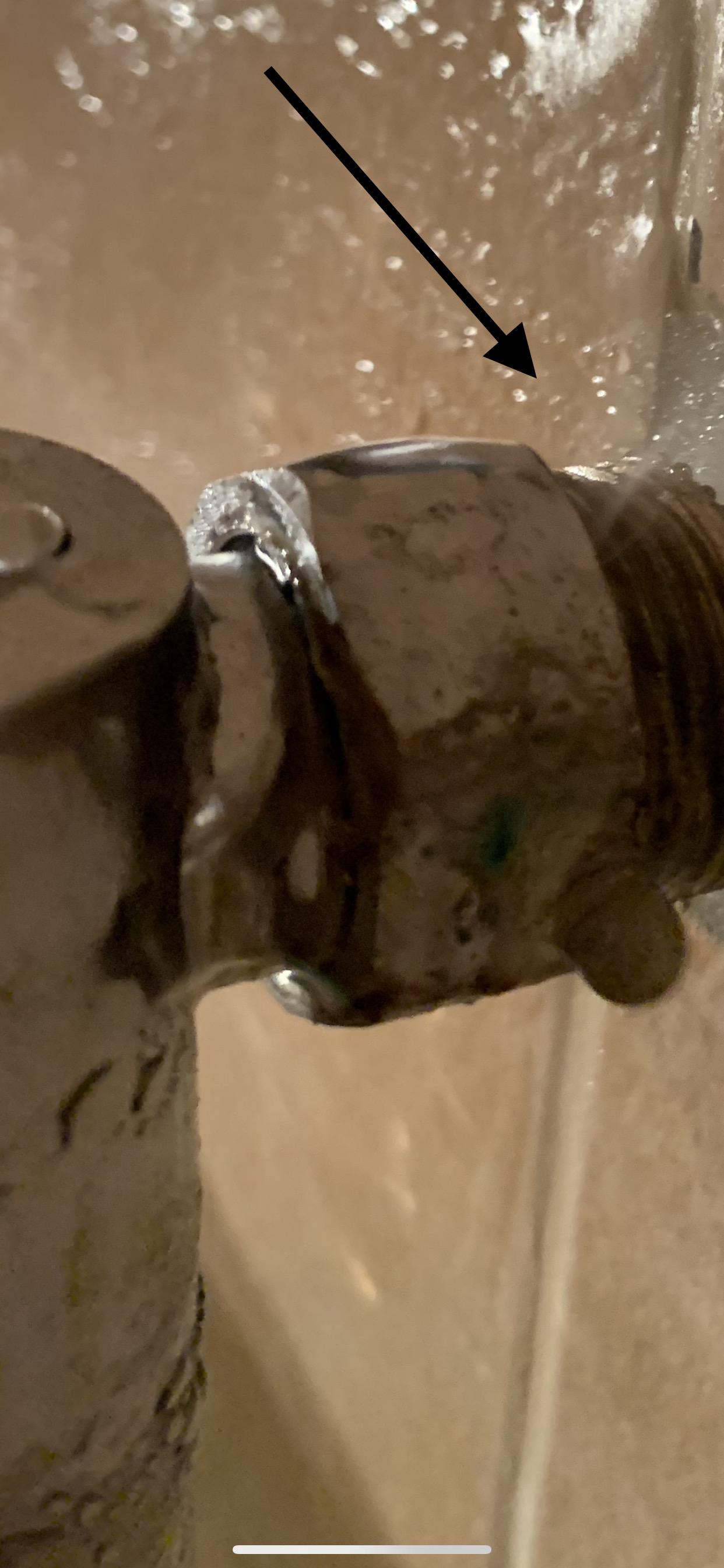

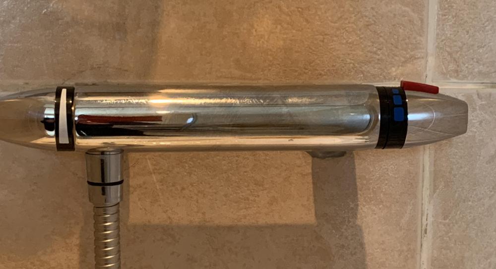

newhome Posted October 22, 2020 Share Posted October 22, 2020 Not the tray thankfully but water is coming out from where the thermostatic unit connects to the pipes. As getting a plumber out here is nigh on impossible I am going to attempt to either fix it myself or cap it off until I can get someone out to fix it. As a plumbing virgin I have a few questions. The water is spraying out where the arrow is. Does this indicate a washer problem or something else? if it’s a washer and it’s an easy fix what size do I need? I have the tool pictured that I used to tighten it up (didn’t work, just made it leak more, and yes I did turn it the right way ?). I thought an adjustable spanner might be best but what size do I need (need to buy one), preferably a cheap one on Amazon Prime as I can’t see me doing this often! This is what I have. This is what I want (I think). Plan B is to cap it off using a push fitting as below until I can get someone in. I don’t use this shower much anyway. All help appreciated before I flood the house ? Link to comment Share on other sites More sharing options...

jfb Posted October 22, 2020 Share Posted October 22, 2020 i think my first call would be to isolate it, clean it up a bit with wire brush and then slap a load of PTFE tape on and tighten. 1 Link to comment Share on other sites More sharing options...
Onoff Posted October 22, 2020 Share Posted October 22, 2020 2 hours ago, newhome said: Not the tray thankfully but water is coming out from where the thermostatic unit connects to the pipes. As getting a plumber out here is nigh on impossible I am going to attempt to either fix it myself or cap it off until I can get someone out to fix it. As a plumbing virgin I have a few questions. The water is spraying out where the arrow is. Does this indicate a washer problem or something else? if it’s a washer and it’s an easy fix what size do I need? I have the tool pictured that I used to tighten it up (didn’t work, just made it leak more, and yes I did turn it the right way ?). I thought an adjustable spanner might be best but what size do I need (need to buy one), preferably a cheap one on Amazon Prime as I can’t see me doing this often! This is what I have. This is what I want (I think). Plan B is to cap it off using a push fitting as below until I can get someone in. I don’t use this shower much anyway. All help appreciated before I flood the house ? Erm...I don't think that'll work at the leaking fitting isn't a 15mm pipe. Got a bigger picture? For a start use a screwdriver to turn those two valves to the horizontal. You should be able to then undo the fitting with only a little local water loss. Guessing a washer behind. A GOOD wrap of PTFE tape may sort you. 1 Link to comment Share on other sites More sharing options...
Big Jimbo Posted October 22, 2020 Share Posted October 22, 2020 Once you get it isolated, take it off. Take the washer out and turn it around. Wrap the thread that the fitting goes onto with ptfe, and bung it back on. Sorted. 1 Link to comment Share on other sites More sharing options...

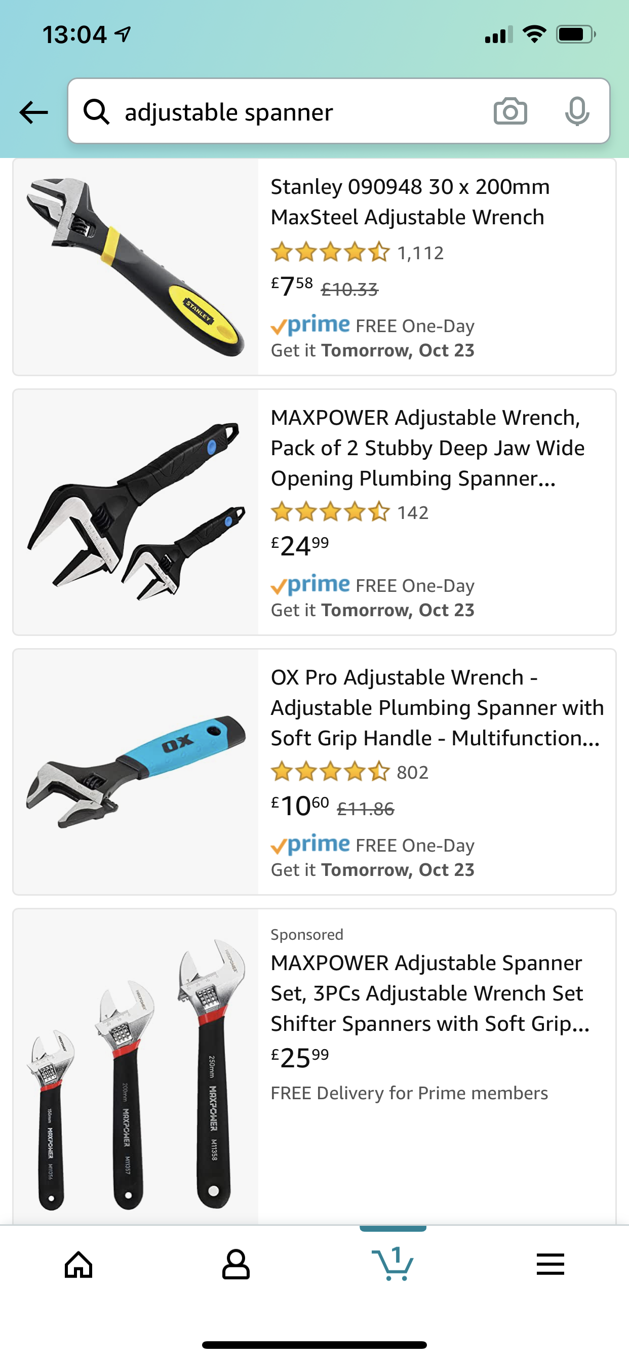

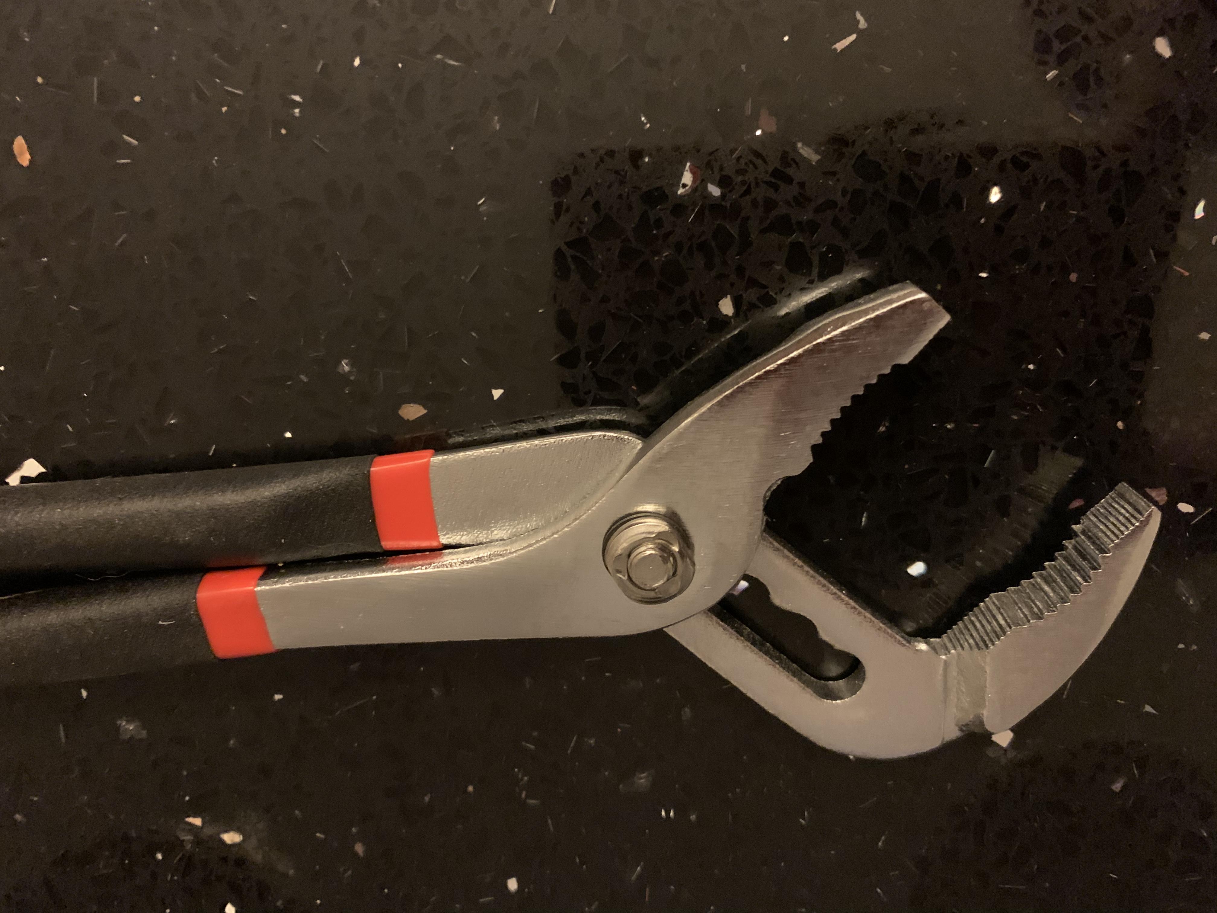

ToughButterCup Posted October 22, 2020 Share Posted October 22, 2020 2 hours ago, newhome said: ... I thought an adjustable spanner might be best but what size do I need (need to buy one), ... Cheap is not a good idea with adjustable spanners. Since you mention Amazon, this selection, not the cheapest or most expensive, might well suit. I suggest this range because the jaw action is more precise. You are less likely to slip because the jaws tend to fit more precisely and so have less play. 1 Link to comment Share on other sites More sharing options...
ProDave Posted October 22, 2020 Share Posted October 22, 2020 Is this one of 2 fittings connecting to a bar mixer? If so the water will be on all the time unless you isolate at the ballofix valves (the things with a screwdriver slot) Or is this a single fitting onto which just a shower hose fits? In which case it will only be "live" with water when the shower controls are turned off. Once you isolate it you can unscrew it with your glad pliers, but wrap something like an old towel around the nut to stop the pliers marking the chrome. You will find a rubber or possibly a fibre washer. It may even have a gauze filter built in. you need to get a new one the same to replace it. Over tightening is often a cause for failure. 1 Link to comment Share on other sites More sharing options...
Construction Channel Posted October 22, 2020 Share Posted October 22, 2020 The isolation valves pictured are in @Ferdinandhouse so I doubt they will stop much water coming out of @newhomes shower. If the shower doesn't have isolators which is more than likely you might get away with turning the water off at the mains while you do what @Big Jimbo suggested. But while you have the washer out measure it and order a new one as turning it round will only be a temporary fix. 2 Link to comment Share on other sites More sharing options...
Onoff Posted October 22, 2020 Share Posted October 22, 2020 In desperation, miles from anywhere with no tools I bought one of these from a petrol station. Surprisingly good: https://www.amazon.co.uk/Amtech-C1680B-2-in-1-Stubby-Wrench/dp/B008PSM7M8/ref=sr_1_1?dchild=1&keywords=amtech+stubby&qid=1603387792&s=diy&sr=1-1 1 Link to comment Share on other sites More sharing options...

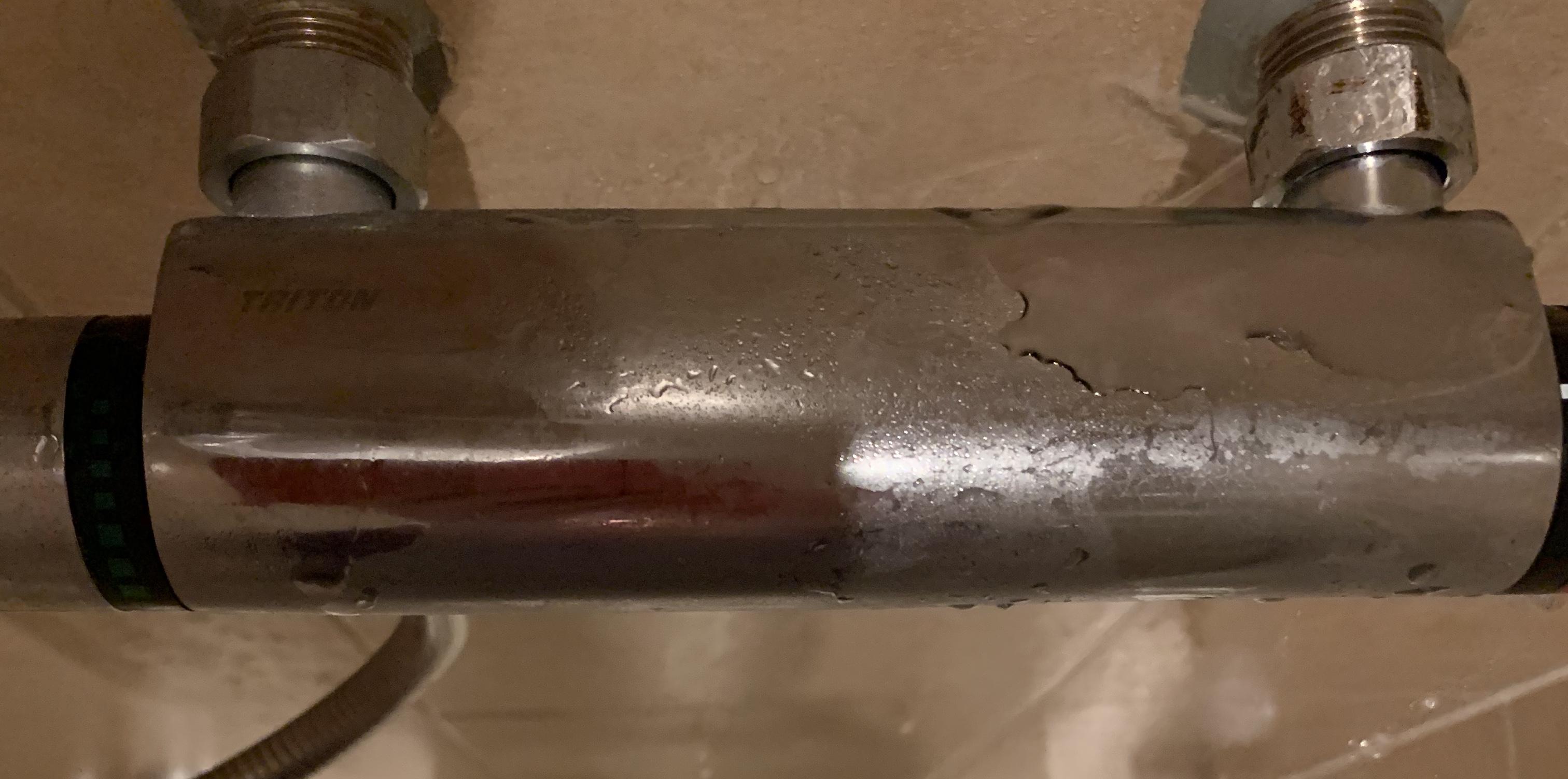

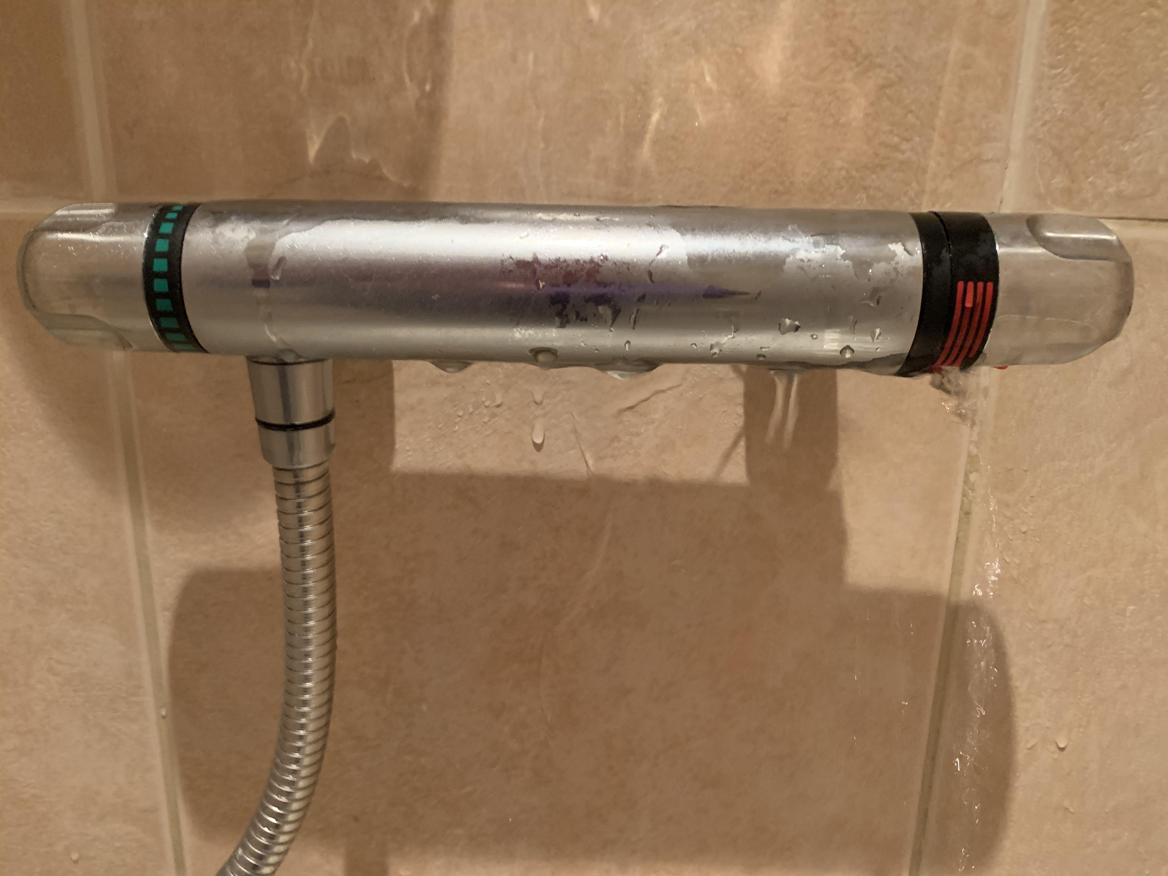

newhome Posted October 22, 2020 Author Share Posted October 22, 2020 Oh God I don’t know if it has an isolator! I was planning to turn the water off at the stopcock and if everything went to shit cap the thing off before turning the water back on. I don’t actually know where the stopcock is in truth ?. There is a tap on one of the pipes in the services room so am guessing that it’s that! The last person to turn it off was @PeterW I think and I didn’t see where. The mixer thing is as @ProDave suggests; a mixer bar with 2 pipes like that (the other one isn’t leaking) the on off is on the left (where it’s not leaking) and the temperature control is on the right where it is leaking. Thanks for all the replies so far. I’m not attempting anything until I know I’ve got the correct bits and have some idea what I’m doing. How do I tell if those cap things will fit? Link to comment Share on other sites More sharing options...
newhome Posted October 22, 2020 Author Share Posted October 22, 2020 So that’s definitely the stopcock in the services room as no water now. I can’t see any isolators to any of the showers so guess the answer is no to that question. Not the best photos but here is the mixer Link to comment Share on other sites More sharing options...

ProDave Posted October 22, 2020 Share Posted October 22, 2020 If it's an unvented cylinder then after turning off the cold stopcock, you will need to let the pressure off the hot water. There is surely at least one stop valve for the hot water out of the cylinder? You will need hot and cold turned off to remove the bar mixer to get to the offending washer. 1 Link to comment Share on other sites More sharing options...
PeterW Posted October 22, 2020 Share Posted October 22, 2020 1 minute ago, ProDave said: There is surely at least one stop valve for the hot water out of the cylinder? Nope it’s a beast of a 500 litre thermal store !! 1 Link to comment Share on other sites More sharing options...

ProDave Posted October 22, 2020 Share Posted October 22, 2020 Ah so just turning off the cold stopcock is all you need. I would go and buy this set https://www.ebay.co.uk/itm/5-EACH-1-2-5-EACH-3-4-BSP-BOTH-PLAIN-AND-MESH-FILTER-PLUMBING-HOSE-WASHERS/274345333529?hash=item3fe0419319:g:L4kAAOSwdppeoXNd I am sure the ones you need are amongst them plus some spares for the next job. 1 Link to comment Share on other sites More sharing options...
joe90 Posted October 22, 2020 Share Posted October 22, 2020 It usually like this https://www.ebay.co.uk/itm/WASHING-MACHINE-DISHWASHER-SHOWER-VALVE-HOSE-FILTER-MESH-GAUZE-WASHER-3-4-BSP/333483418680?hash=item4da5292438:g:U7EAAOSwMkhddjK2. Just need to measure the size when you get it out. 1 Link to comment Share on other sites More sharing options...
PeterW Posted October 22, 2020 Share Posted October 22, 2020 7 minutes ago, newhome said: Nope I don’t think I have that cover. Nearly took it out with my electricity supplier but it had so many restrictions and exclusions I decided not to bother. Found the stopcock now and water is off. Will look to sort something tomorrow as I don’t want an emergency scenario in the night! Wonder what is leaking. They are pretty standard units and don’t tend to leak unless there is a crack in the casting. Hopefully not one in the pipe itself ..! Can be capped off or a new bar fitted - if you don’t use it that much then this would probably fit. Jetcloud 6226129485304 Chrome Modern Thermostaic Bar Mixer Anti Scald Exposed Bottom Outlet Tap for 1/2" Shower Hose Brass Diverter Valve https://www.amazon.co.uk/dp/B07KR25G6D/ref=cm_sw_r_cp_api_i_tqDKFbXZ3WHJ2 1 Link to comment Share on other sites More sharing options...
joe90 Posted October 22, 2020 Share Posted October 22, 2020 Dead easy to remove the bar and those grips you have, with a cloth should remove the nuts..... 1 Link to comment Share on other sites More sharing options...

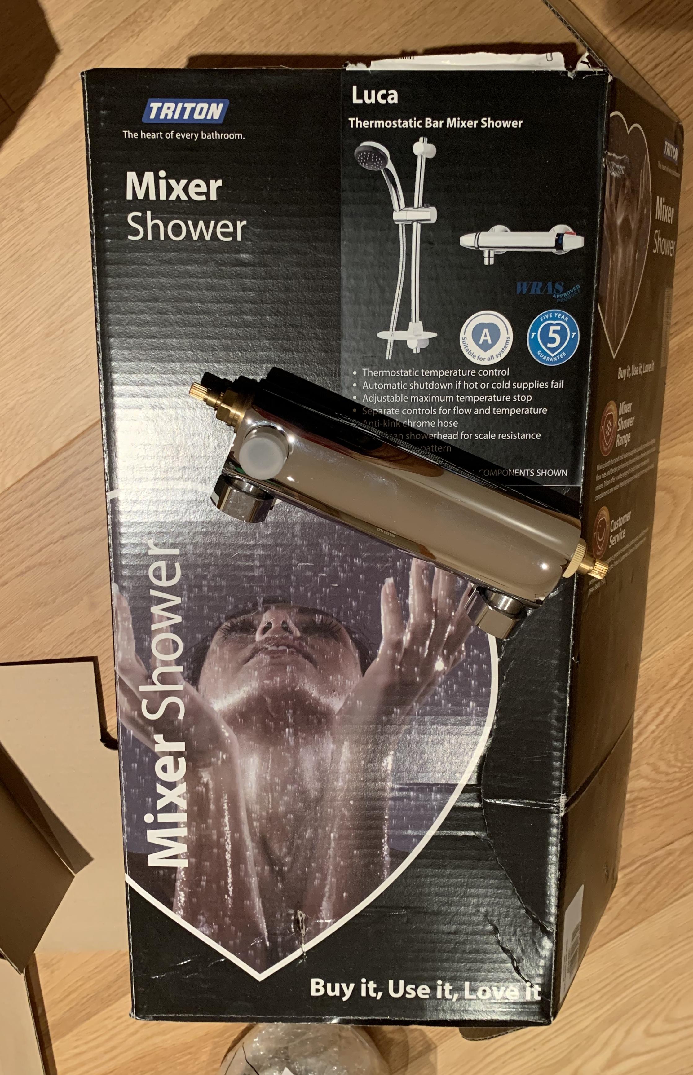

newhome Posted October 22, 2020 Author Share Posted October 22, 2020 Looks like there is a spare shower in a cupboard. Assume this would do? 1 Link to comment Share on other sites More sharing options...
PeterW Posted October 22, 2020 Share Posted October 22, 2020 Yep that should fit ..! Are there any washers in the bar ..?? Or a small bag with a couple of washers with filters on ..? Link to comment Share on other sites More sharing options...
newhome Posted October 22, 2020 Author Share Posted October 22, 2020 Looks like the bar has washers like the ones that @joe90 posted. Will give it a whirl tomorrow. What could possibly go wrong! .... ? Thanks all. Will report back either in panic or to report success. Think I’ll leave the water off when I go to bed. 1 Link to comment Share on other sites More sharing options...
