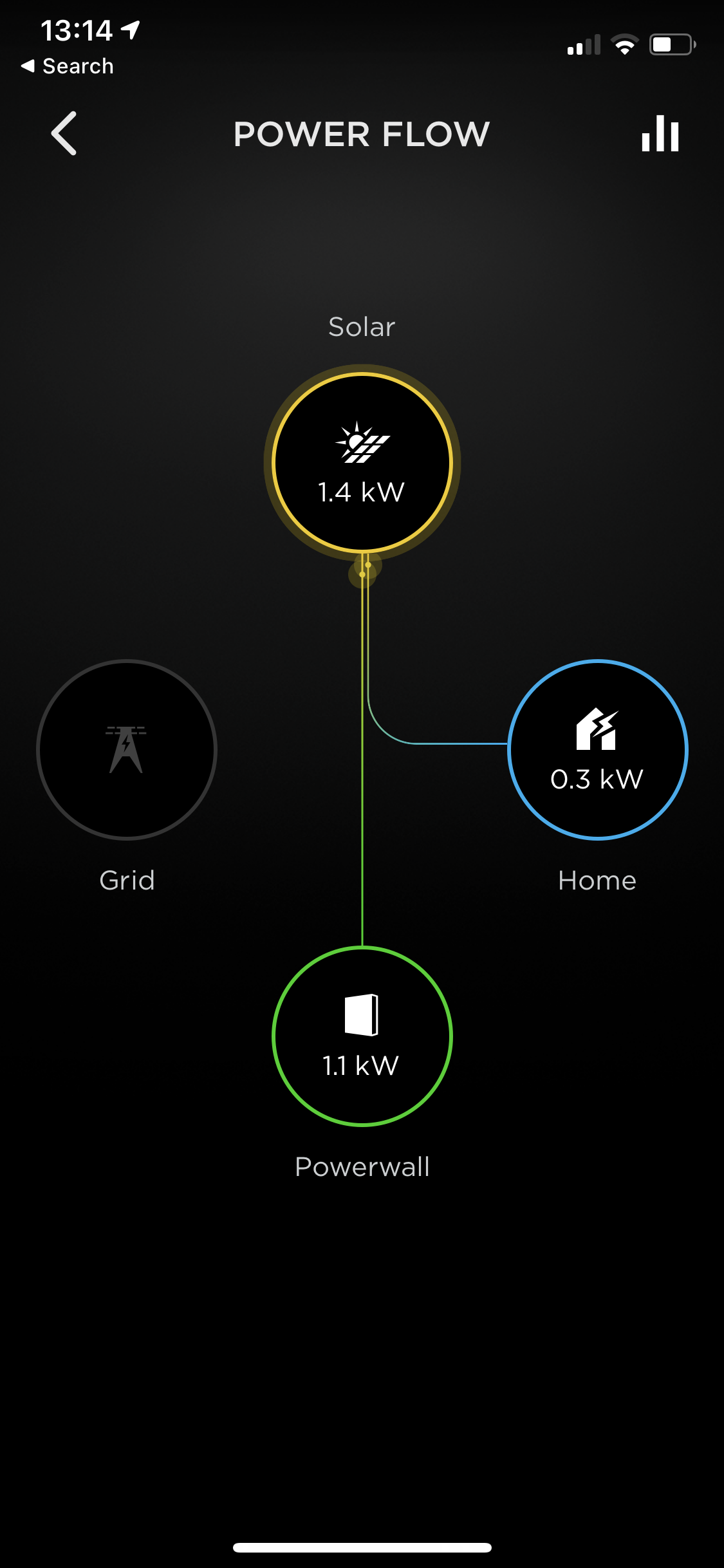

@pocster how much did your battery charge today? I look forward to regular updates on this. I probably shouldn't be but I'm super excited for you!
Too be fair it did surprisingly well . Min is 5% charge retained for backup . We got to 25% - so 20% on a overcast day with the odd 10 minutes of limited sunshine .
It tells me in the stats that I managed 48% self sufficiency.
So given the crap weather and time of year I was pleasantly surprised!
that's pretty darn cool.
