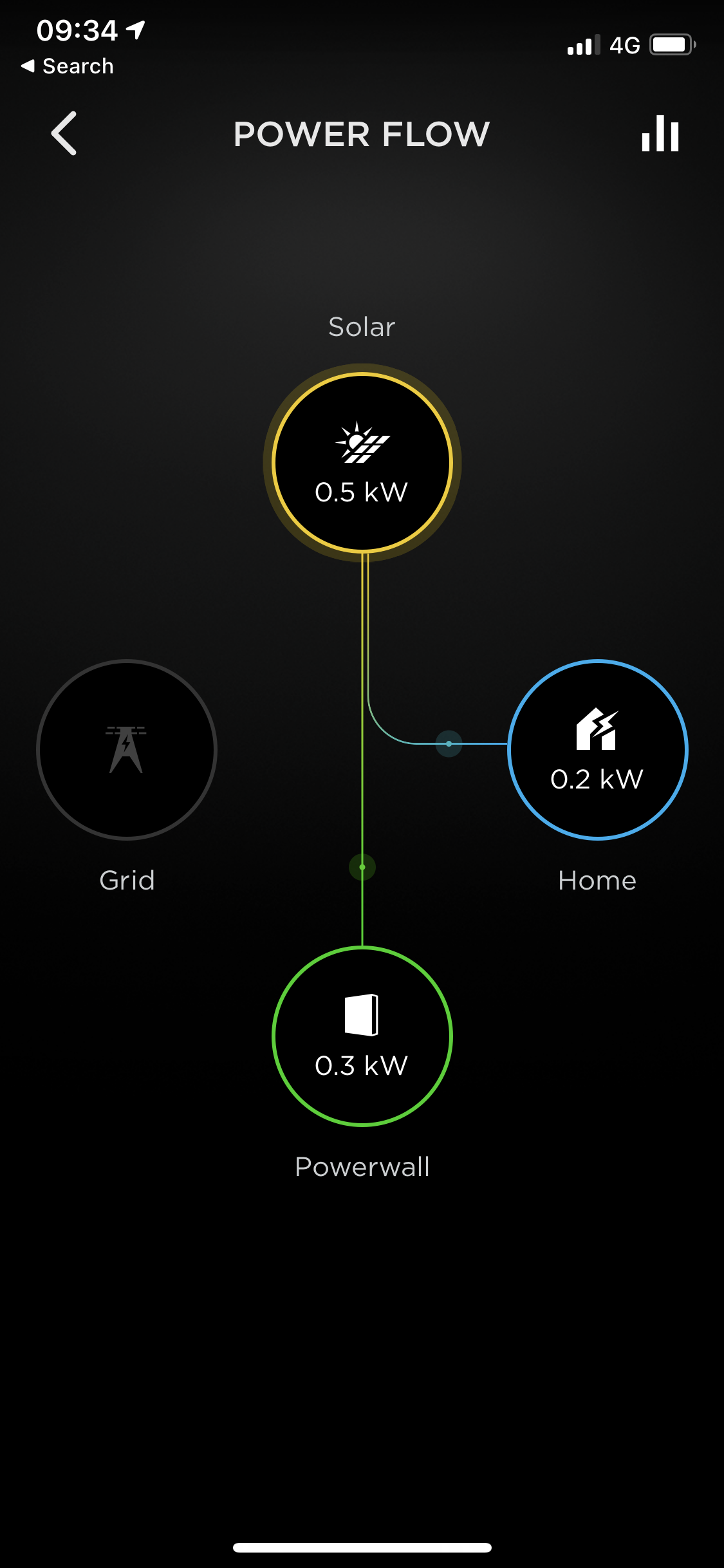

12 minutes ago, pocster said:
Simple things please simple minds .
My building site is now self sufficient! ?
Actually it isn’t.. it’s a fallacy as the grid frequency is driving your inverter phasing so if you hit the main isolator on your grid connection the lights will go out ....
Oh how we like to spoil the fun !

Also the battery is currently set to charge only off pv . Was 5% this morning ( I set that as the minimum) - currently at 7% . Not a particularly sunny day .
I wonder what could be happening??? ?
Tesla PW2 supports battery backup failover during grid outage, and I understand it will adjust the frequency dynamically to lure the PV inverter into increasing/decreasing production according to needs. So it depends how this one was connected up.
