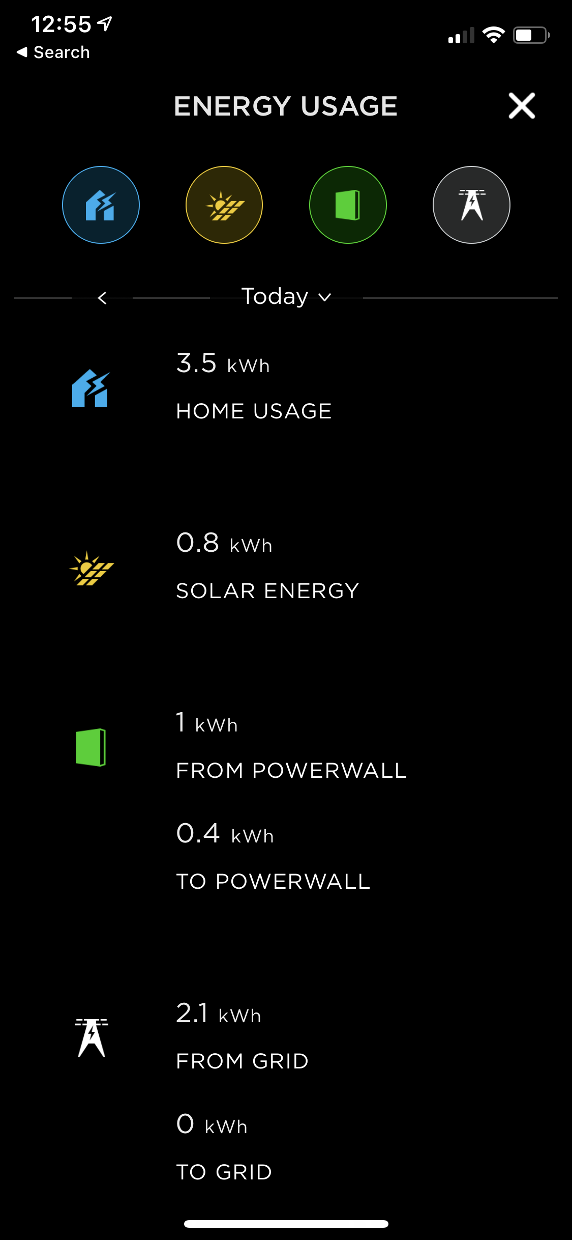

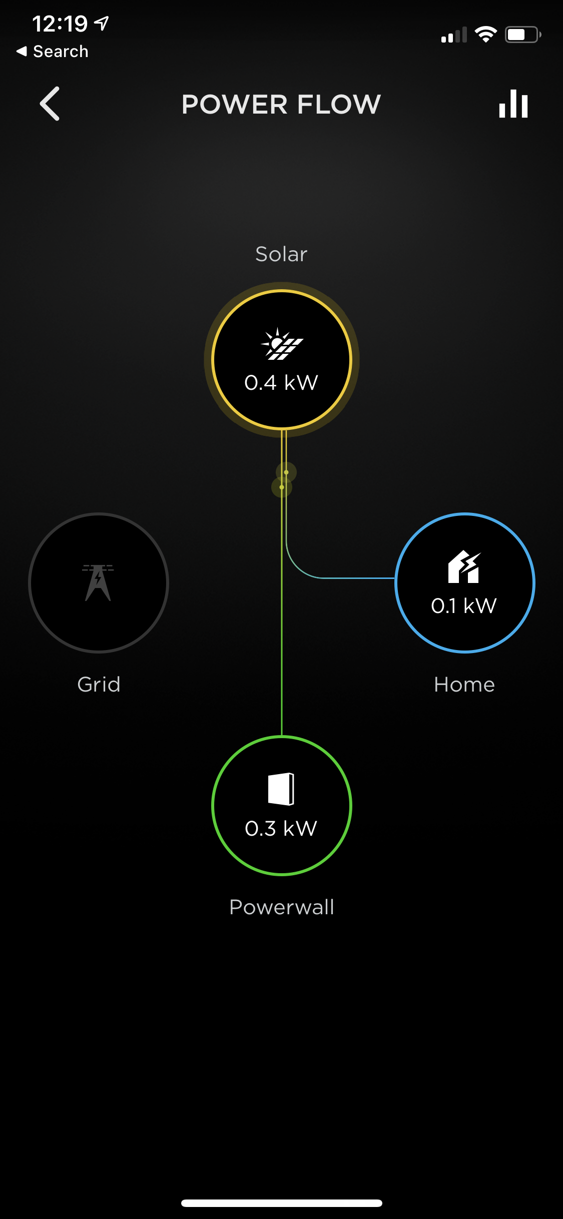

Tesla going in today !
1 minute ago, pocster said:
charge the battery for night use
Do you know, or can you accurately estimate, your night usage?
Don't know what your weather is like so far north and east of the true West Country, but down here it is a 'no weather day'.
So just a white/grey sky and no wind, occasional rain.  But because there is a lot of scattered light, it would be interesting to see how much your PV will generate, probably not as bad as one assumes.

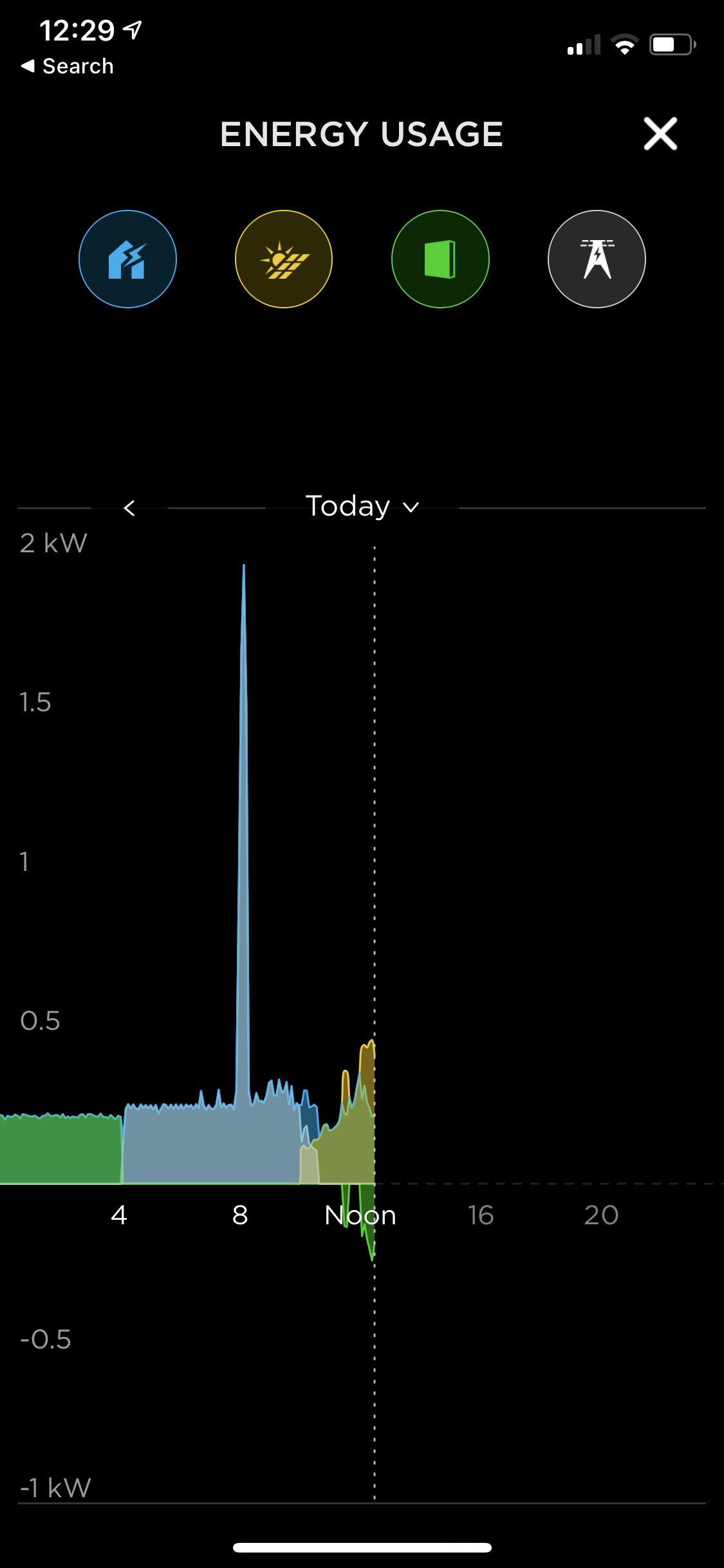

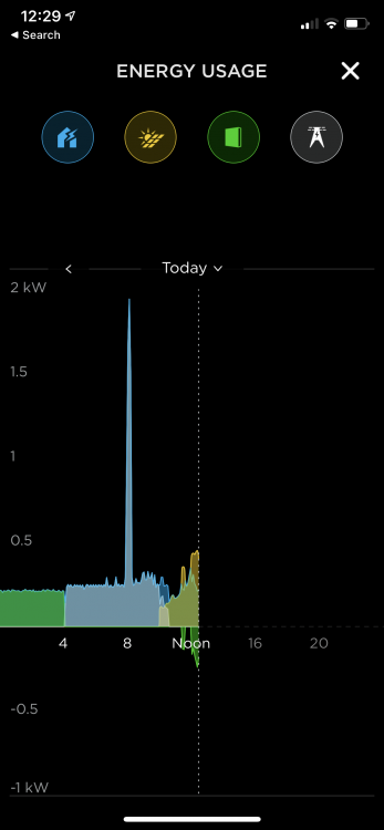

can it show the energy, rather than the power?
6 minutes ago, SteamyTea said:
What do you use in the place you currently live in?
There are many on here that will agree with that method.
What do you mean ? . To measure my consumption in my current abode ??
You mean like this ?
Yes, it will not change much when you initially move into your new place (we take our habits with us).
Yes, and no.  That is pretty useless really, can't see any numbers, so just about impossible to work out what is happening.
that's an interesting spike at 8am? what comes on at that time? ASHP? Kettle? Hydroponics setup? :ph34r:
I assume ASHP did something !! . Nothing else on site plugged in to generate that spike
