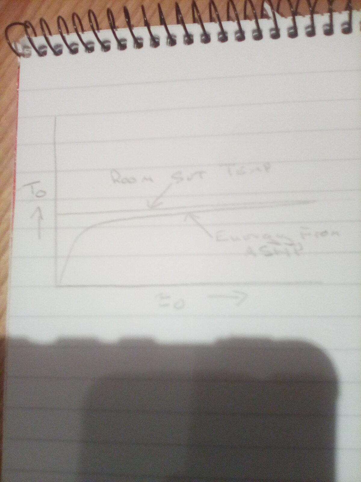

41 minutes ago, PeterW said:
trying to simplify weather compensation algorithms to their basics is nigh on impossible unless you have a good understanding of physics.
Or a simple picture, though suspect a hiding for nothing.
Only physics needed is T=temperature and t=time.

"Temperature compensation". Aha, I missed these words before as I was distractedly frazzled trying to understand the turn it up test.
Ok now this surely is the nub of what needs adjusting: at last I can see the wood for the trees. Its pretty obvious this is where the minor issue lies, if I find what I've repeatedly said I find. No need for any 'turn it up' (.. is there?) I didn't even know there was such a thing/ area/ section as 'temperature compensation'.
If I knew where this was, heck I could probably tweak it myself, maybe in 5mins. But finding it, in that manual?? no flaming chance.
Thanks- useful info then from ProDave (obviouslyI needed joe90's calm manner to get me to it!).

Right, last go.
Think of it as a car, one with manual gears.
Each gear will have a maximum top speed when the car is running on level ground.
Think of that top speed as temperature.
Now you can keep the same temperature, but get there faster by using a lower gear i.e. better acceleration.
Temperature compensation does this automatically for you (no don't say you don't understand automatic cars and have never driven one, they exist, and work).
So when there is a large temperature difference, it in effect uses 'lower gears' to get desired temperature faster.
So when you are asked to 'turn the temperature up', there will be a larger temperature difference between inside and outside, the ASHP will 'drop a gear' and endeavour to close that gap as fast as it can.
If it fails to show much difference, then the temperature compensation 'curve' may need changing (and don't ask for an explanation, just accept it can be changed).
There are a number of reasons that the curve is wrong, mainly these controllers are sold globally and the default settings may be for a totally different climate than the UK (you can claim this is wrong and should not happen, and is bad design, but you are one customer out of millions, and they don't give a flying (expletive deleted) what you think).
Turning it up a few degrees for a few hours is going to take that, say 3 hours.  You have spent several days, and many collective hours of other peoples time on this.
Just give it a go, you may be surprised.

12 minutes ago, PeterW said:
Nope as it could be working correctly ..!! Until you actually do the tests we’ve asked then no one knows.
How so if its got 'temp compensation' & I'm cold @ 9am one morning (outside temp mild), but warm the next morning at 9am (outside temp a few degrees colder)?
Has my perception of cold changed in 24hrs & its actually working correctly?? or.. is it cos the temp compensation ain't working right??
I mean- come now.
Edited by zoothorn
Link to comment
Share on other sites
You’ve latched onto this being “the issue” yet it could be one of many - and despite myself, @Nickfromwales @DamonHD @ProDave and @SteamyTea asking you to try the basics to eliminate a potential issue, you’ve ignored the requests.
I have no idea if it’s the issue, and it could even be something bizarre such as the wind direction or the airflow over this sensor, but without having one more piece of information to try and help, we are all guessing.
Essentially ignoring all the advice you’ve been given is like asking us to stand in the centre of circle and walk to the edge, but telling us we are walking the wrong direction ..!!
So please either do what’s been asked and let us know the outcome, or don’t. But if you don’t, please don’t ask for any more advice on this as we are wasting our time.
  • Like 4
