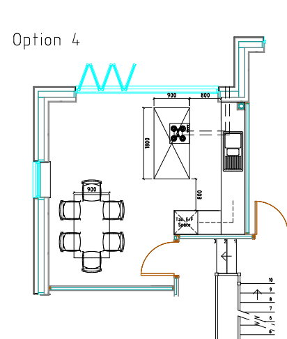

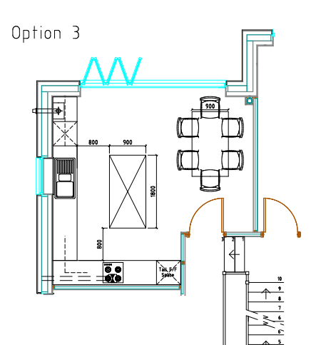

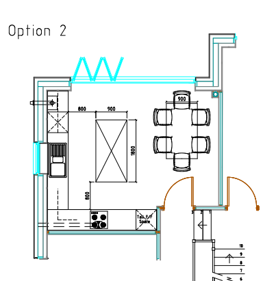

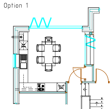

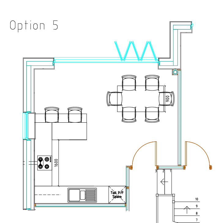

Moonshine Posted September 27, 2020 Share Posted September 27, 2020 Moving on from planning and the indicative house layouts from there, i am trying to come with some decent kitchen layouts and fit in an island if possible, one big enough that people can sit at it. Option 1 - the planning layout Option 2 - ditch the joining stairs from the right to increase usable floor area (stairs don't comply with building regs with the door anyway), though with the island seems too cramped. Option 3 - as above but with some floor space borrowed from the bedroom beneath to make it less cramped, this could work if i could make the island slightly narrower (600mm) Option 4 - switch the cabinet walls around, and change the kitchen entrance door, this needs some tweaking but not a massive fan of it. I would be interested in peoples thoughts on my ideas and any other input, or is it an island too far? kitchen layouts 1-2.pdf kitchen layouts 3-4.pdf Link to comment Share on other sites More sharing options...
Big Jimbo Posted September 27, 2020 Share Posted September 27, 2020 If i could'nt get a clearance of 1200mm to an island, i would dump it. Just me. I always find that if two people cant pass easily, it's a pain in the butt Link to comment Share on other sites More sharing options...
ProDave Posted September 27, 2020 Share Posted September 27, 2020 All of the island options would fail Scottish building regs..... I just don't see that kitchen as large enough for an island. 1 Link to comment Share on other sites More sharing options...
MJNewton Posted September 27, 2020 Share Posted September 27, 2020 20 minutes ago, Big Jimbo said: If i could'nt get a clearance of 1200mm to an island, i would dump it. Just me. I always find that if two people cant pass easily, it's a pain in the butt I often hear 1000mm as a commonly quoted minimum acceptable distance (with the likes of online planners that warn of issues configured this way too), but then I guess you're not call Big Jimbo for nothing! ? Link to comment Share on other sites More sharing options...
Big Jimbo Posted September 27, 2020 Share Posted September 27, 2020 I ran my own Kitchen Company for 20+ years. 1000mm would be absolute minimum, and still a pain in the butt. I would normally design 1400mm for back to back working. 1200mm as a minimum. You might just get away with 1000, but you will find it a pain, and may well end up with a kitchen that looks cramped. 2 1 Link to comment Share on other sites More sharing options...
Mr Punter Posted September 27, 2020 Share Posted September 27, 2020 Is this the only eating area? As others have said, you would need min 1000mm between the island and other run. You will be hurdling the dishwasher door as you have it. Options 2, 3 and 4 you cannot get to the folding doors unless you reverse them. This is worth a lot more fiddling with to make it work. Is the sink waste catered for? 1 Link to comment Share on other sites More sharing options...

Moonshine Posted September 28, 2020 Author Share Posted September 28, 2020 (edited) 12 hours ago, Mr Punter said: Is this the only eating area? As others have said, you would need min 1000mm between the island and other run. You will be hurdling the dishwasher door as you have it. Options 2, 3 and 4 you cannot get to the folding doors unless you reverse them. This is worth a lot more fiddling with to make it work. Is the sink waste catered for? yes its the only eating area, and a lot more fiddling needed to make it work. What do you mean by the sink waste? i am not sure what you mean catered for? i was just looking to pipe it out of an external wall, or does it need a bigger service void to run to the rear of the cabinets? Thanks for the input and it is fair to say that the island is a step to far, next up looking at putting a breakfast bar in and curling the kitchen round, some floor space borrowed from the bedroom beneath and breakfast bar (300mm) to the back of base units. This seems to work a bit better. Further feedback would be welcome Edited September 28, 2020 by Moonshine 1 Link to comment Share on other sites More sharing options...

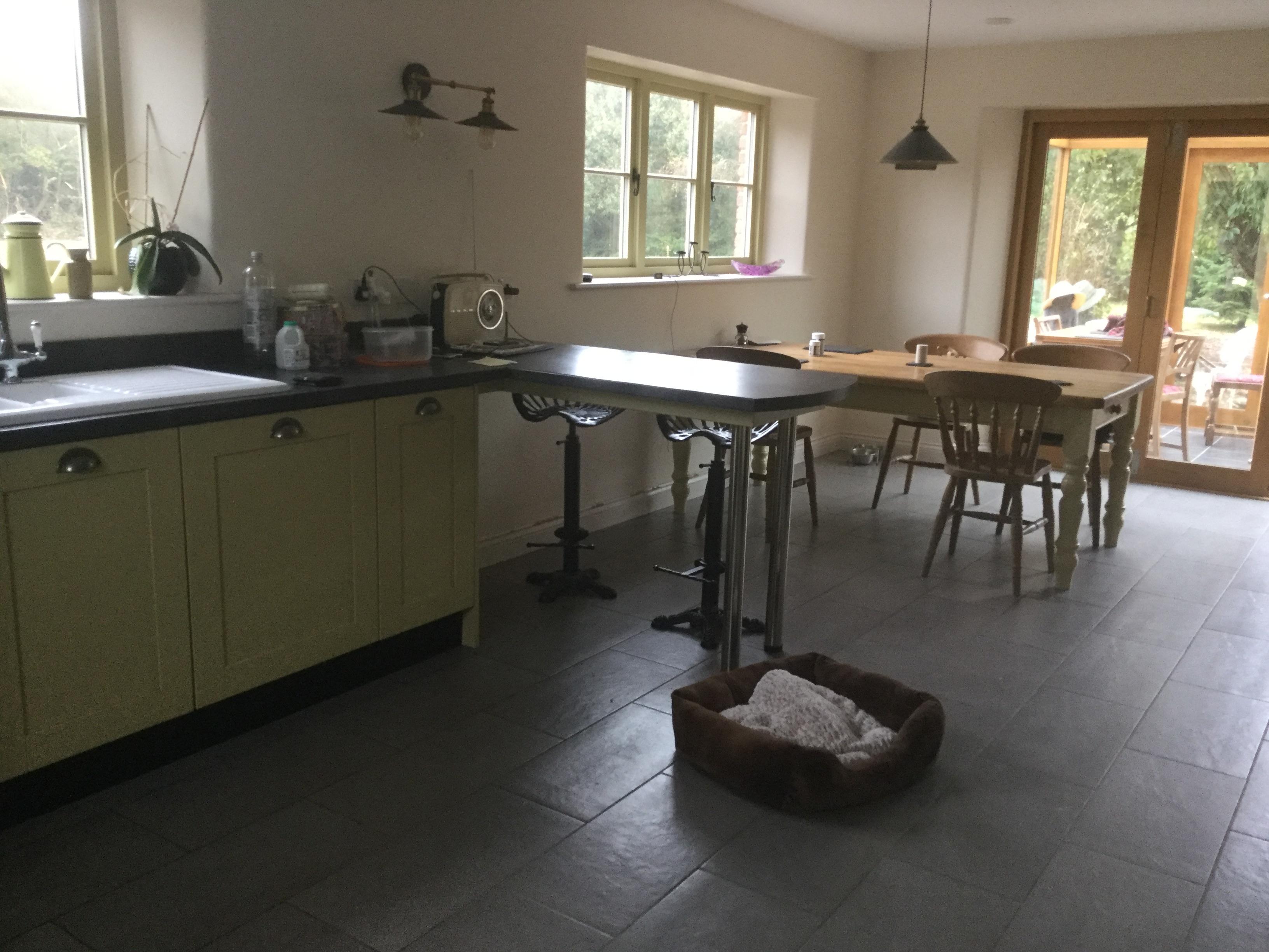

joe90 Posted September 28, 2020 Share Posted September 28, 2020 My other half wanted an island but like @Big Jimbo I hate cramped spaces (and I have been fitting kitchens for years). I came to a compromise with a peninsula That can be sat at, but a proper dining table behind. 1 Link to comment Share on other sites More sharing options...

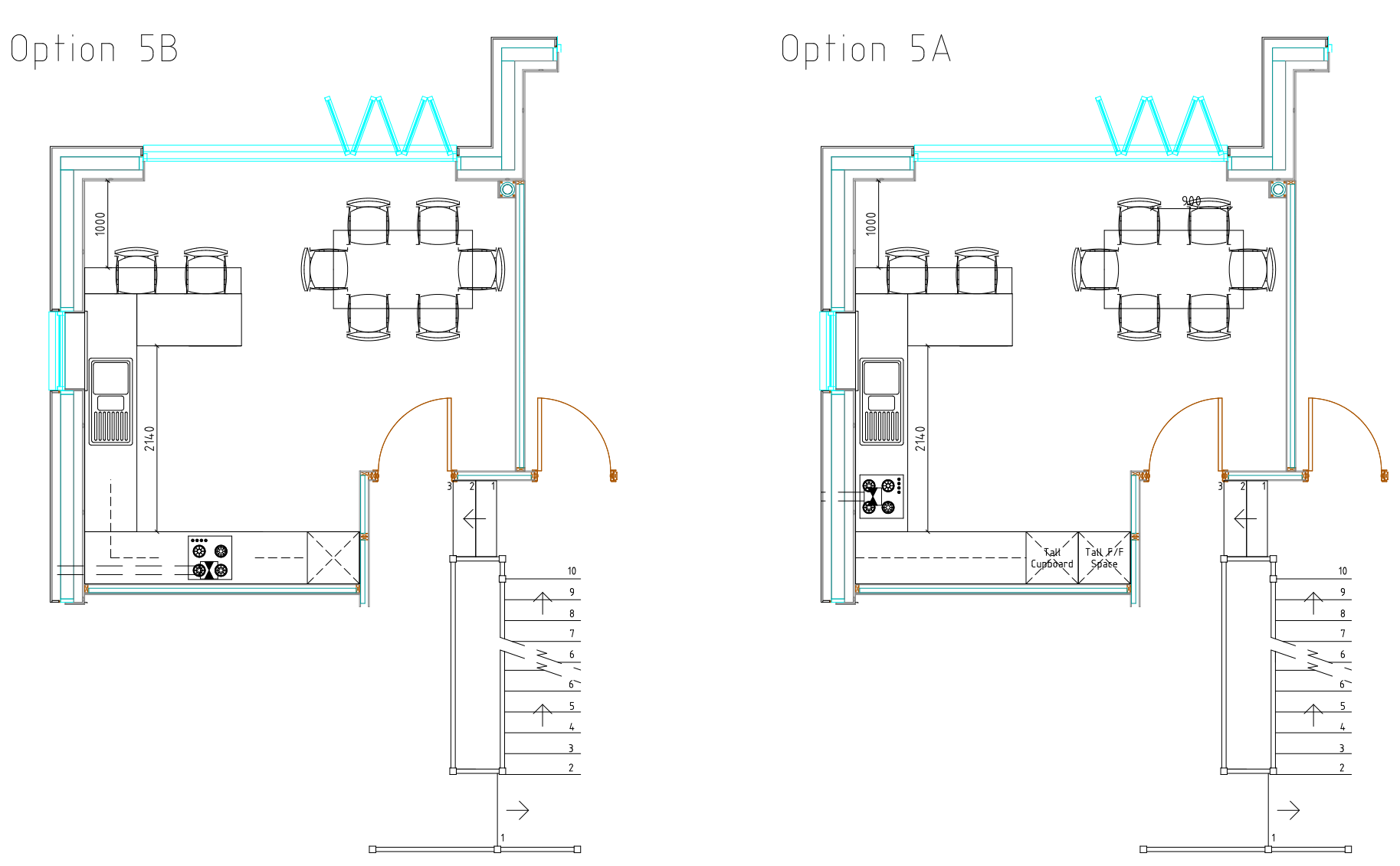

AliG Posted September 28, 2020 Share Posted September 28, 2020 (edited) I think Option 5 works the best. With this design, I would make the wall with the fridge/freezer on it a solid wall of cabinets(at least as far as the sink), put the sink where the hob is and put the hob facing the breakfast bar so you can look out of the window as you cook. This way you can have high mounted oven and microwave and a row of tall cabinets always looks more impressive. It does depend a little on how much worktop you would like. I would maybe go for three seats on each side of the table, it is more efficient with space than having a seat at the ends. Then you could turn the table through 90 degrees and maybe add an extra cabinet or half cabinet to the peninsula. Edited September 28, 2020 by AliG Link to comment Share on other sites More sharing options...
Mr Punter Posted September 28, 2020 Share Posted September 28, 2020 Another vote for option 5 rev A. Perhaps replace the door with a pocket door if it will mostly be left open. Replace the table and chairs with a fixed banquette 1800 long back to the wall 500 in from the end wall. You could do the smaller room size like option 2 if you wanted. You may get the sink on the same run as the hob with the larger room option, then you could try @AliG's run of tall units. Keep the peninsula but move it towards the folding doors so there is 1000 between end of worktop an end wall. Keep the worktop all the same height. Link to comment Share on other sites More sharing options...

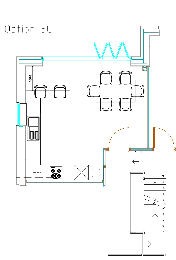

Moonshine Posted September 28, 2020 Author Share Posted September 28, 2020 (edited) thanks @AliG and @Mr Punter, nice ideas and have revised as below, though I think that the 5A with the sink and hob on the same run is too cluttered, and i think that the hob is best on the back wall with work top to the left and right of it. Though i do like the idea of the tall cupboard having a high oven in it like 5C (maybe a bit cluttered). Edited September 28, 2020 by Moonshine Link to comment Share on other sites More sharing options...
AliG Posted September 28, 2020 Share Posted September 28, 2020 5C would work well, that is not too cluttered. I was hoping to get the hob round to face the breakfast bar, but it would need to be 3-600mm longer and there just isn't room. A 1.8m table with three chairs on each side would probably be a bit more space efficient. You could push one end against the wall to give more room between the peninsular and the table. Link to comment Share on other sites More sharing options...
PeterW Posted September 28, 2020 Share Posted September 28, 2020 Right side wall is wasted ... make it a full length banquette seat with the table against it. Link to comment Share on other sites More sharing options...

Moonshine Posted September 28, 2020 Author Share Posted September 28, 2020 44 minutes ago, PeterW said: make it a full length banquette seat with the table against it. i agree the right wall is not well used, but I don't see the appeal of them, it would makes me feel like i was in a cafe or curry house, and hate the fact i couldn't adjust my seating arrangement without moving the table. Though this caught my eye in google images. 1 Link to comment Share on other sites More sharing options...
