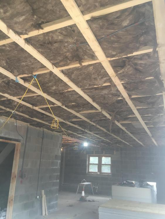

PeterW Posted February 24, 2021 Share Posted February 24, 2021 @tanneja what is your spacing on the joists..?? 18mm will bounce as it is very thin. You could add 12mm ply across the whole floor and glue to the deck and screw it to the joists to give you a very rigid 30mm floor. Link to comment Share on other sites More sharing options...

Mr Punter Posted February 24, 2021 Share Posted February 24, 2021 @tanneja do you have pictures of the floor from underneath? Interested to see the ends of the joists and the mid spans. Link to comment Share on other sites More sharing options...
TonyT Posted February 24, 2021 Share Posted February 24, 2021 Is it the brandering under the ceiling as it’s not nailed on every joist, this may be the squeak Link to comment Share on other sites More sharing options...
epsilonGreedy Posted February 24, 2021 Share Posted February 24, 2021 5 hours ago, tanneja said: Should I cut through the 18mm chipboard joins, to see if that works, or just overply? Dedicated flooring sheets have a tongue & groove joint, my concern is that cutting through this will promote more flex. In your position I would spend more time tracking down the source of the creaking, a teenager with acute hearing might help. Failing that I would consider gluing down a thicker fancy floor finish like bamboo veneer sheets, Jeremy Harris probably blogged about this step in his build. Link to comment Share on other sites More sharing options...
MJNewton Posted February 24, 2021 Share Posted February 24, 2021 Telescopic support rods like these could be useful to pinpoint the squeeky bits. Not only can they be used to brace different sections of joist/flooring to see if the noise goes, but can also be used to flex sections from below to see if you can trigger the offending parts. Link to comment Share on other sites More sharing options...
tanneja Posted February 25, 2021 Author Share Posted February 25, 2021 (edited) I have use a support just now, applying pressure from underneath and it can have some localised reduction at that spot when stepping on the floor above, but it is very localised, rest of the floor has the same creakiness. I have got up a ladder and pushed and pulled on the joists and the chipboard from underneath, even being a few centimetres away I can't discern if it is the joist to noggin interaction, the joist/noggin to chipboard interaction, the crew to timber / chipboard interaction, or the chipboard to chipboard interlocking interaction, I can't see how anyone can tell that as they are all basically next to each other. It feels like I have no option but to strongly consider getting this chipboard up. I'll take out some screws first to eliminate them as the issue, but as before, I would hope multi thread screws would avoid any movement allowing a tight fit. Maybe where i put them back into the previous holes from the first set of screws could be problematic. I don't think there is anything more than tiny deflection (if any) with the joists, my inexperienced gut says that the 18mm board is deflecting due to its lack of rigidity, and so the interlocking mechanism rubbing. If grinding out some joins removed the creak, I would have my answer, but as stated above, will lose some floor rigidity. Maybe I can claim some of that back with a 12mm ply overlay, rather than switching the whole thing out for 22 or 25mm. If we did want to really go the whole hog, what is the most rigid, best quality flooring we could go with? I don't think I would feel confident with standard 22mm chipboard given this headache. It isn't a big area, so cost should be manageable, will be labour more than materials I would think. Presumably cement board is too heavy. Unsure if the foam backed board I have seen advertised is helpful if you plan to glue to the joists. Edited February 25, 2021 by tanneja Link to comment Share on other sites More sharing options...

markc Posted March 1, 2021 Share Posted March 1, 2021 where is the small area that squeaks? mid span? near a wall? service void? etc. i reckon it could well be a joist hanger/connection noise depending on location Link to comment Share on other sites More sharing options...
tanneja Posted March 1, 2021 Author Share Posted March 1, 2021 @markc the squeaks are mainly centre of room, but so also happen a little further away too, for one room it happens immediately as you enter the room. The noise is coming from the area very close to the footstep (when listened to from underneath), not from the hangar location. Of course that doesn't mean they the aren't perhaps responsible for the noise in some way, maybe we can inspect everything critically when the chipboard comes up. 1 Link to comment Share on other sites More sharing options...
PeterW Posted March 1, 2021 Share Posted March 1, 2021 29 minutes ago, tanneja said: The noise is coming from the area very close to the footstep (when listened to from underneath), not from the hangar location. OK that could be the floor and the sole plate of the wall immediately around the area. Do the walls run perpendicular or parallel to the joists and were they built off the deck or the joists ..?? Link to comment Share on other sites More sharing options...
tanneja Posted March 1, 2021 Author Share Posted March 1, 2021 @PeterW it is a small room, so one stud runs parallel on a triple joist, the perpendicular wall sits on the joists too, not on the chipboard. The other two walls are external masonary. I feel like I would be surprised if it were the studs given where I identify the sound coming from. The chipboard is well clear of the perimeter of the door opening and walls (10mm), Link to comment Share on other sites More sharing options...
