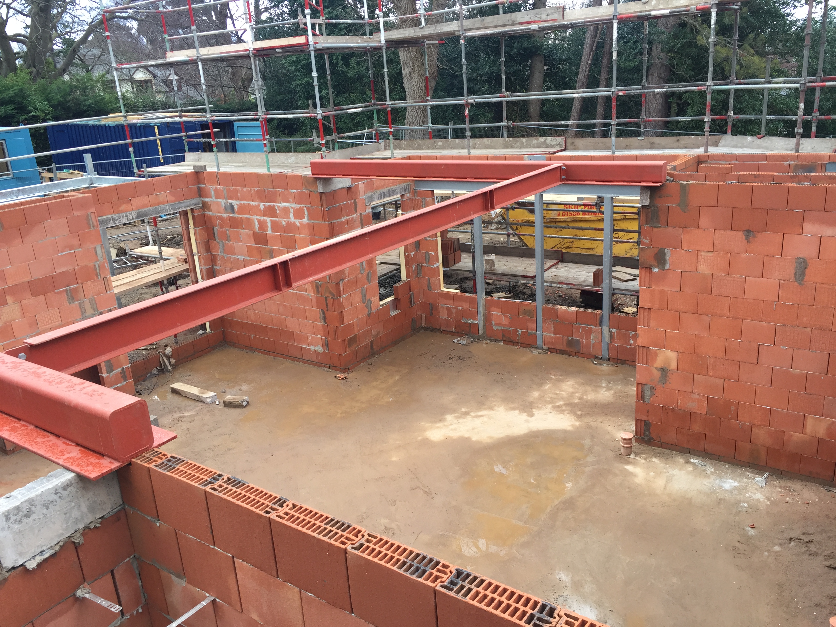

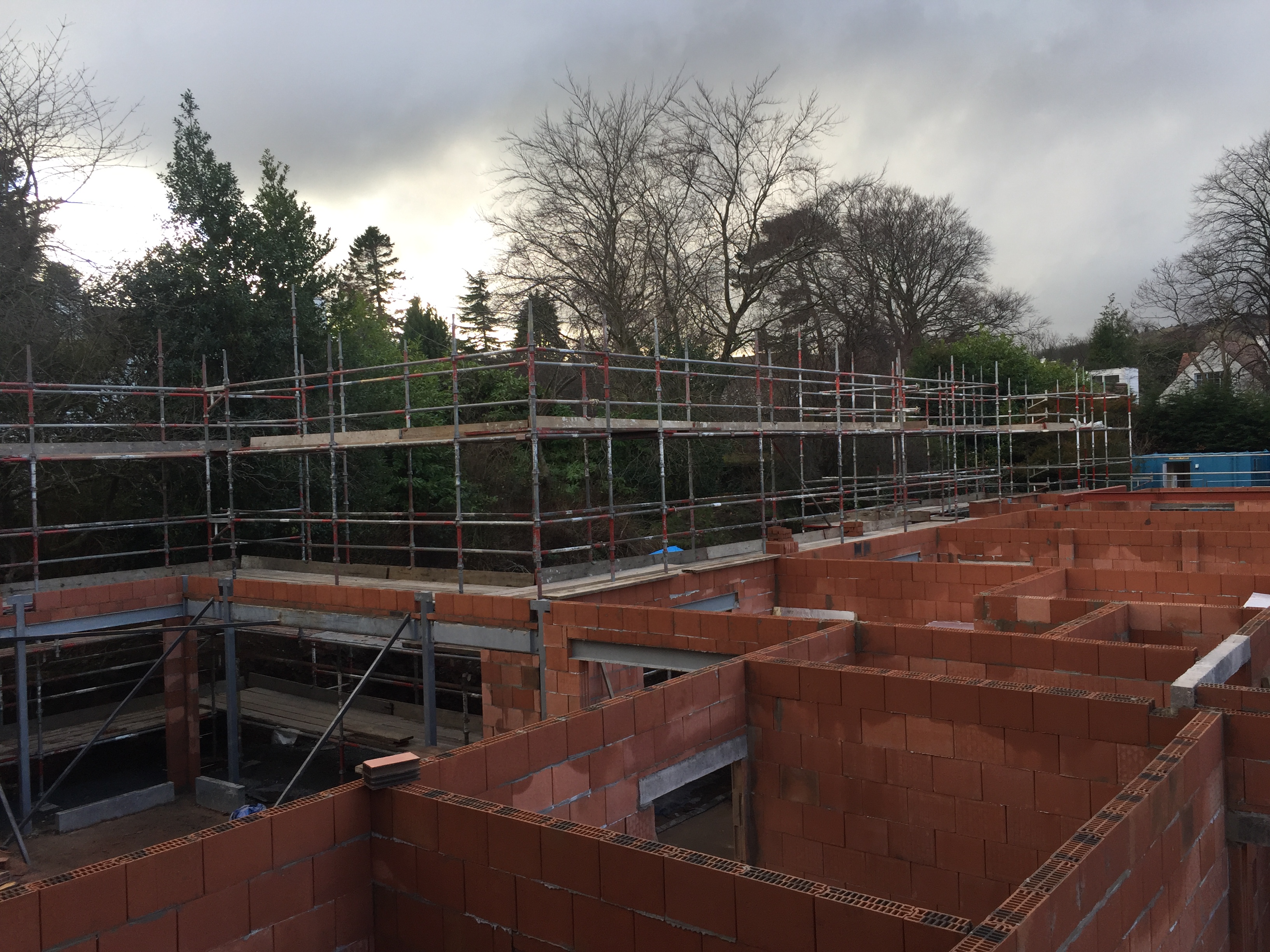

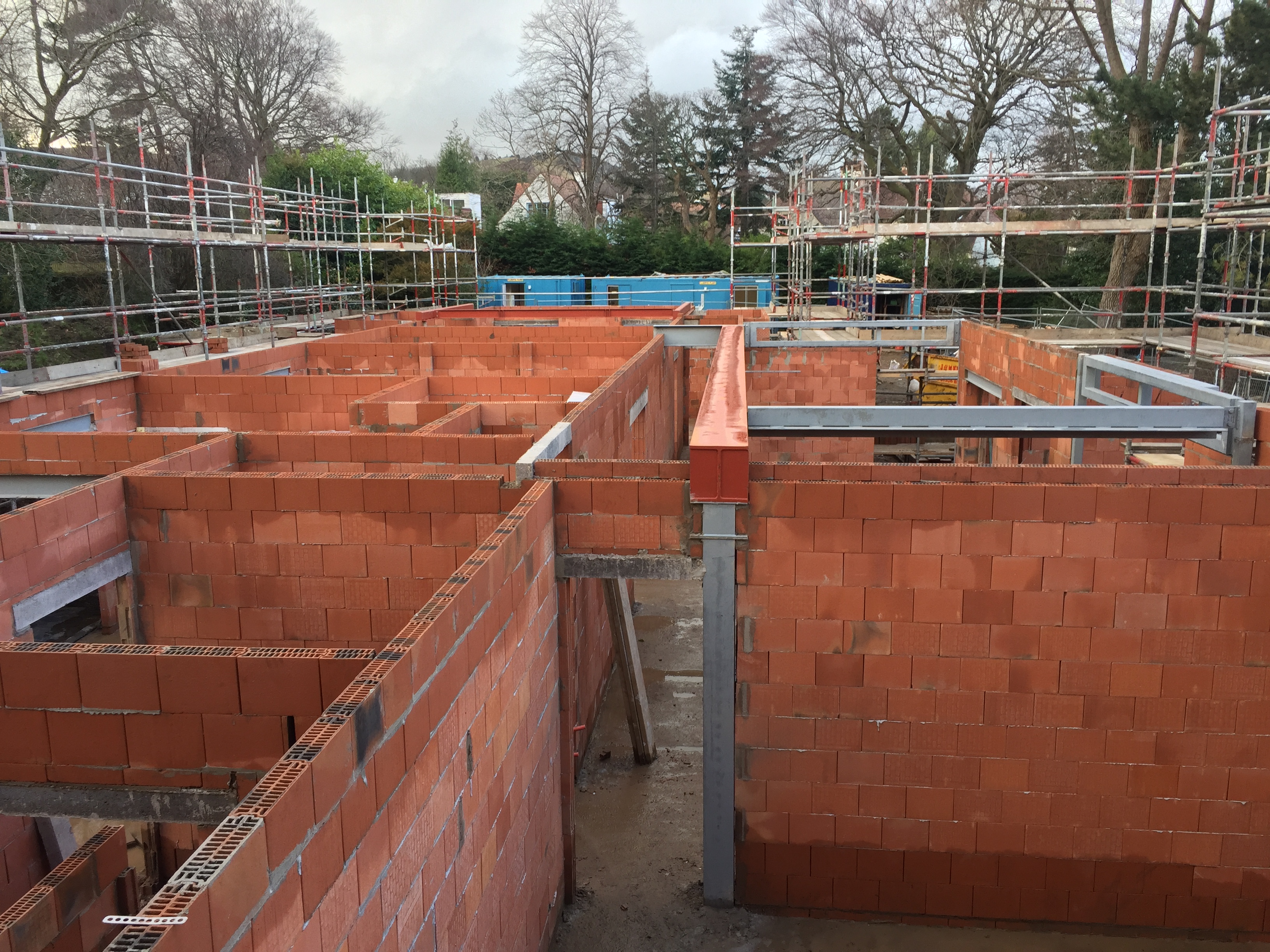

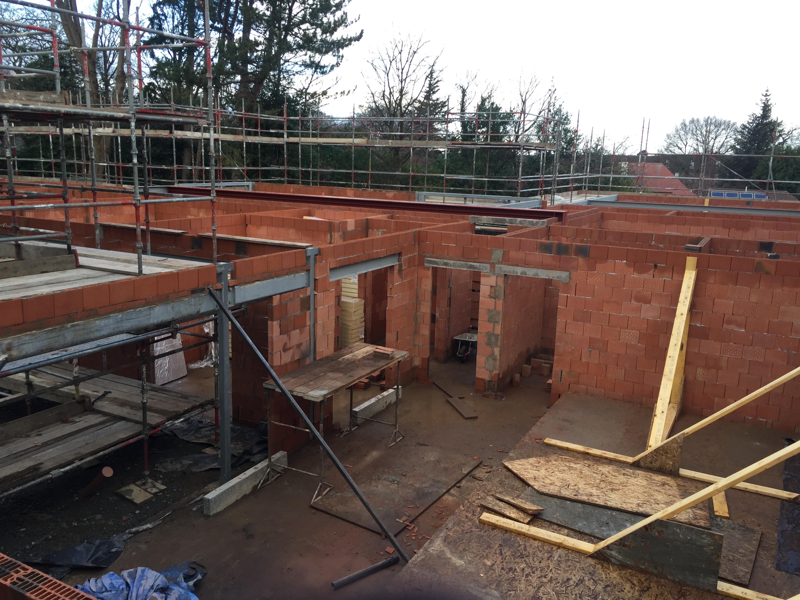

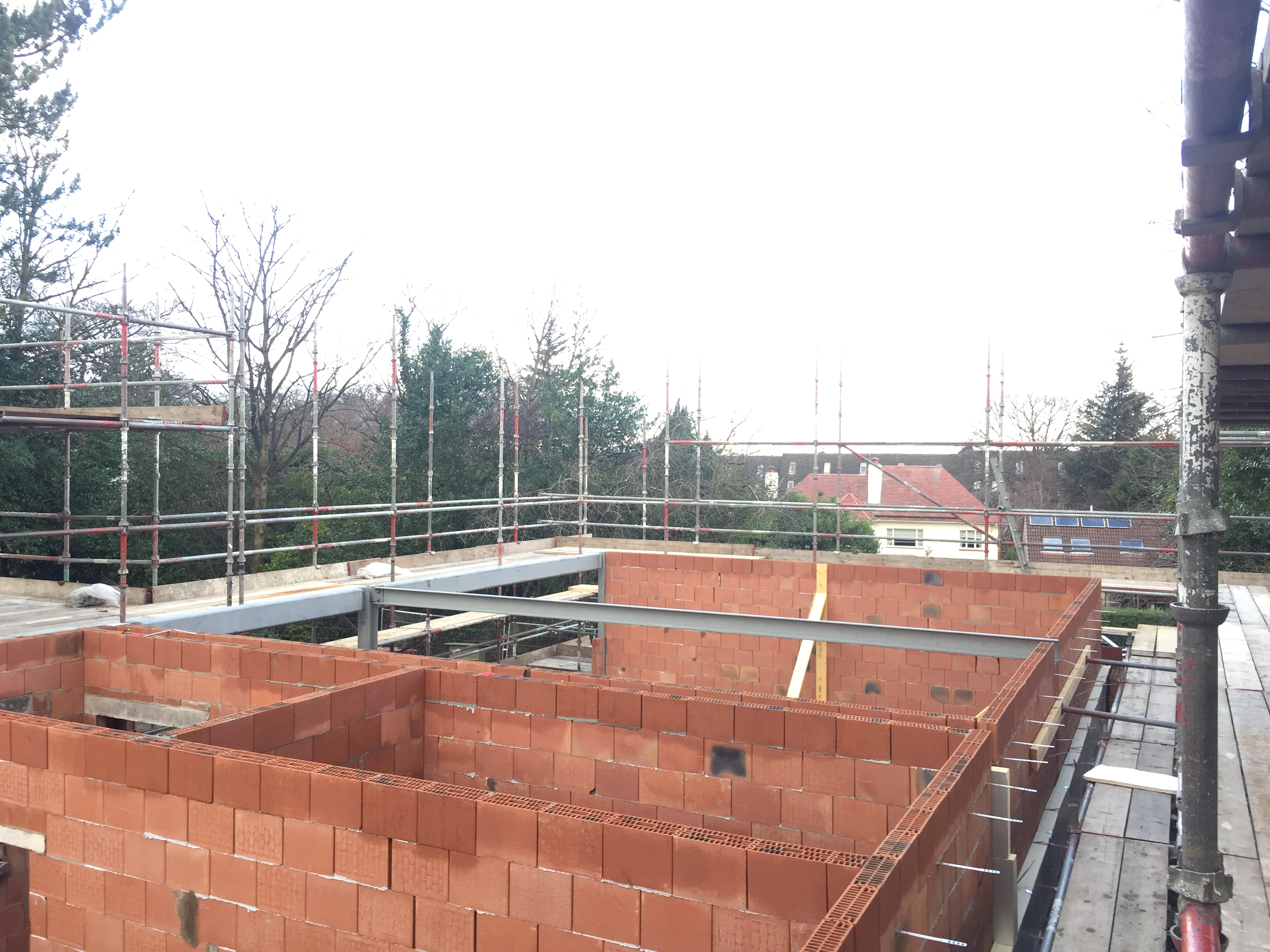

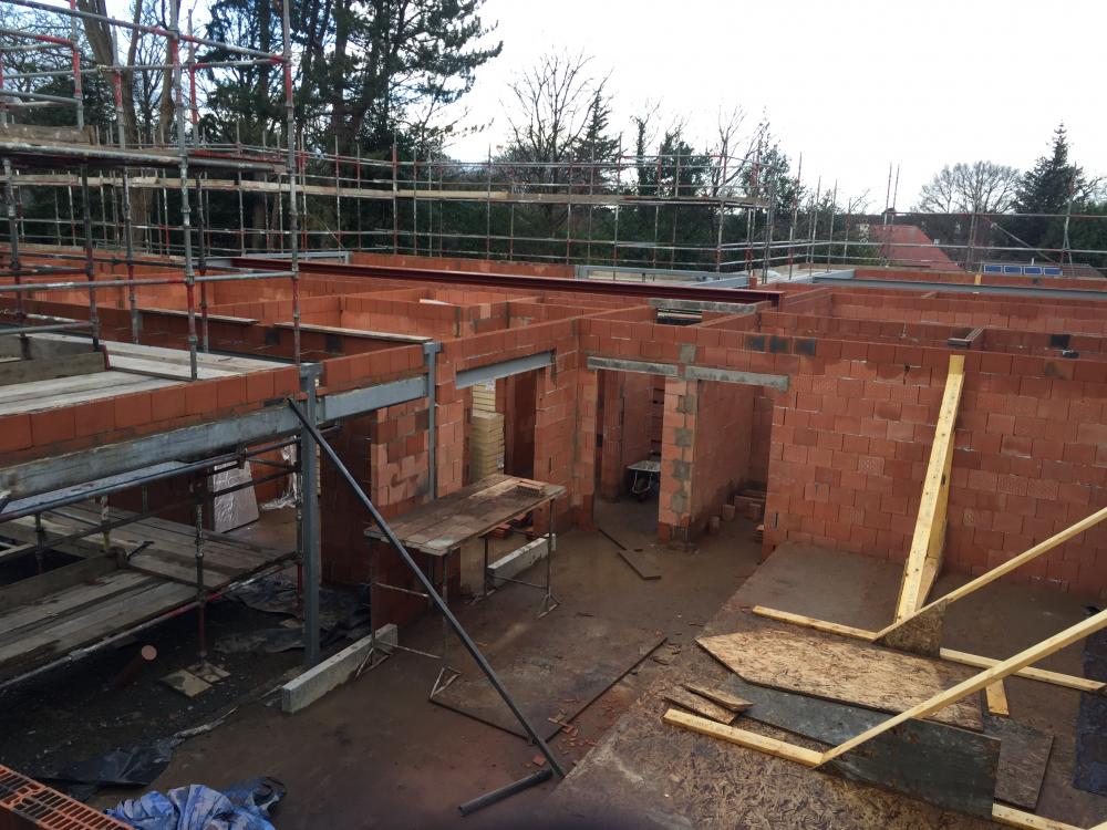

I was finally up on the scaffolding to see how things look from first floor level. I was still probably 450mm below the finished floor level but it gives and idea.
The concrete people have insisted that the walls are braced before they put the first floor slab on on Monday.
There's a lot more steel than I expected when we started.
Edited by AliG
That's fairly coming on. Is the bracing in case of an errant beam coming at 90degrees and taking a section if wall out? I can't see it doing much else than a safeguard?

I am not sure what your first floor make up will be, but you your electrician may curse the fact there are no holes in any of those steel to feed cables through.
Can you not drill a hole through the steel for your cables?
What with,?

I think as you say @jamiehamy the bracing is in case they apply sideways pressure and bring down a wall.
@ProDave the floor is 200mm thick concrete slabs plus insulation and screed on top. So I'm sure the electrician will have no problem drilling through it o.O. The ceiling is dropped down 100m below this for cabling and there is a corridor where the floor is only 100mm thick so that there will be a main route for pipework, mvhr pipework etc.
I believe that the architect has allowed for pre cut holes where the cabling will go upstairs.
Last night the email came through from the architect with the latest costs. There is indeed more steel than expected to the point of it being 4x the expected cost >:(
The braces are essential to prevent buckling failure of the yet-to-be-tied inner wall skin, under the compressive load of the first floor, applied to the top of the inner wall skin.  Once the two wall skins are tied together they become a great deal more resistant to buckling failure under a compressive load, because the slenderness ratio has decreased.
If you want to try and get your head around this you can either read up on buckling, crippling and slenderness ratios under compressive loads (tip: search for work by Euler, the 18th c mathematician), or you can do a simple experiment.
Take an ordinary straight drinking straw (not the fancy ones with bends in) and stand it vertically on a hard surface.  Push down on the top end with your finger and you'll find that it will buckle and bend in half under a quite modest load.
Take another straw, and this time just very, very gently hold the mid-point between the thumb and forefinger of one hand (simulating the bracing) and push down on the top end with the other hand.  What you'll find is that the maximum compressive load that the braced straw will take is a lot greater than that of the unbraced straw.
