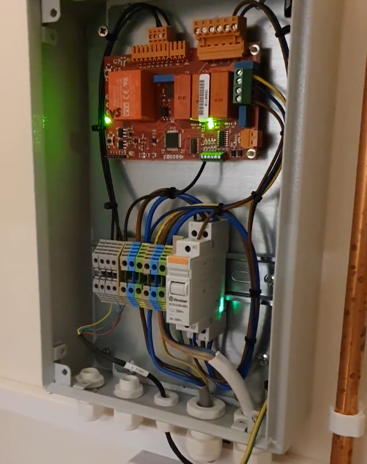

readiescards Posted July 26, 2020 Posted July 26, 2020 Got a call from our holiday cottage - guests no hot water. Thanks to @Nickfromwales support was quickly able to identify control main relay failure exactly as @Jeremy Harris I believe - with the neutral line remaining open. Horrified to see it spark through the relay body and very annoyed no proactive input from Sunamp telling me to replace the relay so now got an expensive electrician call out for a short term replacement relay to get hot water flowing again - argh!

readiescards Posted July 28, 2020 Author Posted July 28, 2020 With spade connectors, Sunamp warn me this one also has visible sparks from the internal contactors
PeterW Posted July 28, 2020 Posted July 28, 2020 That should be a socket relay not spade connectors. What current is it carrying..? Ideally it should be a contactor. Sorry, edited to add, are you sure that the relay number is correct on that Finder relay in the box..? @Nickfromwales aren't these 3kw heater elements..? The Finder spec for that number is 12A
Reiver Posted July 28, 2020 Posted July 28, 2020 11 minutes ago, readiescards said: With spade connectors, Sunamp warn me this one also has visible sparks from the internal contactors This is such a common issue on all sorts of equipment and seems to significantly reduce relay life. All for want of adding one or two supressors across the terminals to stop the sparking/arcing. 1
ProDave Posted July 28, 2020 Posted July 28, 2020 What you have is a screw terminal DIN rail relay. Why have the sent you a spade terminal screw mount relay as a replacement when they say the Finder one is "okay"? I would personally replace with another DIN rail mount of another better make and higher current rating but then you have the thorny issue of warranty even though you would have fitted a better part. I used to build industrial machinery and we quickly found Finder were not the best. Of course you can fit the one they have sent just by crimping spade connectors onto the wires you have. then you have got to mount it somewhere. 1
Nickfromwales Posted July 28, 2020 Posted July 28, 2020 2 hours ago, ProDave said: Of course you can fit the one they have sent just by crimping spade connectors onto the wires you have. then you have got to mount it somewhere. That is now the OEM solution for any SA unit sent out in the last x number of months. 2 hours ago, Reiver said: This is such a common issue on all sorts of equipment and seems to significantly reduce relay life. All for want of adding one or two supressors across the terminals to stop the sparking/arcing. They could just fit a bloody SSR and all this goes away in a 'flash'....... 3 hours ago, PeterW said: @Nickfromwales aren't these 3kw heater elements..? The Finder spec for that number is 12A Yup, give or take. Seeing 15a is a worry, as it'll do the job but is still very close to the known duty. I know there's not massive shunt resistance with an immersion, but it should still have a lot more headroom IMO, even if just to promote longevity! 1
PeterW Posted July 28, 2020 Posted July 28, 2020 12 minutes ago, Nickfromwales said: They could just fit a bloody SSR and all this goes away in a 'flash'....... @readiescards I would be looking at a permanent upgrade to a din rail SSR and get rid of the relay - cost would be £30 tops and makes it safe and also silent. 1
scottishjohn Posted July 28, 2020 Posted July 28, 2020 seems sunamp are still using "tombstone technology " like aero industry did at start of jet era ---when enough wings fall off -time to upgrade them not doing themselves any favours long term for sales especially when cost of these peripherals is so little in overall cost of the system 1
Nickfromwales Posted July 28, 2020 Posted July 28, 2020 1 hour ago, PeterW said: @readiescards I would be looking at a permanent upgrade to a din rail SSR and get rid of the relay - cost would be £30 tops and makes it safe and also silent. If DIN rail SSR option is available, what about heatsink? Issue or not?
