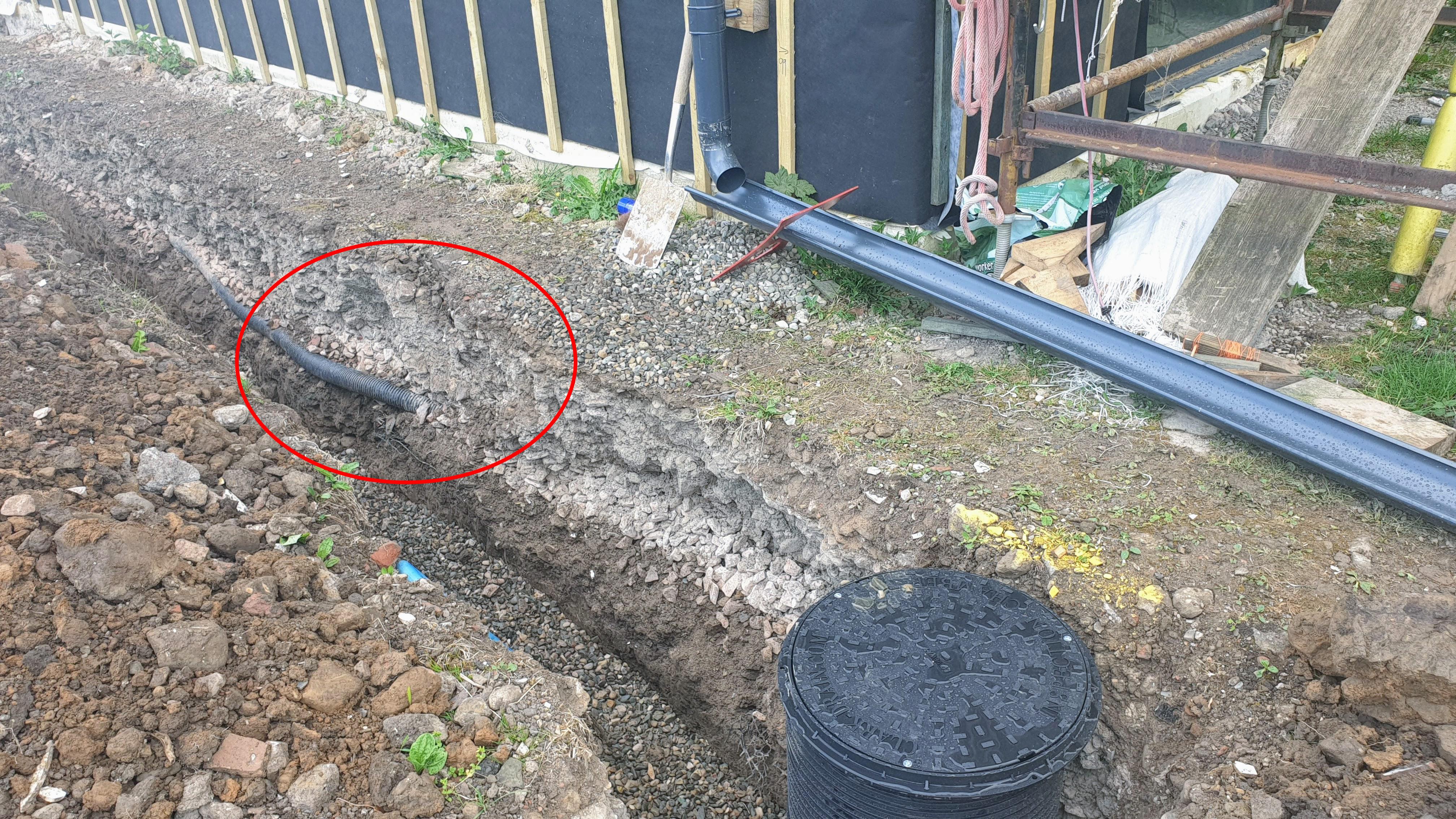

ToughButterCup Posted May 14, 2020 Author Posted May 14, 2020 12 hours ago, Simplysimon said: if you have a high water table then water will be seeping in and running down to the sewer continually. Currently the water table has disappeared. But your point is well made. By sheer chance the I/C I'm talking about is right next to the land drain ( see red elipse above) designed to protect the slab from frost heave. All but one of the I/Cs will be next to that land drain. Except one. I'll need to fettle that more carefully. Thanks very much. Ian

ToughButterCup Posted May 14, 2020 Author Posted May 14, 2020 1 hour ago, Oz07 said: Who needs a land drain when you have unsealed ic inspection chambers!? Tongue in cheek and 2 hours ago, Russell griffiths said: Is it worth all the agro @AnonymousBosch a 450mm riser with sealing ring is £8.60 is it worth the ag of trying to make something. and Quote Morning [...]. Could you tell me if the joints between the risers on our I/Cs need to be sealed? I ask, because all the I/Cs (bar one) are positioned right next to the land drain which surrounds the slab (the anti-frost heave drain) - marked with a red elipse in the attached photograph. Kind regards, Ian. Reply by text is fine if its easier for you. Message to BCO this morning. her reply by text Quote Hi Ian it is good practice but not a typical standard we see. Thanks. [...] Well, that bottoms that out. Silicone it is then. Thanks everyone for your contributions. Ian
