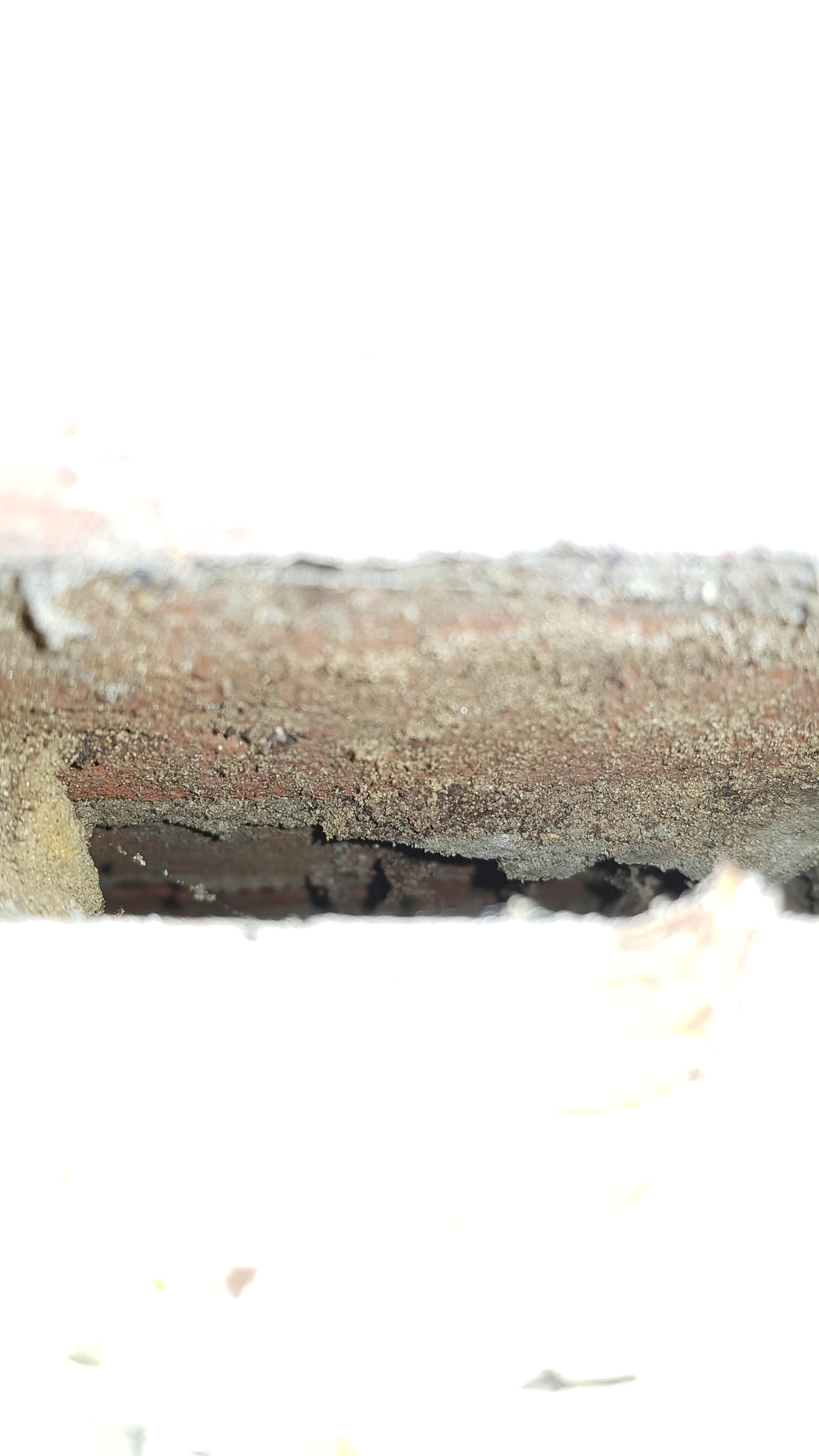

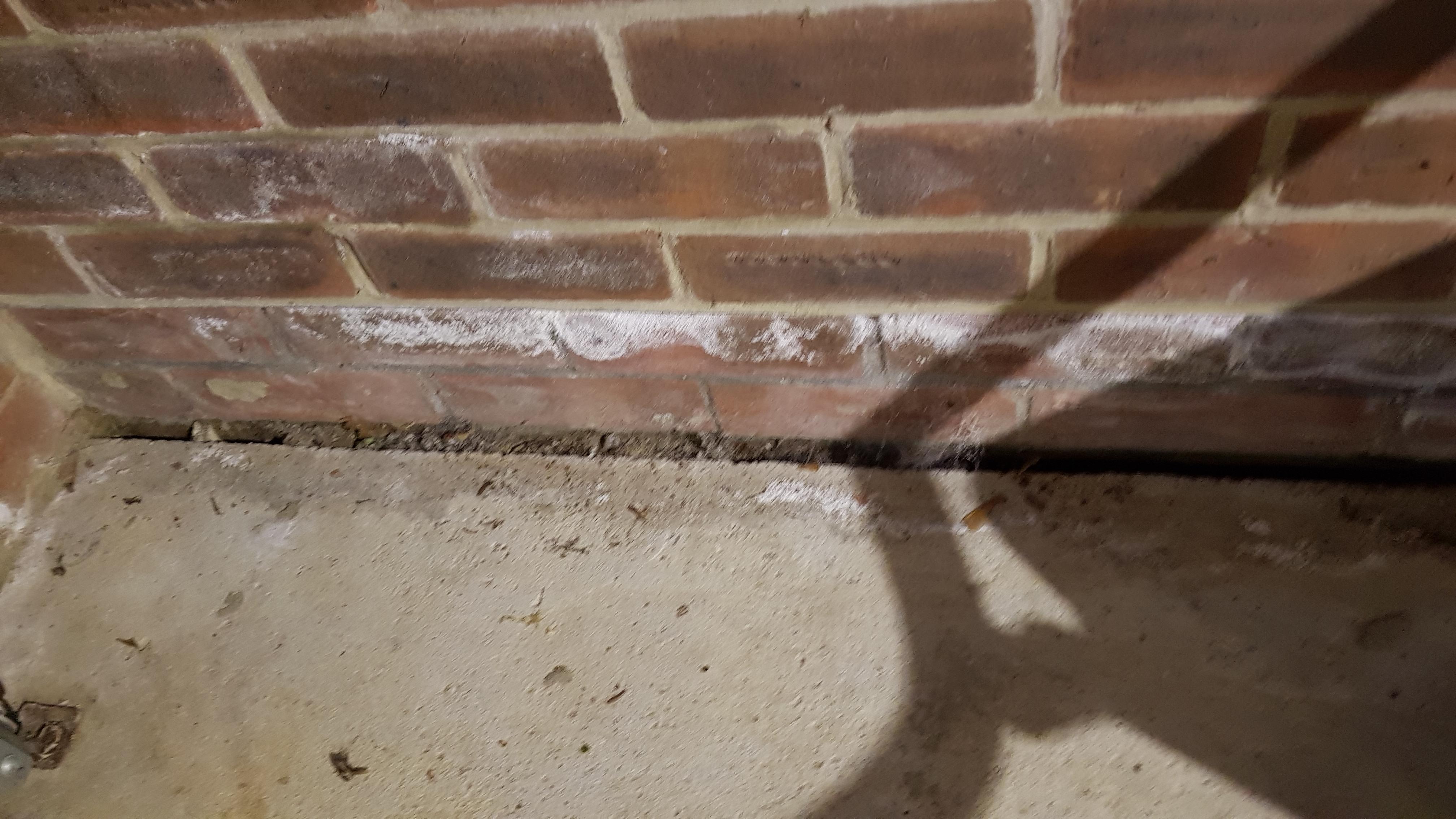

success1980 Posted May 8, 2020 Author Share Posted May 8, 2020 Thanks for the tips everyone. Upstands would look nice and give it a tidy finish. And they would cover the 2cm gap between the walls and the slab ... anyone know why they build it like this? I would have thought the walls get put ON the slab. There is actually soil in the gap. Link to comment Share on other sites More sharing options...

Jeremy Harris Posted May 8, 2020 Share Posted May 8, 2020 8 hours ago, success1980 said: Thanks for the tips everyone. Upstands would look nice and give it a tidy finish. And they would cover the 2cm gap between the walls and the slab ... anyone know why they build it like this? I would have thought the walls get put ON the slab. There is actually soil in the gap. Any chance of a photo of the gap around the walls? Presumably the slab doesn't extend as far as the garage walls all around, but has a gap around the periphery, is that right? This seems odd, as normally a floor slab will either be structural, with the walls on top, or will be poured after the walls are built on top of trench foundations, using the walls to contain the concrete. From your description is sounds almost as if the floor slab was poured into shuttering before the garage was built, then the shuttering was removed and trench foundations dug around the slab (awkward and not something I've heard of). I wonder if that small bit around the edge might just be a shallow recess from where boards or battens were put in at the time the floor was poured, to set the level of the floor. Might be worth picking away at the dirt in it to see how deep it is. I'd be inclined to fill the gap up with a bit of strong mortar if it were, me, before laying any tiles. Link to comment Share on other sites More sharing options...
success1980 Posted May 8, 2020 Author Share Posted May 8, 2020 3 hours ago, Jeremy Harris said: Any chance of a photo of the gap around the walls? Presumably the slab doesn't extend as far as the garage walls all around, but has a gap around the periphery, is that right? This seems odd, as normally a floor slab will either be structural, with the walls on top, or will be poured after the walls are built on top of trench foundations, using the walls to contain the concrete. From your description is sounds almost as if the floor slab was poured into shuttering before the garage was built, then the shuttering was removed and trench foundations dug around the slab (awkward and not something I've heard of). I wonder if that small bit around the edge might just be a shallow recess from where boards or battens were put in at the time the floor was poured, to set the level of the floor. Might be worth picking away at the dirt in it to see how deep it is. I'd be inclined to fill the gap up with a bit of strong mortar if it were, me, before laying any tiles. Thanks for this detailed post. I will take a picture tomorrow and also have a look what it is exactly. Sounds logic to fill before tiles go in. Would probably have a small foam band between tiles and wall and sit upstands on it, filling with silicone. Link to comment Share on other sites More sharing options...
success1980 Posted May 9, 2020 Author Share Posted May 9, 2020 Here are the pics. The gap is about 2.5cm wide and I can scrape soil out with a screwdriver. There doesn't seem to be any concrete underneath. It looks like I will have to try and get original plans to see how it was built ... I didn't build this house myself, just doing it up a bit. Link to comment Share on other sites More sharing options...
Ferdinand Posted May 9, 2020 Share Posted May 9, 2020 The only time I left a gap like that was to decouple a conservatory slab from a no-foundations Victorian cottage. So I am no wiser. It would be a little difficult to build like that, maybe. Or can concrete shrink? Link to comment Share on other sites More sharing options...
Jeremy Harris Posted May 9, 2020 Share Posted May 9, 2020 That definitely looks a bit odd! Looks as if there had possible been a board there at some time. that's since been removed (goodness only knows how). Best bet is probably to scrape out a couple of inches or so and fill it with a mortar mix I think. Link to comment Share on other sites More sharing options...
ProDave Posted May 9, 2020 Share Posted May 9, 2020 I have seen that before. Garage built on strip foundations and wall built straight up. Slab poured afterwards (usually when bricks only a few courses high so you can work around it from the outside) Often a strip of wood fibre board is inserted as both a level marker and a bit of an expansion gap. That has probably rotted away. Link to comment Share on other sites More sharing options...
success1980 Posted May 9, 2020 Author Share Posted May 9, 2020 1 hour ago, ProDave said: I have seen that before. Garage built on strip foundations and wall built straight up. Slab poured afterwards (usually when bricks only a few courses high so you can work around it from the outside) Often a strip of wood fibre board is inserted as both a level marker and a bit of an expansion gap. That has probably rotted away. That sounds logic. The house was built by a quantity house builder so I would not be surprised to find thats true. To be honest, I hope it is ... as long as the walls are on strip foundations I'm happy. I will just scrape the gap and fill with something. Link to comment Share on other sites More sharing options...
