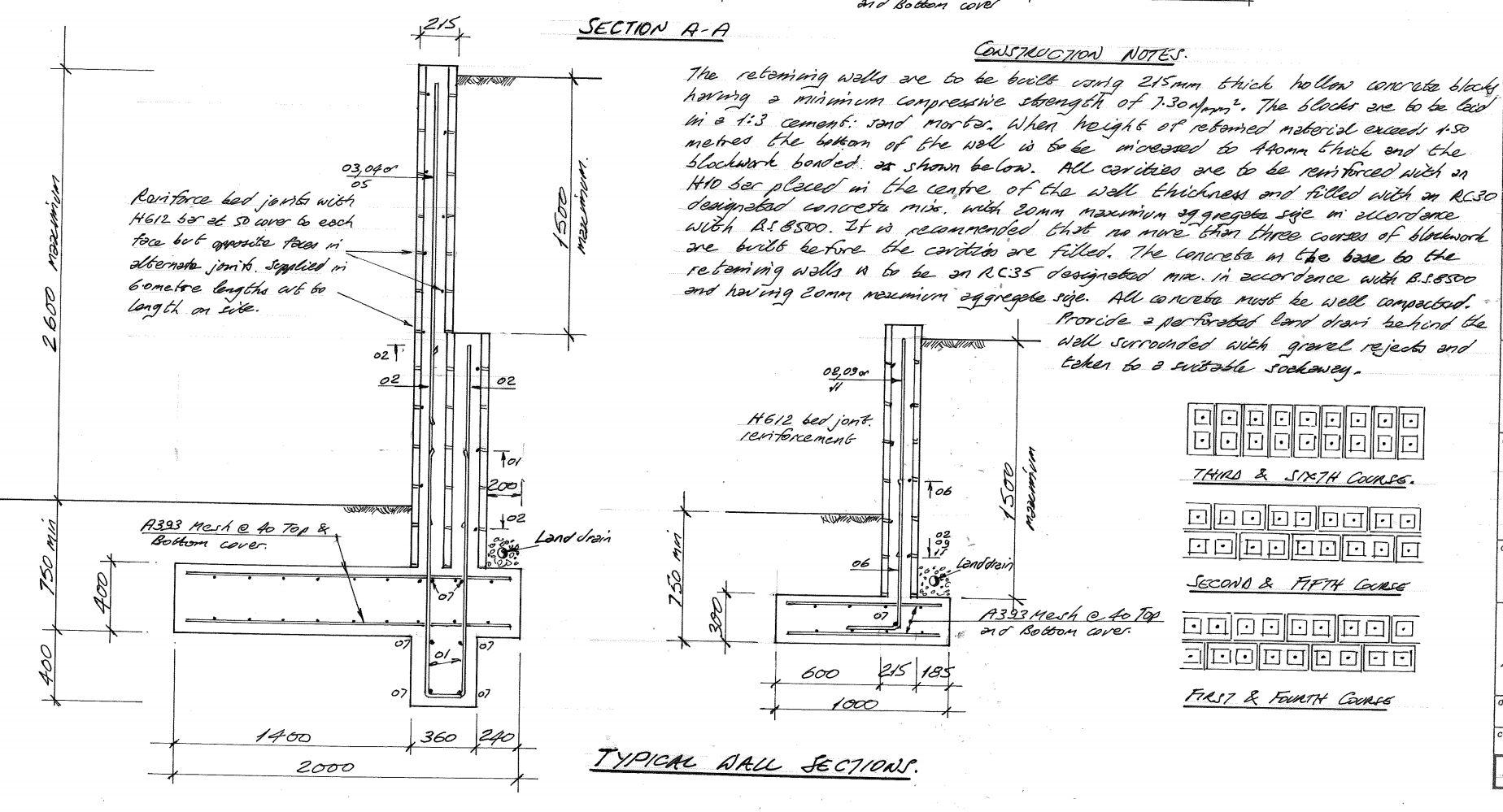

Jeremy Harris Posted April 27, 2020 Share Posted April 27, 2020 5 hours ago, Margaret dailey said: Ok thankyou all Will need to really reconsider this. I posted this earlier as a pdf file, but it might make things clearer to see just a typical vertical concrete block retaining wall cross section. This wall is similar in size to the one you are planning, but doesn't have the added surcharge load from a house on the ground that it's retaining, all it's retaining is the garden of the house behind ours. Even so, it needed pretty substantial foundations, as in the photos posted earlier, together with steel reinforcement to enable it to withstand the overturning force from the soil pushing sideways behind the wall. Link to comment Share on other sites More sharing options...

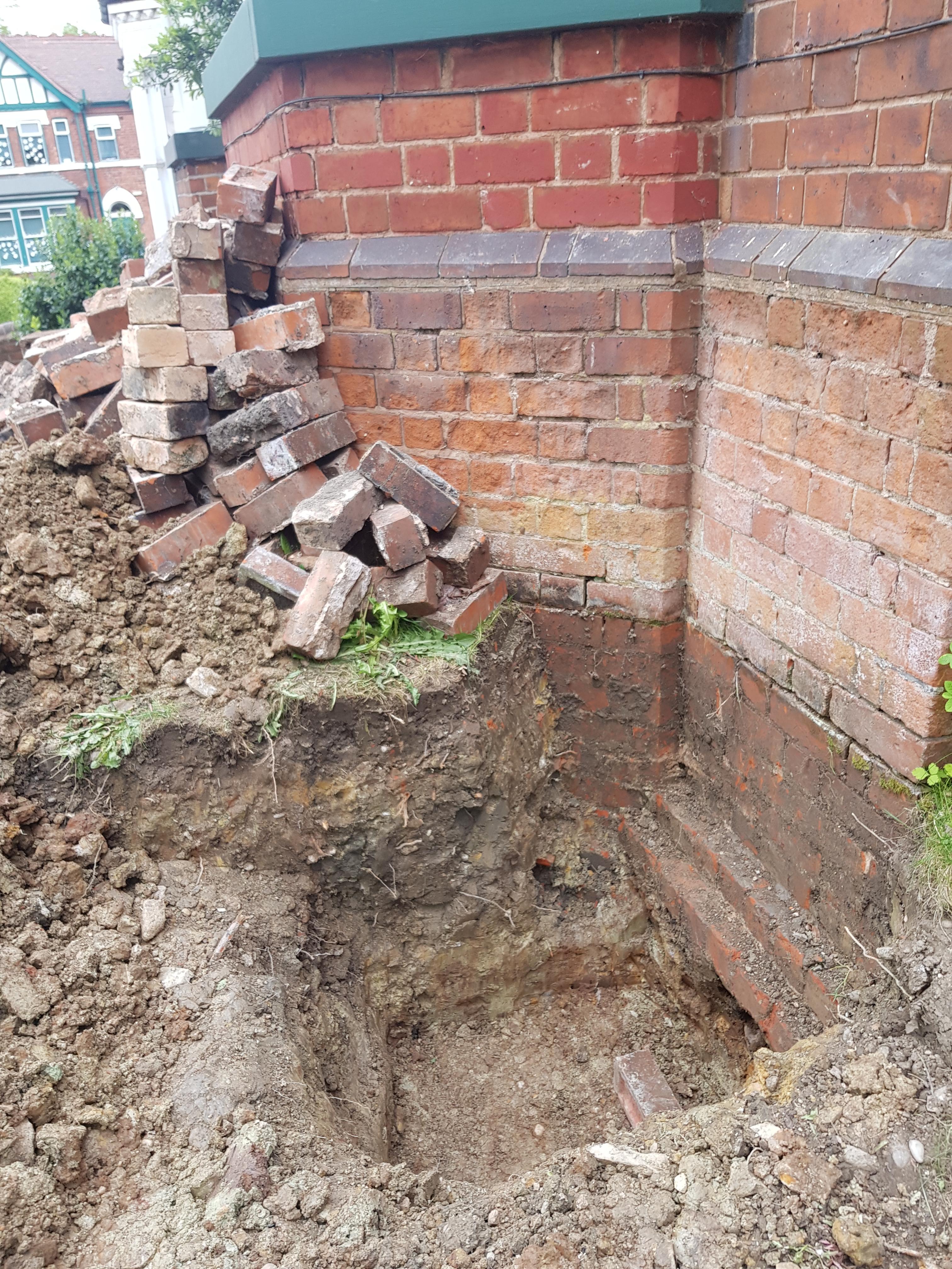

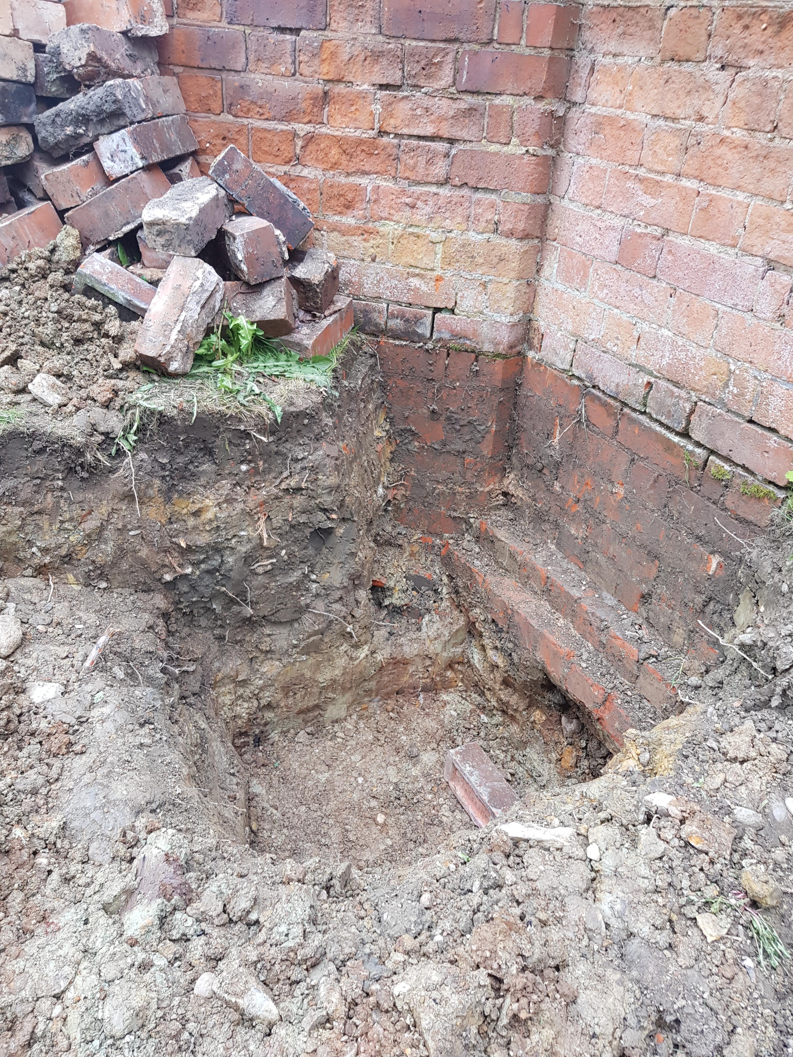

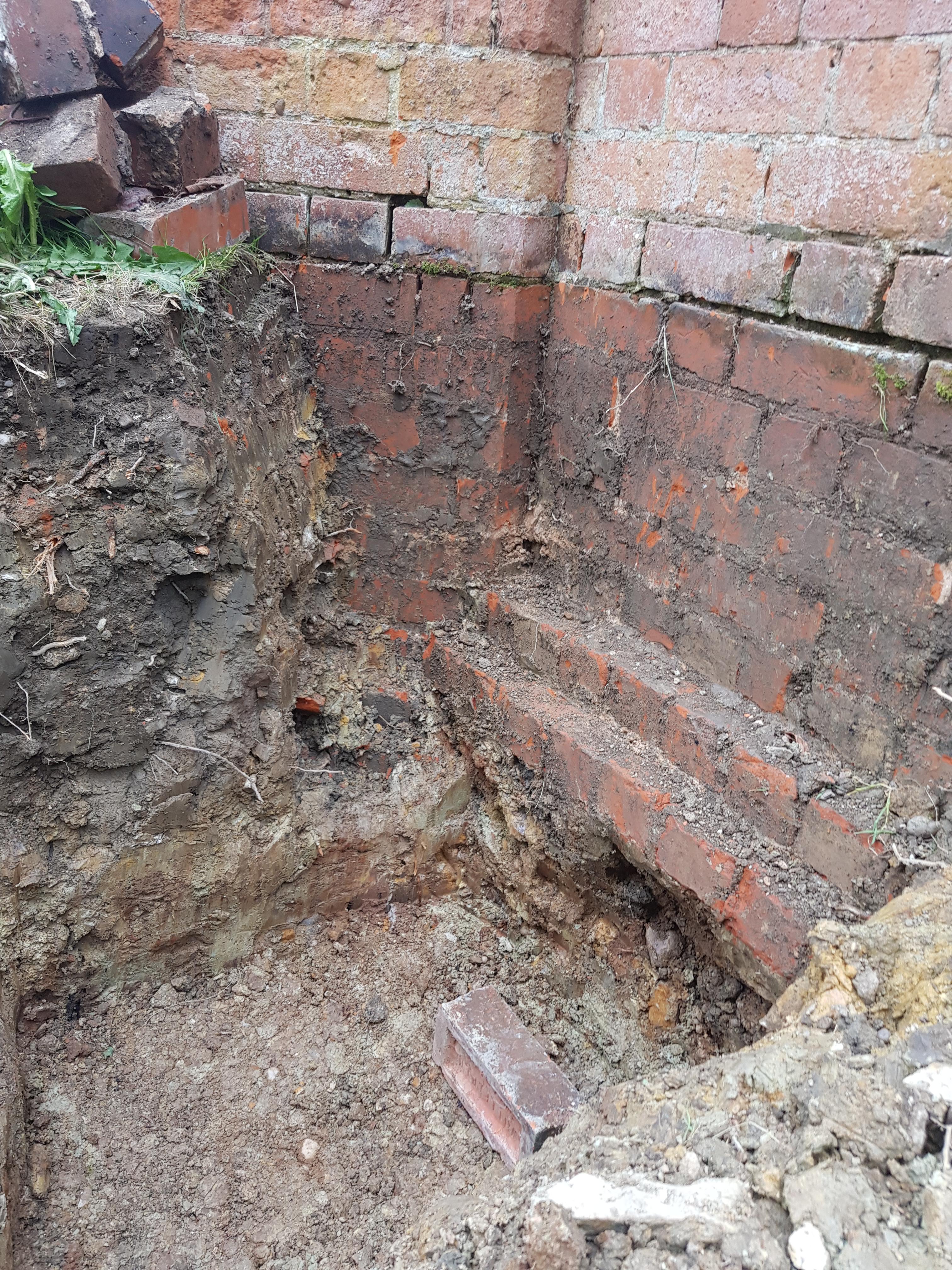

Margaret dailey Posted April 27, 2020 Author Share Posted April 27, 2020 The builders duck down today to check what type of Foundation is underneath the house and as you can see it goes down and comes out about 2 bricks so they have decided to dig down 1m at the wall and 5ft out and then 2m down, fill with concrete then insert 6-ft 9inchx9inch RSJ and then fill ontop with concrete again. They will do this each corner of the house at the front and at two points in the Middle by the window Link to comment Share on other sites More sharing options...
Declan52 Posted April 27, 2020 Share Posted April 27, 2020 Is there any concrete or just the wide founds of brick??? Link to comment Share on other sites More sharing options...
Onoff Posted April 27, 2020 Share Posted April 27, 2020 7 minutes ago, Declan52 said: Is there any concrete or just the wide founds of brick??? My 1863 terrace was built very similarly on just a widening of bricks as "footings". Link to comment Share on other sites More sharing options...
Mr Punter Posted April 27, 2020 Share Posted April 27, 2020 So maybe 600mm max to the base of the foundation from existing ground level. They will not be able to dig down 1m adjacent to the wall without risking it collapsing. Can you not just park your car parallel with the house and just dig out part of the garden? Link to comment Share on other sites More sharing options...
