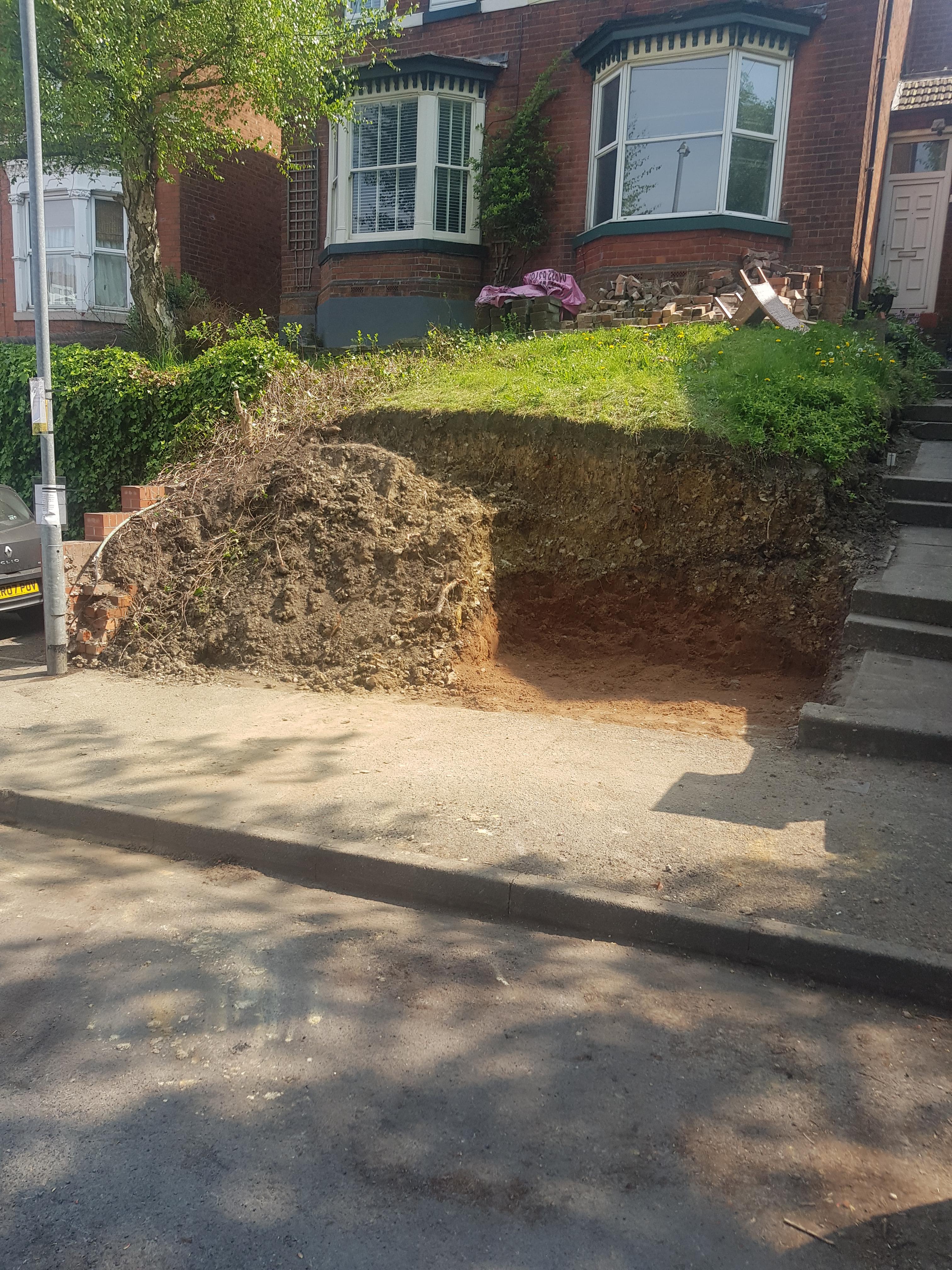

My name in margaret and im 62 and live in walsall uk. I was directed to this site by a friend who is a member, in the hope i can get some advice.

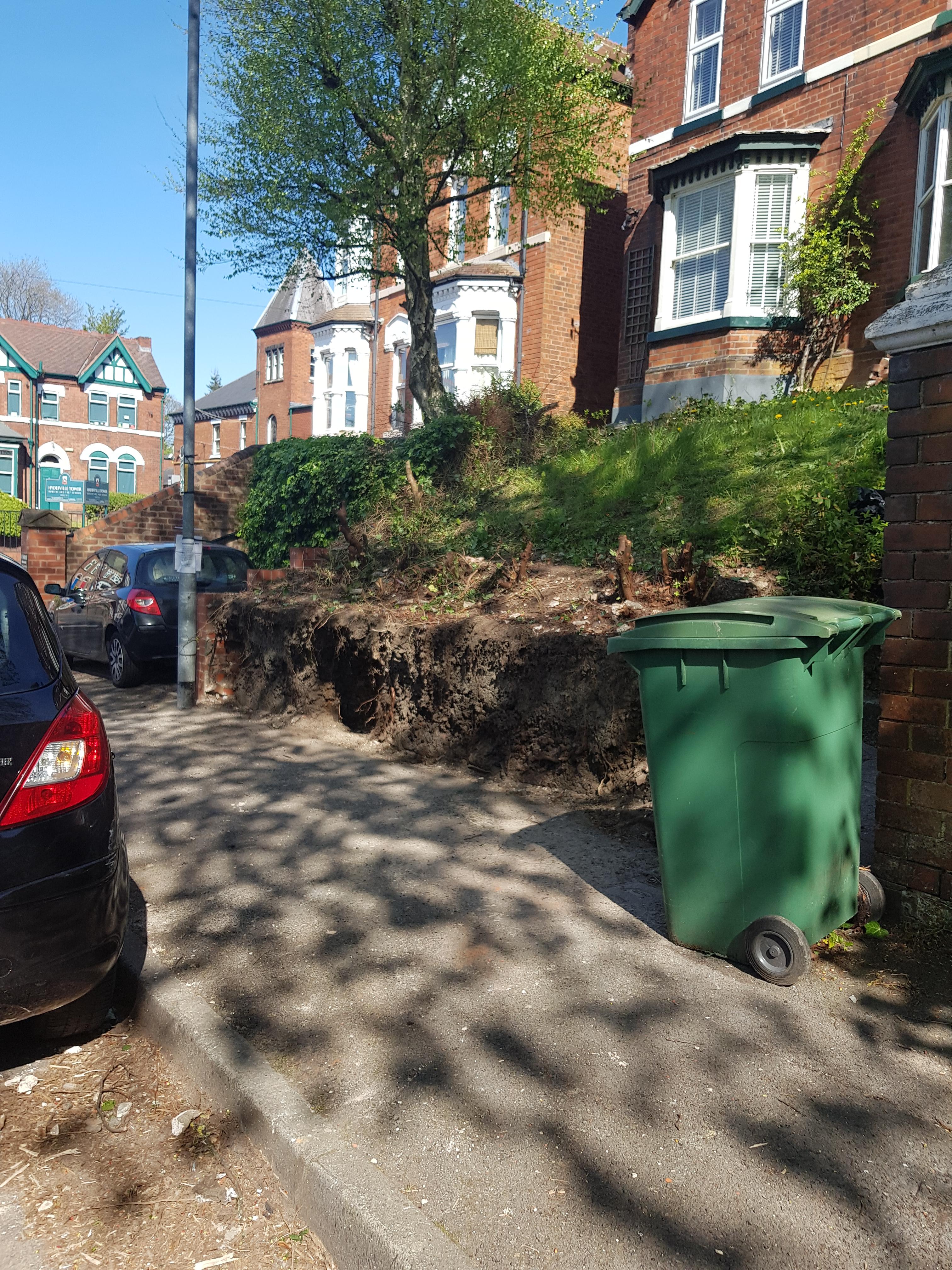

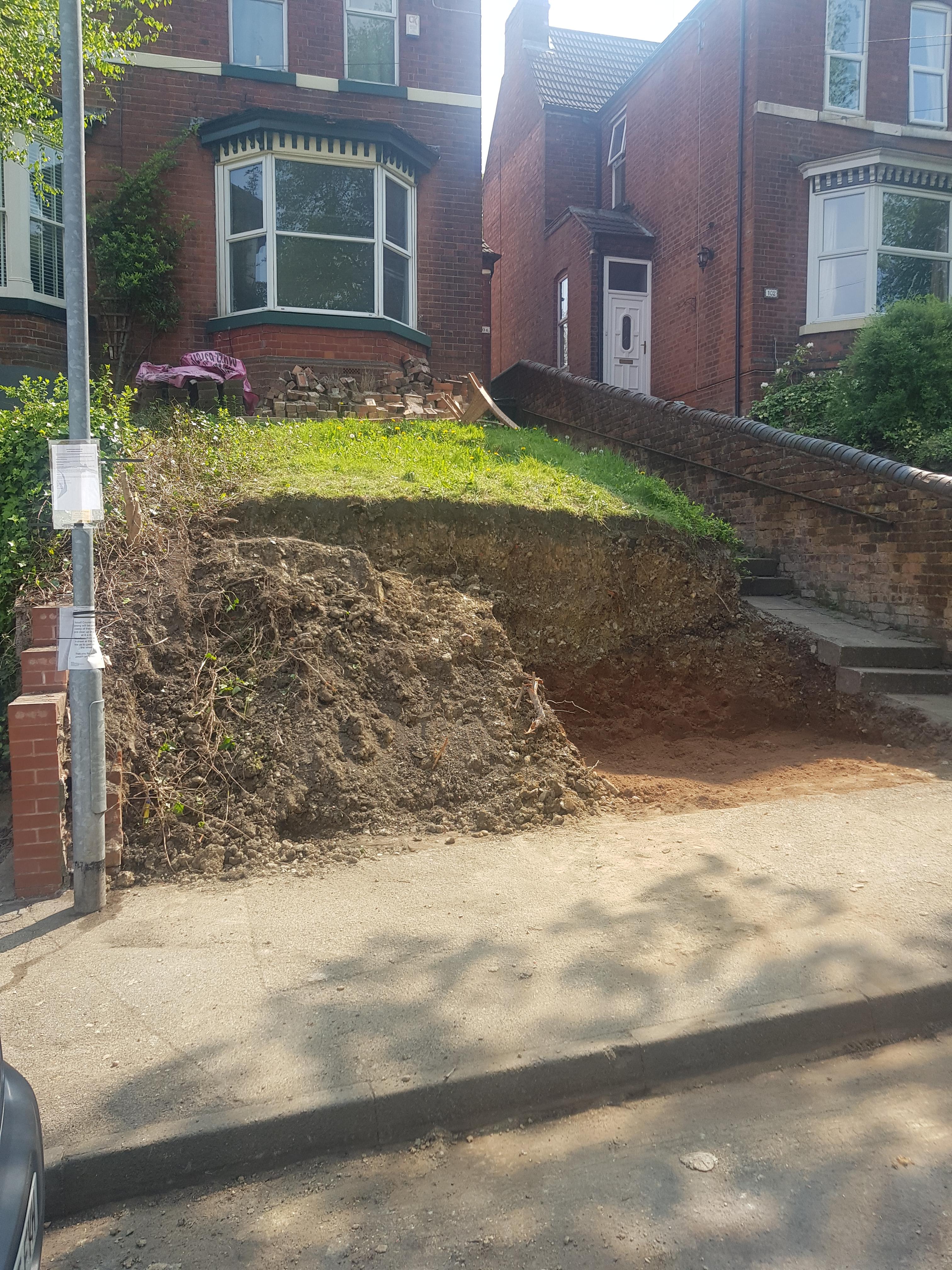

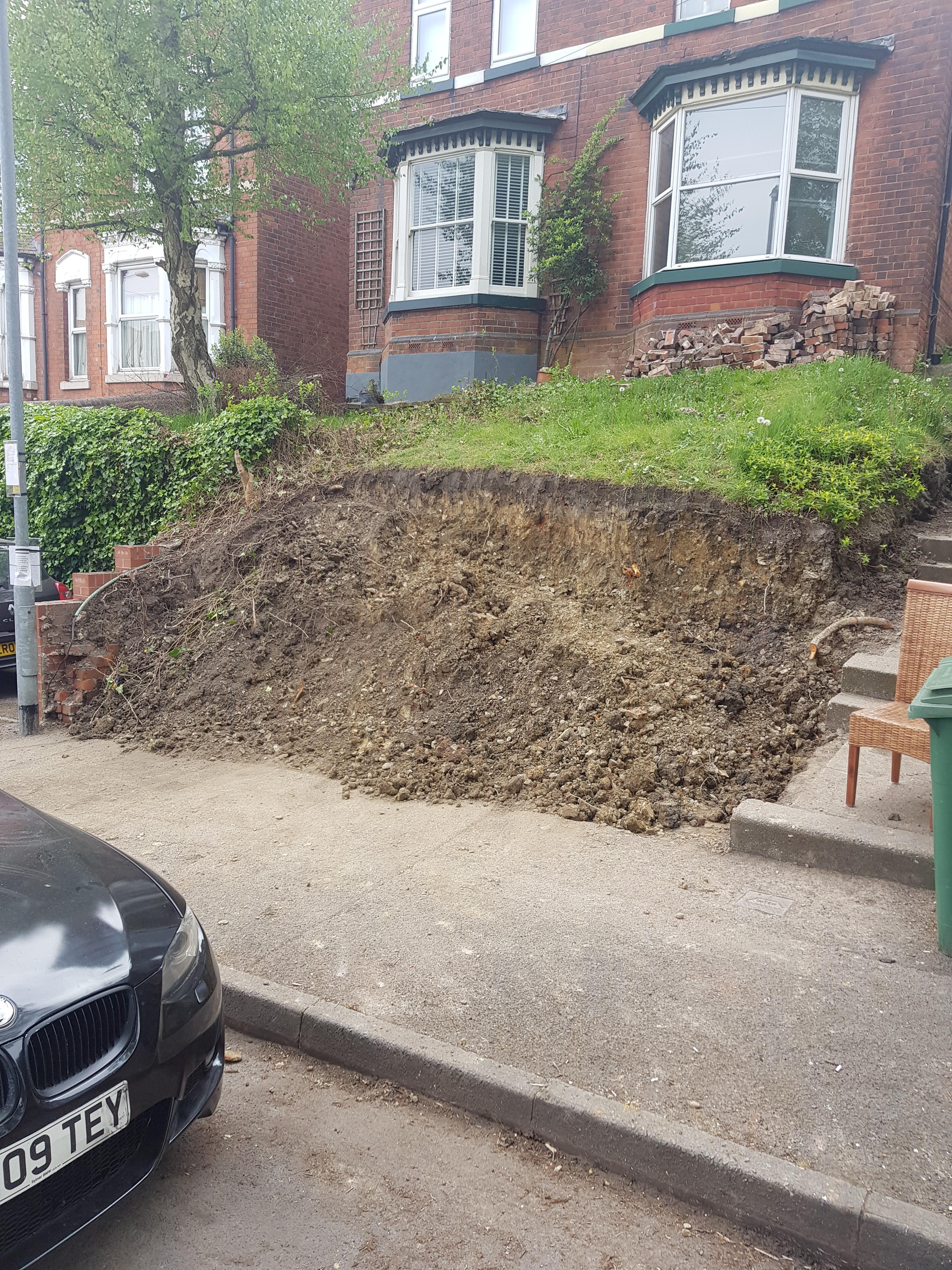

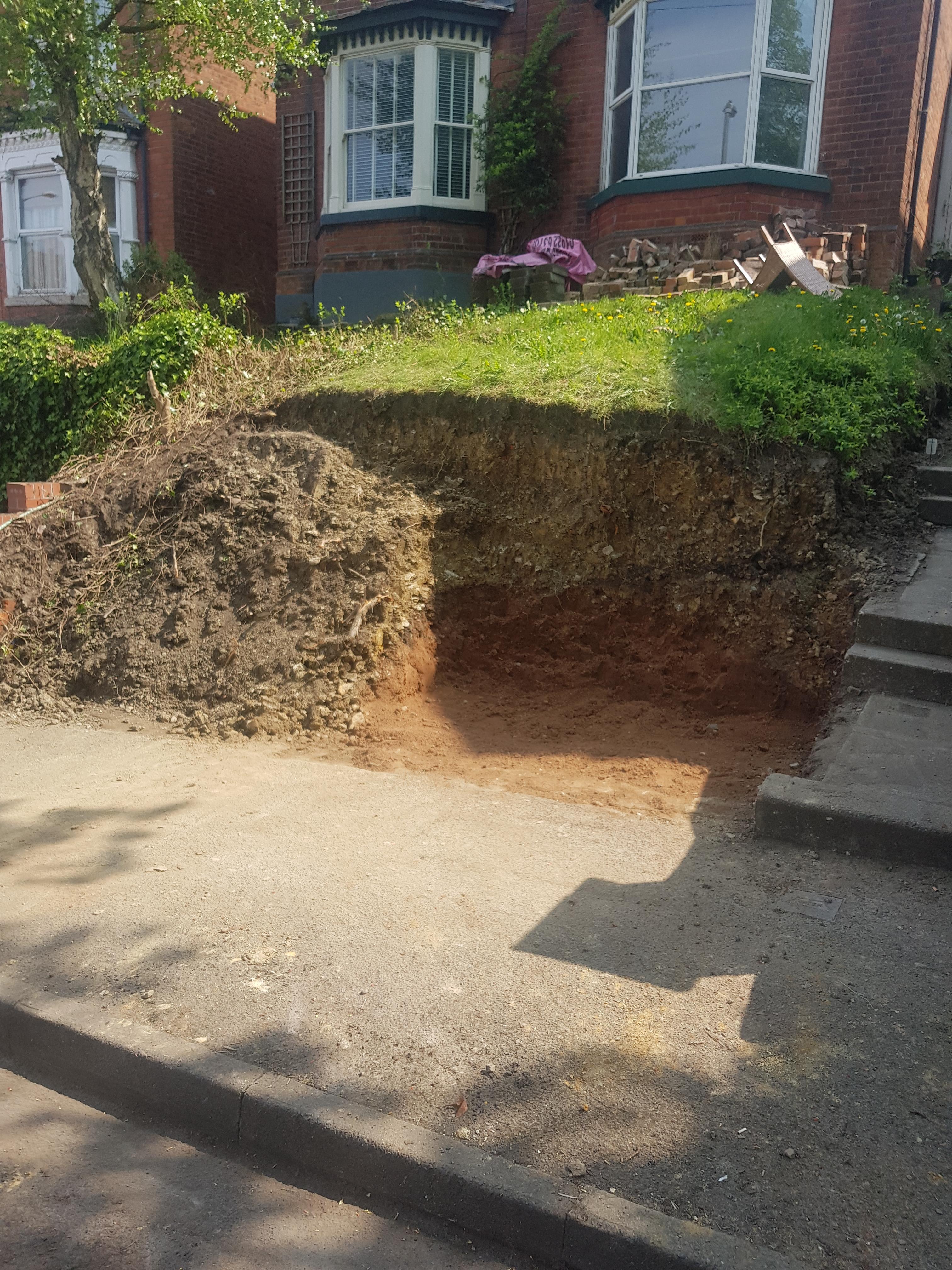

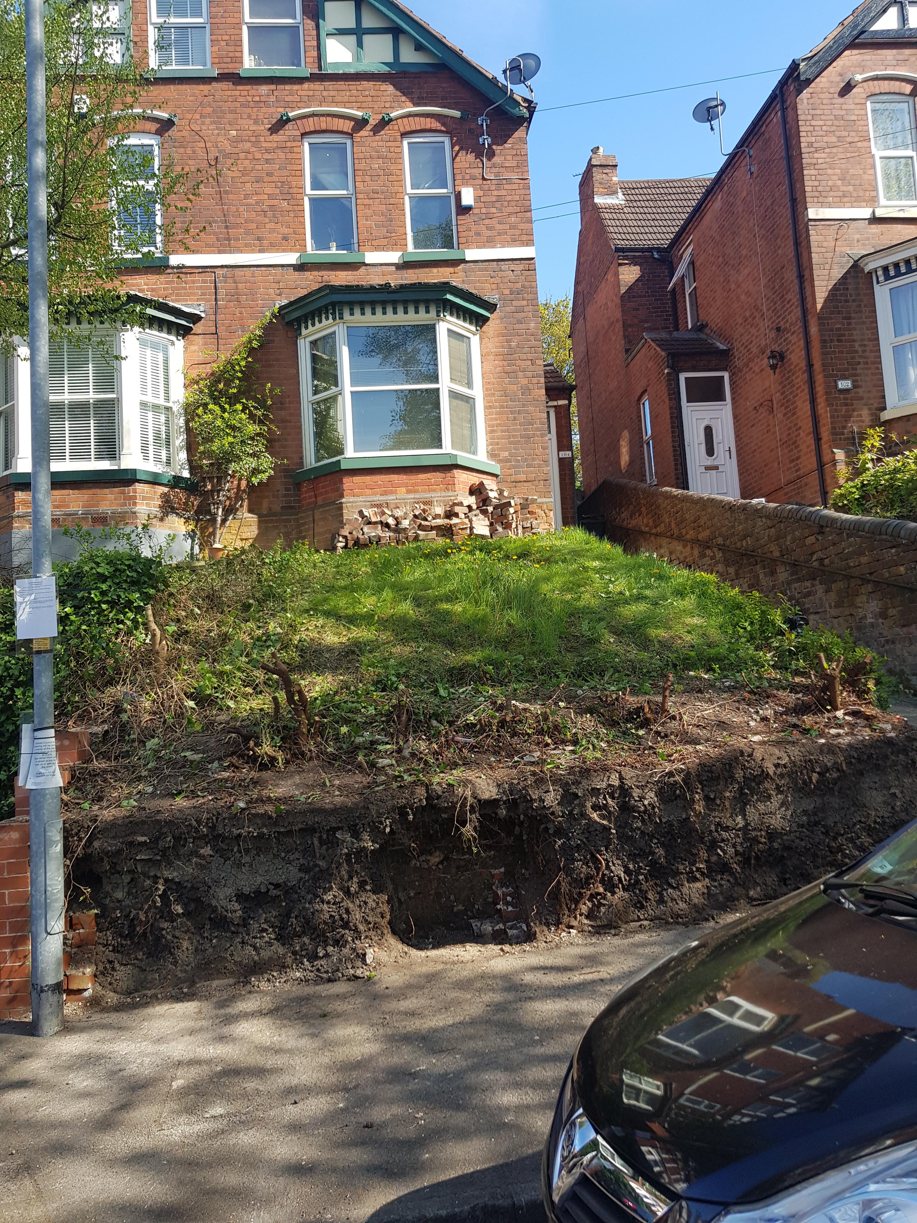

Basically, i live in a semi detached house which you can see from the picture i have attached, sits elevated from main road and has a front garden sloping down from the house to the main street.
In urgent need of a disability parking space, we have decided to make a car drive in front of the house.
So we have started the work, by removing the brick wall that was at the bottom running across garden, and a tall bush.
Now we are slowly excavating the garden in order to make a space that is flat to park vehicles. I dont want the space to be sloping so were digging straight to be flat
Anyhoo, what i wanted help with was i wanted to know how close i ca excavate to the front of the house wall.
I was told i would have to leave at least 3ft of garden and then add a retaining concrete block wall going across and  then in a gap between this wall and the garden behind it, pour in concrete.
So yeah thats it, just wanted to know how much garden/land i need to retain from the house wall, how far back we can dig to make drive as long as possible.without it risking the foundations of the house, if that is the case.
Im not hoping to go right back to actual house wall and dig all of the soil out, just as far back as possible to make drive as long as possbile.
Measurements wise,  the width is approx 18ft, and lenght from bottom of garden on the street to the house wall, its about 23ft. But that is obviously being measured standing on a slope,

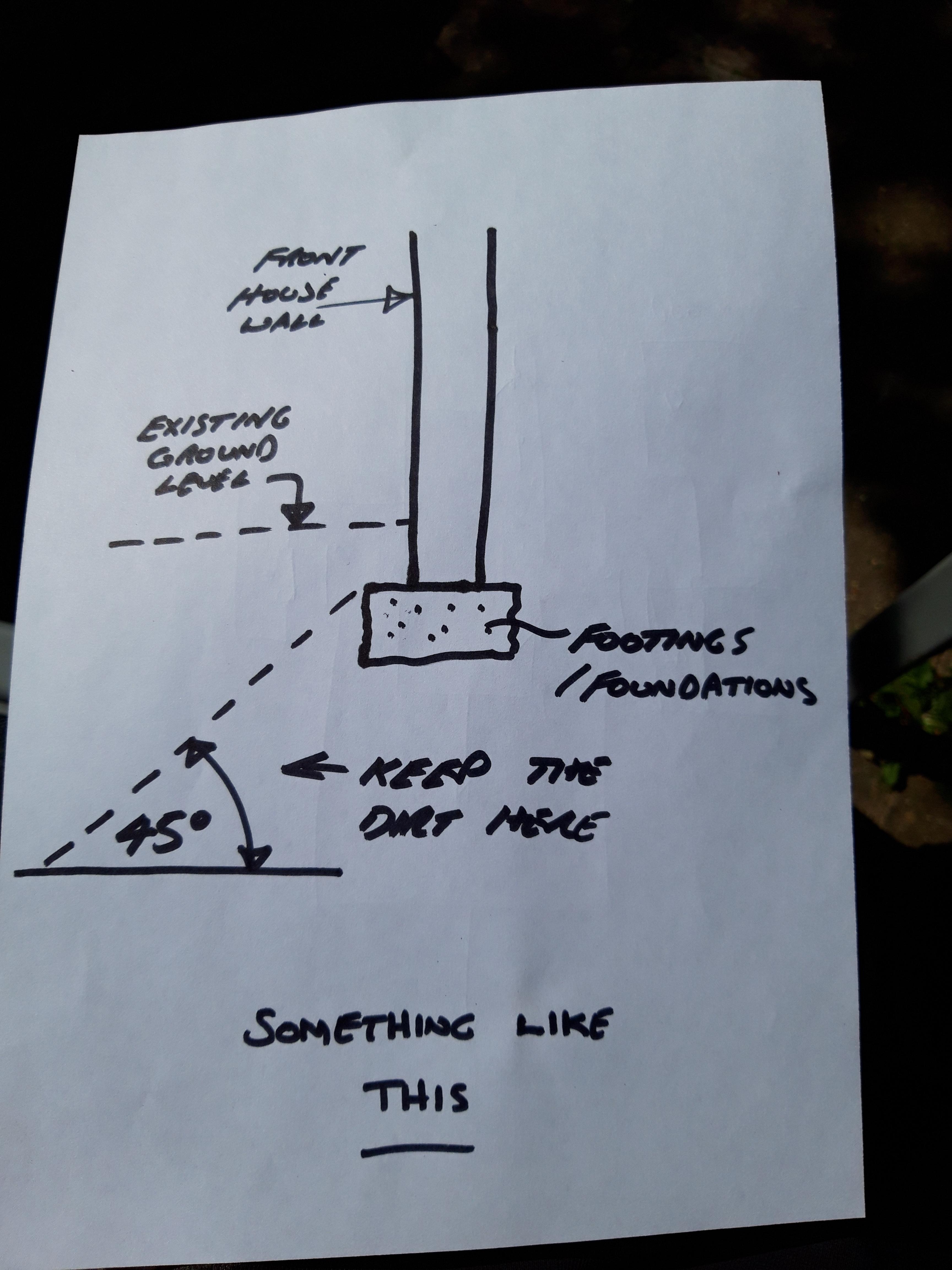

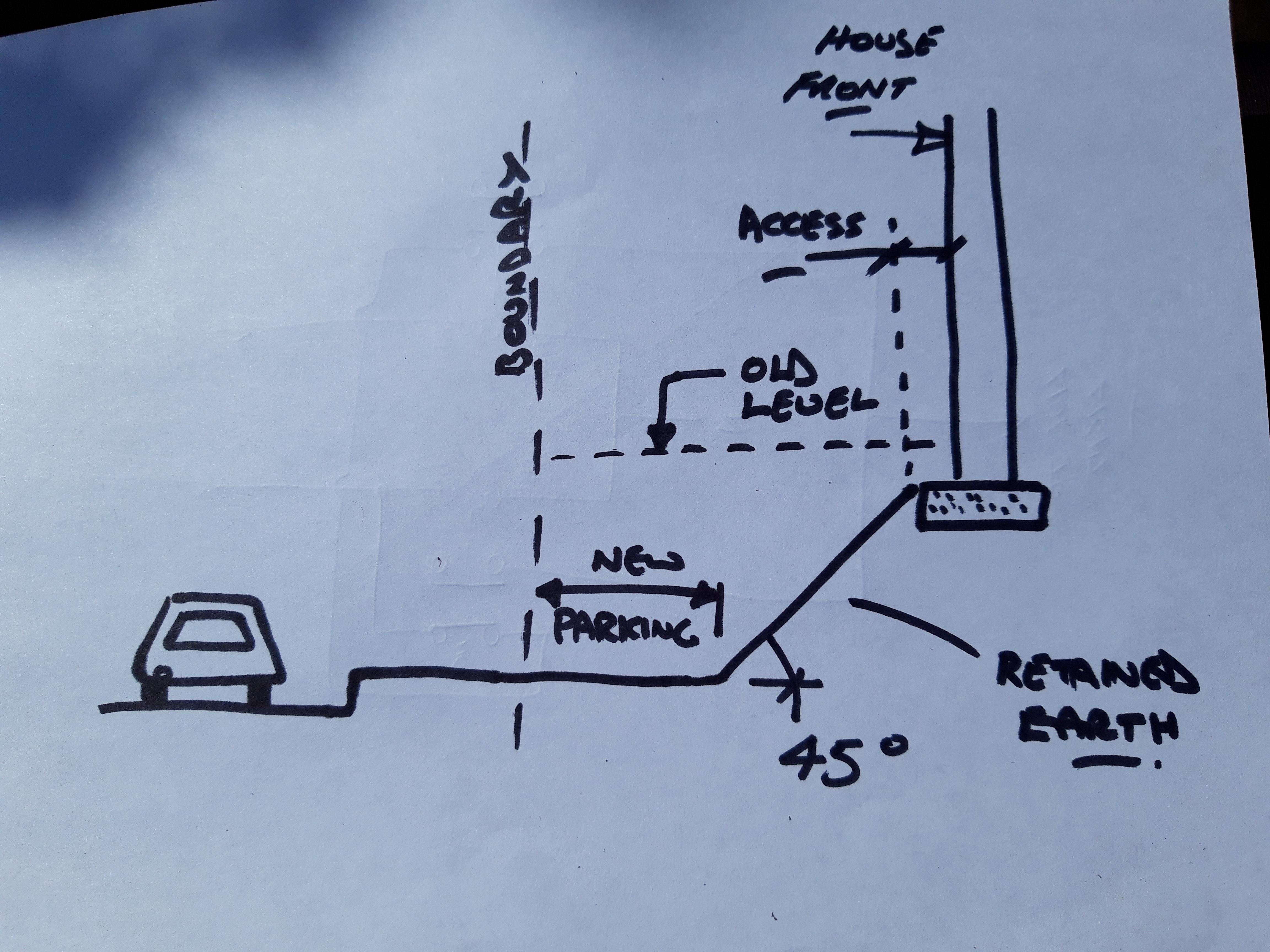

Before you go much further I would do a test dig adjacent to the house to find how deep the foundations are (dig down a small hole by hand and see how deep before the bricks start stepping out wider or you hit concrete)
Then you need to apply the "45 degree rule"  Project an imaginary line from the foundation depth down at 45 degrees and that is the soil you must not disturb without proper structural engineer input.

20 minutes ago, Margaret dailey said:
also can you explain this please "
Then you need to apply the "45 degree rule"  Project an imaginary line from the foundation depth down at 45 degrees and that is the soil you must not disturb without proper structural engineer input".
Something like this I think he means:
In fact I've seen places where the slope gets paved.

again thankyou for your help,  and really appreciate the drawing.  but im still a little confused.
i understand i stand at the bay window then dig down a little until i can touch concrete and then i dont understand what i need to do to work out where to stop digging to.

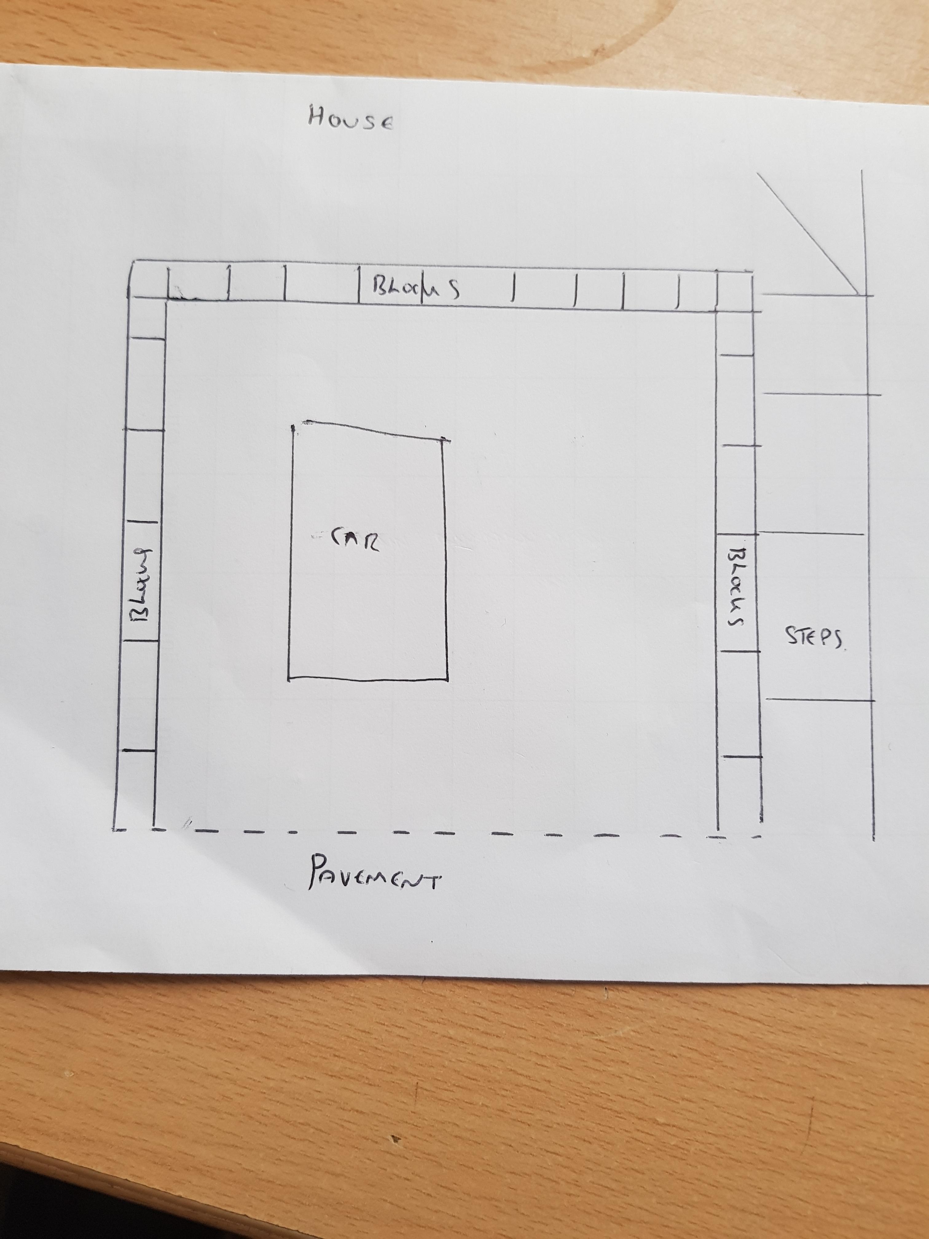

Posted (edited)
also it wont end up being a slope, it will be all dug out so the car can park flat.  and not on a slope, so that my car can be driven on and its flat land.
one other thing, once dug out, we are going to be putting up walls using concrete blocks.  so one will be putting a wall up between the remaining land in front and either side also,
see  poorly drawn pic below.
Edited by Margaret dailey
Posted (edited)
At the bottom of the slope is where the new flat area for parking will be / start from. How much parking space you end up with is dictated by where the 45deg slope ends. My fag packet sketch is very rule of thumb just to show the concept.
Things to consider are leaving a width in front of the house for future access like maintenance and cleaning windows. Similarly you don't want to expose too much of your foundation to weathering by the elements.
Hopefully you'll see this is more than just dig it out and hope for the best. You might well need building control approval. If it all go t!ts up and the front wall of  the house develops cracks, subsidence or worse it might well invalidate your insurance.
Really not trying to scare you.
The only way to cut back fully, to say within 3' of the house is to get structural engineer's input and likely build a big, reinforced U shaped wall. You might even need temporary supports to the house whilst you do. Similarly I'd get an SE even to go the 45deg route.

Explains what you want to do perfectly. Really...get professional advice.

Thanks @Onoff for the drawings.
If you want to to plan this you really need to know how deep the foundations are, then you can draw a drawing like @Onoff did a few posts up but properly to scale with your actual site measurements and foundation depth.
If your proposed parking space does not cut into the bit below the 45 degree line, then everything is fine.  If it does, you will need a structural engineer to design a retaining wall.
You might well find because the house has been built on a slope that the foundations are already deep.
An alternative might be to lift some floorboards in that bay window and see how deep the void below the floor is, that will perhaps give an idea of the foundation depth without digging a test hole.

Margaret - looking at your photos, that retaining wall could be over 6 feet high. You also have to dig out the foundations for the new wall, meaning further digging.
This really is getting dangerous. Anything over 3 feet high needs to be properly designed and constructed.

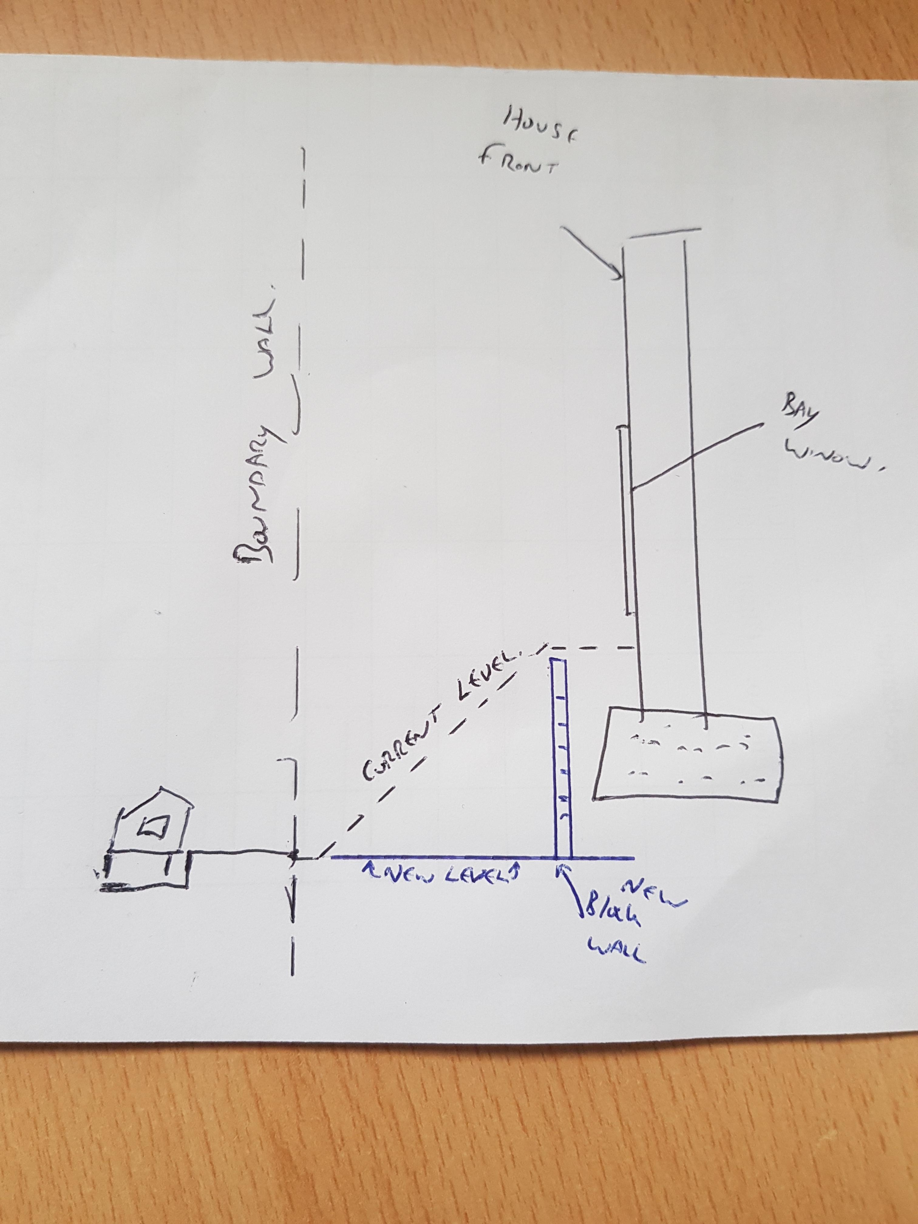

Posted
i think i might have confused the point.  on/off drawing showing the side of the house is spot on,  however the current level of the ground is not straight.
if you please take a look at my drawing showing the side of the house,  there is no access from the front, the front door is at the side of the house facing the street.  there is a bay window infront of the proposed drive.  then in front of the bay window there is small peice of ground u can stand on which is flat, approx 1ft then it slopes down all the way to the bottom wall at the boundary which has been removed now.
