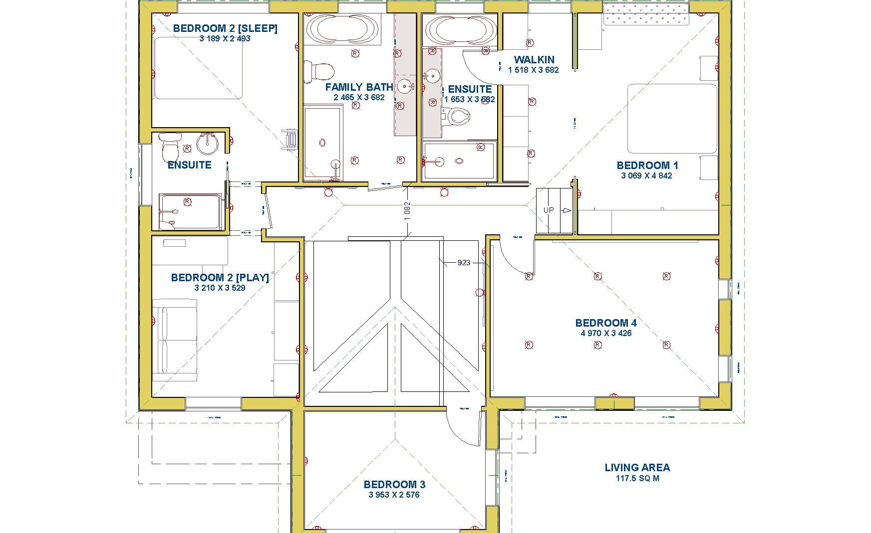

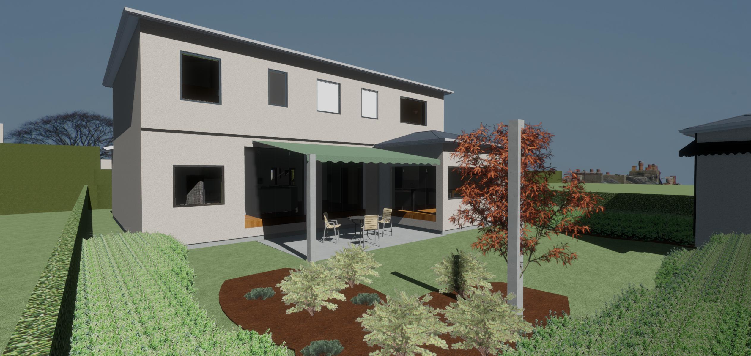

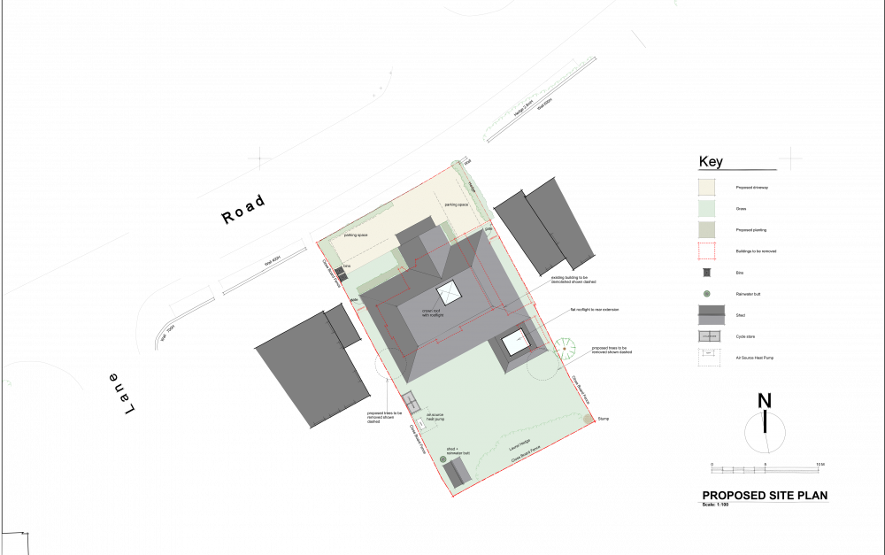

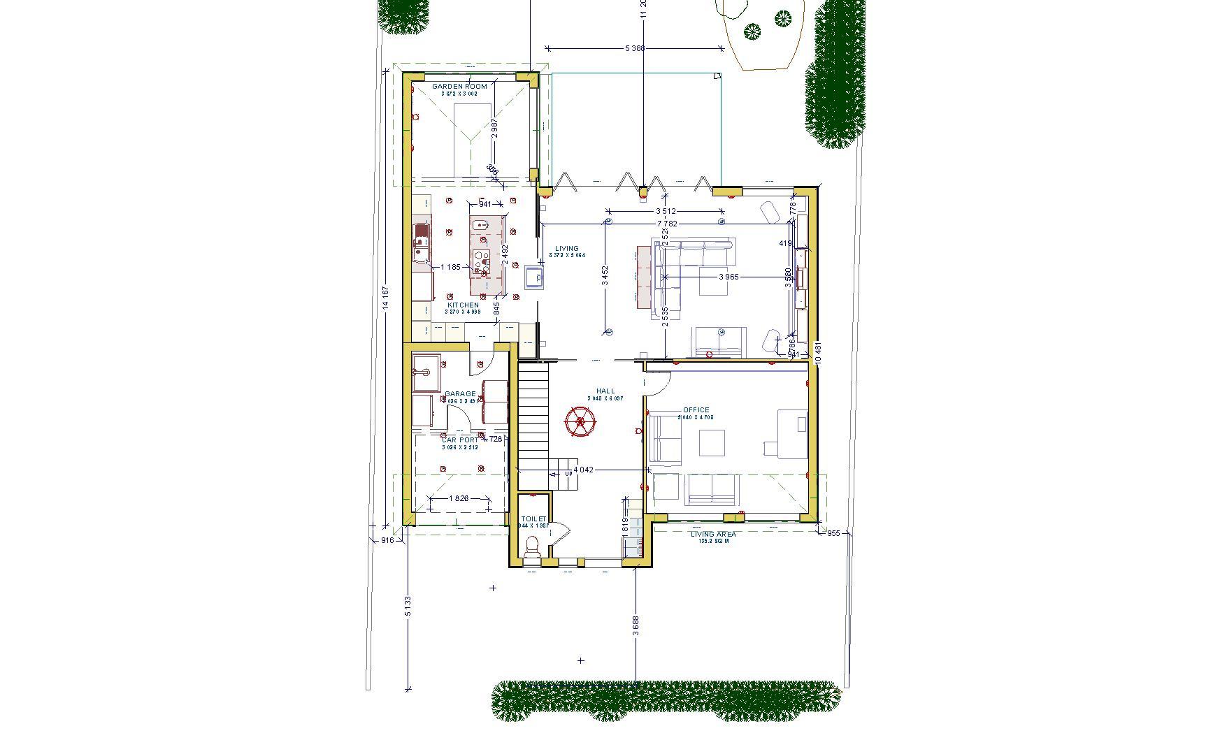

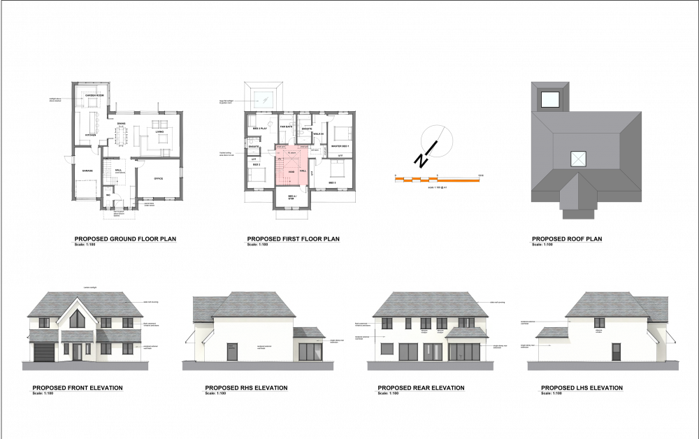

puntloos Posted April 21, 2020 Share Posted April 21, 2020 (edited) Even if this is the one, I'll 'probably be back' Main layout: - We don't know for sure if the ASHP is in the right spot? - Note that our main walls are in line with neighbors but hoping this 'gable hall/room' is reasonable. - Total floor space about 250m2 And here's the design from the architect. - The kitchen and garage will trade some space, adding 1m to kitchen - Intending to extend the gable (25cm) and then move the entire house into the garden (25cm) so bed4 and hall(staircase) will have some extra space. - Ceiling lights in particular in the loft need to be added (somewhere).. I'll update with a few more points and an updated internal design shortly - Edited April 21, 2020 by puntloos Link to comment Share on other sites More sharing options...
wozza Posted April 21, 2020 Share Posted April 21, 2020 (edited) If it were mine, I would consider putting in an en-suite for bed 3 where the loft hatch space area is. Move family bath, master en-suite and walk in to the left a bit so master door can be put on same wall as family bath door. Edited April 21, 2020 by wozza Link to comment Share on other sites More sharing options...
ProDave Posted April 21, 2020 Share Posted April 21, 2020 I am not convinced the master bed is big enough. I would ditch the walk in to make the room bigger, you show a built in wardrobe and that would do for me. I would put the door to the garage from the dining room in that otherwise awkward looking alcove in the corner, so save splitting the run of kitchen units to put the door there. Link to comment Share on other sites More sharing options...

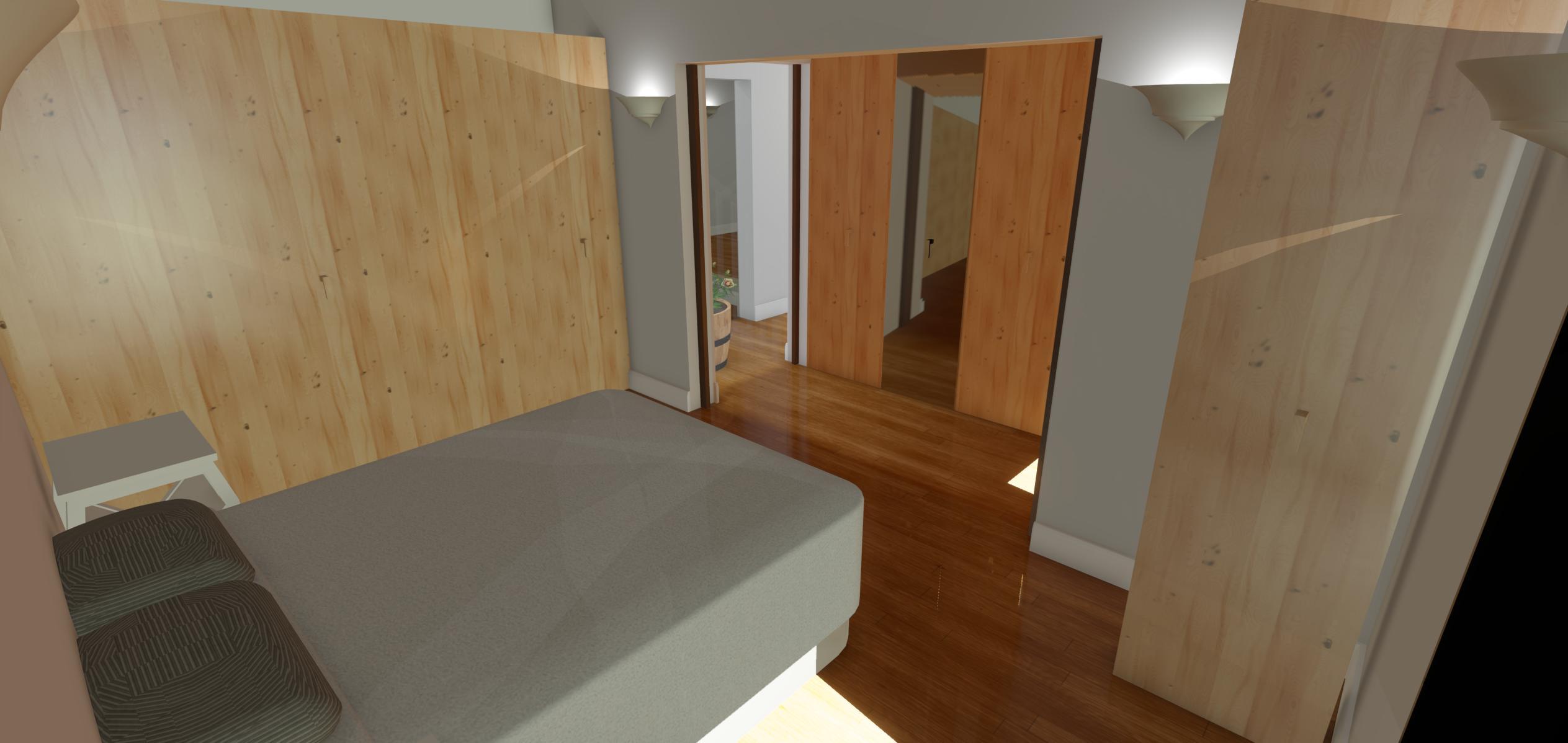

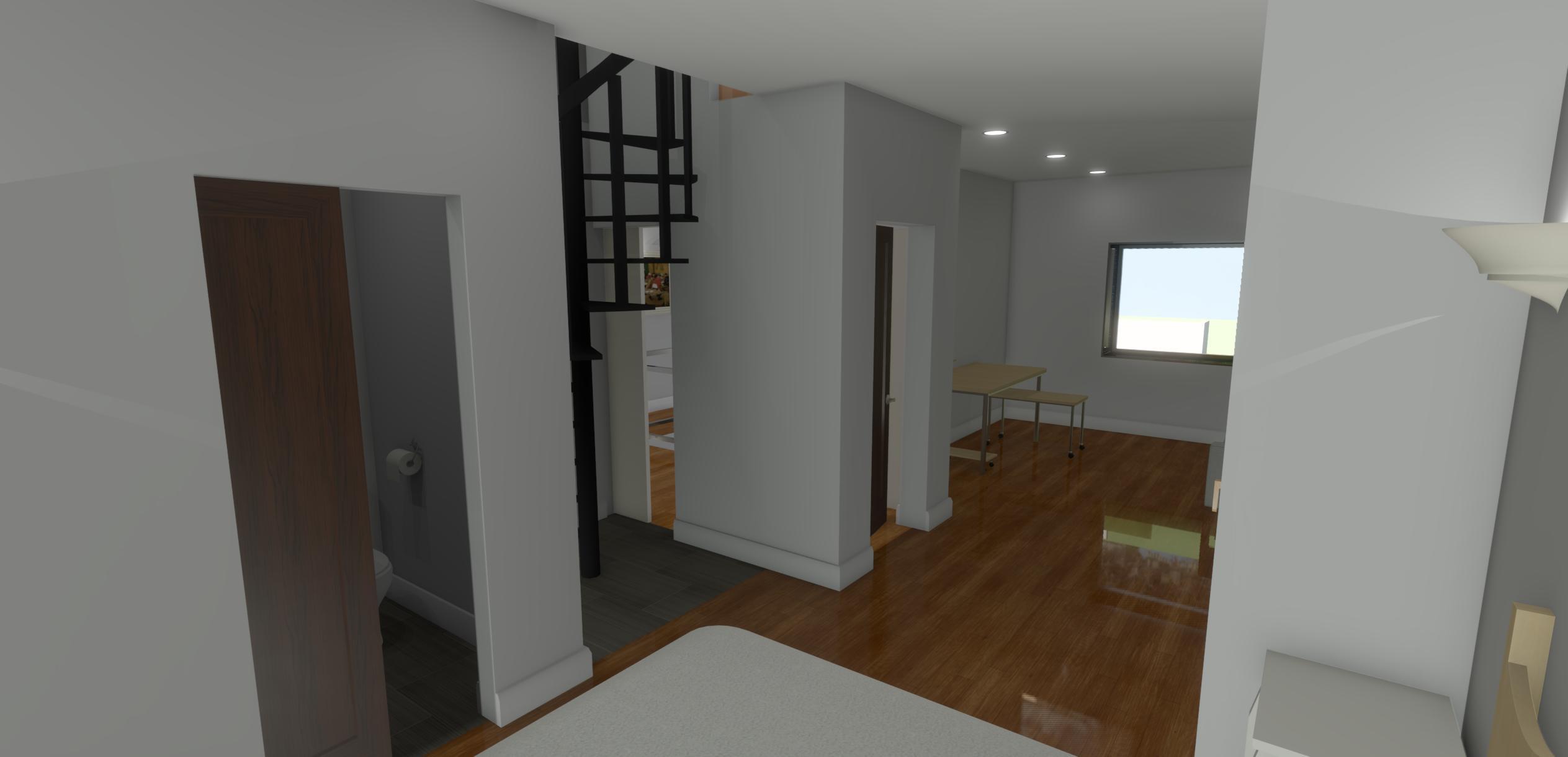

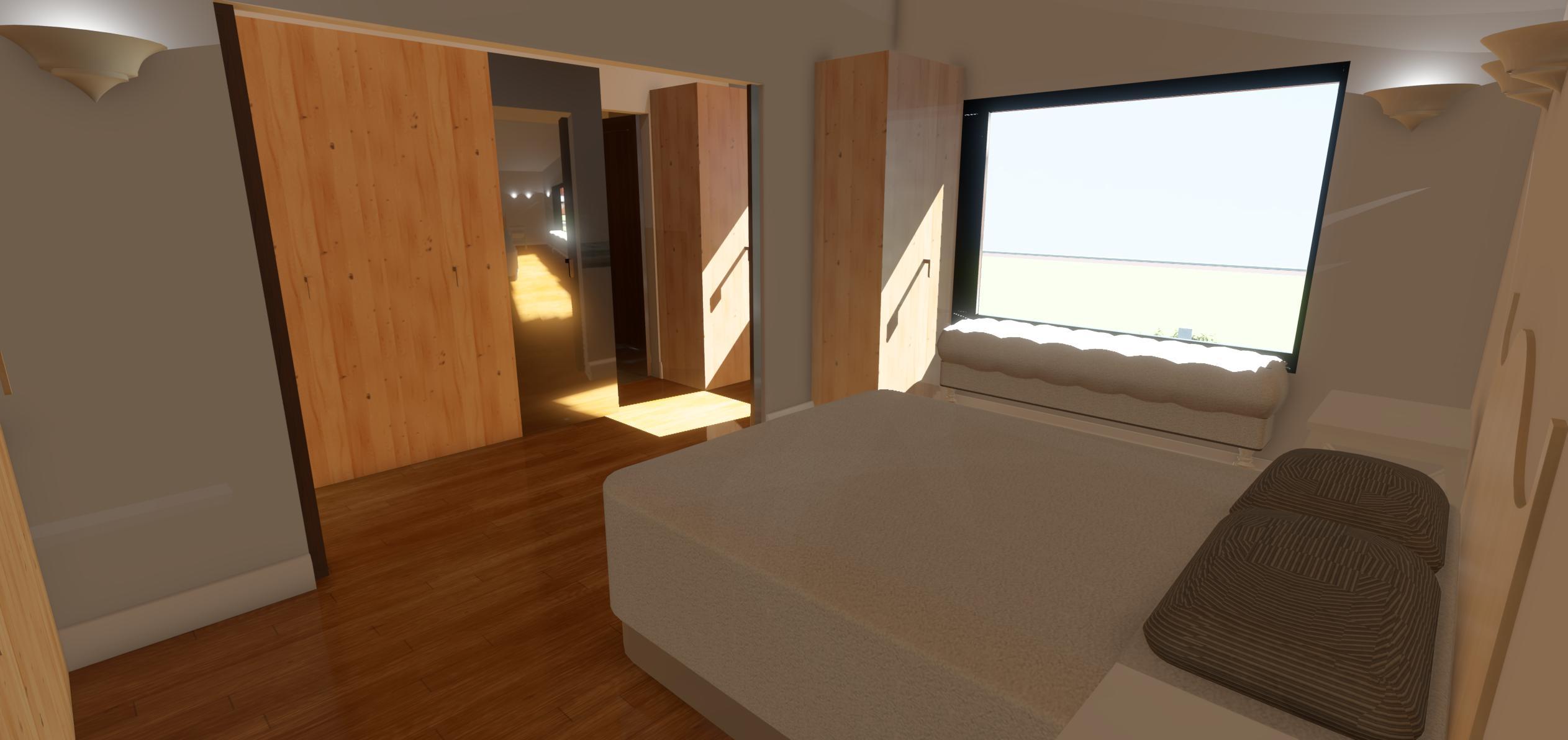

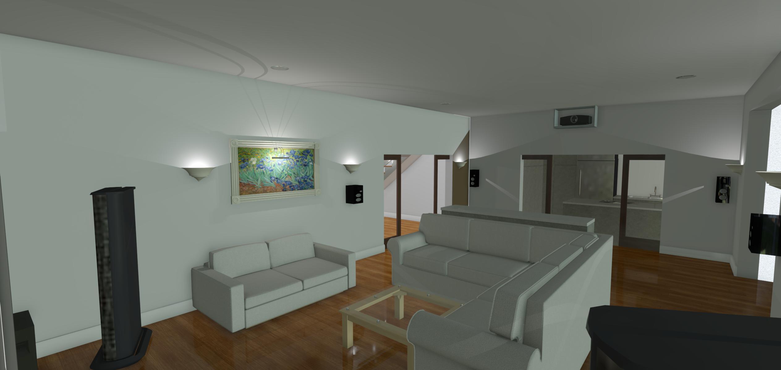

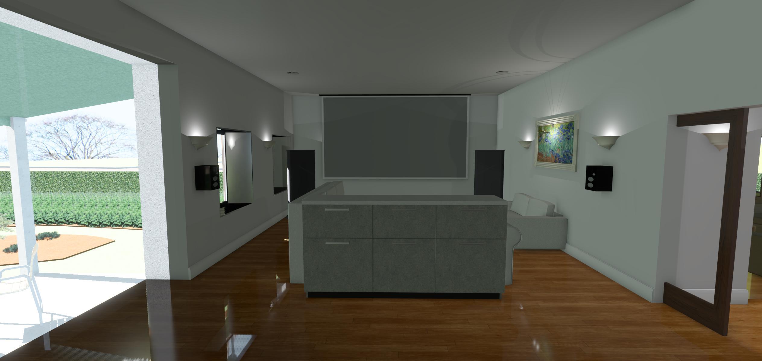

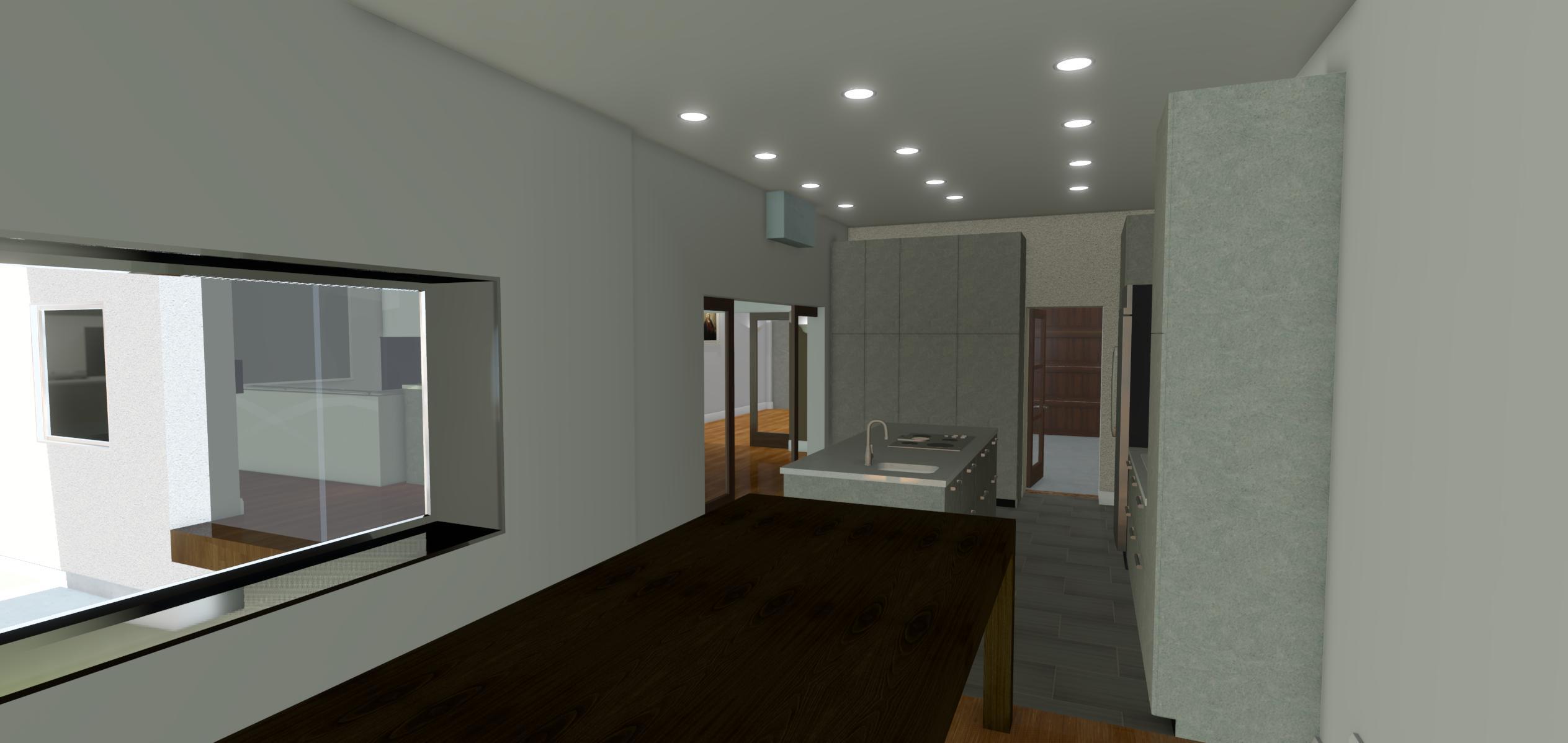

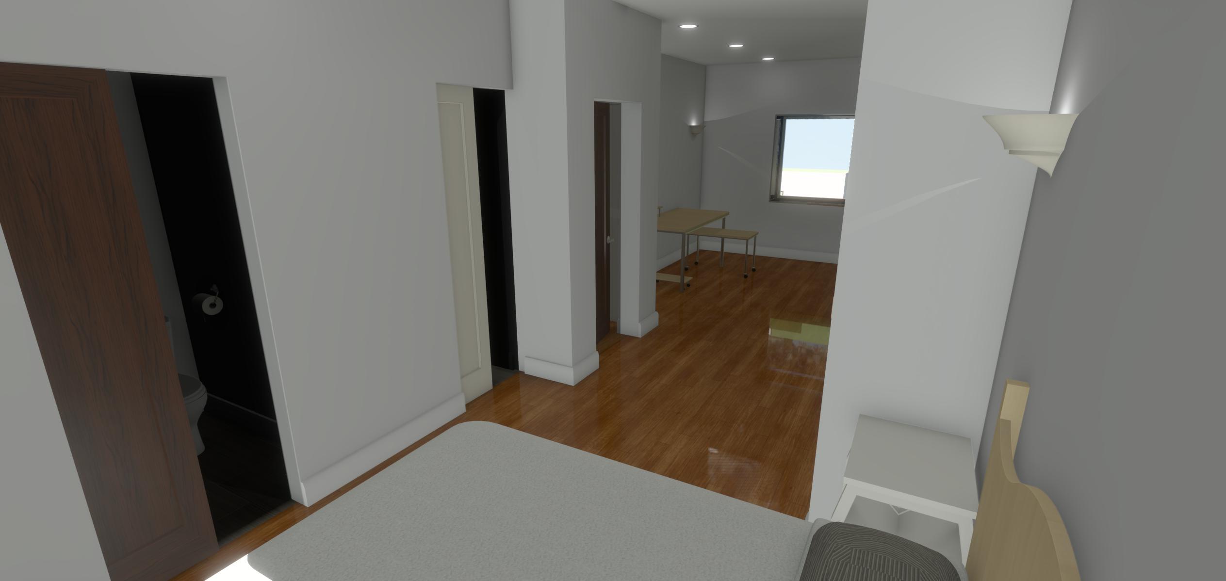

puntloos Posted April 21, 2020 Author Share Posted April 21, 2020 (edited) Here's the updated thinking on internals inside my own program @ProDave - as you can see we shared your feeling around the master, so we flipped things around to "default" to a larger space, that can be closed off into a 'walk-in' Reasoning here is that my wife and myself have very different schedules around work and kid, so getting dressed is much better in a separate area, and obviously we're tight(ish) for space. @wozza - hmm not a bad idea, I'll consider it. Downstairs: Upstairs: I found animating the differences very helpful. See the attachments, the forum doesn't allow animated gifs apparently. Check here: Downstairs: https://drive.google.com/open?id=1VHx0uhvZdlPeAzS9fRyImbke-Mo_ujru Upstairs: https://drive.google.com/open?id=1wbFll6l-7pOGSXlw4orxYWlhdLlvIPG_ This is what Master now looks like: (note one of the closets in walk-in is a mirror) Edited April 21, 2020 by puntloos Link to comment Share on other sites More sharing options...
AliG Posted April 21, 2020 Share Posted April 21, 2020 1. Do you plan to have a cupboard under the stars? Or is that a cupboard across from the WC? We have a load of coats shoes etc in a big hall cupboard. 2. If you aren't having a garage and plan to put the car in there I would lose the door and widen the opening which won't need a door frame anymore. It will be easier to get in and out of the car and get past the car. 3. The sliding doors that separate the kitchen are pretty close to the island. I would move them over 1-200mm to the right on the picture. TBH I doubt they'd even be closed and it might be better just to lose them altogether, I don't like the pinch point between the island and the entrance to the garden room. If you wanted to separate an area, the lounge would be better where between the office wall and the pillar in the bifolds. 4. I guess the door to bedroom 2 is recessed to make the hall more symmetrical, but that looks like way too tight an entrance. You would open the door onto a wall right in front of your face. I would put it back where it was before, you could still have arches between the rooms. 5. I am not sure what you are trying to achieve on the master bedroom. I think it would be better to walk into the bedroom where that stair that I assume is a glitch is shown then have the walk in between the bedroom and the en suite. I guess it makes the bedroom feel wider as it is shown. You couldn't walk in there and close it off without disturbing the other person in the room. I don't think the massive sliders are a good idea, so I would either just make it a big room with wardrobes or I would make that a wall with an archway. Alternatively you could put the bed where the ensuite is and split the area where the bed is between the en suite and dressing room. Or you could make bedroom 4 a little narrower and put the walk-in there, making the room longer and narrower which fits a bed better. 6. The bathroom door opening out onto the landing is not a great idea and there is room to open into the bathroom. Link to comment Share on other sites More sharing options...
puntloos Posted April 21, 2020 Author Share Posted April 21, 2020 Thanks for your response, inline! 16 minutes ago, AliG said: 1. Do you plan to have a cupboard under the stars? Or is that a cupboard across from the WC? We have a load of coats shoes etc in a big hall cupboard. Yes I think under the stairs is wasted space otherwise. 16 minutes ago, AliG said: 2. If you aren't having a garage and plan to put the car in there I would lose the door and widen the opening which won't need a door frame anymore. It will be easier to get in and out of the car and get past the car. Not sure I understand. Do you mean remove the garage door? Or make the door from the kitchen an open walkway? The idea is that we won't use it as storage for a car, but we wanted it to be 'theoretically suitable'. We'd probably put a door halfway, so there is still an outside(ish) space for trash bins, bikes perhaps, and have a more heated 'utility' section. 16 minutes ago, AliG said: 3. The sliding doors that separate the kitchen are pretty close to the island. I would move them over 1-200mm to the right on the picture. Interesting point. We could consider this. It also would work a bit better with the projector. 16 minutes ago, AliG said: TBH I doubt they'd even be closed and it might be better just to lose them altogether, I don't like the pinch point between the island and the entrance to the garden room. If you wanted to separate an area, the lounge would be better where between the office wall and the pillar in the bifolds. The idea for closing is that we want to separate smells and mess from the living room, but I imagine it mostly happening with guests, and not 'day to day'. 16 minutes ago, AliG said: 4. I guess the door to bedroom 2 is recessed to make the hall more symmetrical, No, the reason is twofold: 1/ to have the walkway 'disappear' as to give an idea of space. If you can't see where it's going your mind imagines much more space then there actually is 2/ To be able to split Bed 2 into two bedrooms. 16 minutes ago, AliG said: but that looks like way too tight an entrance. It's 1m.. not that bad? But, we could perhaps open into Bed 2 downwards (we left space..) but then you'd have to walk around a corner to get back in. 16 minutes ago, AliG said: You would open the door onto a wall right in front of your face. Fair point.. not the end of the world I'd say, but perhaps less elegant than ideal, thanks will consider alternatives. 16 minutes ago, AliG said: I would put it back where it was before, you could still have arches between the rooms. Not sure which arches you refer to.. between bed2-sleep and bed2-play? 16 minutes ago, AliG said: 5. I am not sure what you are trying to achieve on the master bedroom. I think it would be better to walk into the bedroom where that stair that I assume is a glitch is shown Nope, this is intended to be the loft access (of course not always in the 'down' position) - not a glitch.. 16 minutes ago, AliG said: then have the walk in between the bedroom and the en suite. I assume what you mean is the ensuite being down to the front, but that comes with downsides: - Privacy (either no windows, or it will be hard to prevent people seeing your outline as you move around..) - Bedroom 4 becomes quite small 16 minutes ago, AliG said: I guess it makes the bedroom feel wider as it is shown. You mean my current design? 16 minutes ago, AliG said: You couldn't walk in there and close it off without disturbing the other person in the room. I don't think the massive sliders are a good idea, so I would either just make it a big room with wardrobes or I would make that a wall with an archway. Your suggested solution, or this one, is all we could come up with so far.. 16 minutes ago, AliG said: Alternatively you could put the bed where the ensuite is and split the area where the bed is between the en suite and dressing room. We thought about this, but this is also about noise separation, the kid can be loud, and with age gets louder, so we figured having a 'layer' between our bed and the rest of the house is important. But yes, all compromises.. 16 minutes ago, AliG said: Or you could make bedroom 4 a little narrower and put the walk-in there, making the room longer and narrower which fits a bed better. Ha, one design we did consider at some point I think, but "a little"narrower is pretty optimistic, it'd stop being a 'king size' bedroom. 16 minutes ago, AliG said: 6. The bathroom door opening out onto the landing is not a great idea and there is room to open into the bathroom. Agreed, we should fix it. Link to comment Share on other sites More sharing options...

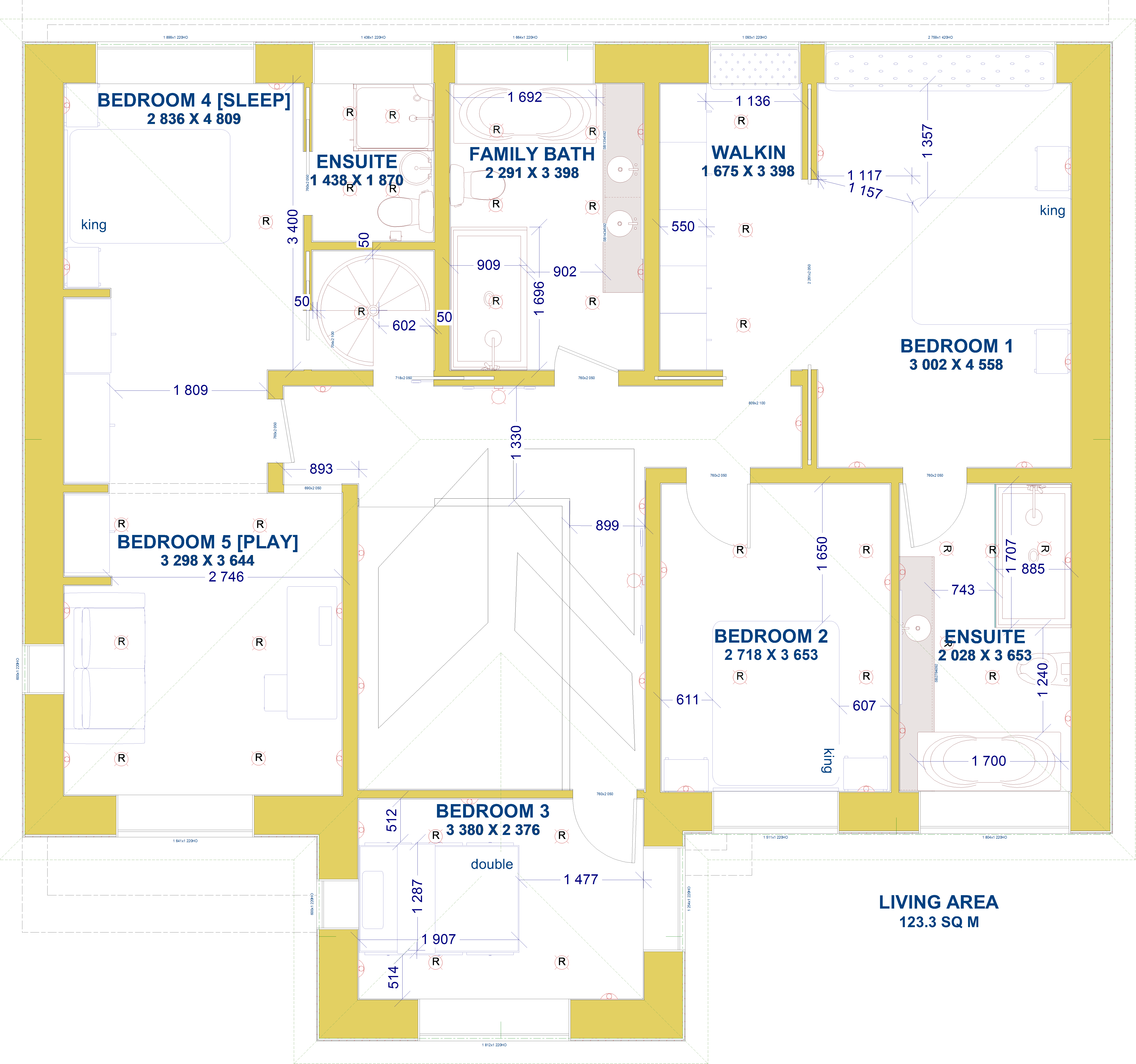

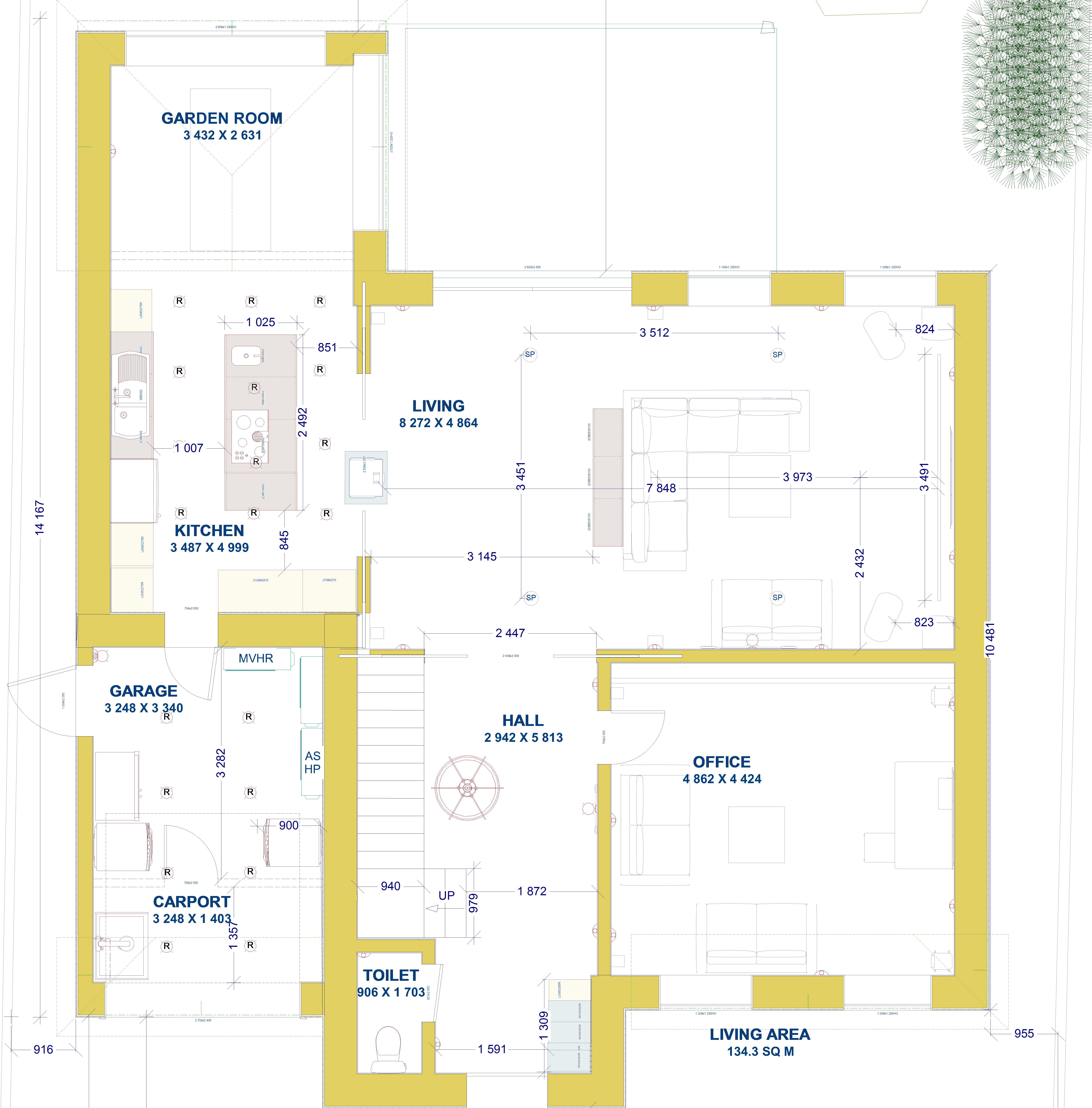

puntloos Posted May 25, 2020 Author Share Posted May 25, 2020 Almost there.. a few updates after speaking with a Passivhaus builder. As per the tinkering with design post-permission discussion, I figured I want the design (and in particular the window positions) as close to current as we can get to. The changes: - Ext wall thickness 500mm - perhaps not required really - @ProDave's example was 360mm but to be sure it'll work and we have some give. - 3m worth of garage wall allocated for ASHP/MVHR type equipment - Rethink of both main rooms (Kid and Master). Given up on master ensuite next to family. Moved Ensuite into BR2 Moved Kid Ensuite next to Family Bath, making Kid flow much nicer. Changed pull-down loft stair (below walkin) into spiral stair straight up from main stair (TBC, discussions still ongoing but for now I'll assume..) I'm still debating if I should pick generic window sizes (so I can still move them a little) or make them fit the current design exactly - for example the walkin window - should I make it exactly fit the walkway or keep them a bit smaller so if I move the windows around, it still could fit whatever new room layout I'd go for.. Link to comment Share on other sites More sharing options...
dpmiller Posted May 25, 2020 Share Posted May 25, 2020 what's the point of the pocket door between Bed4 and the spiral stair? Surely the handrail will preclude acces to the stair... Link to comment Share on other sites More sharing options...
ProDave Posted May 25, 2020 Share Posted May 25, 2020 I would not use a round spiral staircase in a square "room" the old round peg in a square hole situation creating awkward corners you will never get to for cleaning etc. Make a square "spiral" staircase out of timber in the same way a timber stair can wind round a corner, it will just keep on winding like a spiral stair, but with all the treads going out to the corners. Then the space under it could be a cupboard accessed from bed 4. 1 Link to comment Share on other sites More sharing options...
DevilDamo Posted May 25, 2020 Share Posted May 25, 2020 What are your floor to ceiling heights? Why is the roof to the single storey rear element so high up? Is it to do with ceiling heights hence my comment above? There may be a slight access/design issue with the door between the Landing and Bedroom 3 assuming the front projected part is still to have the lower eaves? The line of the wall between the Landing and Bedroom 3 doesn’t appear to be shown correctly. The Landing side of that wall lines through with the internal face of the front wall to Bedroom 2 but does not line through with the internal face of the front wall to Bedroom 5. If you’re going to use the loft as storage, then you can do what you like to access it. The roof could also be designed with a slightly simpler structure. If however you’re going to use the loft for anything else that resembles a habitable area, it will need to meet BR’s in terms of structure, fire and thermal. If you are going to use the loft as habitable, you’d normally look at having four Bedroom’s on the first floor and a fifth/Games room on the top floor. Who has designed this house because in another post, you mentioned your wife is the architect or were you referring to that as her making the decisions and having the final say? 1 Link to comment Share on other sites More sharing options...
bassanclan Posted May 25, 2020 Share Posted May 25, 2020 I'm not 100% clear where your dining table is, if in the garden room access is a little awkward for people coming from the open plan living area. Would the kitchen ar the far right work better, with more natural light and better outlook? 1 Link to comment Share on other sites More sharing options...
tonyshouse Posted May 25, 2020 Share Posted May 25, 2020 What are the Target U values for walls, floor, ceilings, fenestration, target air tightness, have you done a thermal model looking at overheating in summer and/or informing smaller windows, shading of windows and reducing dangerous for overheating West facing glazing. integral garage is what I call an in-house winter cooling system so would try to design that out how big does an office need to be ? 1 Link to comment Share on other sites More sharing options...
AliG Posted May 25, 2020 Share Posted May 25, 2020 (edited) A few things. 1. Mentioned before, but it is even worse now with the thicker walls. That corner between the island and the pocket door to the living area is both narrow and awkward. It would be even worse with a chair at the island. The space around the island is just too small. When you open the door to a dishwasher, it sticks out almost 80cm, you won't be able to pass between it and the island, you won't be able to pass between an open cupboard door and the bottom of the island. If the plan is to put the dining table in the garden room, then the space between the hall and patio doors seems wasted and I would move the packet doors back in line with the other side of the stairs to give you almost an extra metre in the kitchen. 2. You will not be able to use the projector there. I have a 5 m long room painted dark brown, including the ceiling, with a little slot window and the projector is OK in the daylight on a 2.9m wide image. In my old house with a slightly smaller screen, white ceilings and larger windows it was impossible to watch the projector in the daylight. And this was much closer to the screen. The combination of light coloured room, patio doors and projector will not work. 3. Spaces of 600mm and 500mm either side of a bed are too narrow. By the time the duvet hangs over the sides you can knock another 100mm off that. 4. Now that you have made the master bedroom larger, I would move the door to being a normal swing door next to bedroom 2 and close in the wardrobe more. Sliding doors are a pain to use relative to normal doors. It is not quite clear though as the render appears to have wardrobes there. You have a lot of room in the walk in, I would try to keep all the wardrobes in there. 5. The floorpan shows windows on 3 sides of bedroom 3. With the already limited space, a window or door on every wall will make placing furniture difficult. 6. I would make the sink area smaller in the master ensuite so it does not impinge on the entrance area in front of the shower. Edited May 25, 2020 by AliG 2 Link to comment Share on other sites More sharing options...
