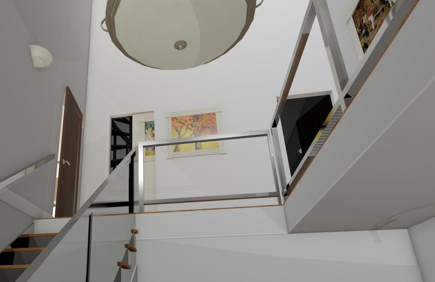

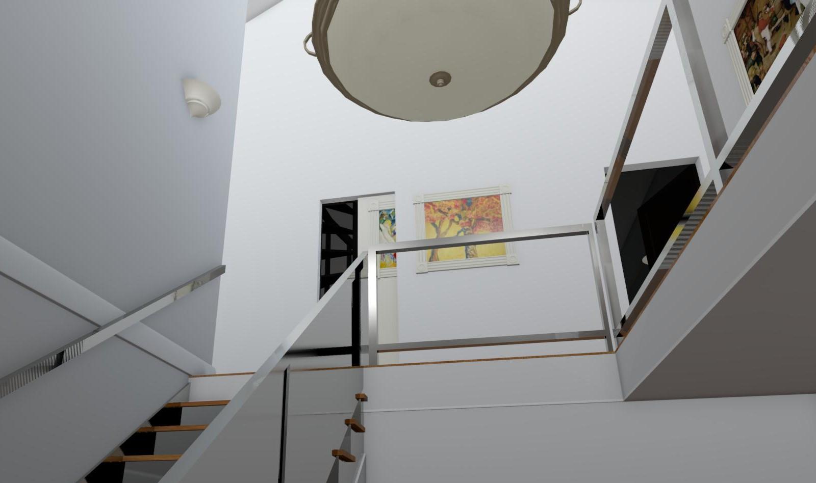

2 reasons:
1/ Visual. Compare: (sorry I don't know why the program is changing the colors, ignore.
nodoorcrop.thumb.jpg.d9c43fd7a893e7dd39ad80fb94124074.jpgdoorcrop.thumb.jpg.61b1a37efd8678f2572c50d60f516170.jpg
As you perhaps agree, the hallway in the first picture looks, to the eye, as if it could go on for miles. It gives the impression of a larger house.
2/ The hallway actually can fit a door, allowing us to easily split the one big bedroom into two.
