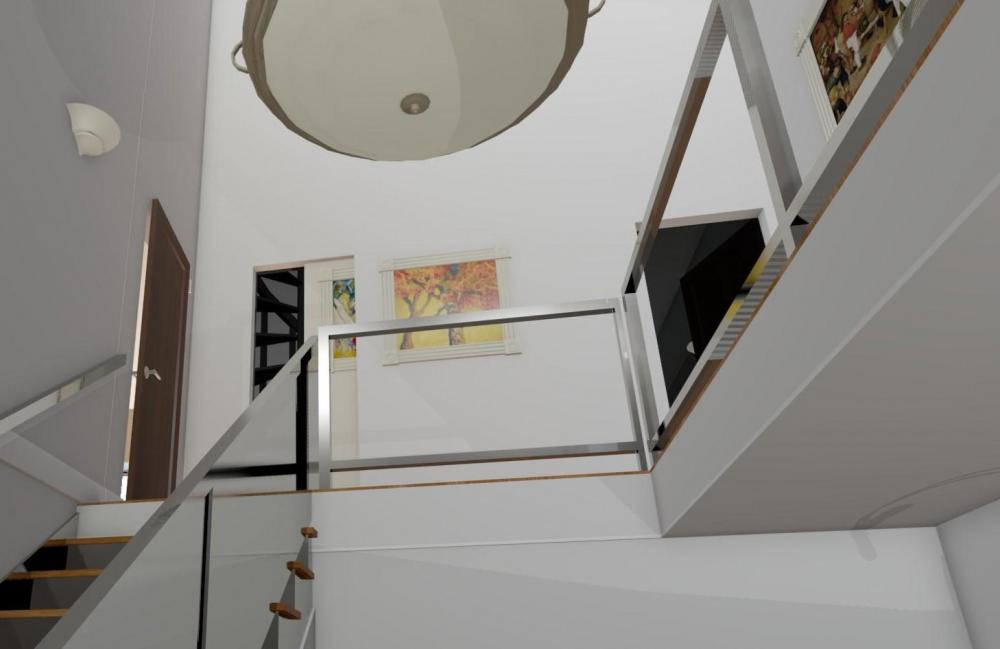

what's the point of the pocket door between Bed4 and the spiral stair? Surely the handrail will preclude acces to the stair...
I didn't realise, very good point.
The point was to have a fun secret passage for the kid to get into the loft.
Perhaps the handrail can be movable somehow?

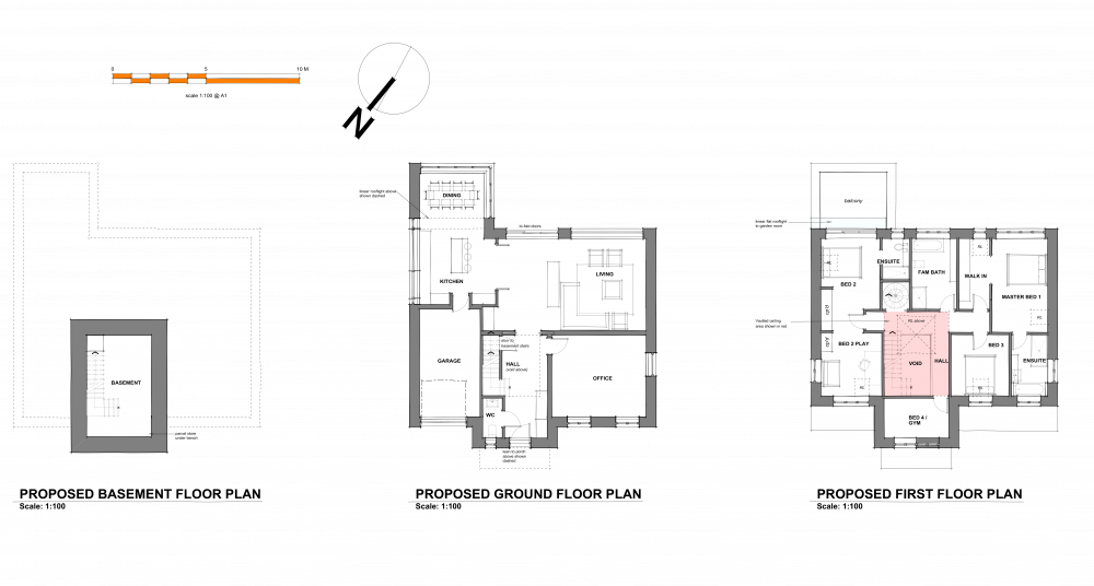

    Here's an updated design after a day or 2 discussions.    Changes: - 1200mm anywhere between island and wall - Moved kitchen pocket door forward into living - Island modified

3 hours ago, ProDave said:
I would not use a round spiral staircase in a square "room"  the old round peg in a square hole situation creating awkward corners you will never get to for cleaning etc.  Make a square "spiral" staircase out of timber in the same way a timber stair can wind round a corner, it will just keep on winding like a spiral stair, but with all the treads going out to the corners.
Then the space under it could be a cupboard accessed from bed 4.
Got it, great point. As I said elsewhere the spiral staircase rabbit hole has been interesting.. on the surface it seems like a good idea but a ton of 'small annoyances' to figure out. I did like the idea of using some space under.

Have you considered direct access from their rooms/built in wardrobes up fireman's poles or climbing walls, which would be more fun and less restrictive in terms of space?

There may be a slight access/design issue with the door between the Landing and Bedroom 3 assuming the front projected part is still to have the lower eaves?
Nicely spotted- this is something I'd need to check since indeed not possible to see just from the floorplan.
Quote
The line of the wall between the Landing and Bedroom 3 doesn’t appear to be shown correctly. The Landing side of that wall lines through with the internal face of the front wall to  Bedroom 2 but does not line through with the internal face of the front wall to Bedroom 5.
I see what you mean, this is probably down to my crappy design skills - I have very little idea of what separates a good design from a bad one (at that detail level, at least).
If the original arch drawing exhibits the same flaw my architect is not doing her job.

3 hours ago, AliG said:
A few things.
Bring it! ;)
1. Mentioned before, but it is even worse now with the thicker walls. That corner between the island and the pocket door to the living area is both narrow and awkward.
Huh, I missed that point from you earlier, will need to review if I skipped over anything else (sorry). It's a good shout, will need to examine.
It would be even worse with a chair at the island. The space around the island is just too small. When you open the door to a dishwasher, it sticks out almost 80cm, you won't be able to pass between it and the island, you won't be able to pass between an open cupboard door and the bottom of the island.
Frankly the kitchen design was a bit slapdash since I was expecting a 'pro' to do this at some point. I did take some values of 'minimum distance' from various recommendation sites, but indeed they might've missed that dishwasher point.
If the plan is to put the dining table in the garden room, then the space between the hall and patio doors seems wasted and I would move the packet doors back in line with the other side of the stairs to give you almost an extra metre in the kitchen.
Yeah, I'm thinking the same thing. To be clear the home cinema is the part that has very few compromises but that bit of movement seems.. reasonable.

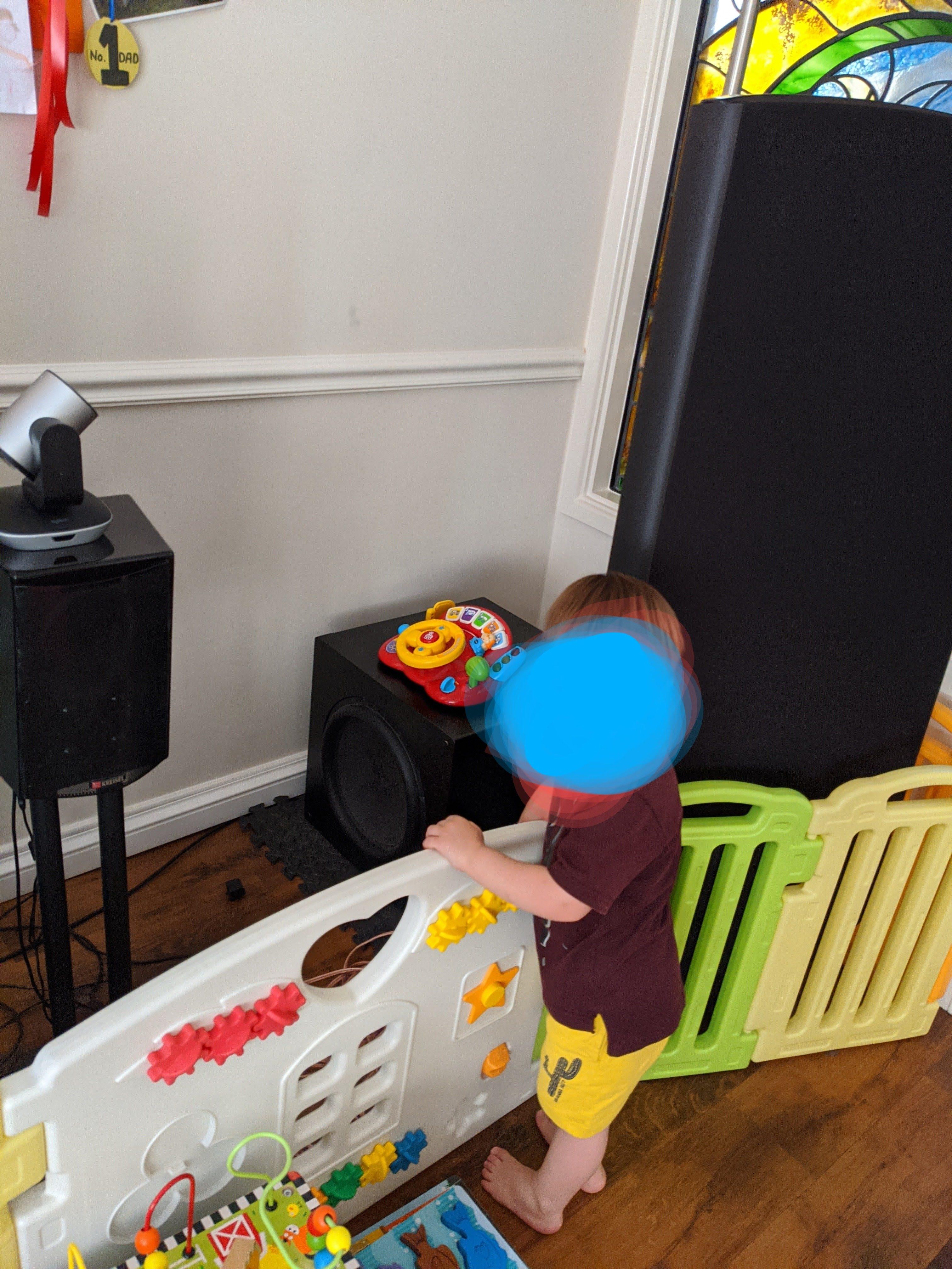

2. You will not be able to use the projector there. I have a 5 m long room painted dark brown, including the ceiling, with a little slot window and the projector is OK in the daylight on a 2.9m wide image. In my old house with a slightly smaller screen, white ceilings and larger windows it was impossible to watch the projector in the daylight. And this was much closer to the screen. The combination of light coloured room, patio doors and projector will not work.
To be clear, that depends on the projector. - https://www.barco.com/en/product/udx-w32;)
I'm not at all expecting this to work well during the day, and will have a 55" TV behind the roll-down projector screen for daytime viewing. Shutters, curtains and suchlike for the evening.
FWIW I've also sent my design of the house to a cinema team to review..
3. Spaces of 600mm and 500mm either side of a bed are too narrow. By the time the duvet hangs over the sides you can knock another 100mm off that.
Depends where? If you want to go for a feeling of space and luxury, sure. But if you're a kid, or if you want to economize, then I disagree. Case in point, in my current house the master bed is 450mm away from full-height built-in wardrobes(!!), and day-to-day this actually is not a problem at all! (once you want to use the wardrobes, different situation!)
4. Now that you have made the master bedroom larger, I would move the door to being a normal swing door next to bedroom 2
Funny, I actually don't remember why I made it sliding in the first place!
The key rationale in general is that with 2 parents waking up at different times, having sound/light separation between bed and bath/walkin is important.
and close in the wardrobe more. Sliding doors are a pain to use relative to normal doors.
The big sliders are to 'by default'(open) have a large amount of spacious feeling but it's a good shout I want a quality design that's easy and silent.
It is not quite clear though as the render appears to have wardrobes there. You have a lot of room in the walk in, I would try to keep all the wardrobes in there.
Yeah sorry the render is slightly older than the floorplan. The walkin is a 3.3m wall of 550mm full height wardrobes.
5. The floorpan shows windows on 3 sides of bedroom 3. With the already limited space, a window or door on every wall will make placing furniture difficult.
Interesting point, heh as said before I know next to nothing about practical window placement, size, space, etc. But bedroom 3 is a bedroom in name only, if anything it'll probably be a gym or office. Perhaps not a bad idea to close up the window behind the bed though.
6. I would make the sink area smaller in the master ensuite so it does not impinge on the entrance area in front of the shower.
Maybe have it start where the number '743' is displayed then?

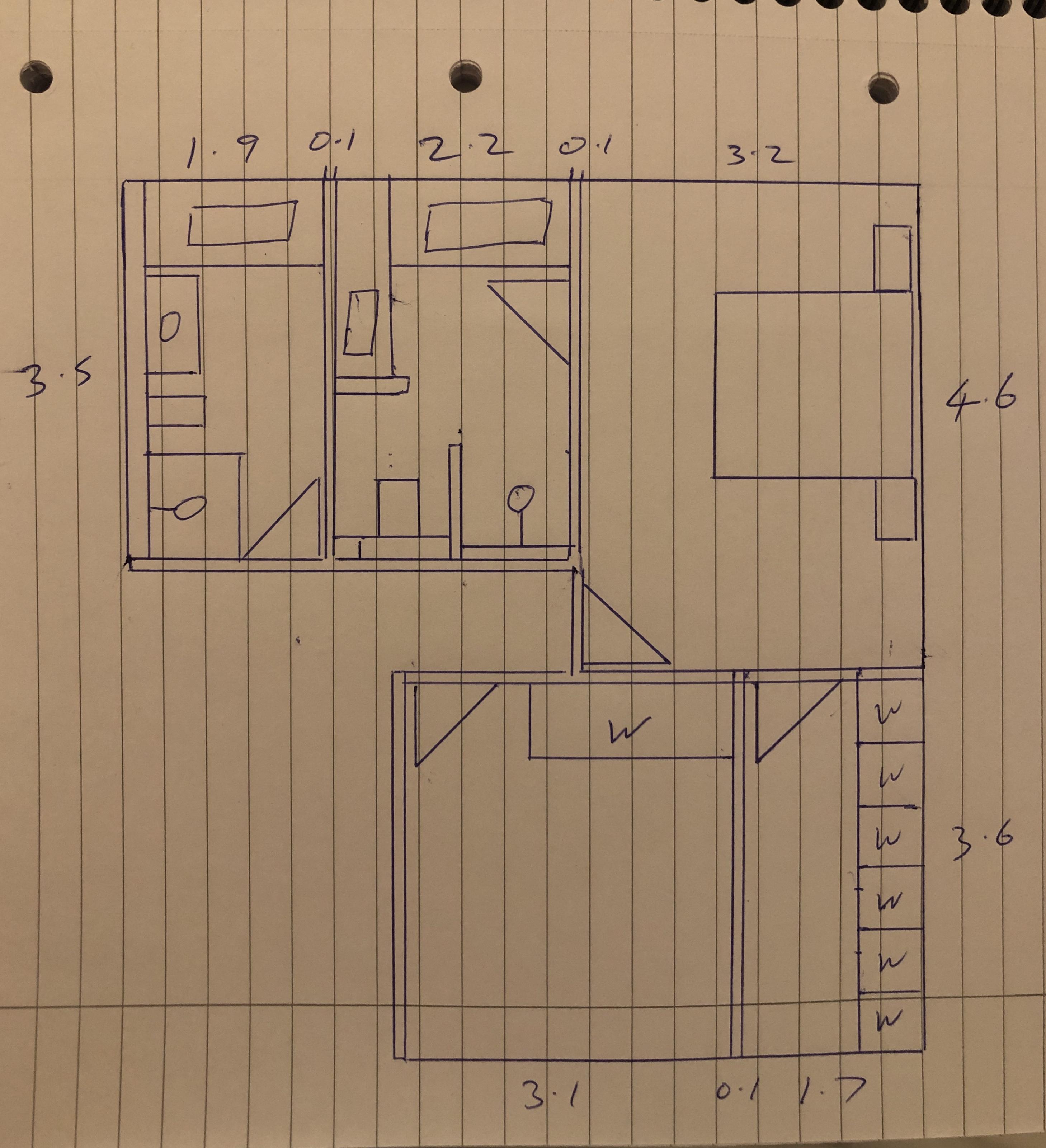

I probably wasn't clear enough, it is the slide into the master bedroom that I was talking about doing away with The sliders into the dressing room are fine, but as a door into a main room a normal door is better, it would fit next to the bedroom 2 door. Also if you want to make the roof habitable space, it will have to be a self closing fire door, something hard to do with a sliding door.
To do it you would have to make the entrance to the dressing room narrower so that the door doesn't slid into the hall wall, then you can put a normal room door there.
I have been trying to draw it up, so let me come back with a sketch.
I was going to ask about that, that is what we had in the cinema room in the last house. That was a dedicated cinema room and what happened was we never opened the curtains and never used the TV. The rear speakers can go in the ceiling so you don't have to worry about them, I would probably build a false wall where the screen is and embed the TV and speakers into it.
Would be great, I'm struggling a little to follow off words alone.

Ah, no, speakers need to be at ear-height when you're sitting. :)  but I did debate putting them in the walls, the problem with that proposition is that if you buy new speakers they might not fit.. so the current default is hanging them off the wall as per normal, but I could be convinced.
Uh.. have you seen my speakers? :) no.. the front speakers are a FEATURE
For reference my kid is pretty much exactly 1m tall.
- The speaker to the left will be a side speaker (minus the stand), rears are slightly larger but similar. The sub in the back is about 50cm tall and the big ones are 1m50..
and of course i will have speakers in the ceiling, but that's dolby atmos for you ?

I have been playing around with the layout for a few hours but, I have a couple of questions.
1. What equipment do you want in that utility area in the garage? The ASHP would have to be outside. Is there any reason it is not part of the heated envelope of the house? If it is so it could be turned into a full garage in the future that would be very difficult by the time you have the MVHR etc in there.
2. As the kids bedroom has an en suite and you have a shower and bath in your en suite, do you want a shower and a bath in the main bathroom as it may help to arrange the rooms upstairs if you can lose the shower or bath from the main bathroom, but equally that may be what you want.
Edited by AliG
Ooh cool..
Sure
The passivhaus builder gave me a rule of thumb that they would appreciate 3m of 'utility wall' to fit the arsenal of heatingcoolingcirculating stuff. I think you're right that at least one of the devices probably needs to be against the outside wall or else it'd be a ducting hassle.
To be honest I've kind-of given up on the whole full garage thing although I might not have admitted it to myself yet. I still think a carport would be a great idea but I don't think the space is ever going to store a proper car.
"Eh" for our own use we'd just want the bath in master ensuite. For kid, shower is fine although he might start to enjoy baths.
Perhaps a showerbath could be a doable compromise in the family bathroom?
To clarify, my dream would be having:
- A 'room' that is outside of the thermal envelope
- At least 3x5m
- water + power (washers, freezers)
- Thin wall somewhere halfway down, to shield internals from elements
- Car port for the rest - open to air
And separately, elsewhere, the permanently fixed 'heating/cooling/water storage' stuff
-> If someone *really* needs it to be a garage, it can be turned into one. (resale, or maybe when I hit midlife, I need a ferrari..)
But at this point the only builder we spoke to so far says that even a small 3x3ish basement for that permanent heating stuff will cost a *serious* amount of £ - depending of course on water table etc, the estimate for a 3x3 basement would be 72000 gbp, so I guess that solution is out... (unless they are somehow waaay off but they were fairly reasonable in most other estimates..)
The reason I asked is if you have a 2m ish carport but then make the wall between it and the utility the outside wall of the house it frees up a bit of space for the kitchen due to moving the thick insulated wall. It would also nicely line up with the bedroom wall above making the build easier. The carport area would just be like a small porch then.
If you put a hot water tank and MVHR in that utility space it will never be possible to convert it into a garage, so why not just make it part of the house now.  I think you are compromising the house for something that won’t happen. Also the door from the kitchen to that space would have to be an insulated outside door or you will lose considerable heat from the kitchen.
I am not an expert on ASHPs but they have to be in an area with unobstructed airflow. It is just about conceivable it could go in the open carport at the front but ideally it would be at the left hand side of the house. However you only have 1m width there and an ASHP might be 400mm wide with various  clearances required depending on the model. Just something worth noting.
Edited by AliG
Interesting point. Implemented this to see how that works.
Are you saying to include part/most of the 'garage' into the insulated envelope?
Yup, as noted above I'm close to giving up on the whole "It could be a garage" story. It might have some other impact though, since I'm required to provide 3 parking spaces on the property, but I think it should be fine.
I guess I just would want one more quote how much a small basement for this heating equipment would cost.. I heard a LOT lower in this forum
Well, hm.. I think it would make sense to have the ASHP not obstruct the path to the ... ha now I'm reconsidering.. but basically as you can see in my updated drawing, the external part could just sit out of the way to the front.. but perhaps I value access to the rear more. (to be clear, there's a clear path to the rear on the other side of the house..
OK, my quick sketch before bed, sorry for the lined paper.
If you use normal 100mm wide stud walls, then you have 7.5m across the back, less 200mm of wall. Also the wall between the bathroom/en suite and the landing being 100m frees up 100mm to make the rooms 3.5m long.
If you reduce the size of the shower in the main bathroom (or do away with it) and cut the main bathroom to a still decent 1.9m wide then you can put the master en suite where the walk in is and the walk in where the en suite is. As the walk in is narrower then this gives you more room for the spare room which can also have a wardrobe.
There is plenty of scope in those spaces for bathroom design, I just put something down quickly. I should have drawn the main bathroom the other way round so the pipework backs on to the pipework on the en suite. In the en suite I put the WC in a little space of its own and made a walk in shower, but there is plenty of space to do other things. All of our showers are walk in, no doors to clean and more space efficient. Putting the door into the middle of the ensuite and not the end usually lets you use the space better.
