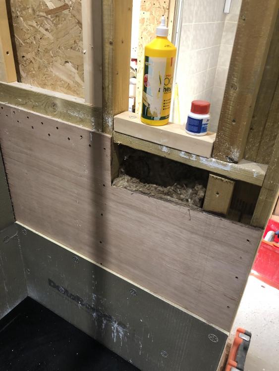

Pocster Posted March 15, 2020 Posted March 15, 2020 Found a thread on this already , mentioning ice cubes and battons My tray weighs an impressive 72kg . As I’m always on my own ( pre self isolate - I set the trend ) ; this won’t be much fun . Want to recess tray into floor . So once wall boarded with marine ply and tile backer board on ; need a nice method to get tray in and out of corner . Battens sound best . But tray won’t be easily liftable once in situ . Was thinking of some kind of hoist ...

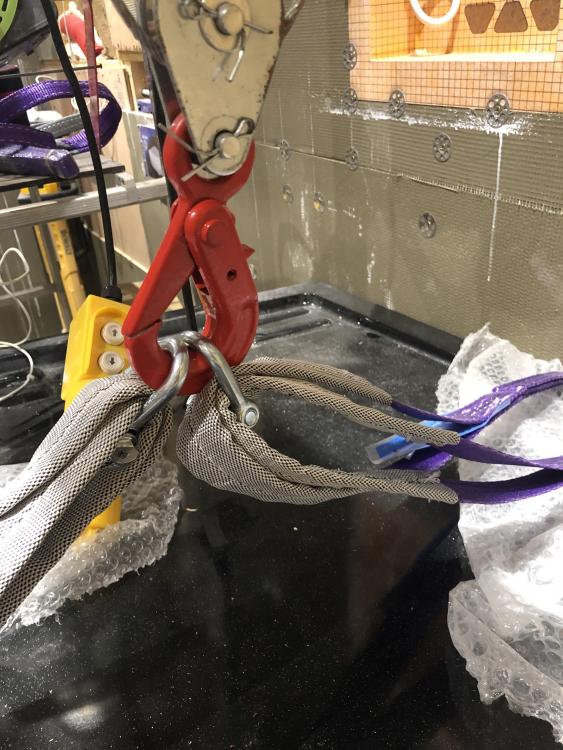

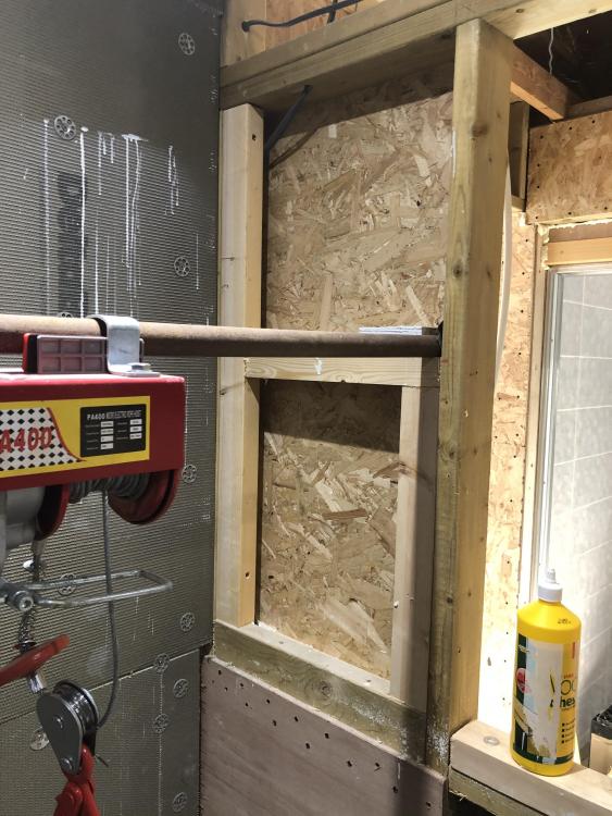

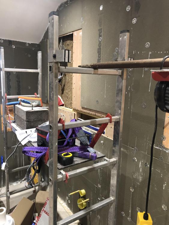

Pocster Posted August 10, 2020 Author Posted August 10, 2020 Not on this yet - but thinking .... I could stick a hole in the beam and block and use a bottle jack to lift/ lower it . Only issues are the height the jack could go and some method to support the whole tray - stop it falling off the jack . Is it ok for a tray to be ‘jacked’ at one point ? ??
Ferdinand Posted August 10, 2020 Posted August 10, 2020 (edited) This one? My tactic was to buy a tray that weighed half that... Edited August 10, 2020 by Ferdinand 1
Pocster Posted August 10, 2020 Author Posted August 10, 2020 On 10/08/2020 at 17:45, Ferdinand said: This one? My tactic was to buy a tray that weighed half that... Expand The best solution is a lite tray . I reckon props / jacks from beneath is the man solution ? 1
joe90 Posted August 10, 2020 Posted August 10, 2020 On 10/08/2020 at 18:45, pocster said: I reckon props / jacks from beneath is the man solution ? Expand Says the man who already bought a heavy tray!
PeterW Posted August 10, 2020 Posted August 10, 2020 On 10/08/2020 at 17:17, pocster said: . Is it ok for a tray to be ‘jacked’ at one point ? ?? Expand No you will snap it or punch a hole in it.
